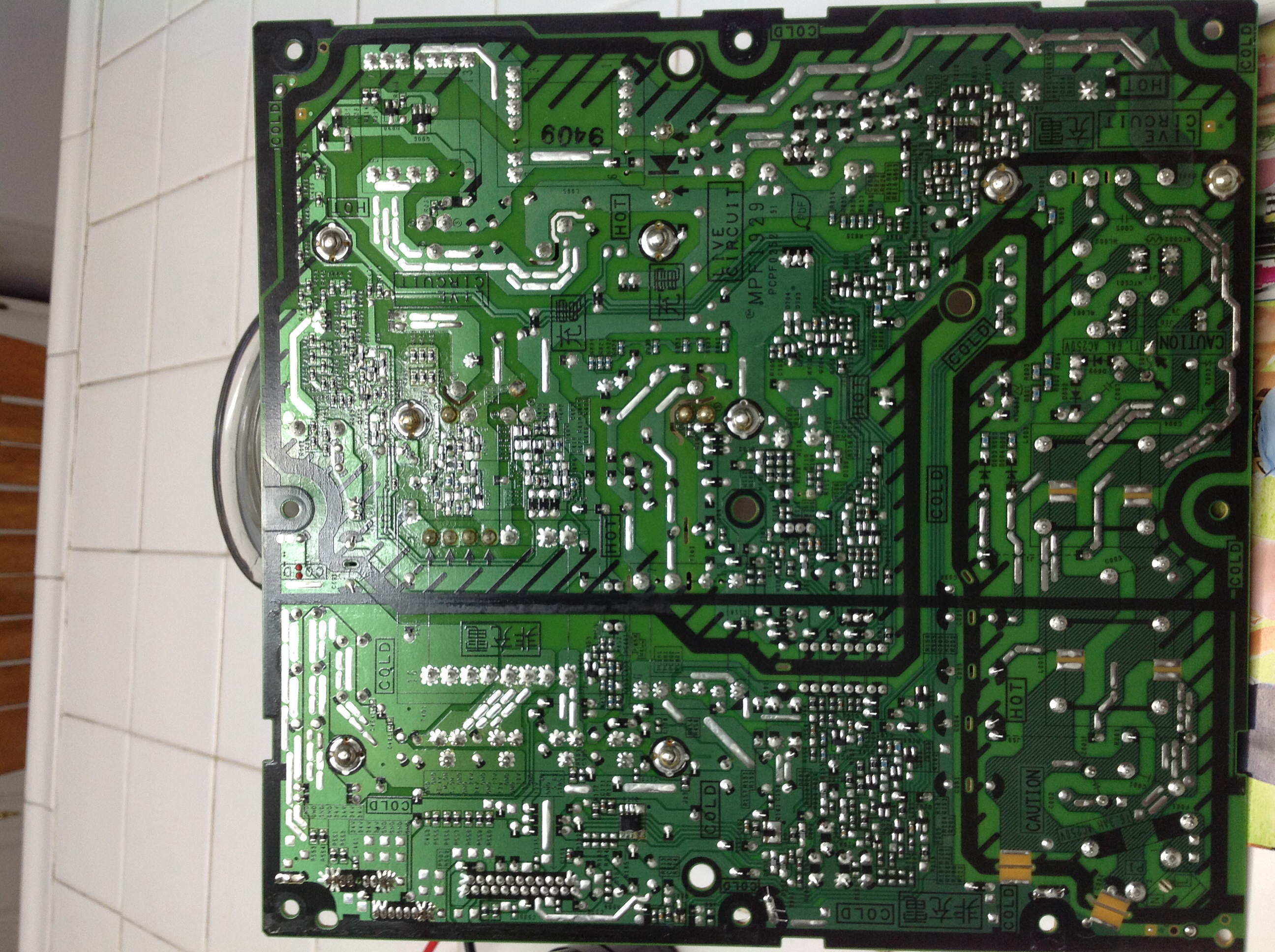

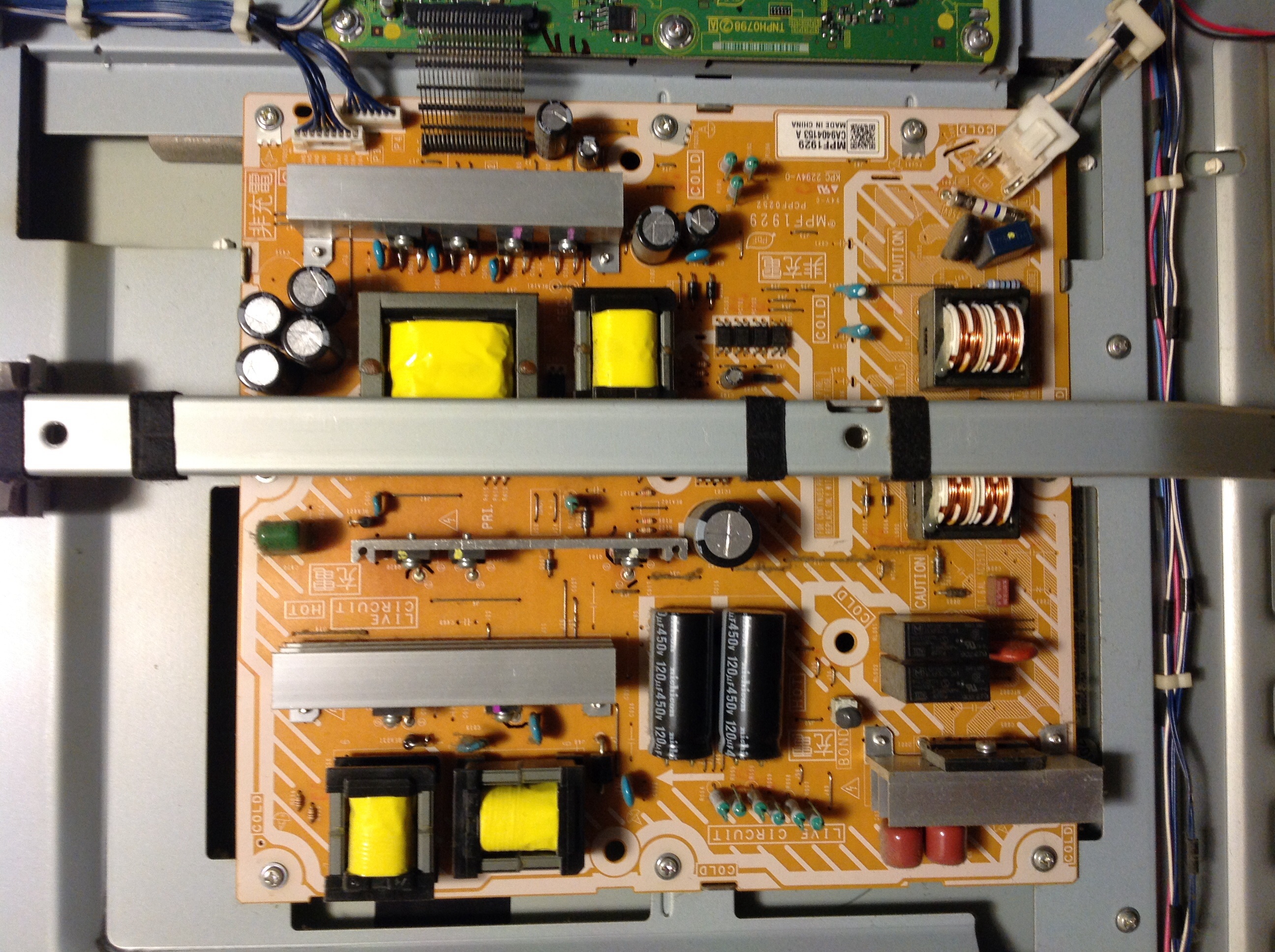

    This tv is completely dead. No lights, no sound, no blinking, no bulging caps! The fuse appears to be soldered in. Not sure what to do; I'm open to any suggestions.

    you need a meter to test the fuses - i see atleast 2.

        Thanks stj for your reply. I see the obvious fuse but not sure of another one. Do I need to remove the board and test these out of circuit? Any details you could provide is appreciated.

          You will need to remove the board. When it out take a good clear picture of the bottom.
          There is a red box fuse - bottom left corner on your picture half an inch from the edge.
          Will probably say F??? beside it.
          You can test in circuit. No power to the board -meter on ohms 200 good fuse will read same as touching the probes together

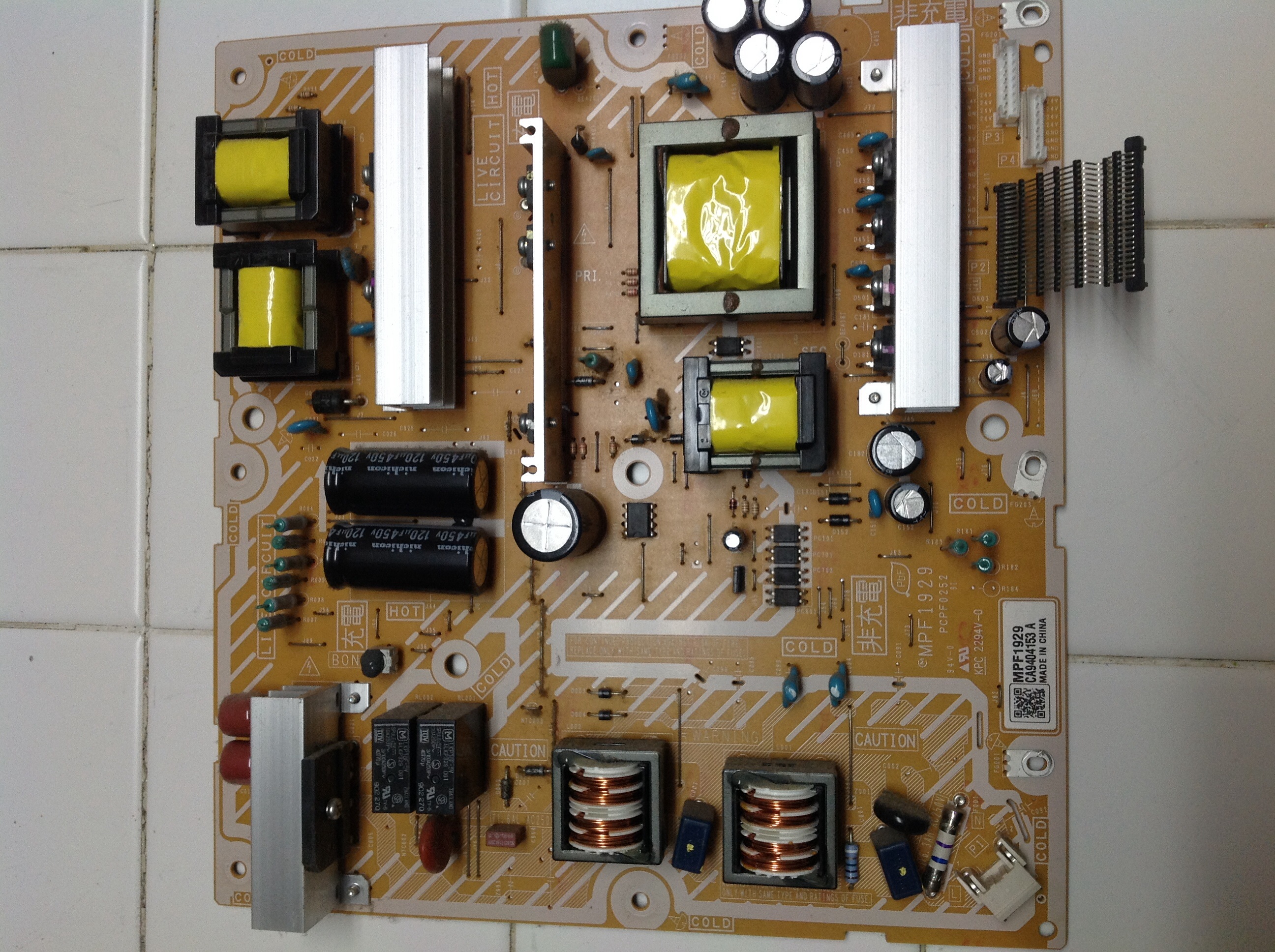

            Thanks selldoor for response. I took out board and tested red fuse in circuit and got OL. I'm not sure about the white fuse. It appears to be riveted in and not sure if I can test in circuit or if it's ok to remove the rivets. I tested it in circuit and got intermittent readings. I apologize but I'm quite the novice currently. I am attaching hopefully clearer pics of top and bottom of the board.

                OK I was looking earlier but couldnt see what amps the red fuse is. I think I see now it is 1.6amps. You will need to get a new one but perhaps you can find another type that will do to test more cheaply. You do need to test that other fuse - it should test the same way - perhaps try on the solder joints at the back of the board.
                Next test after that is a HIGH voltage test just on that board.
                You need to work on a non conductive surface and use a rcd if you have one. Also have someone else in the house if possible.
                So set your meter on 600vdc and CAREFULLY put one lead on each leg of one of the pair of the BIG capacitors - should be 300-400 volts.
                Perhaps try a dummy run to practice holding the probes and watching the meter without power to the board. Then power it up and test on both caps. Then unplug and leave for 5 minutes
