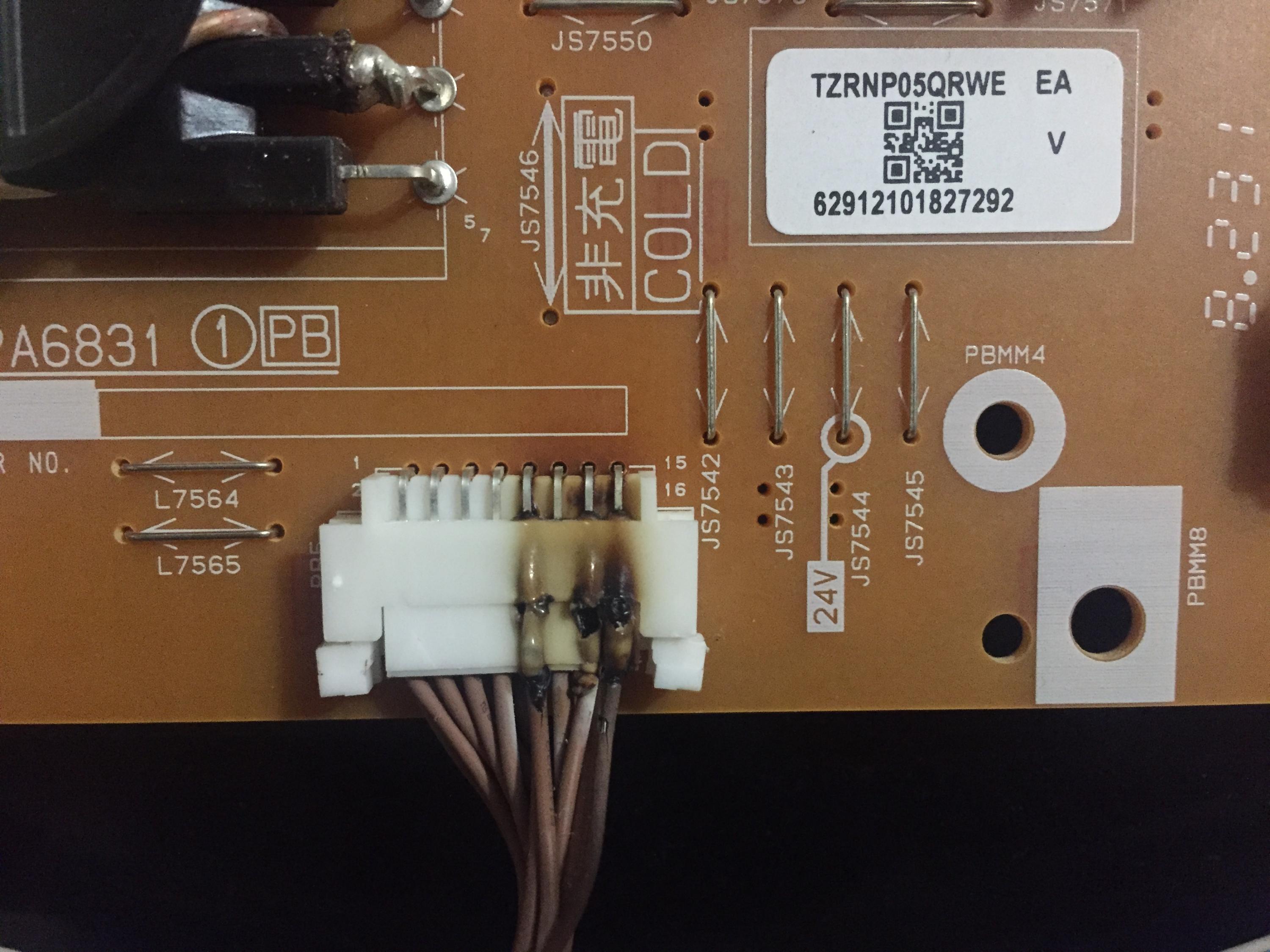

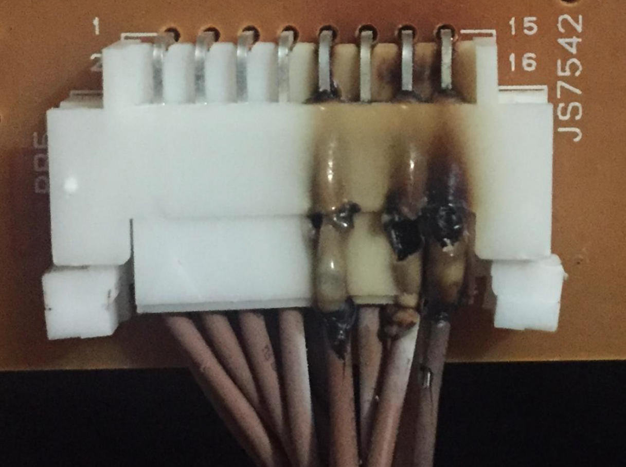

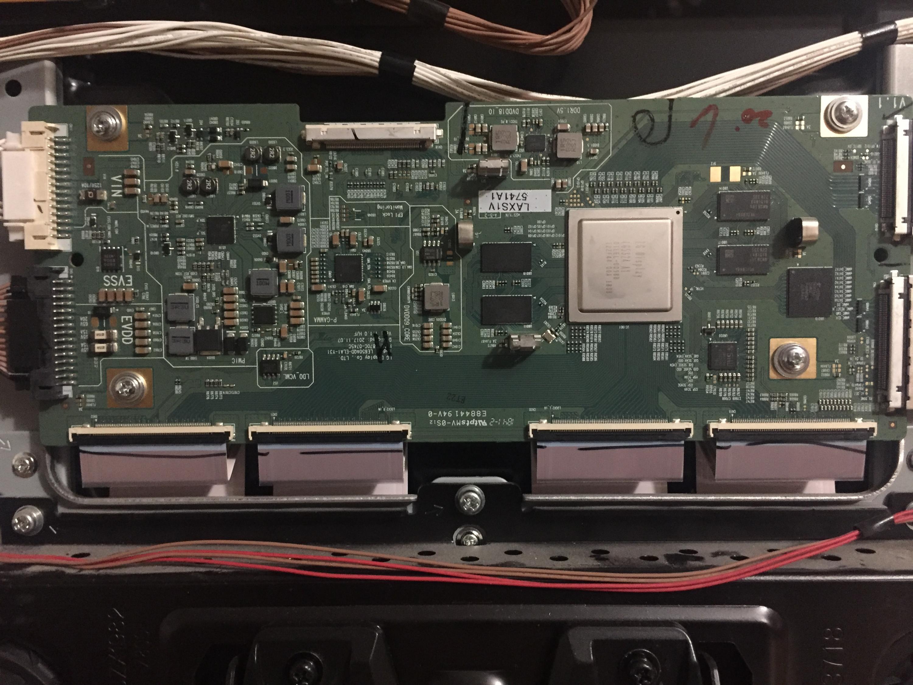

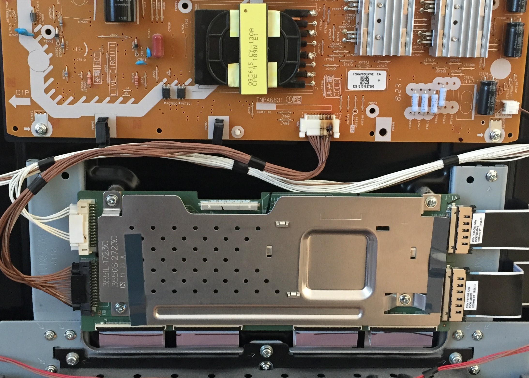

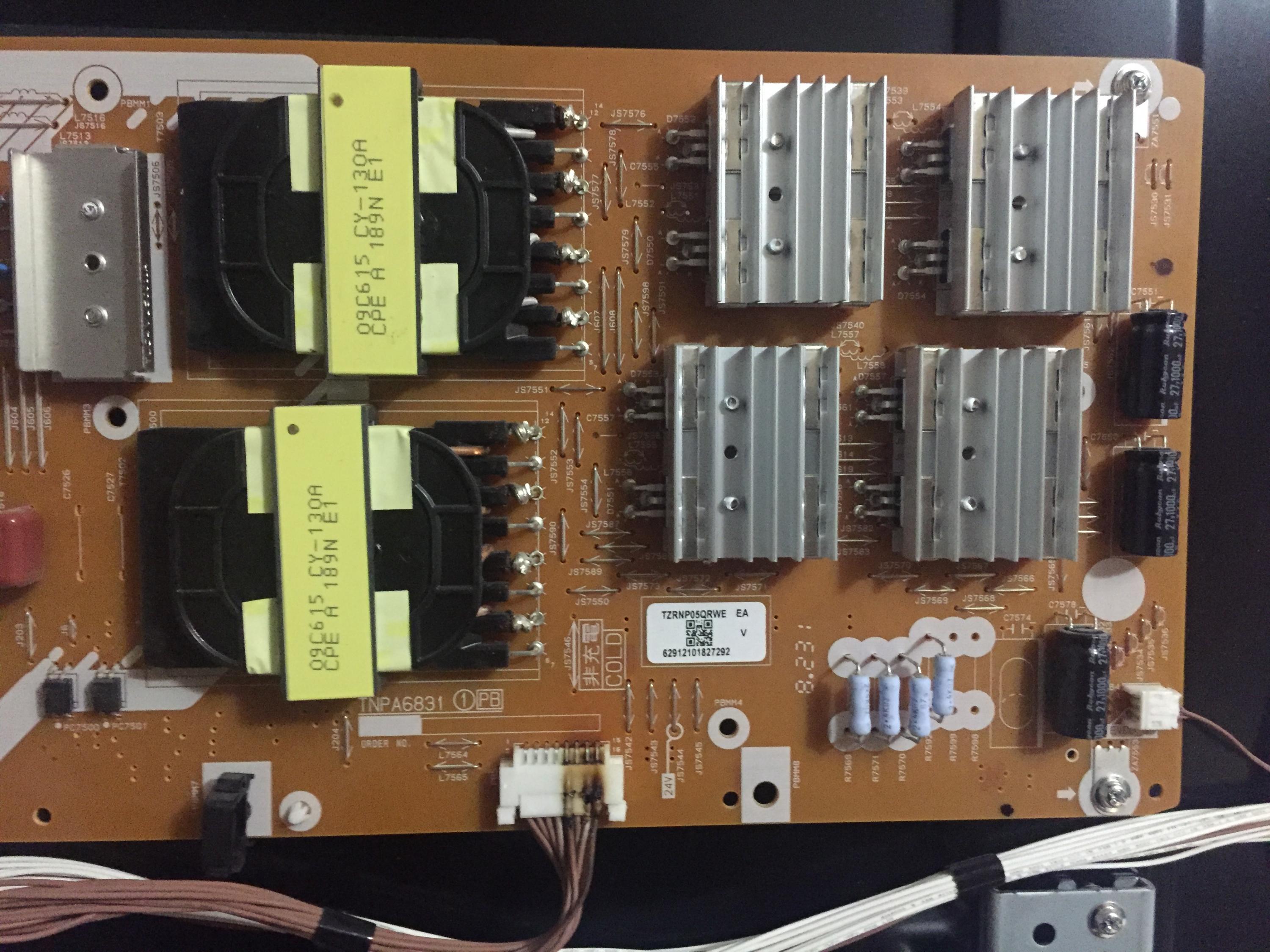

    I opened it and found a burned connector on PB-board on the 24V pins.
    The 24V wires have change a bit of color due to the overheat and the corresponding connector on T-CON board has nearly no damage.
    On T-CON board, I removed the metal plate and detected a bump surely due to overheat on L6006 wich is located on the 12V rail.
    I checked all decoupling capacitors looking for a short circuit but found none.
    A short circuit exist on the mosfet source Q6004 (SVDD_CS ?), seems strange to me.
    I am waiting for a new part but I do not have the T-CON schematics to check the mosfet wiring.

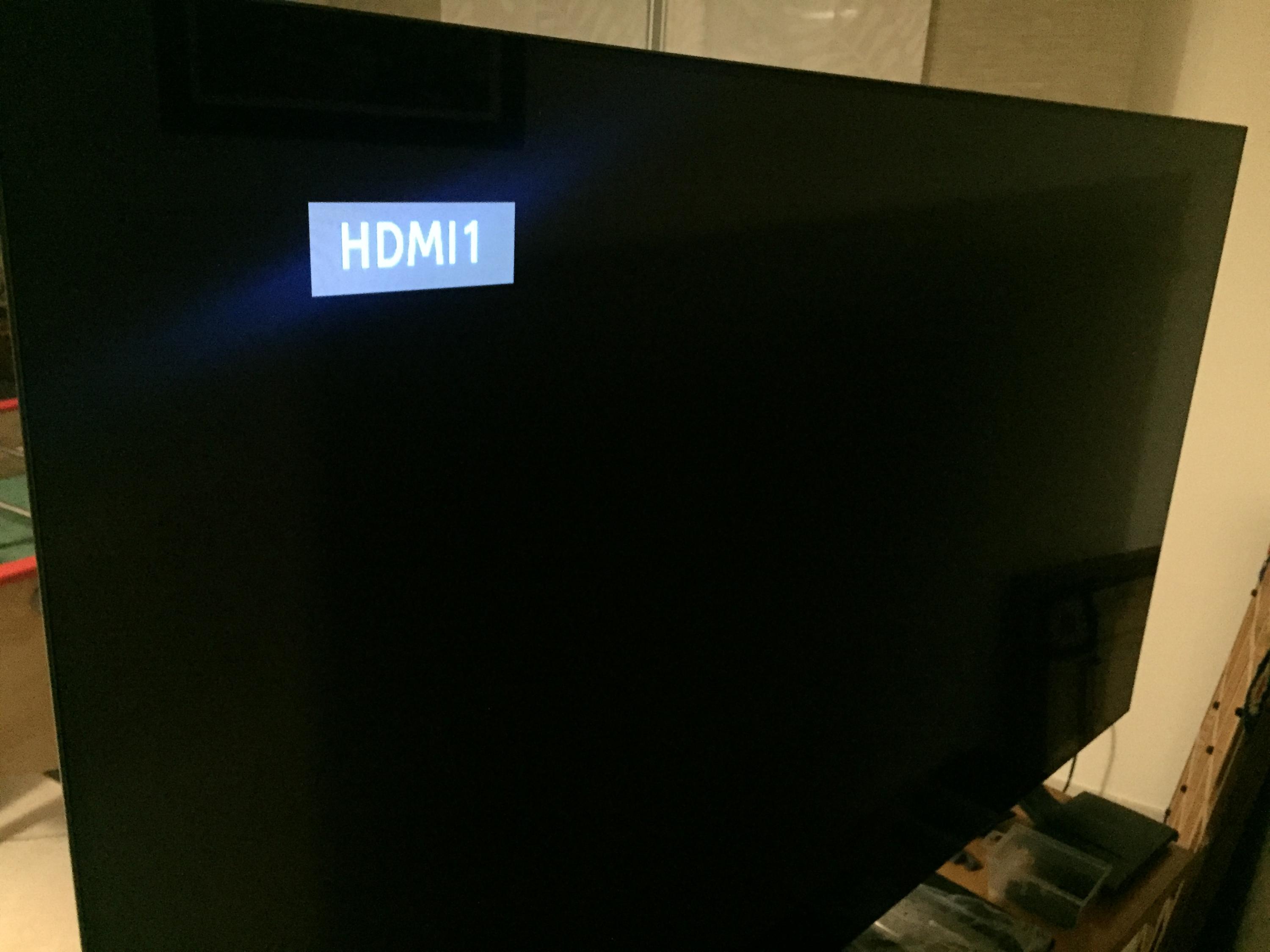

    I power up the TV without any video source and then the OSD display a small blue box with "HDMI1".
    In the case the 24v (EVDD) and 12V(SVDD) are ok, stable, no overload, no overheat on 24V wires.
    Then I plug a video input on HDMI1, the video is displayed perfectly, 24v(EVDD) and 12V(SVDD) are OK but the 24V wires between PB-board and T-CON board becomes more and more hot and the TV switch off (no more 24V either 12V).
    If I turn on the TV again, the TV immediately switch off, no 24V either 12V.
    I use a freeze spray to check if it is due to a componant temperature but no change, the TV switch off immadiately.
    To test again with an image, I have to wait for hours.

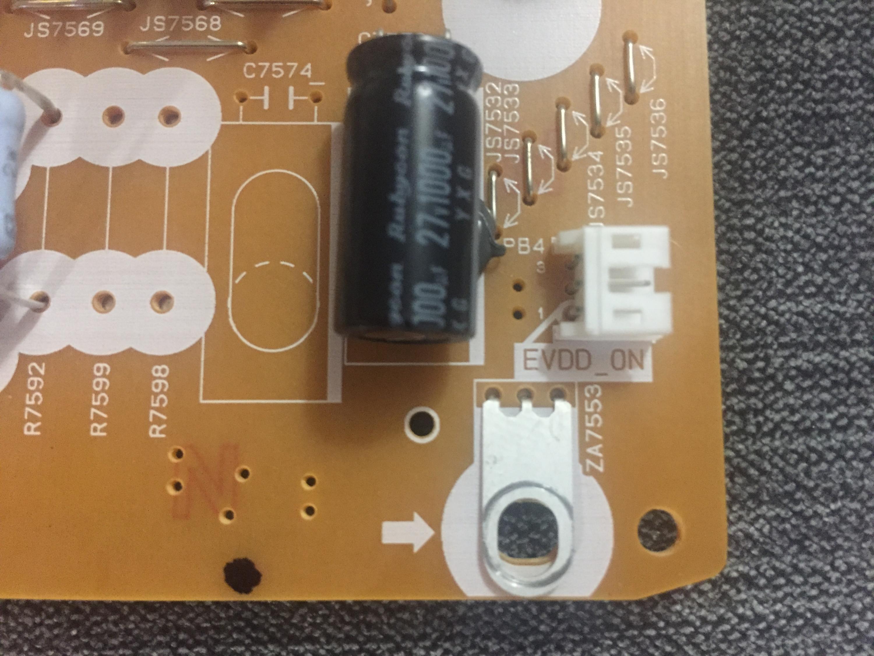

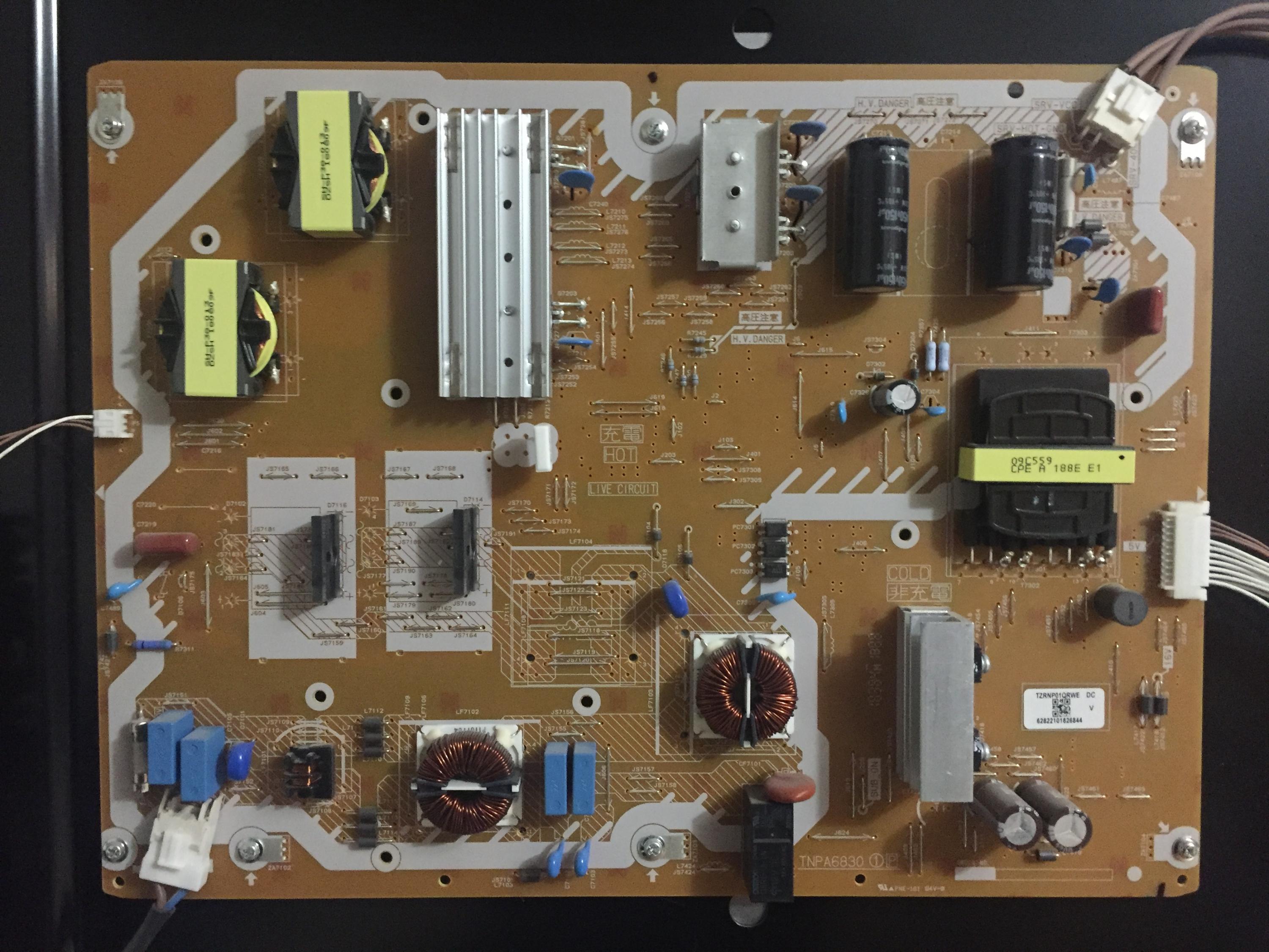

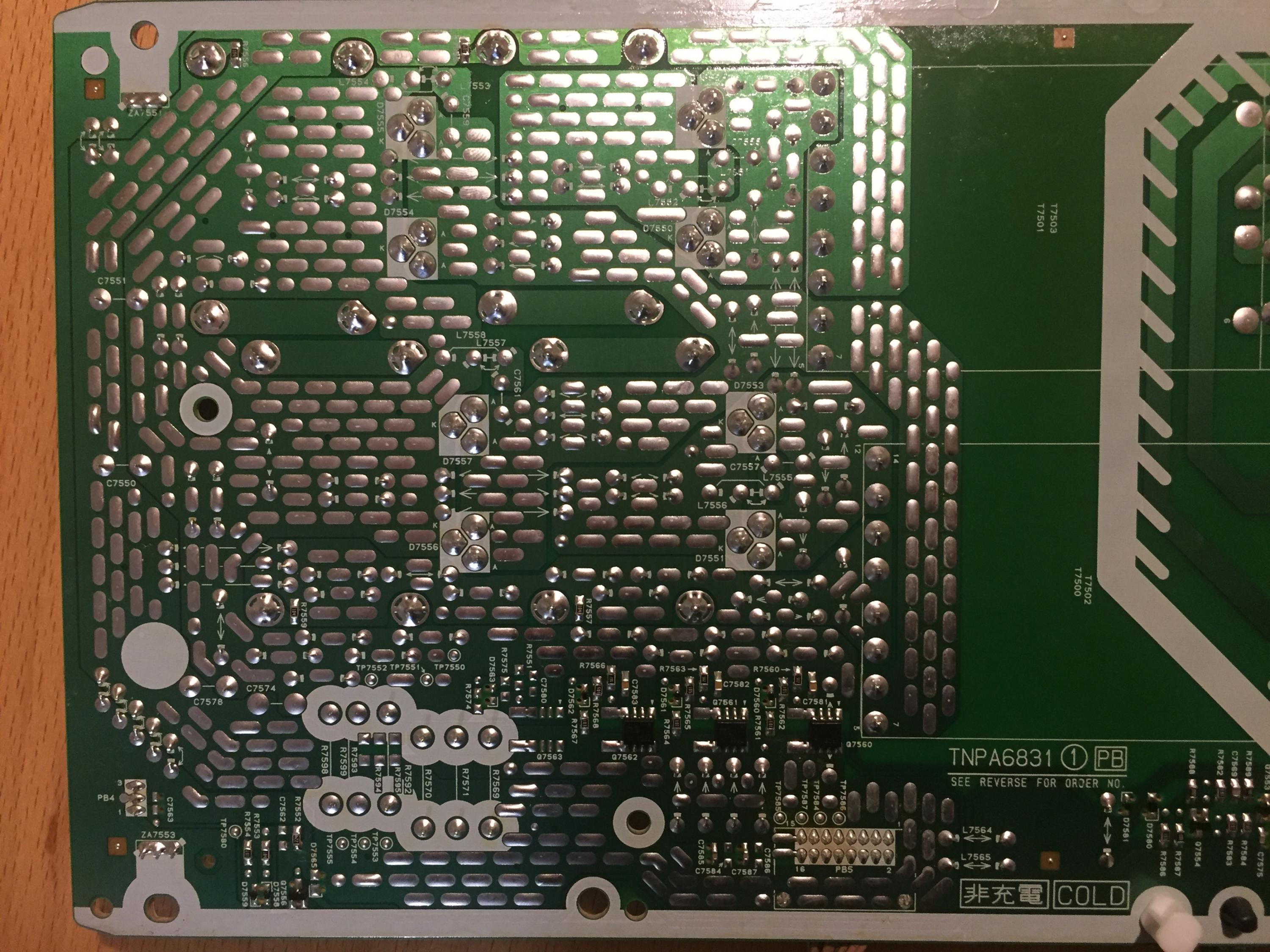

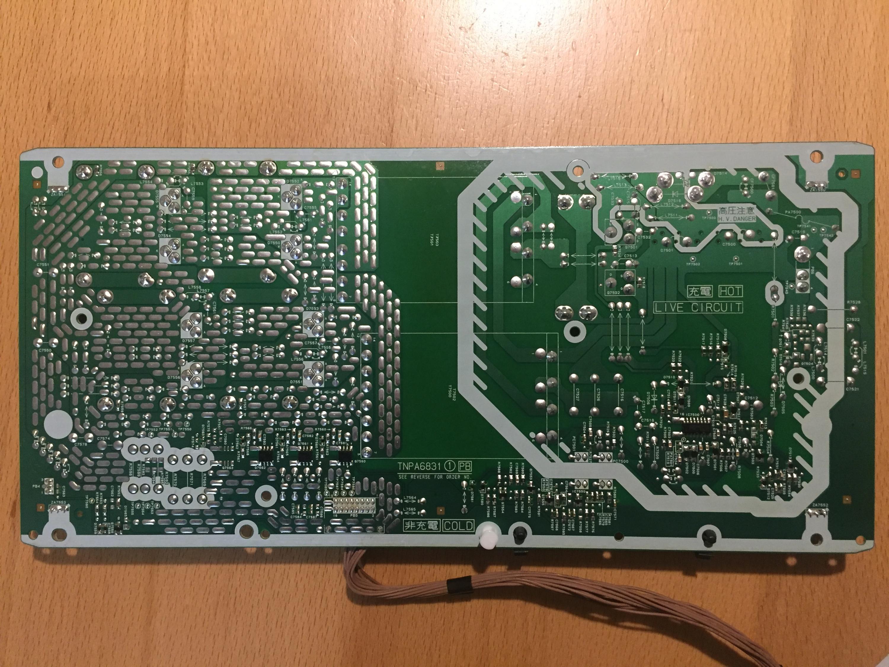

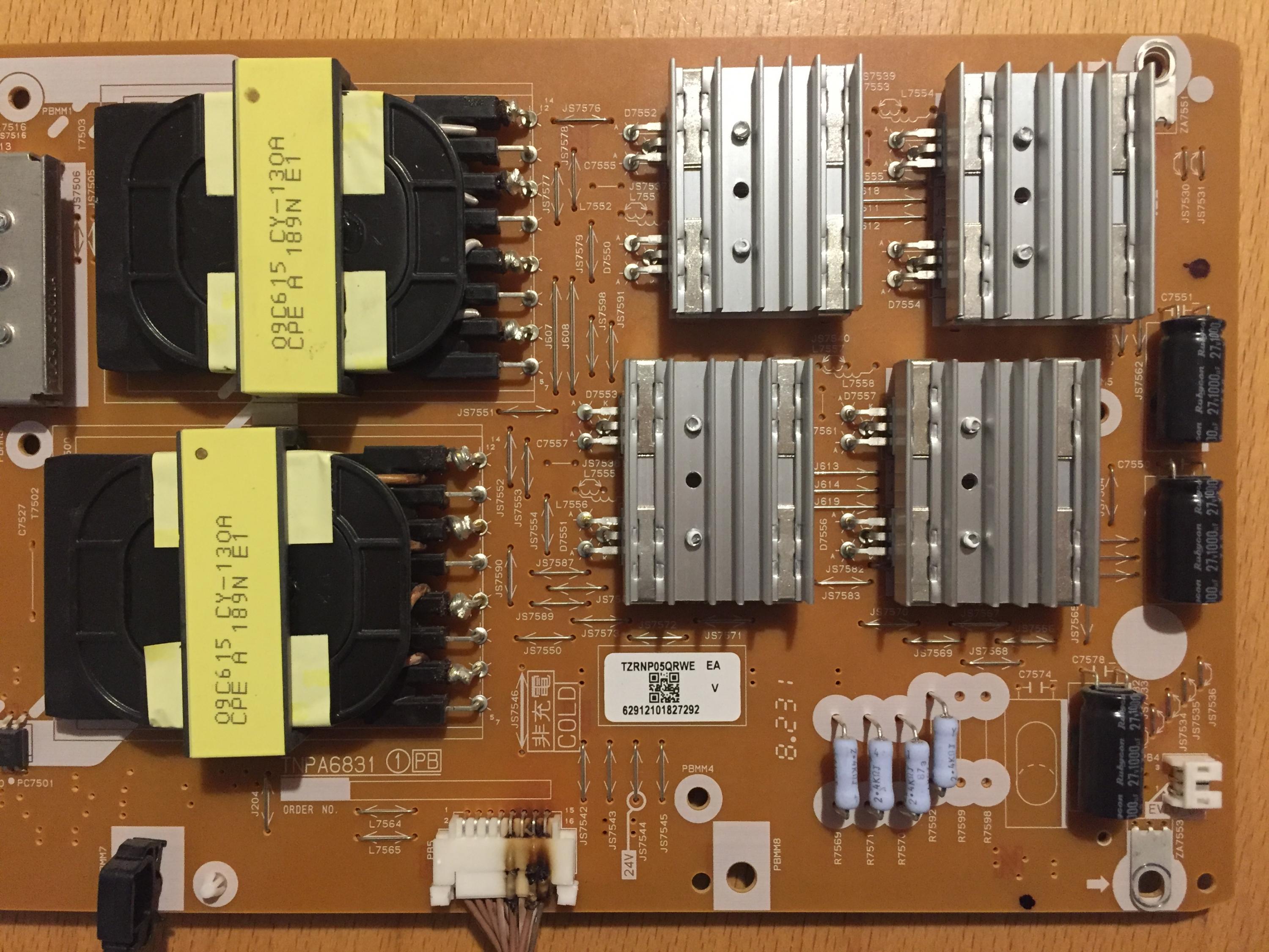

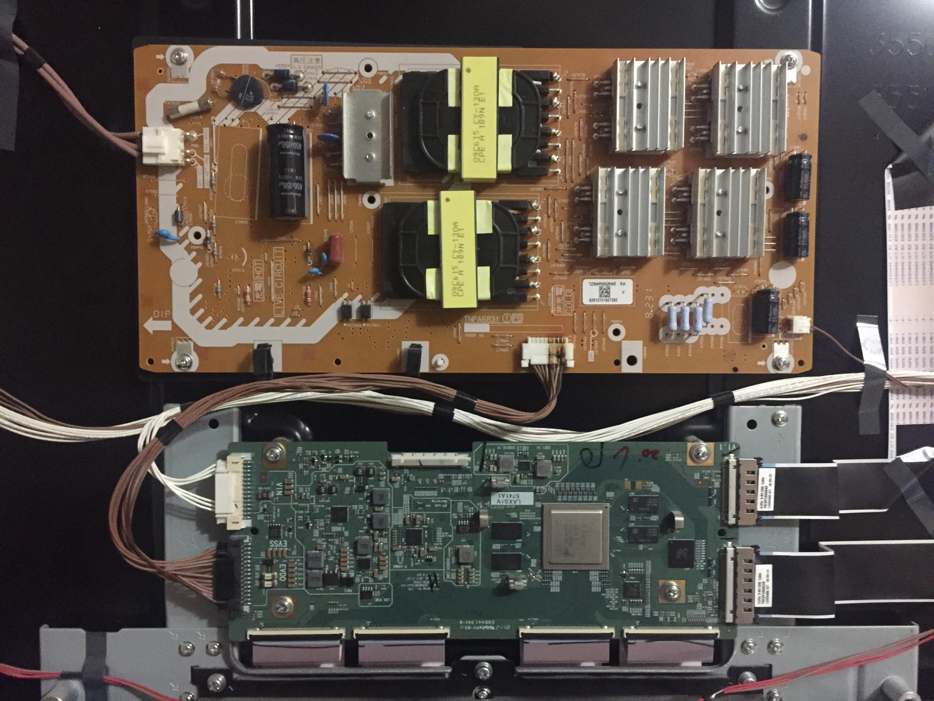

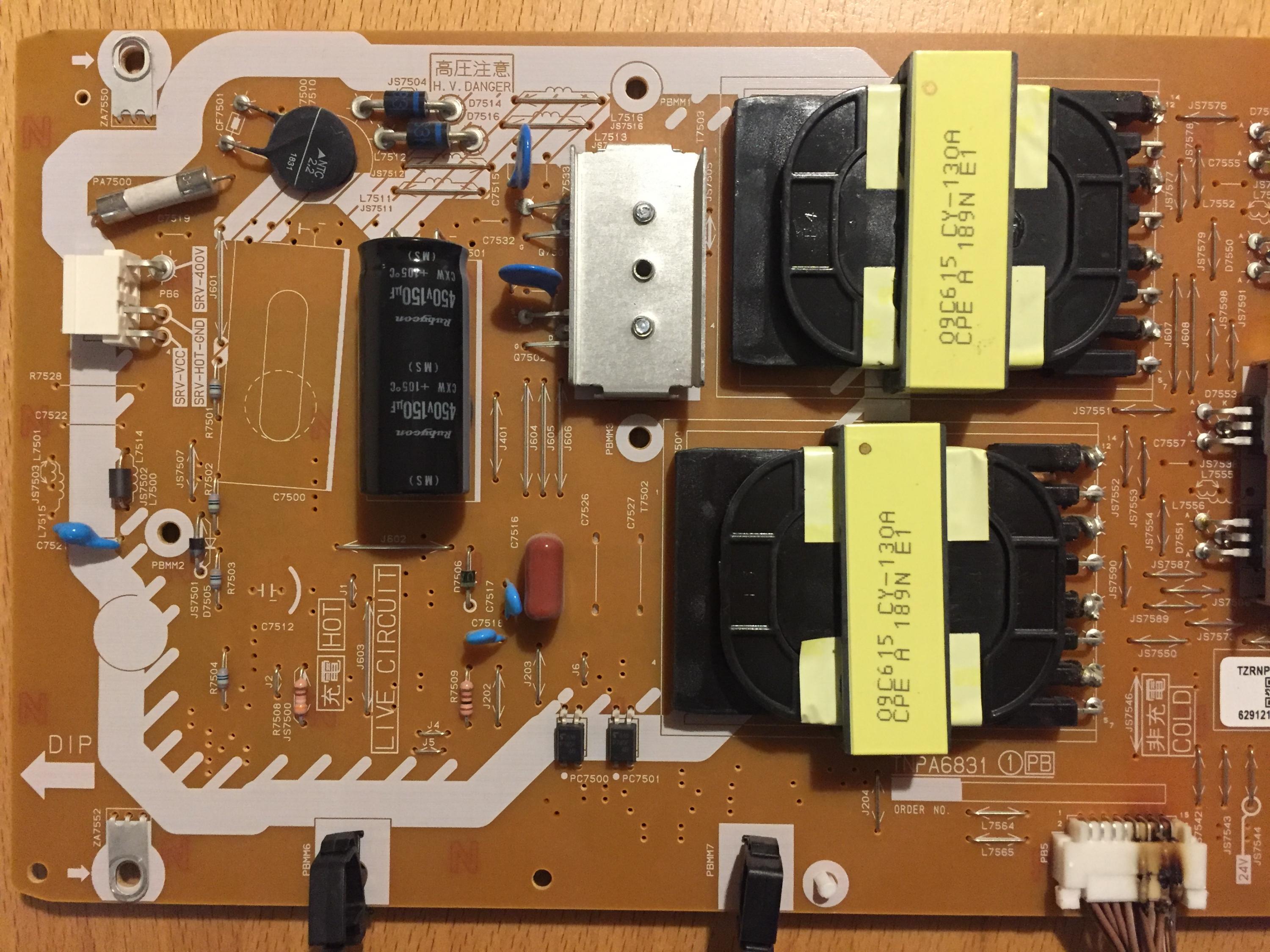

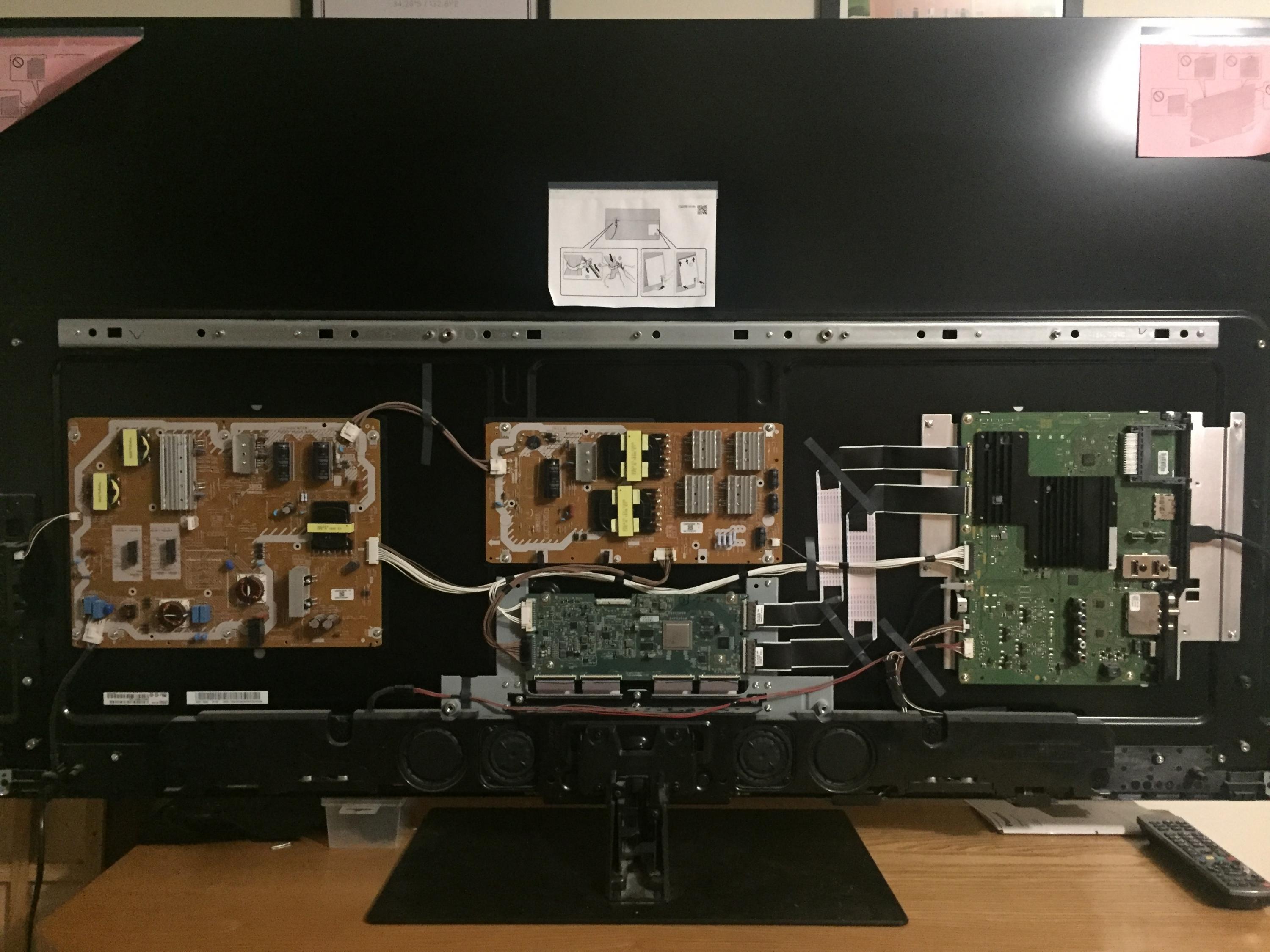

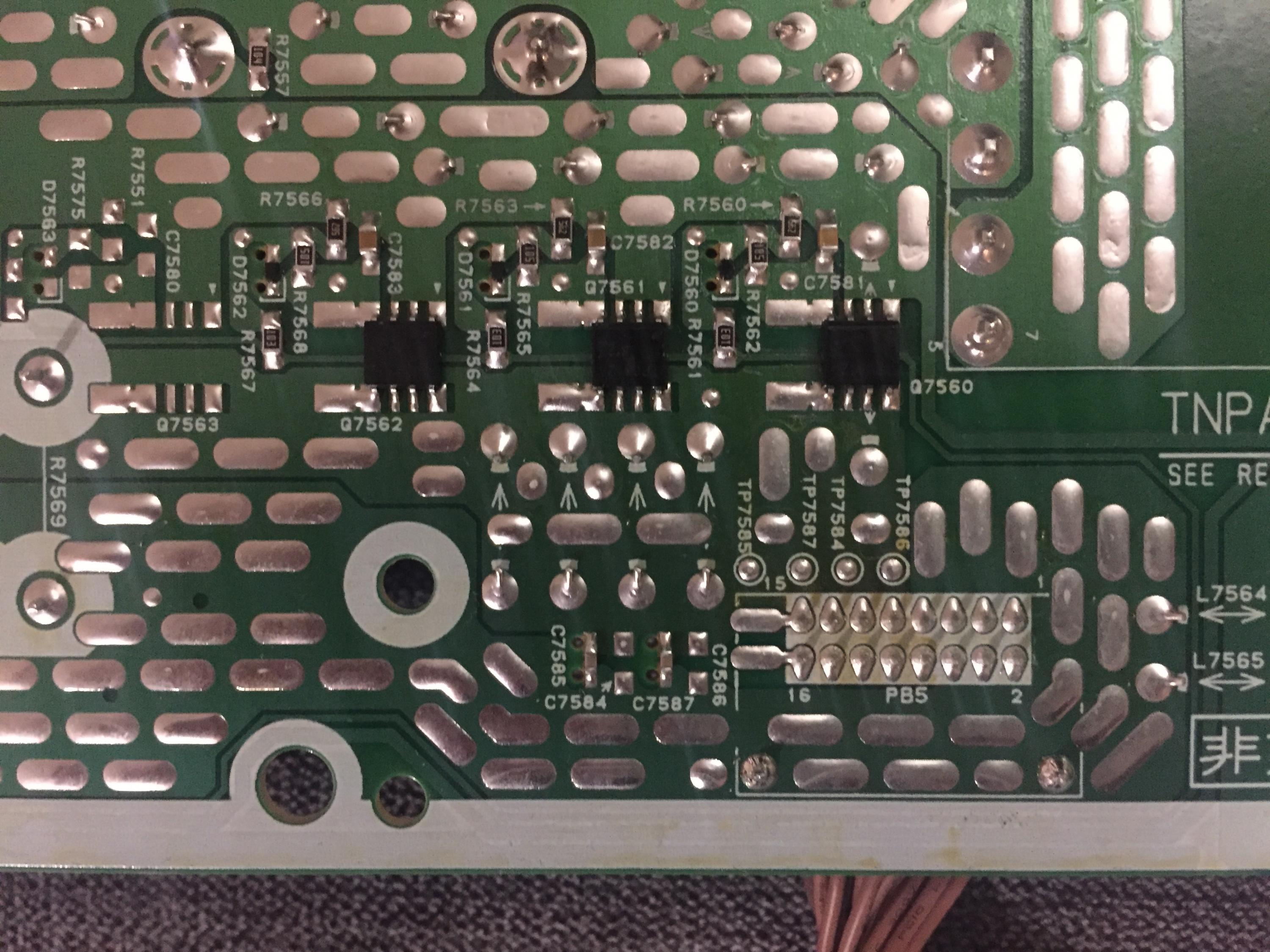

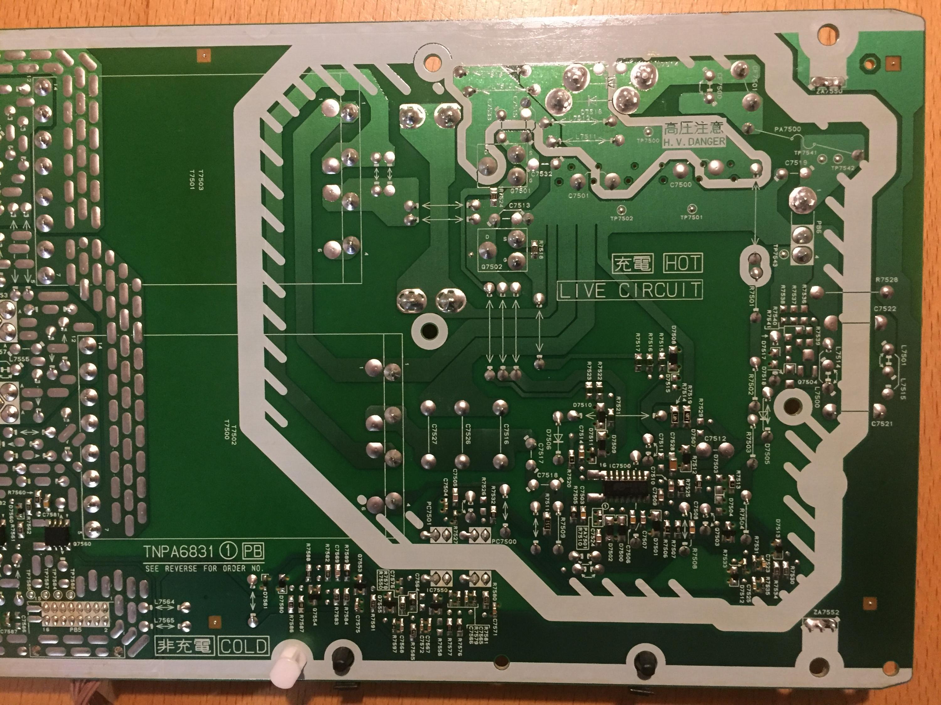

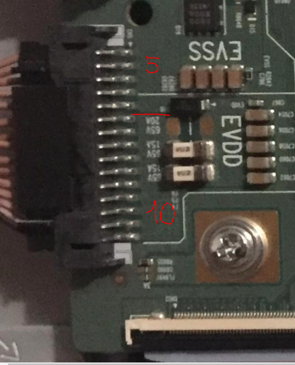

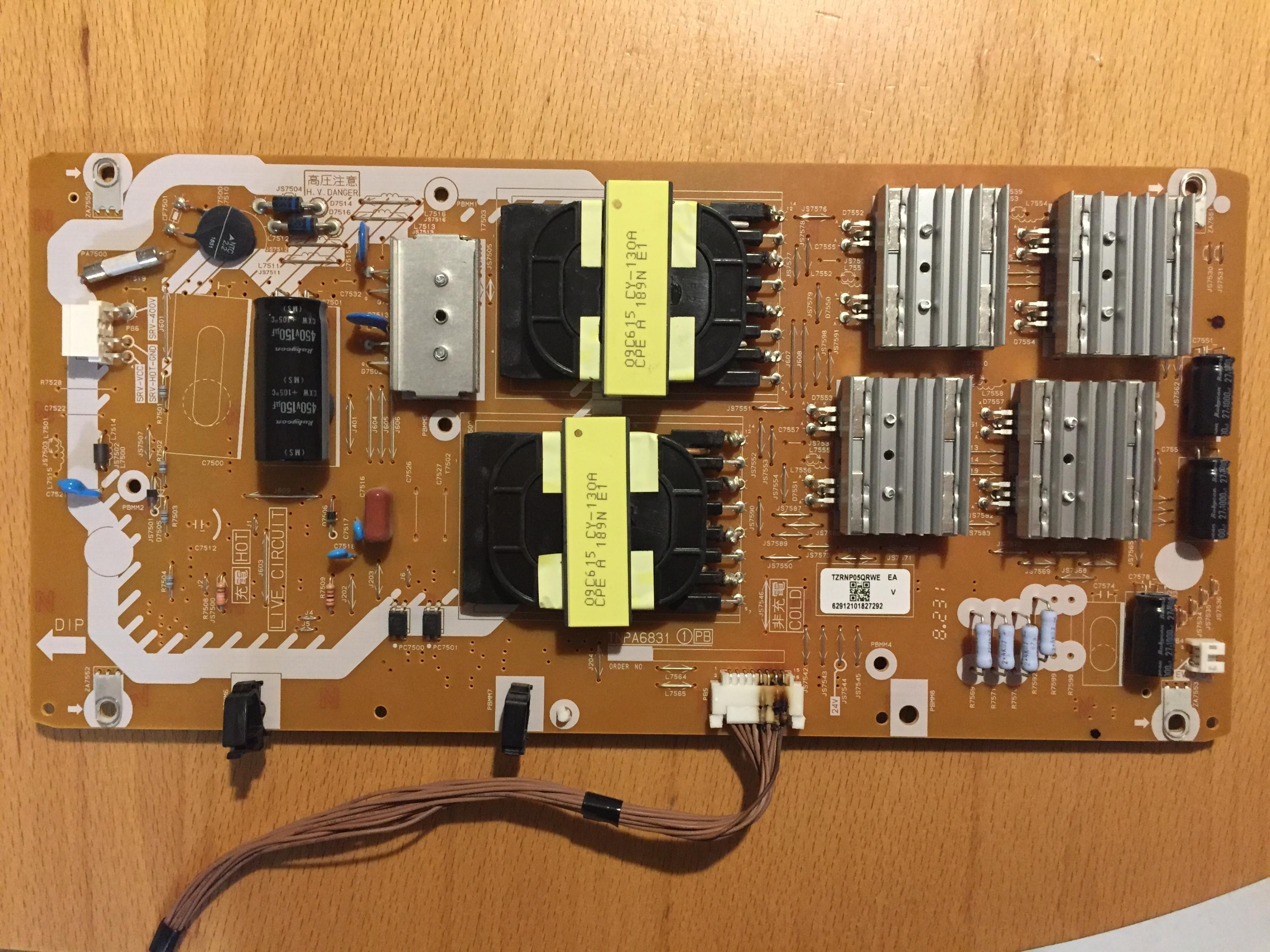

                              Here the pictures of PB-board. I add one picture showing the PCB wich has burned a little bit between 24V pins on PB5 connector and D7553. I check the D7553 diodes which have the same behavior than the others.
                              • Diah
                                • Feb 2013
                                • 6460
                                Re: Panasonic Oled TX-65FZ800E, no picture, red led blinking every 4 sec
                                okay thanks... but can you please upload focused photo closed only on the burned socket from down side we cant see the green circuit chart layout ,,, and on the top right you have one socket with one cable ist EVDD ON ?
                                • Tof
                                  • Jan 2022
                                  • 19
                                  • France

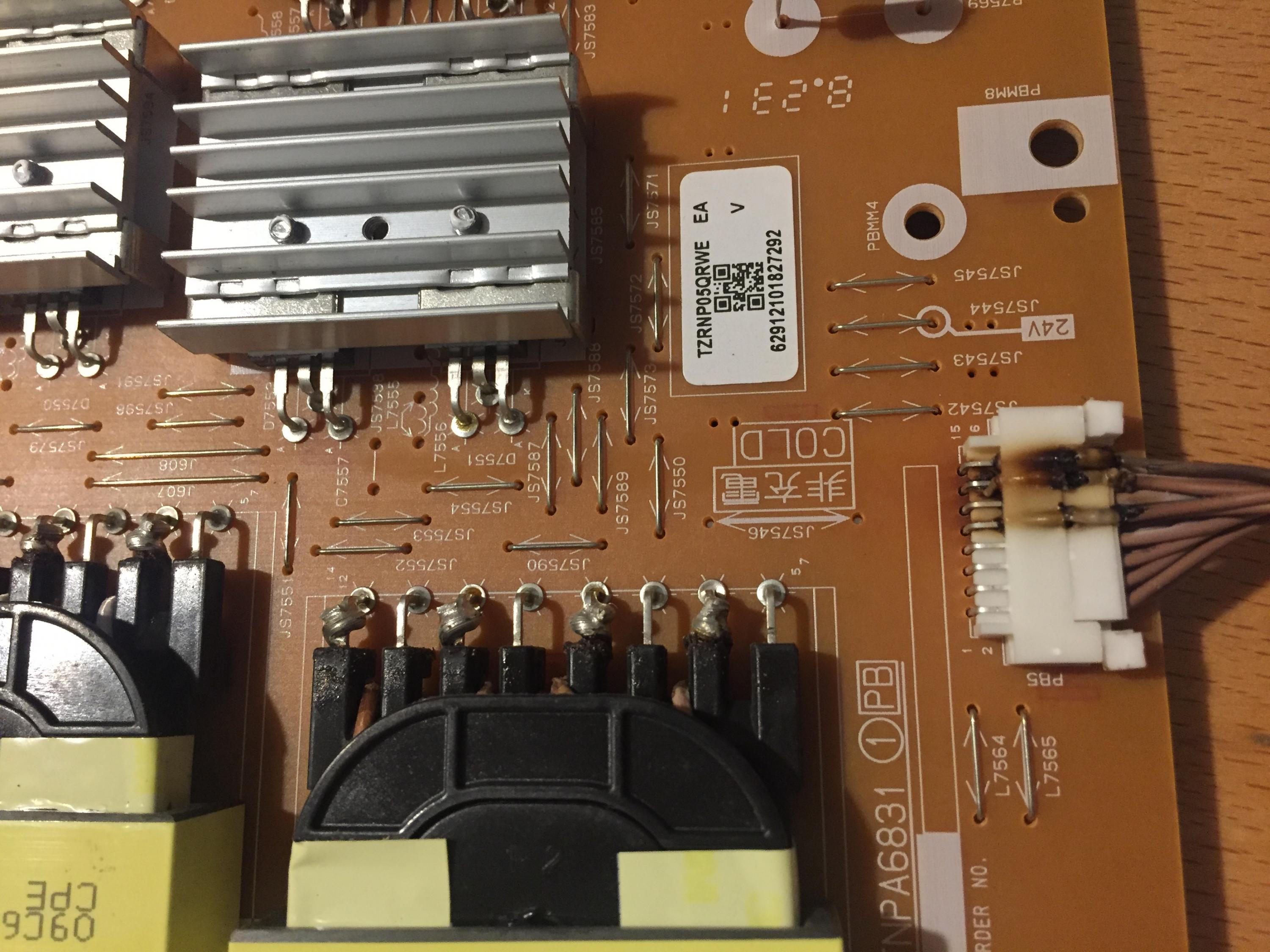

                                  Here are the pictures with a closer focus on burned socket down side and EVDD_ON socket.
                                  • Diah
                                    • Feb 2013
                                    • 6460
                                    okay thanks evdd on now confirmed.. still the socket down photo not clear to my poor eyes,,,LOL .. test with your DMM peep ton mode between the raw up 1 to 2 down , up3 to down 4 up 5 to down 6 until the end up 15 down 16 to see which are share same line
                                    then the up raw 1 -15 between them which are read one line and the down raw from 2 to 16 which are read one line.

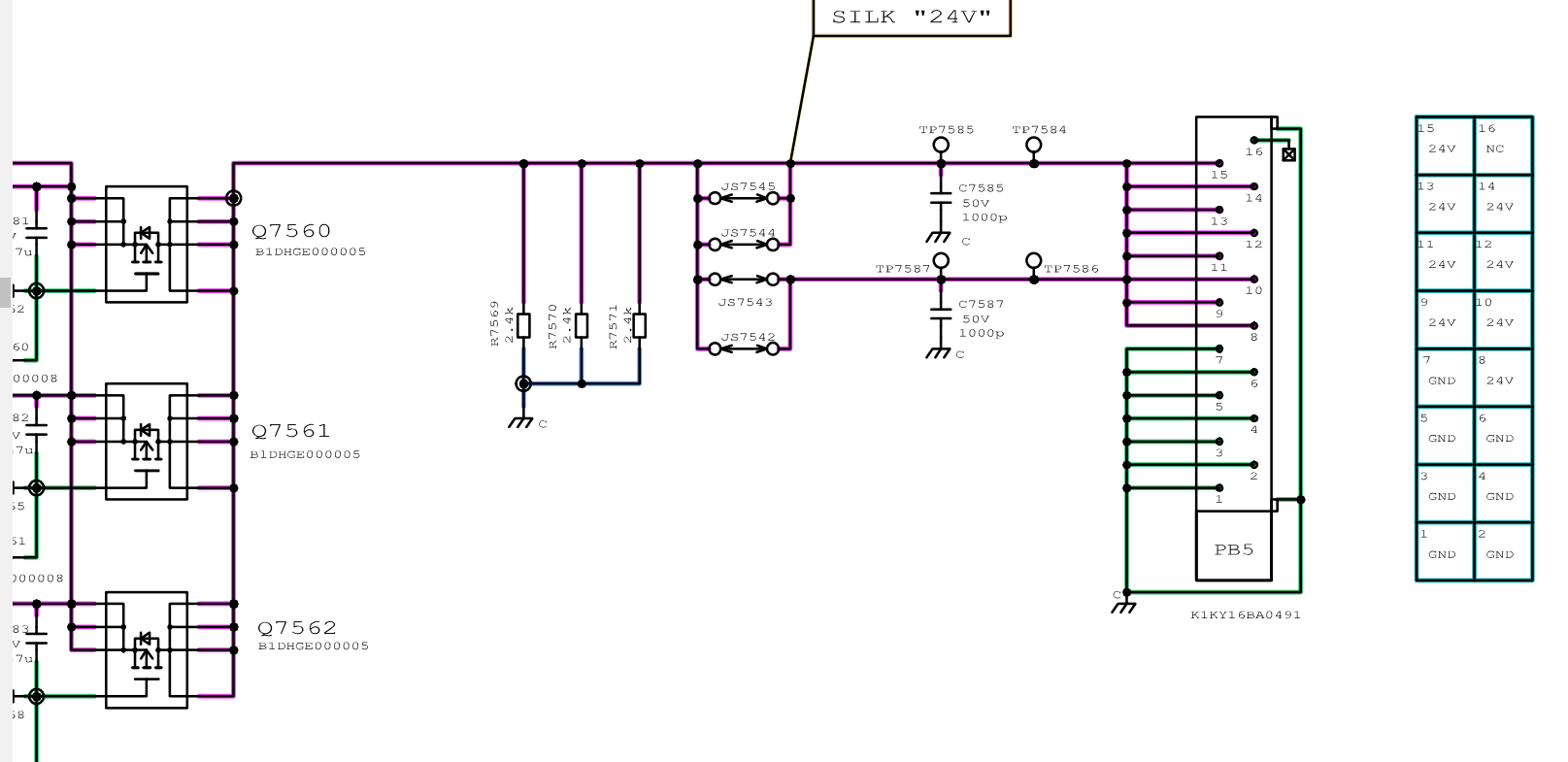

                                    • lotas
                                      • Jan 2016
                                      • 4785
                                      • Russia
                                      24v schematic
