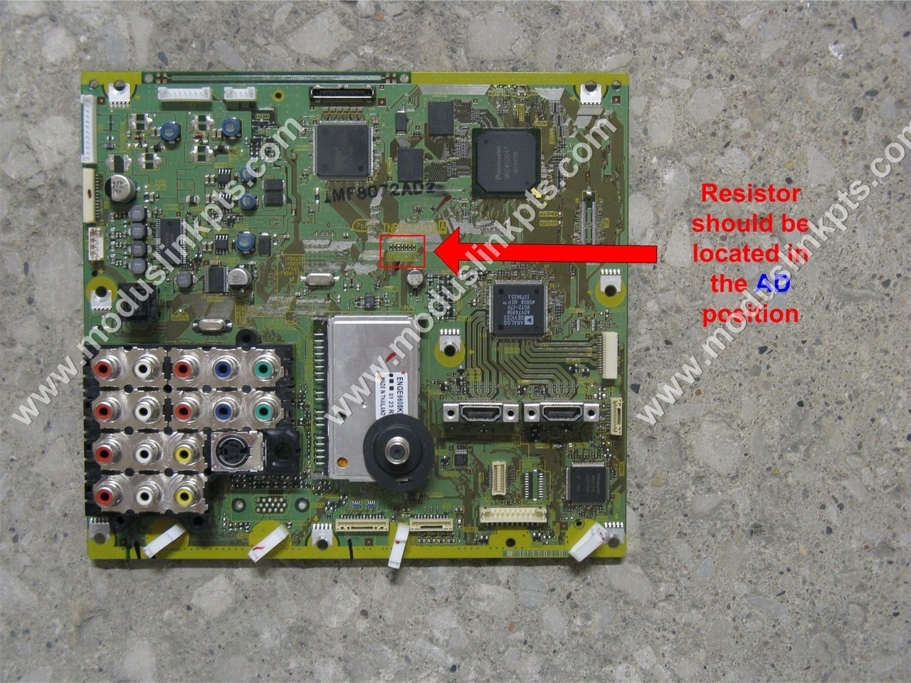

    May be your board, you'll have to check what revision is yours or post a very clear picture topside showing the area of the board where SUFFIX is and any labels or markings.
    There's also a Pz80UA with different board so check before you order something.

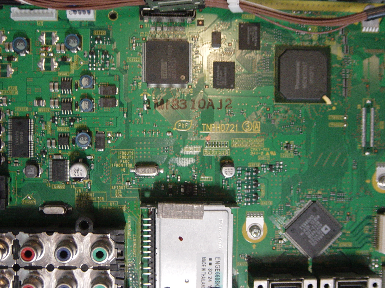

        OK I removed A5, A6 and A7 powered on and got a full white screen just as you said. I have attached pic of board and I think TNPH0721 3A is what I'm looking for. Is this correct?
        Thank you very much for the help.
        Tim

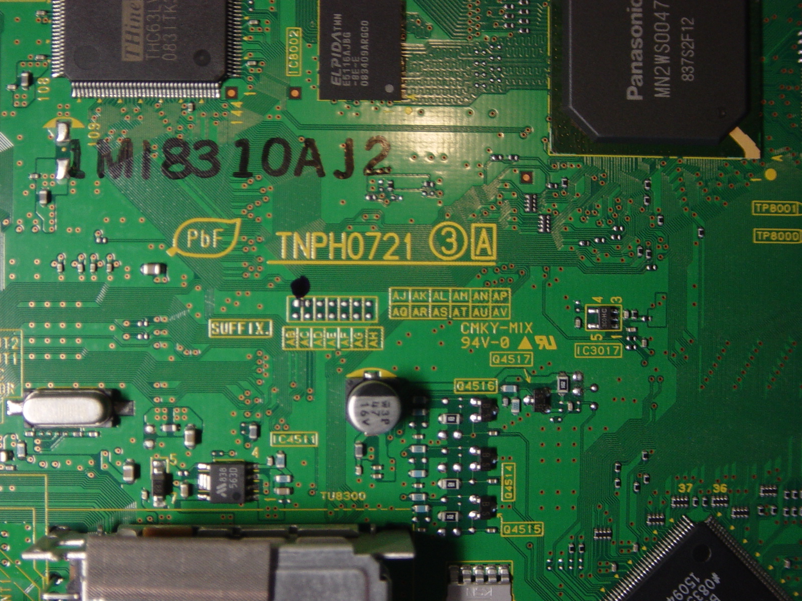

          NO,
          TNPH0721 is the main part number and under that it has a suffix matrix to work out the rev, could be AJ but we need a clearer closeup as it's blurred.
          It's a bank of jumpers they put one next to the rev letters to indicate.

            I think this is it.
              Re: Panasonic 42" plasma #42PZ80U electrical storm damage
              Suffix AJ, I think.

                yeah, TNPH0721AJ

                  It worked!! Thanks everyone
