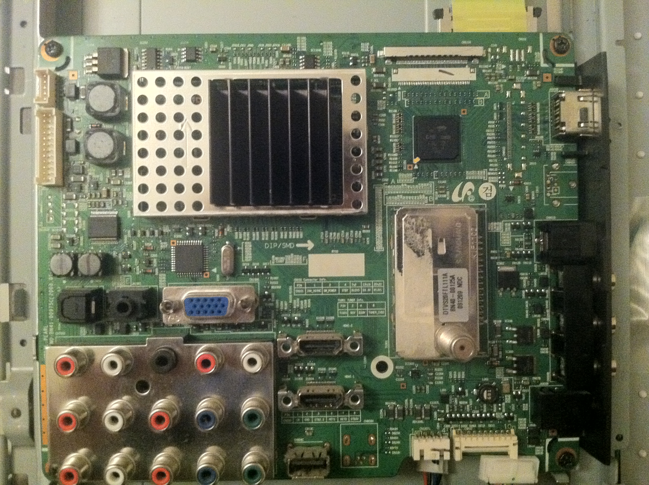

    Hello Everyone,
    I am new to this forum and the world of electronic repairs lol. My nephews tv is down and im trying to be the hero of the day.
    The tv does not not turn on and only has the standby light on. I was told before it completely shut down it use to come on and the screen would look "crazy" and make a loud high pitch screeching noise then shut off .
    So far I -
    looked at the caps none are bulging
    disconnected the tcon from motherboard and nothing
    I jumped the powersupply with pin 1-3 and 1-5 and the back lights came on and stayed on
    I read that it could be the main boards graphic card so I "Baked" the card in the oven for 8 min at 400 degrees to reflow it. after i let it cool down i put it back in and the tv came on and i went to the menu screen but then it shut off again and shortly after it turned off i heard a click for the first time as well
    Any help is much appreciated thank you.

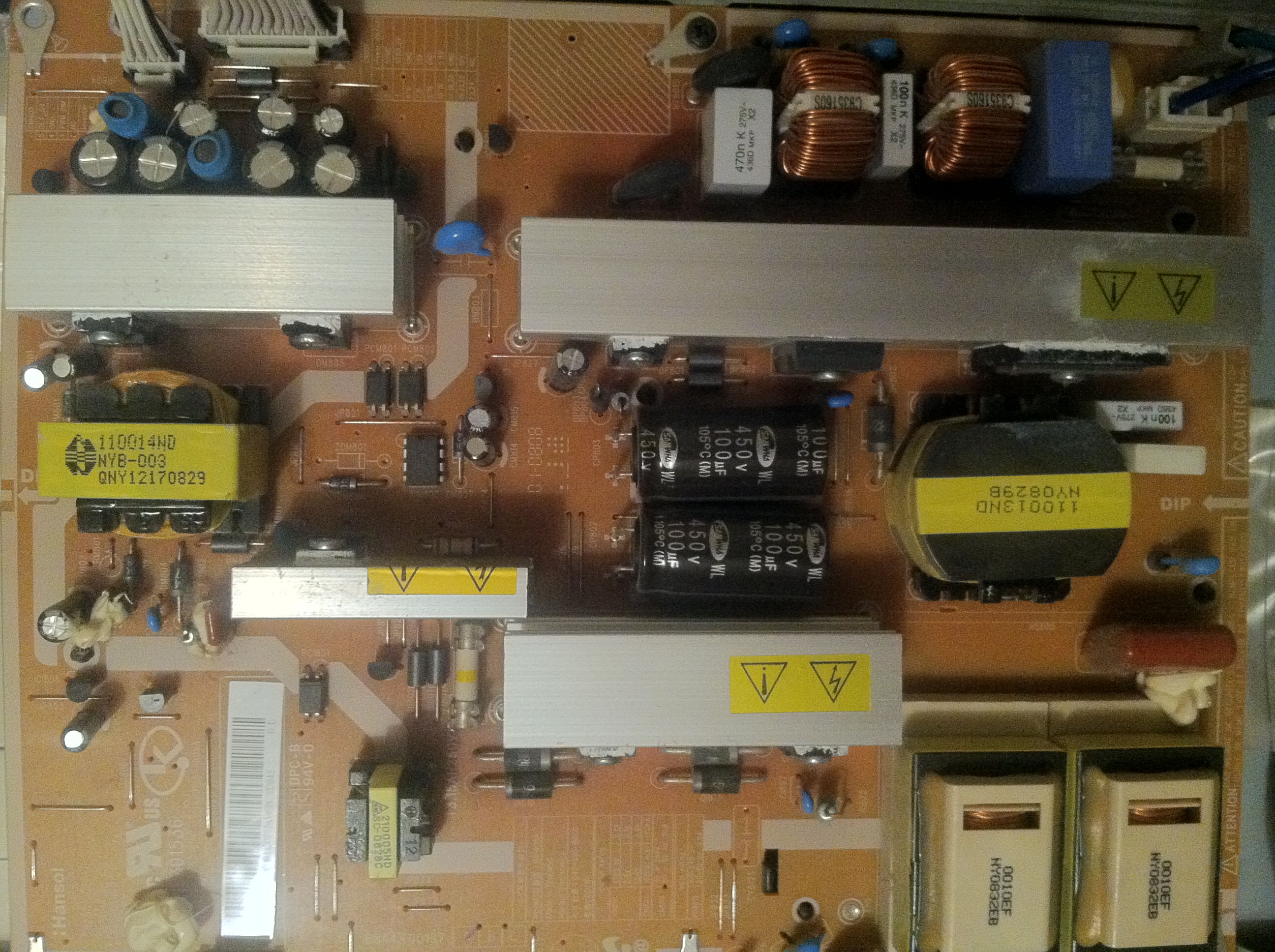

              You said that you changed the caps on the psu were yours bulging?

                2 out of the 6 1000uf caps were bleeding out of the top. I replaced them all.
                Take the back off you set and snap some photos of each of the boards as clear as you can.

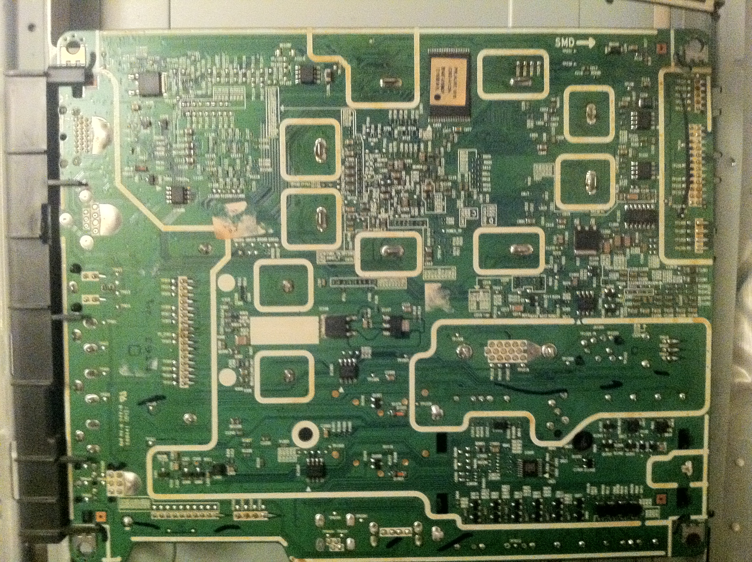

                  can you post close up photos of the main board (back and front)? Since this is LCD I'm not certain if this is the same main board such as the ones in the plasmas where there's one ceramic cap that causes the screeching problem.

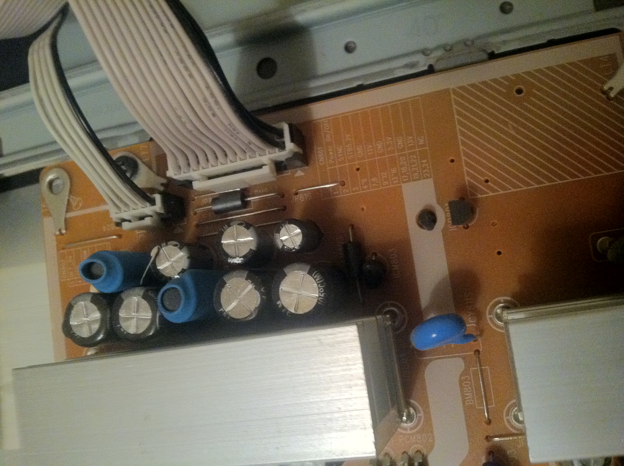

                      Okay here are the pics let me know if you need a more clear image or closer shot i added the psu as well. The sound is coming from the speakers at least what I think. It has only made the sound 2 times since i have been working on it.
                        Re: Samsung ln40a530p1fxza Loud screeching noise no screen
                        What is the power supply P/N? BN44-??????
                          bn44-00197

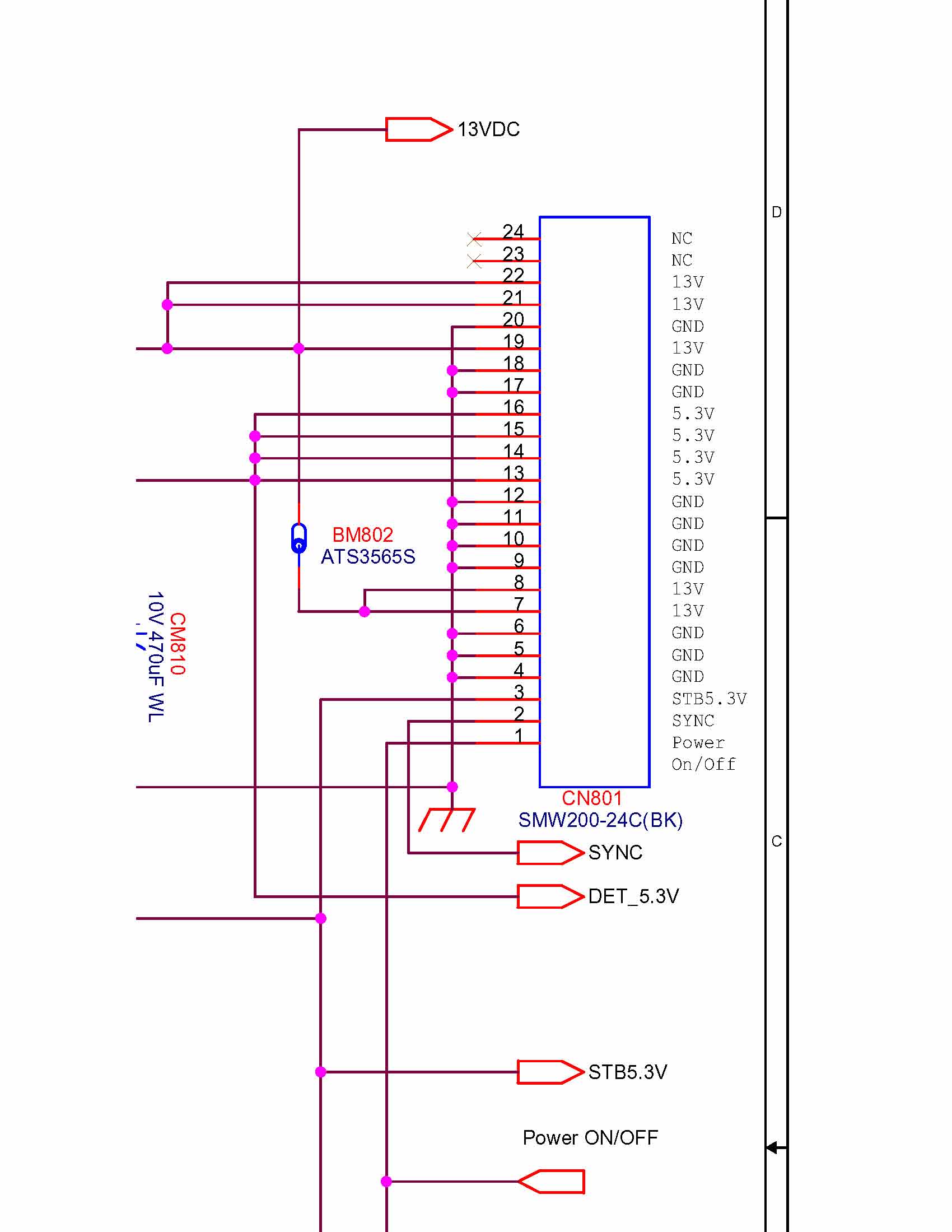

                              Is it 197A or 197B, tom66 has the diagram for your board.

                                      OK good, I download both A and B earlier. So let me look at the diagram.
                                        OK report the DC Voltage readings on each pin of CN801 when TV is OFF and when TV is ON.
                                        for example:
                                        pin 1 Power ON/OFF = xxV (OFF), xxV (ON)
                                        I believe you have main board problem.
