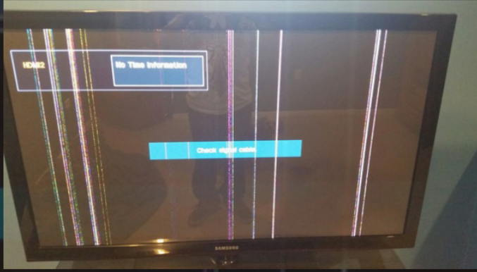

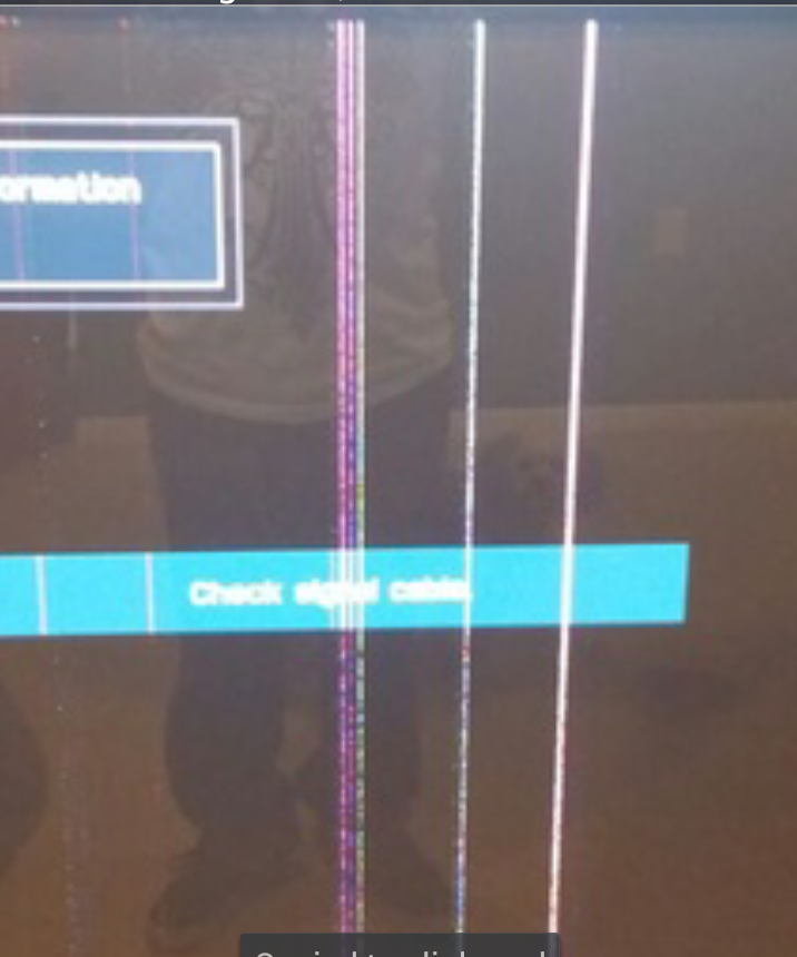

    samsung 50" PN50C450B1D vertical lines
    how are you doing guys
    should I buy this tv?
    it has vertical lines
    I believe it has something to do with the logic board
    but I haven't had time to search on this wonderful forum.
    I am in training all day today
    thanks for the help
  • freakaftr8
    • Oct 2012
    • 3743
    Re: samsung 50" PN50C450B1D vertical lines
    That unfortunately is a defective panel. It happens to these newer samsung plasma screens. It's the vertical ic's embedded in the ribbon cables giving up due to overheating and poor cooling. There's no fix. And fooling with them will only make matters worse.
    • jose6326
      • May 2013
      • 707
      thanks for the help
      I will see if the guy will give it to me for $10 bucks and I will sell the boards
      • freakaftr8
        • Oct 2012
        • 3743
        Best of luck.
