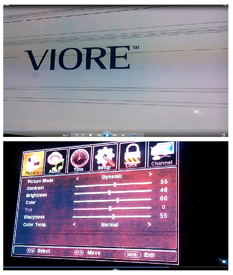

            While checking the prices for a replacement buffer board, I came across something interesting. The same boards that go in this 42PA30RQ are also for a VIORE set.. Just so happens I have a VIORE in my shop with a bad display..
            Anyways, turns out the boards are the same, but the VIORE is a 50" and the RCA is a 42..
            So, no luck there...
