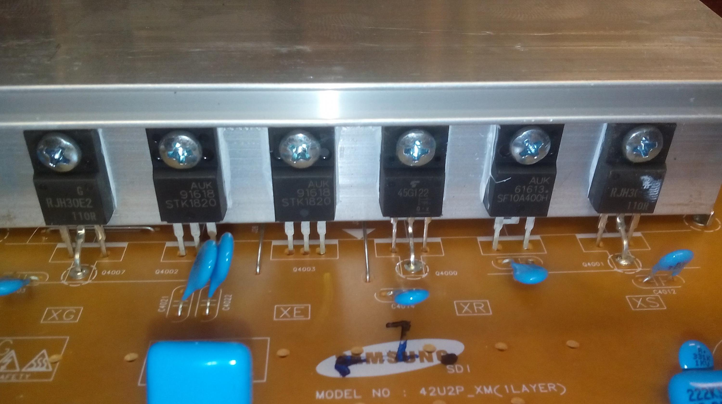

          I am going to try the X-Main first as that seems to be the culprit in the majority of those threads...

              You can try checking for shorted transistors on the xmain.

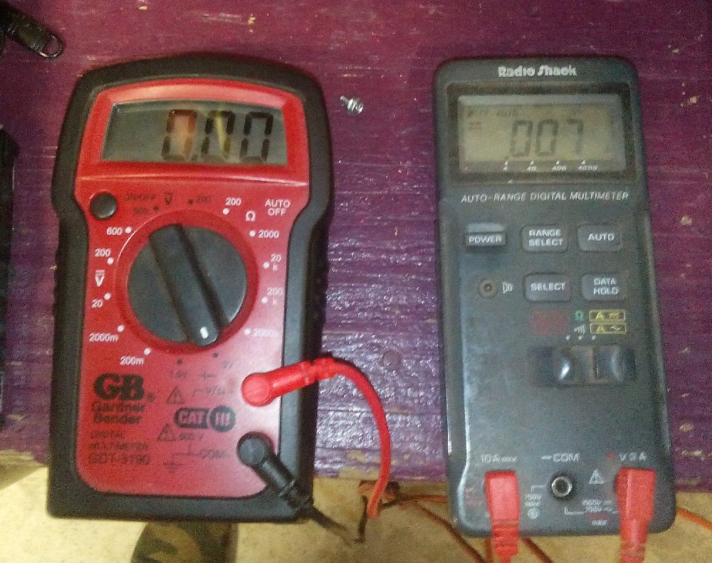

                Visually, everything looks OK...
                I don't really have the equipment (beyond a simple voltmeter) nor the expertise to troubleshoot actual boards, much to my chagrin...
                My best diagnostic tool in my inventory are my eyes and even then, it's going downhill..
                Thanx for the reply....

                  is your voltmeter a digital one?
                  • Michale32086
                    • Nov 2011
                    • 1453
                    Re: RCA 42PA30RQ Playing The 'Let's Swap PCBs' Game
                    "He CAN be taught!!!"
                    -Genie, ALLADIN
                    http://www.wikihow.com/Test-a-Transistor
                    • Michale32086
                      • Nov 2011
                      • 1453
                      Yea...

                        In this case it's more appropriate to test a MOSFET or IGBT, these devices are slightly different. (High power semiconductors.)
