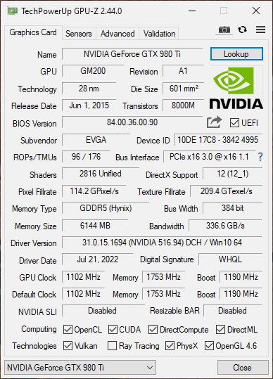

    I have a problem with an EVGA GTX 980 TI,
    I have a problem with an EVGA GTX 980 TI it displays a black screen when starting a game on the menu for example either in HDMI OR DISPLAY PORT.
    The basic problem is that the card does not boot, the FDMF 6823A mosfet shorts internally on the 12V line and I also changed an original one and now the card boots.
    Driver installation OK
    Detection of the card OK
    No black screen on the desktop
    No short circuit on the GPU
    All voltages stable
    The problem is when starting a game, black screen with the game sound in the background.
    The problem seems to happen at a higher current demand on the gpu.
    The card doesn't shut down and when I turn it back on the desktop is displayed.
    Work done
    - Changed again the controller by an original FDMF 6823A always black screen when starting a game (Value 6 Kohm on the 12 Volts seems ok), ohm test on the two internal mosfets at the gate ok about 30 Kohm) of the controller
    - Flash bios by a new version always black screen in game.
    What would be the cause ?
    Is it a bad soldering of the FDMF 6823A?
    What else should I check?
    Many thanks to you =D =D
    Translated with www.DeepL.com/Translator (free version)
  • fab13
    • Dec 2021
    • 109
    • France
    Re: EVGA GTX 980 TI black screen when launching a game - Why?

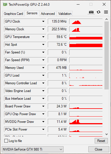

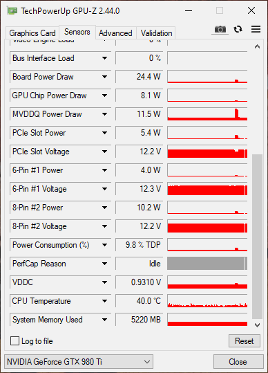

    See on GPUZ monitor everything seems detected
    1) GPU clock and well at 1102 mhz stable from the start of a game
    2) No code 43 in device manager
    What I just tried:
    Revert to old bios still same problem
    New 27 mhz crystal oscillator still same problem.
    I don't know what to do ^^

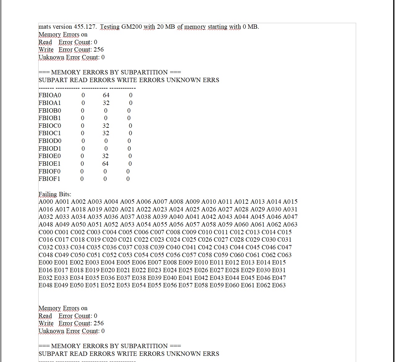

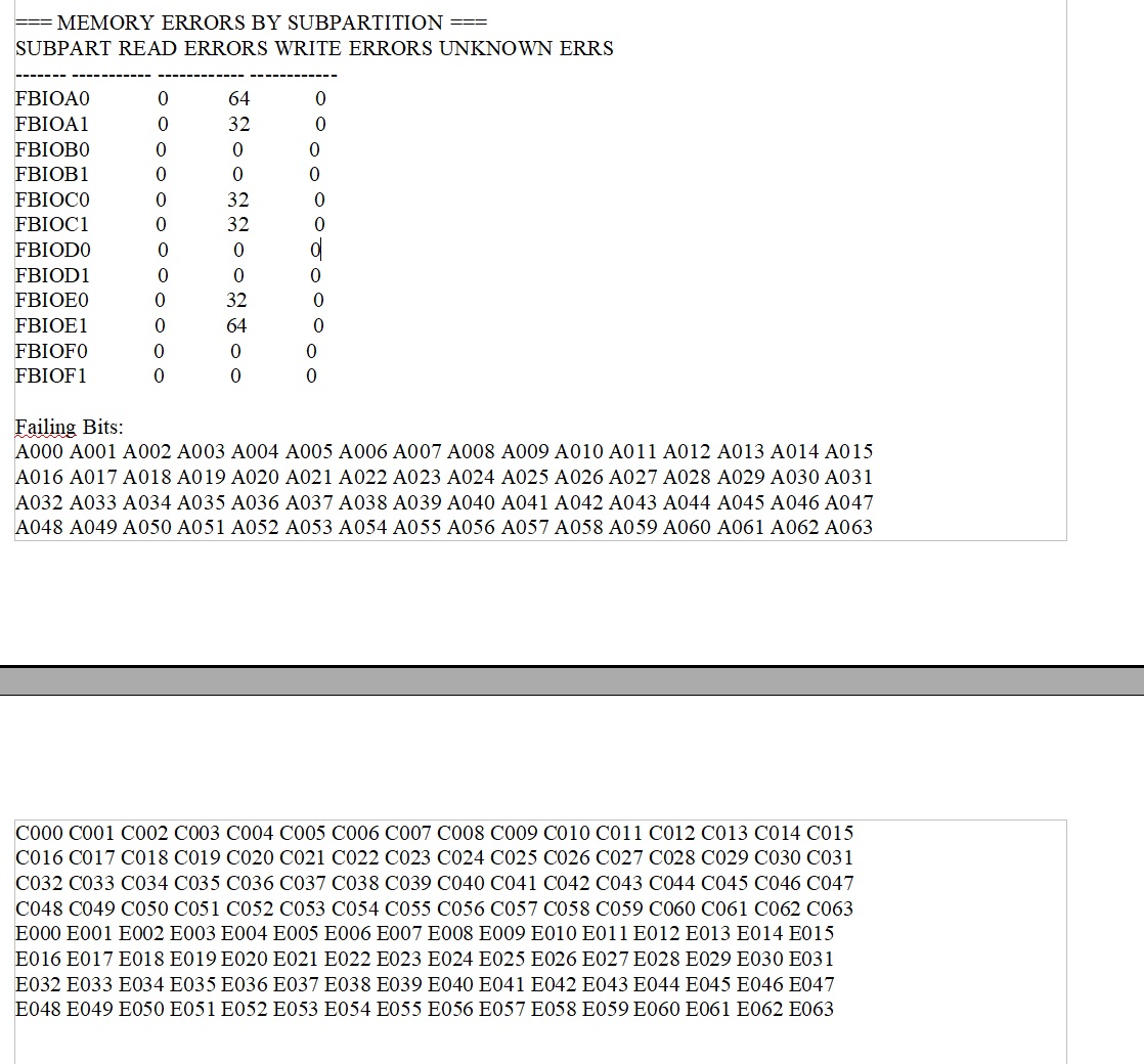

          Test Mats some slight errors not exceeding 64 ? The numbers are low?
          I am lost, my resources are empty

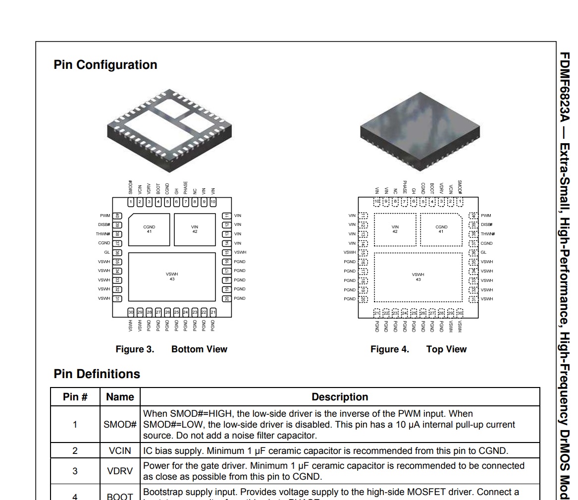

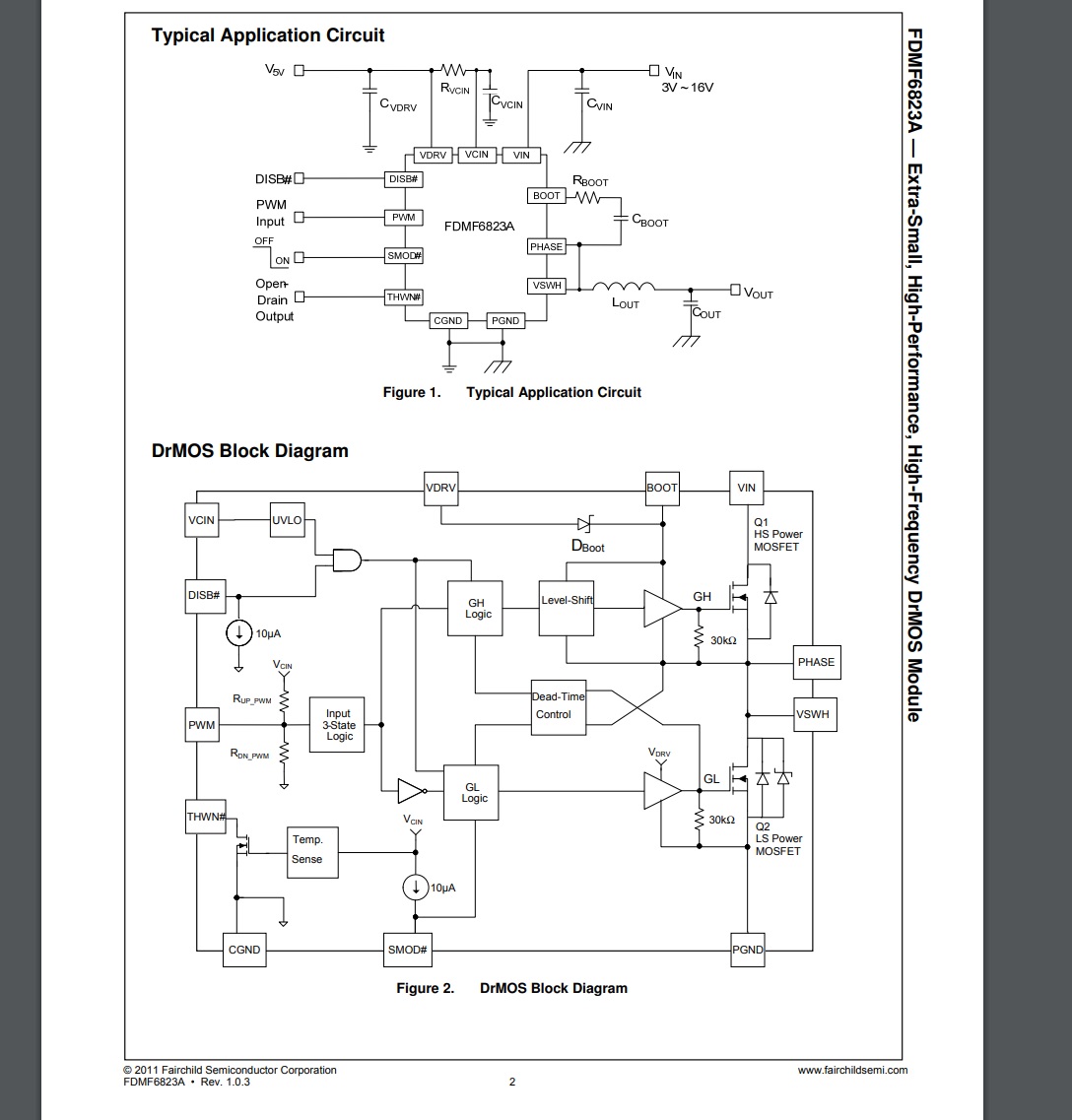

              Here are the measurements for each phase on the FDMF6823A dual mosfet controllers.
              All are approximately equal
              1 SMOD# = 300 Kohm / 0.7V diode mode
              2 Vcin= 1.7 k / 0.4V
              3 VDRV = 1.68 K / 0.45V
              4 Boot = Between 290 Kohm and 378 Kohm / 0.48V
              5 = Ground
              6 Gate Hight = Between 30 Kohm and 35K / 0.427 V
              7 PH = 2.4 ohm to GPU coil
              8 = NC
              9 to 14 = VIN = 12 Volts ok
              15 VSWH = 2.3 Ohm also goes to GPU coil
              16 to 28 = Ground
              29 and 35 = VSWH = 2.3 Ohm
              36 Gate Low = 30 Kohm / 0.427 V
              37 Ground
              38 THWN (Thermal warning flag) = No value
              39 Disb = between 290 kohm and 99 k
              40 PWM = between 6.2 Kohm and 7 Kohm = 0.427 V
              What is strange is that the first FDMF6823A row 1 on VIN pin 9 to 14 shows me no value in KOhm, Mohm, Ohm
