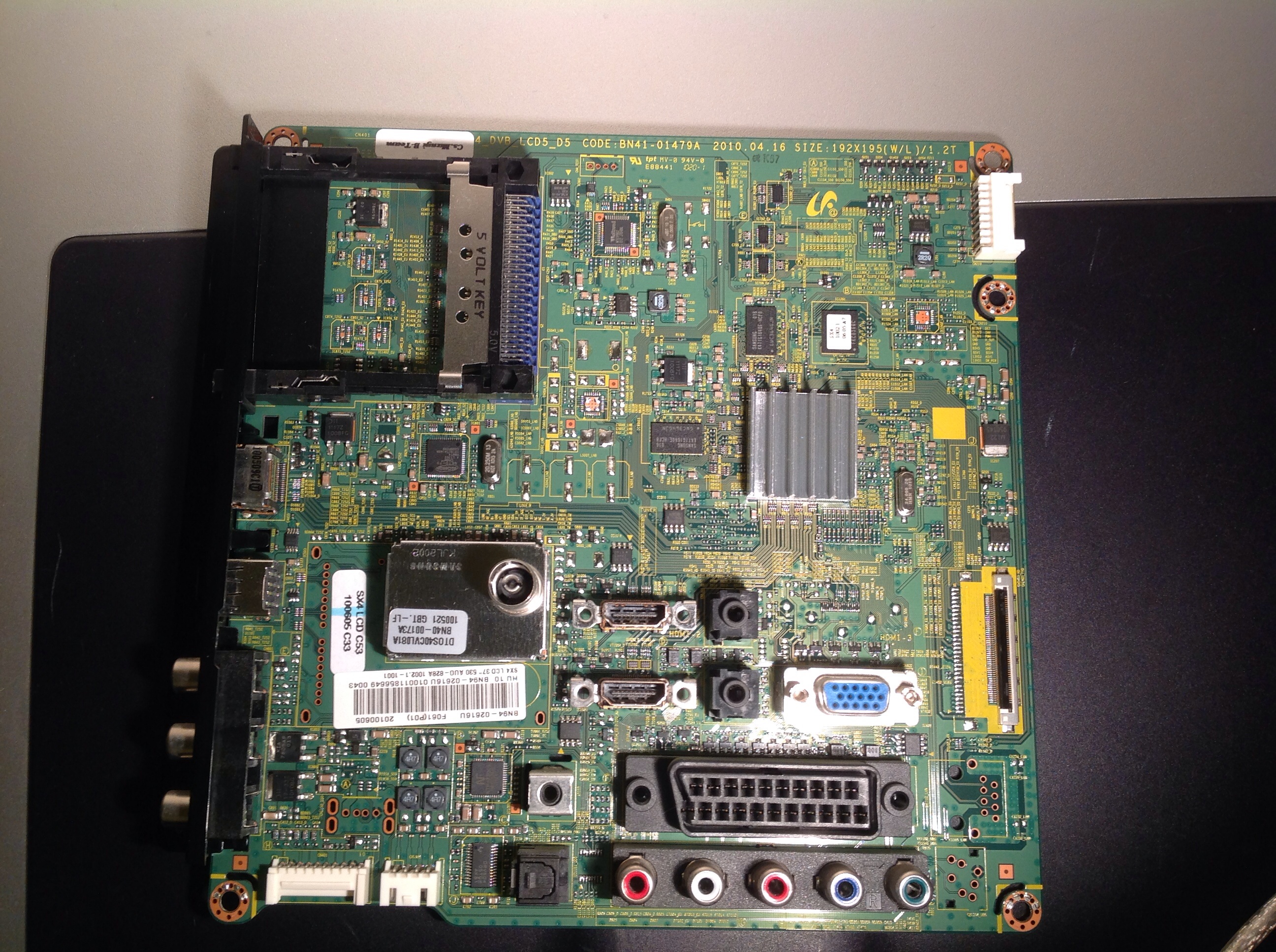

                    It seems more likely that you have a bad main board. Extremely common on c series Samsung

                        Did you try heating main board gently with a hairdryer.
                        Post a good clear picture front and back and we might spot something.
                        Instead of unplugging the main board to get the lights on try keeping the main board connected but detach the lvds
                          Re: Samsung le32c530f1w not switching on
                          "Ok, how would I know for sure if the main board is indeed faulty?" Because the backlights do come on when the cable between the Power supply and the main board is disconnected, the main board is keeping the bl_on (invr on/off) LOW.

                            I tried the heating both boards with a heatgun on low setting for about 30 second but still no sign on life. I have attached images of the main board as requested. I personally so not see any obvious signs of anything wrong with the main board.
                            I did some more observations and here's a summary of my findings...
                            When the TV is on standby, the capacitor does not buzz
                            When the TV is attempting to power up, the capacitor buzzes
                            With the main board disconnected but IVD board connected, the backlight comes on and the capacitor stops buzzing
                            The capacitor buzzes even when the inverter driver board is disconnected.
                            With both boards disconnected, upon plugging the power lead in, the capacitor still buzzes.

                                  Just an update to say that I've replaced the AV board and the set is now working. Indeed the power supply wasn't the issue.
                                  I'm still keen to find out what may have caused the AV board to fail as you claim that it is common for the Samsung C series.

                                        just thought id update this, the problem is the EEPROM ic402 on the mainboard.
                                        they need to be preprogrammed, Ohmsupplies sell them.
