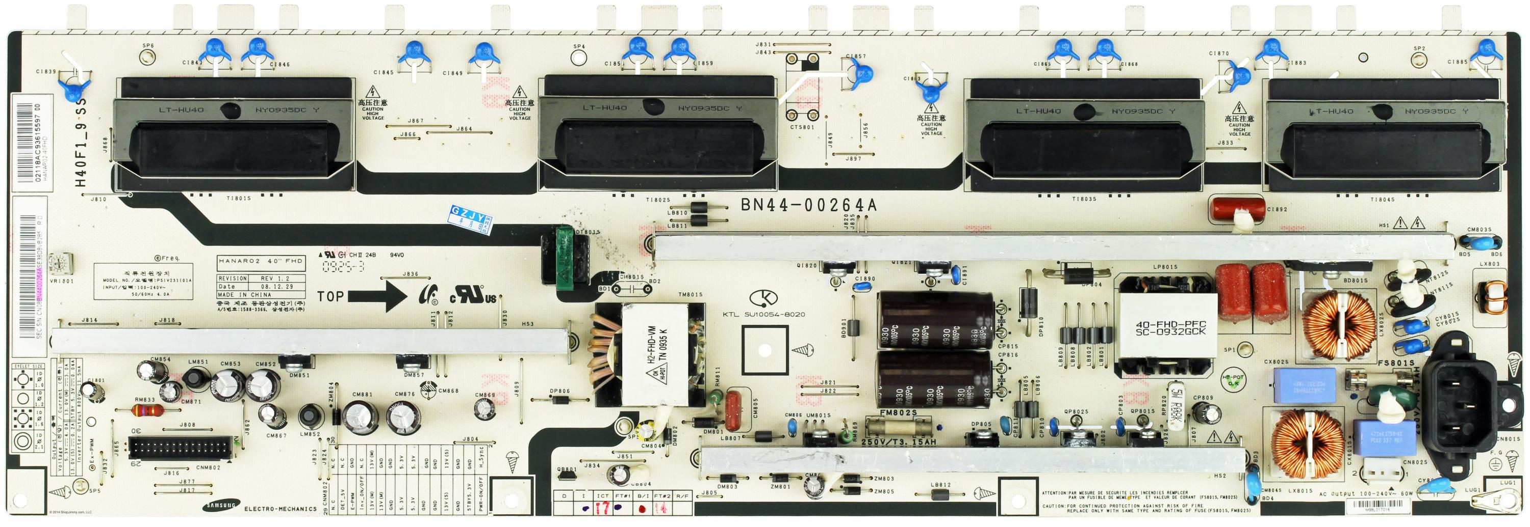

    I have a Samsung LN40B630N1FUZA that was manufactured in February 2010 and purchased in April 2010. The TV was not used heavily the past four years and was recently unplugged (several hours after being powered down) before we went on a vacation. When we returned the TV was plugged back in and attempted to be used the next day. The TV powers on, I hear the startup sound, but get no picture and no OSD when the MENU button is pressed on the remote. If I play a DVD or use another input, I can hear sound and see a faint, clear picture if I shine a very bright flashlight close to the screen. I have not been able to get any decent estimates to repair the TV, so when I found this forum I decided to try some of the items I had found for this specific model.

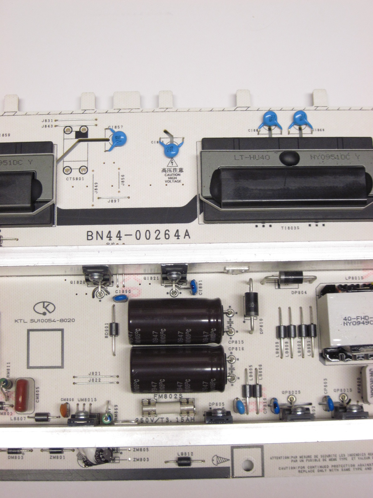

    I removed the back cover and the Power/Inverter board (BN44-00264A) for inspection. I found no burnt traces, no bulged caps, the two fuses (FS801 and FS802) checked okay and I obtained the following readings (taken with a Fluke 23III DVOM on Ohms Auto-Range) when going across the Bridge Rectifier (as seen in another thread) -

    If anyone has any ideas how to isolate a component failure on this board, or determine if the Logic Board or T-Con Board is the issue, I would greatly appreciate the help. I have access to a DVOM, soldering iron, etc., but no scope. I can read the wiring schematic for the board and know what most of the symbols mean, but do not have enough knowledge to develop a troubleshooting method. Thanks in advance for anything you can provide!

    Thank you for such clear photos!
    Can you try checking the voltage across one of the 450V capacitors on the power supply with the TV switched on? You should get about 390V.

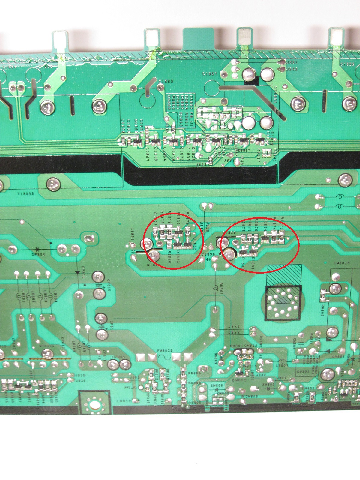

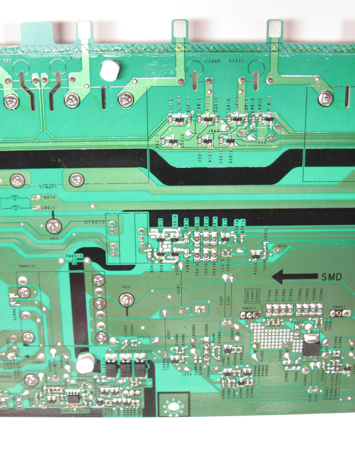

              Try checking these resistors to see if any of them are out of spec.

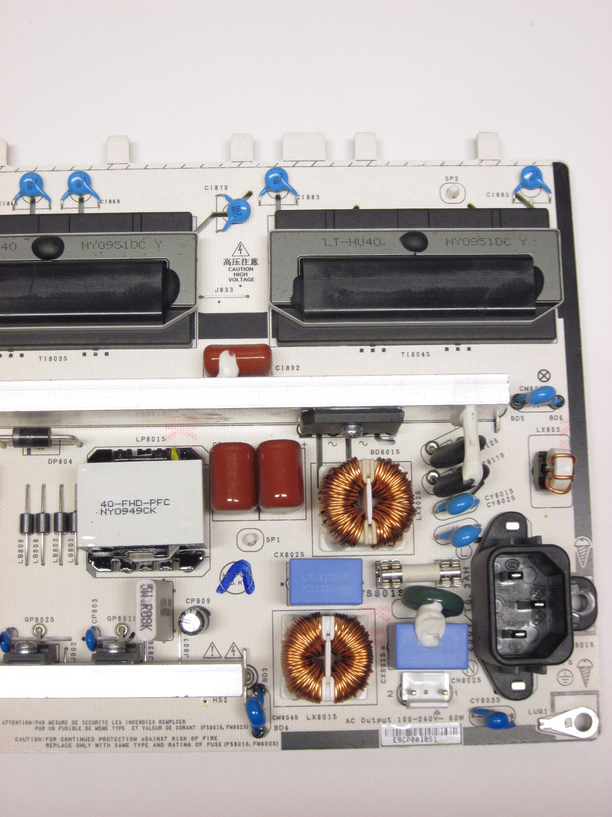

                  Here are good pictures from Shopjimmy, and the SCH from TOM.
                  Check the cap CI892, the voltage (negative of the probe on the negative leg of the main filter cap for primary side circuit ground ref. point on those points.

                      I will make the rest of the checks recommended later this evening. Bud - I really appreciate the help. Can you clarify the test you are wanting me to perform? I reviewed the redline diagram you attached, but am not 100% clear.
                        Re: Samsung LN40B630N1FUZA - Backlight Inop
                        I will give you the details this evening.
                          Resistor Spec Measurement
                          RI870 68 68.6
                          RI871 56 56.6
                          RI872 30K 25.4K
                          RI873 470 234.6 (parallels RI874)
                          RI874 470 234.7
                          RI875 68 68.1
                          RI876 56 56.2
                          RI877 30K 29.9K
                          RI878 470 234.2 (parallels with RI879)
                          RI879 470 234.1
                          I'm kind of concerned with RI872 as I am guessing it is a 1% or less tolerance resistor and does not match the corresponding resistor (RI877) in what appears to be a "twin" circuit, where I would expect all readings to be nearly the same. Thoughts?
                              Those readings look good, I was expecting one to be open circuit or very high resistance.

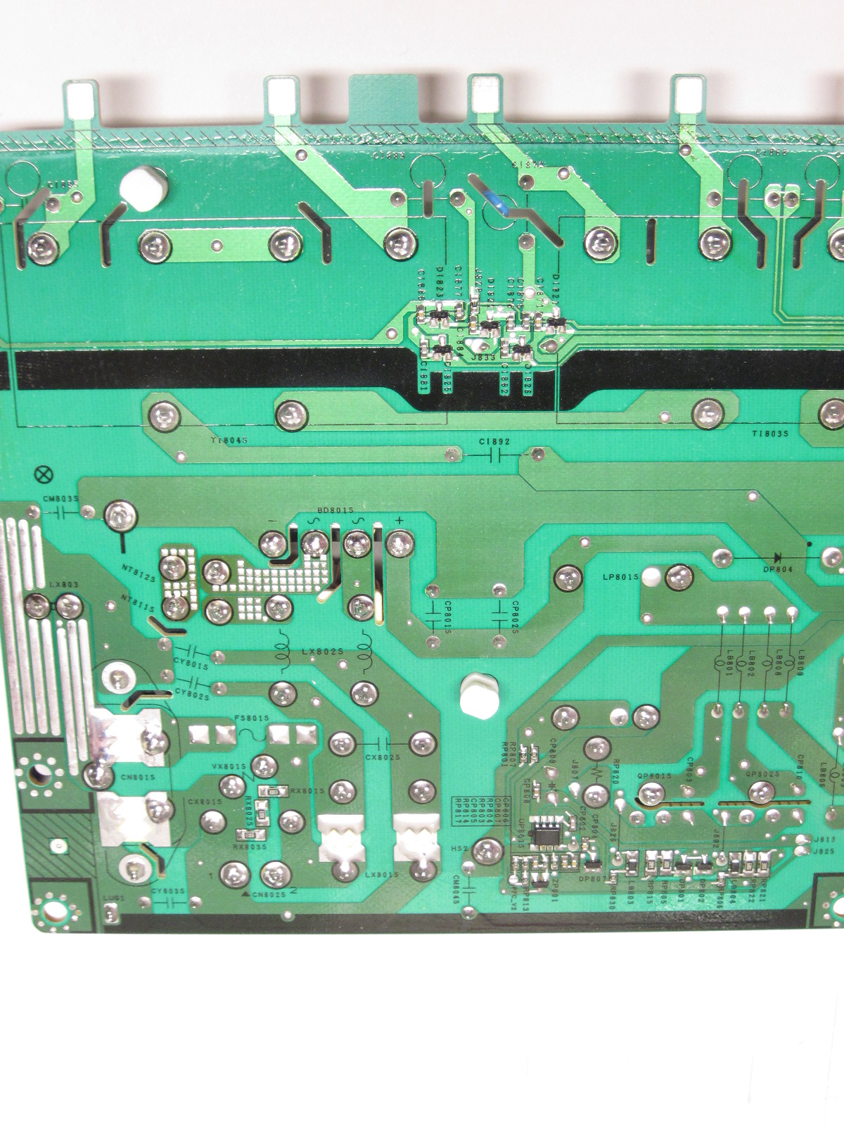

                                  Looks like a replacement board is not available for this thing after my searches without significant lead times. It would be nice to find the offending component and replace it, but at what time do I stop testing and order the board in hopes of getting one? Is everyone pretty sure this is in the Power/Inverter board, or are there still possibilities for the T-Con or Logic boards? If there was some sort of procedure I could use to eliminate them, it might make sense to do that and then order the Power/Inverter board before they become harder to find. I don't want to give up on this though. Thoughts?

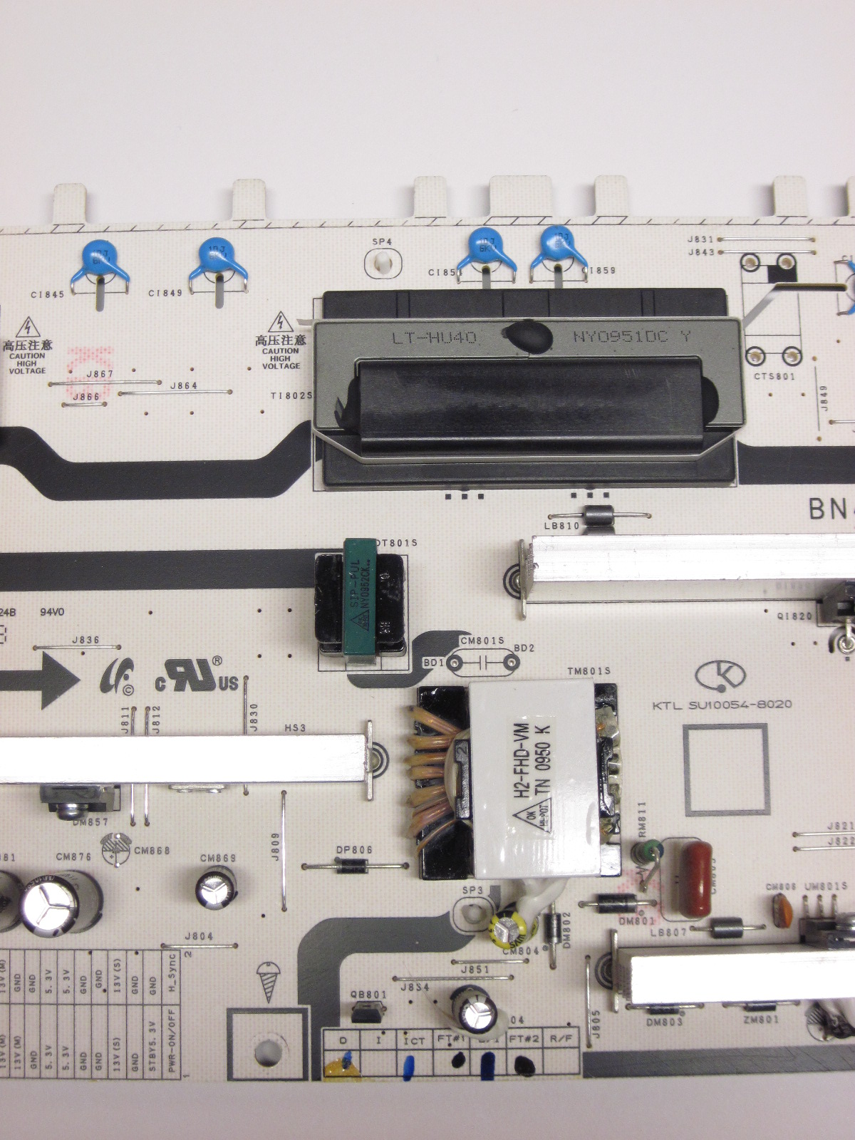

                                    The problem is definitely in the power/inverter board. I had the same model and board with the same problem, and it turned out to be in the general area I circled and found an open resistor. Try testing the transistors there also.
                                      UPDATE - I finally found a fairly cost effective Power/Inverter board on the internet and ordered it late last week. It arrived today and I installed it. TV is working perfectly now (and has for several hours). I am now going to try and take a closer look at this board and see if I can find anything wrong with it. Does anyone know if there is anyone who buys these boards to refurbish them? It would be nice if I could get some money back from it and help someone else out as it looks like these boards are getting hard to come by now. Thanks to everyone for their help!
