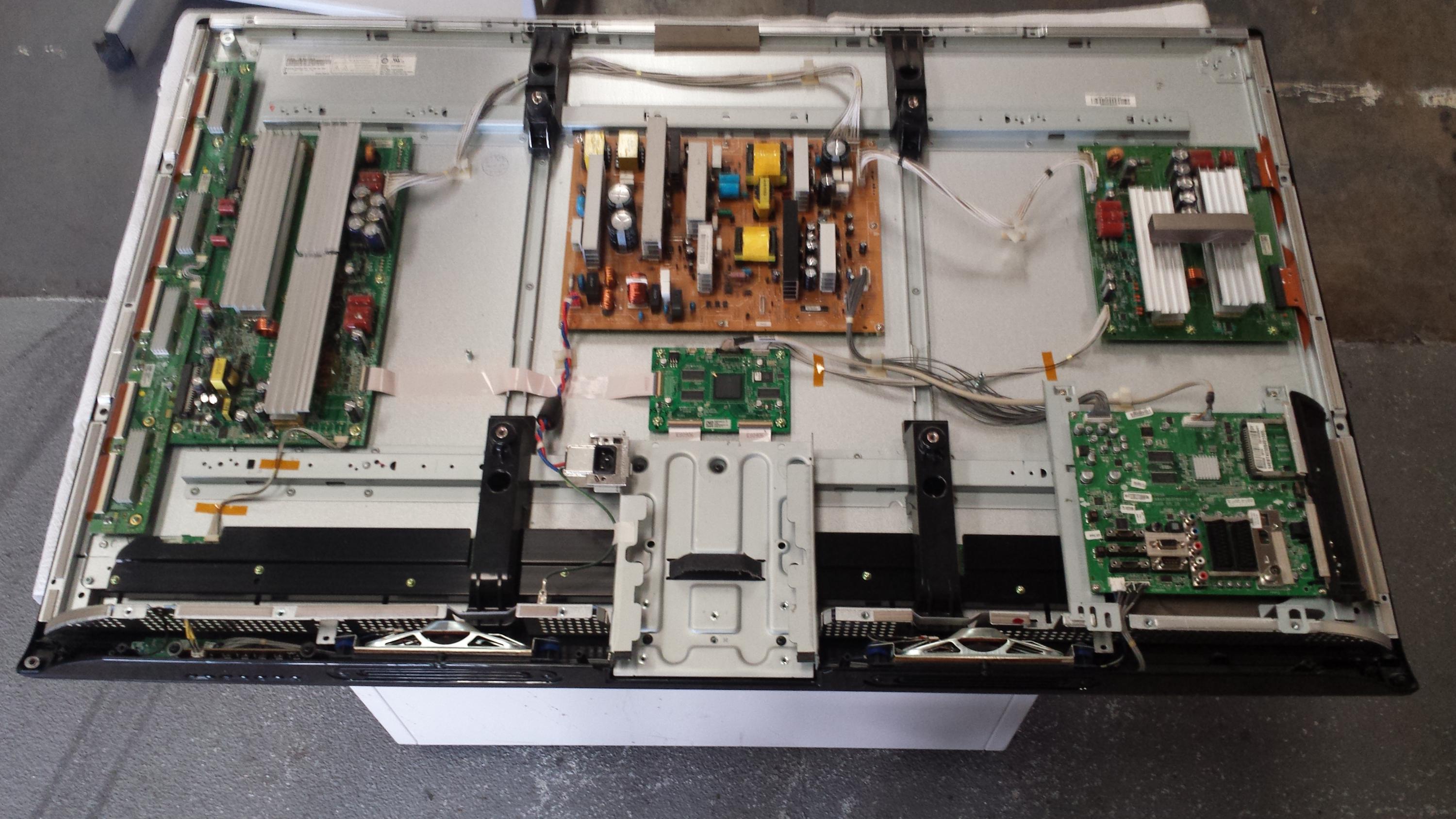

                          Re: Faulty lg 50pg3000
                          Hi Tom
                          Here is a pic of the back of the TV which part am I to look at?
                          Thank you
                          • scootmansfield
                            • Jul 2014
                            • 28
                            Hi Tom
                            https://www.dropbox.com/s/1c7xzjjvzy...716_161313.jpg
                            Thank you
                              I can't see either of those files. Try uploading them to this site directly using the Manage Attachments feature, or use a service like imgur.

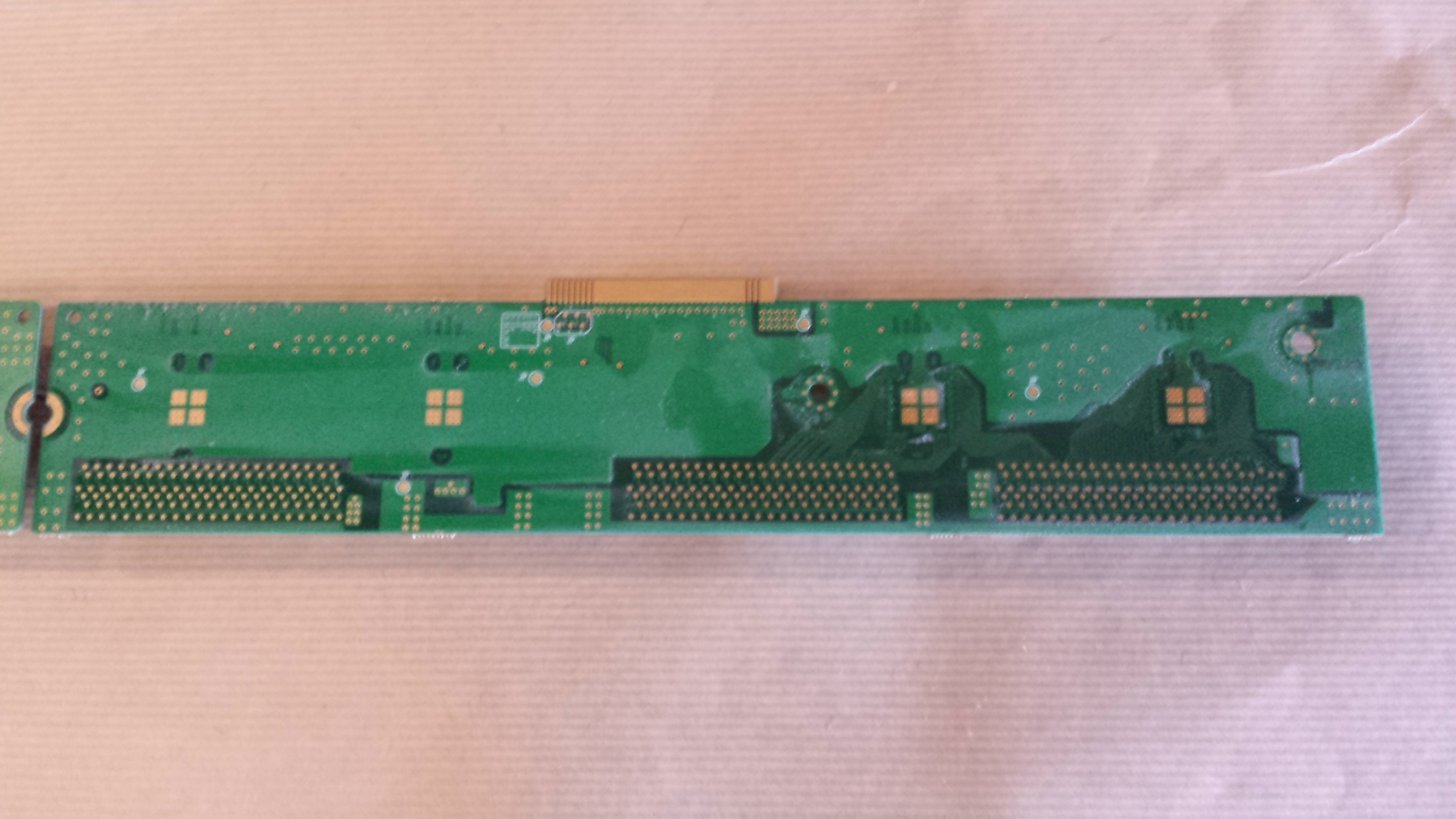

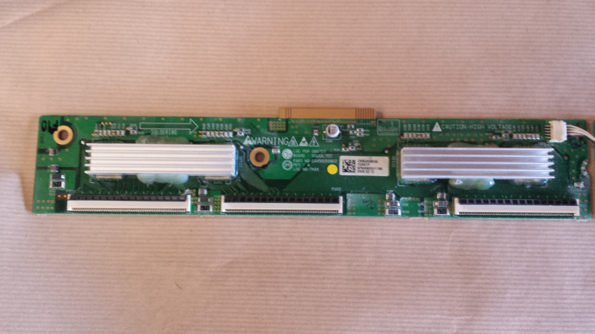

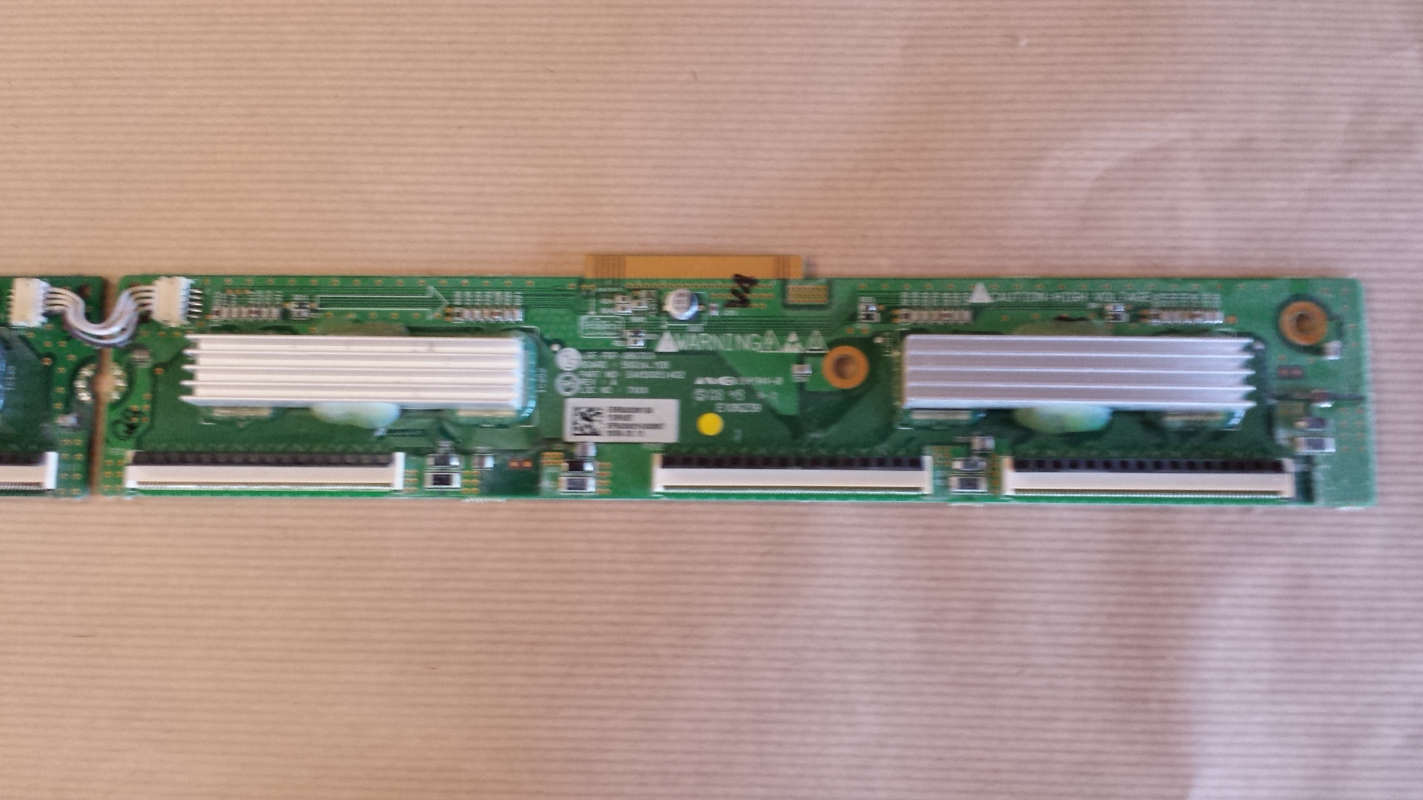

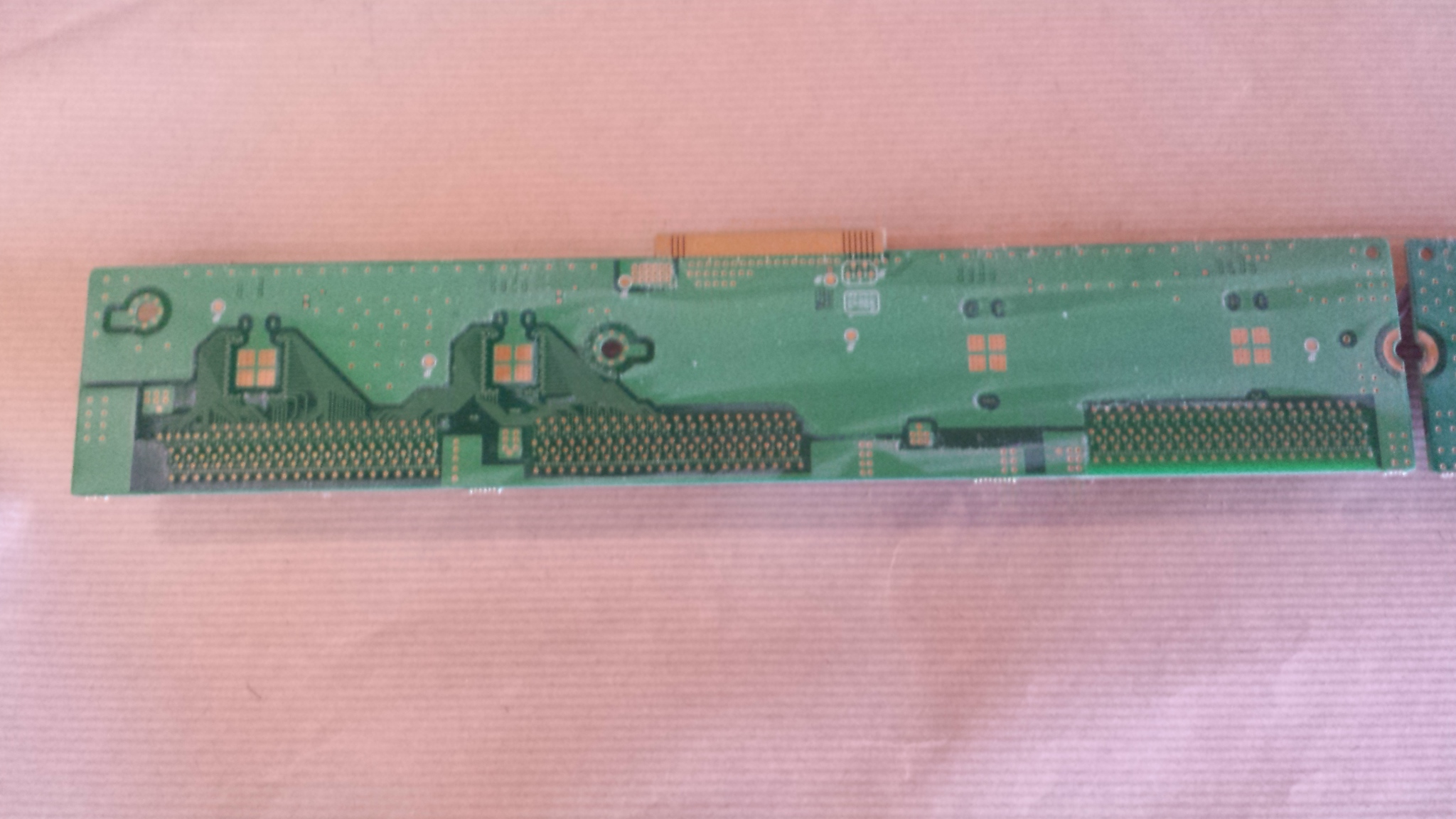

                                  I AM GATHERING IT IS THIS PART?
                                  http://www.ebay.co.uk/itm/Y-SUS-BOAR...item259166987c
                                  • scootmansfield
                                    • Jul 2014
                                    • 28
                                    Tom
                                    I took off the part like you said and checked the part number on ebay and it came up with
                                    http://www.ebay.co.uk/itm/T-V-LG-YSU...item3f3866d1c2
                                    £74.50 so good advice LOL
                                    You mentioned earlier about testing it to make sure it is definitely that could you please let me know what I have to do?
                                    Many thanks
                                      That's actually the Y-sustain. In your case, you will need to replace the top Y-buffer board. If you like this can be tested for short circuits.
                                      To test, remove the top Y-buffer. It connects to the Y-sustain. You can see orange ribbons going into it. You'll need to unclip these to take out the board. (Be very careful! If you damage them they can't be replaced as they are bonded to the plasma panel.) Then -- A picture of the board and I will highlight where to test.
                                      • scootmansfield
                                        • Jul 2014
                                        • 28
                                        Morning Tom pics included I really appreciate this!
