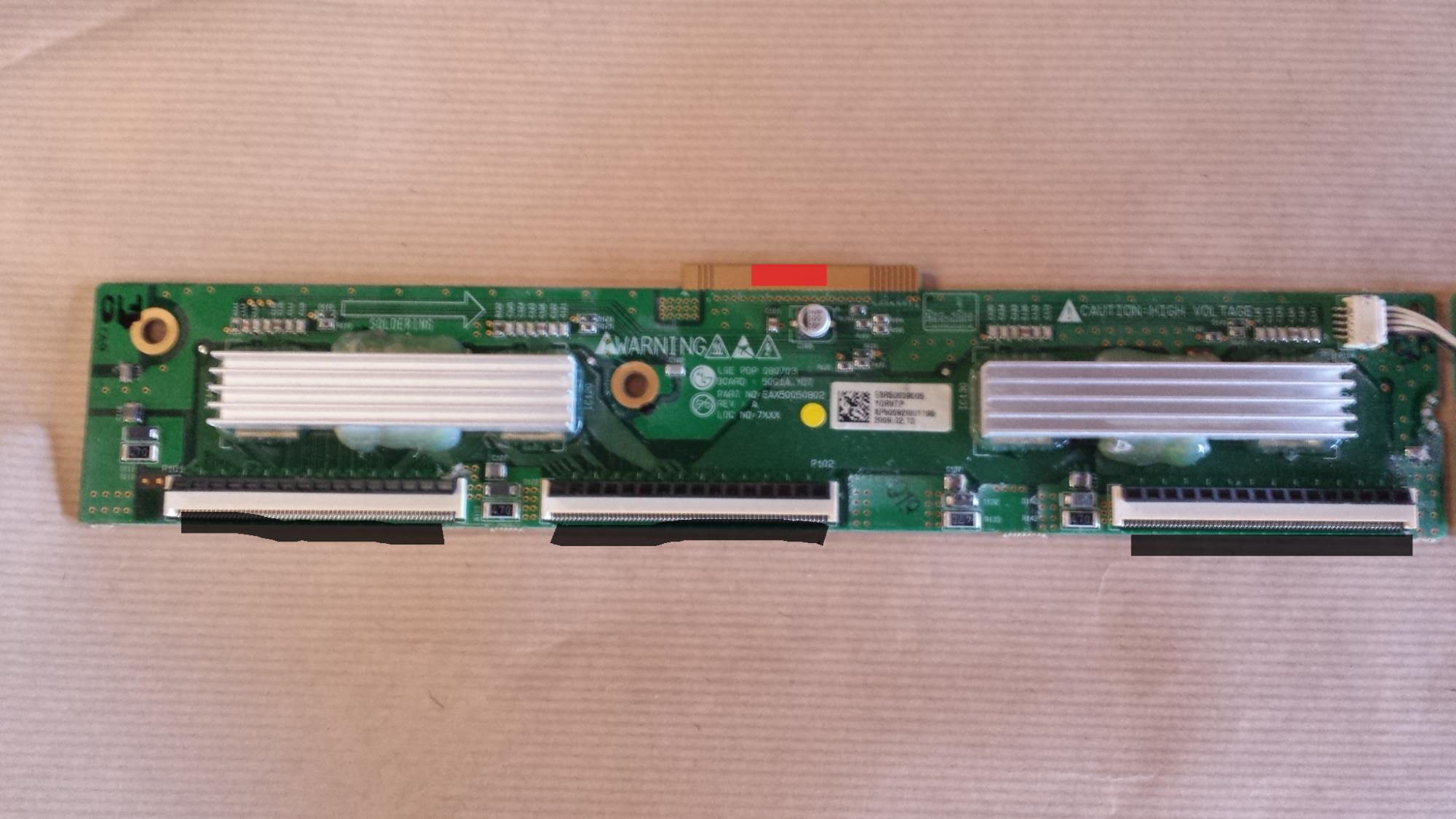

    OK, place the red probe on the copper area marked in red. Then run the black probe along the ribbon connector contacts. Try not to miss any.
    Your meter should be on the beep mode - i.e. when you touch the probes together it should beep.
    You only need to do this on the upper buffer board. The lower is OK.

      So am I looking for continuity across all contacts?
        Re: Faulty lg 50pg3000
        You should get no continuity.
        I am fairly sure your top buffer is bad, but this is additional information which will confirm it.

          On the left set of terminals there was no continuity but some terminals when tested gave a 1 on my multimeter and some gave varying numbers 476 589 etc.
            OK, that is a bad board. They are not dead short but they are leaky. So I would say you can just go and replace the top buffer board to fix this problem.

              Middle ribbon connector contacts all gave varying numbered readings and not one 1 reading
                The left hand ribbon connector is right where the lines are horizontally on the TV as well does that make sense?
                  Can you try reversing the red and black probes and do the test again?

                    Just a constant 1 when I do that

                      Hm, no shorts. Well, I would say replace the board anyway, given the fault symptoms. I can't see any other part causing it. Wish I could be more conclusive, though.
