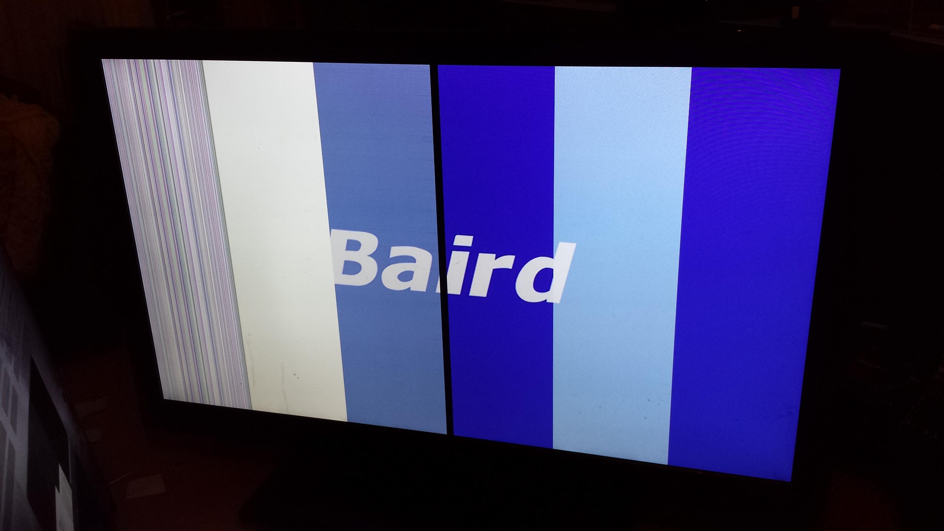

    Hi guys got this tv and guy explained to me his kid pulled it off the stand i was sure before he plugged it in it would have had a cracked screen as its a realy thin LED TV. He plugged it up and no crack. However there is multiple bars running down the screen. Could this be repairable ?

    possibly,the jolt may have loosend one or more of the lvds ribbon,but could also have broken the lcd driver boards inside,any signs of the framework cracked?,so check ribbons from t-con to panel,and check everything else is secure.
    my guess tho is the the panel itself is buggerd,many fine ribbons prone to damage.

      Most likely a small chip to edge of panel, or damage to a tab bond, not going to be repairable.
      Even if it hadn't have fallen, if I saw that, I would say bad panel anyway.

        no sign of cracked framework
