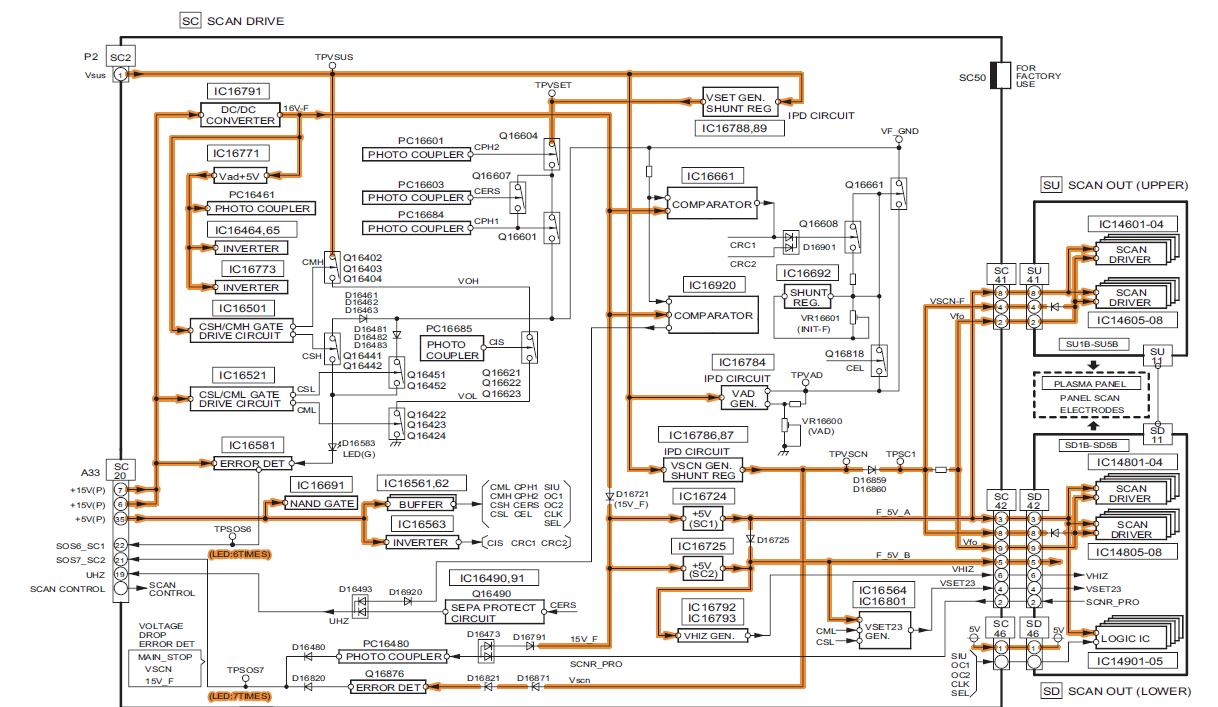

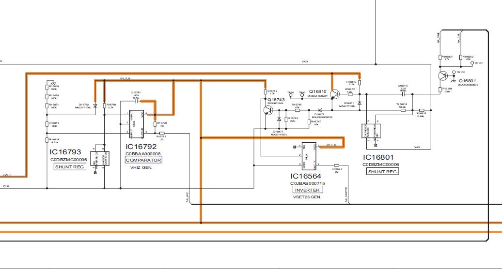

            Spent the day trying the freeze spray trick on the boards. Went top to bottom starting with the SD, then the SU and last the SC. The lines appeared on the SC board when the area around the TPSC1 was cooled down. As it warmed up again, they disappeared. Repeated it 3 times and each time, same result. No other areas on any of the boards caused the issue. Also took out all 3 boards and checked them front and back. They look brand spankin new and all solder points are solid... Put them all back in, turned on the TV and like clockwork... lines... and 4 minutes later, a perfect picture...
            Anyone know what this area's function is?
            Going to order an SC Board Monday and hope for the best...
              Re: Problem with Panasonic Viera TC-P54S1
              VHIZ GEN (IC792), VSET23 GEN (IC564) . No I don't know really what their functions are off the top of my head.
              I must admit I was thinking SD board. I only saw 2 on Ebay. If you're jumping in spending what I expect big $ for a SC, $30 for a SD board might be good insurance just in case.

                I saw those two IC in that area but could not find anything saying what they were for. Before coming back into the forum, I went and froze the SD board again hoping for a sign... no such luck.
                I did order an SD board just to be on the safe side since the SC board is definitely big bucks... But now, the TV has to be fixed because it has been driving me nuts since it started and I have to know what is causing it. Whichever board arrives first is the first one I am trying so, we sill see.

                  Looking at it, whole picture affected so you're probably right about it being SC.
