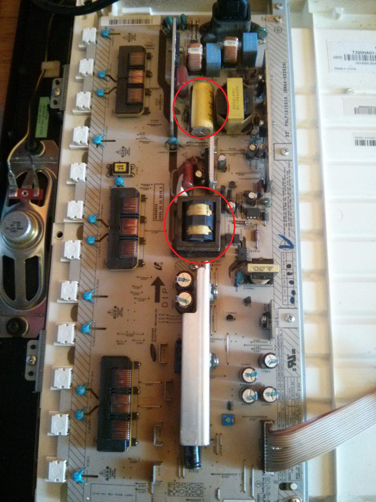

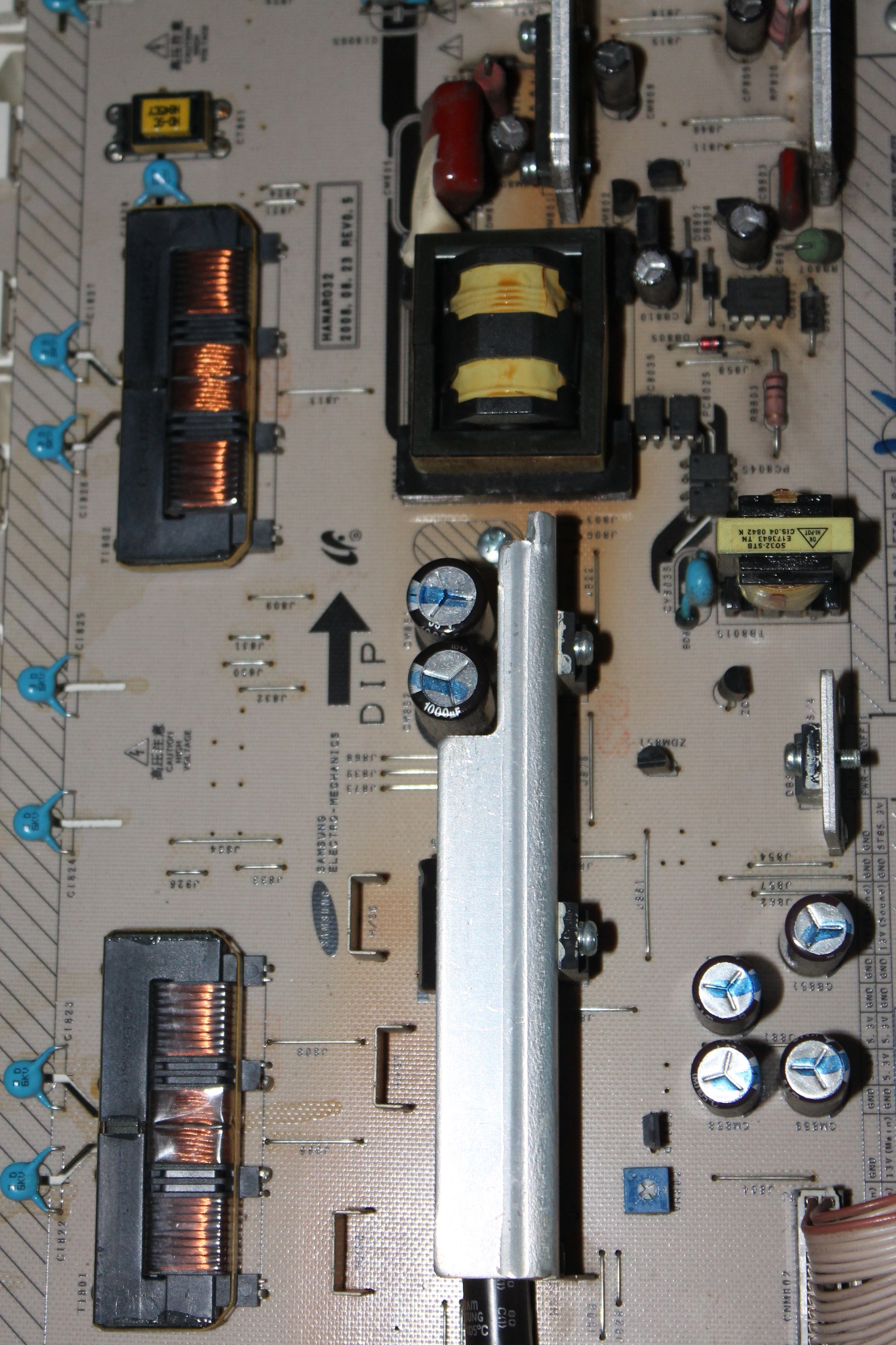

    My Samsung LE32A336J1N LCD TV, just stays on Standby, doesn't turn on.
    I have basic solder and components knowledge but i'm no expert by any means.
    I've checked the capacitors, and i see no budge or leaked ones.

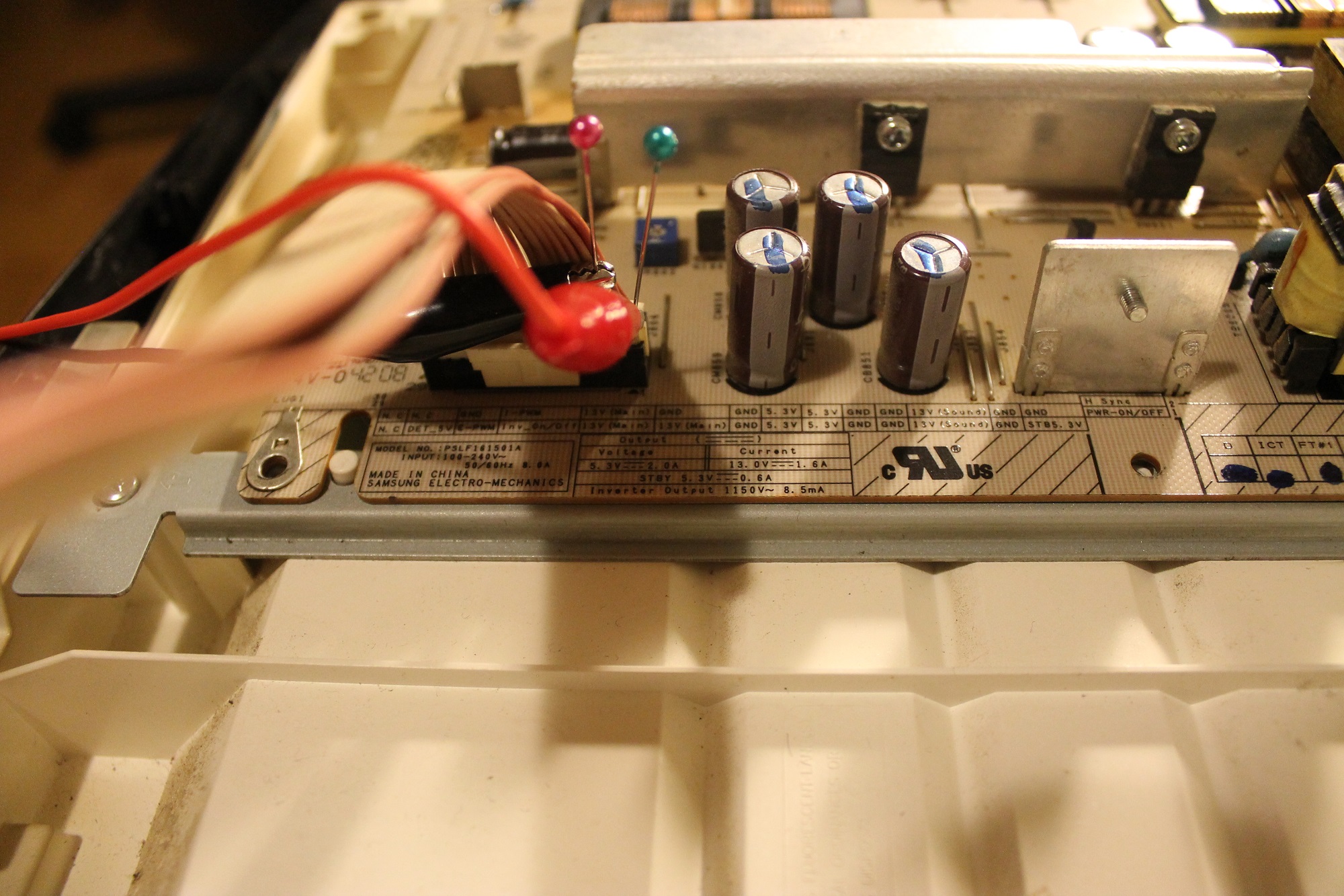

    What I've noticed is a faint clicking noise from the power supply, and i think it's coming from one or maybe from both, the component marked on the attached picture.
    What can it be? How can i diagnose it any further?

    can we have a clear and upclose picture from the power supply?

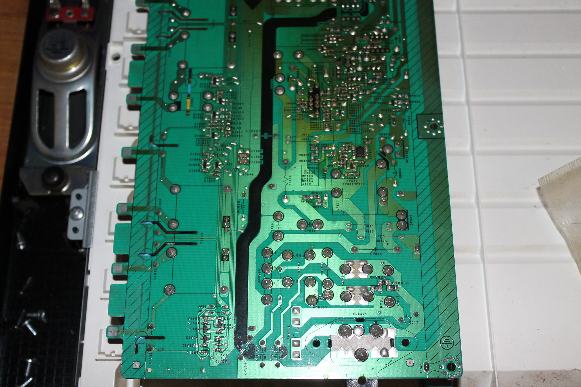

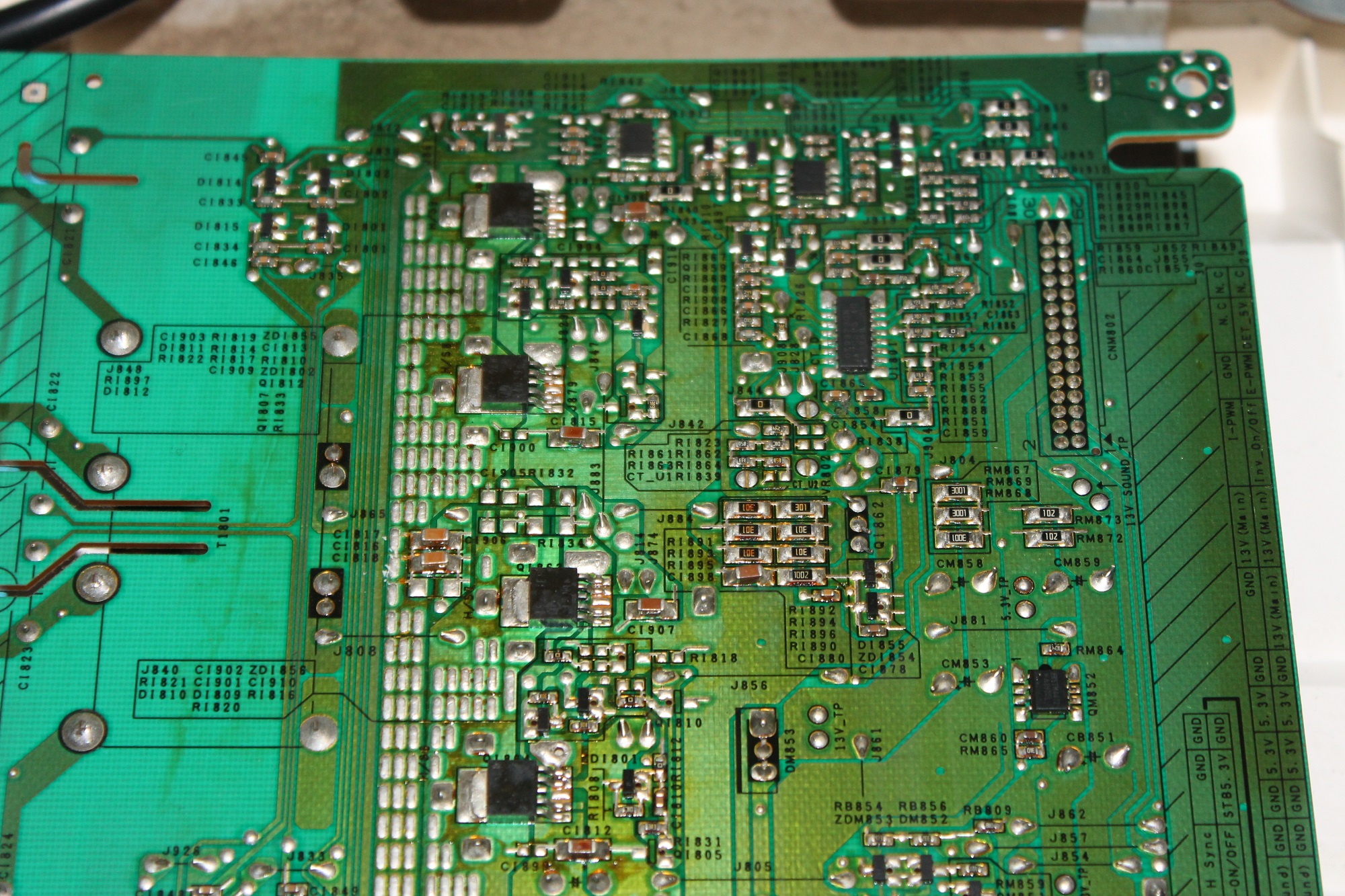

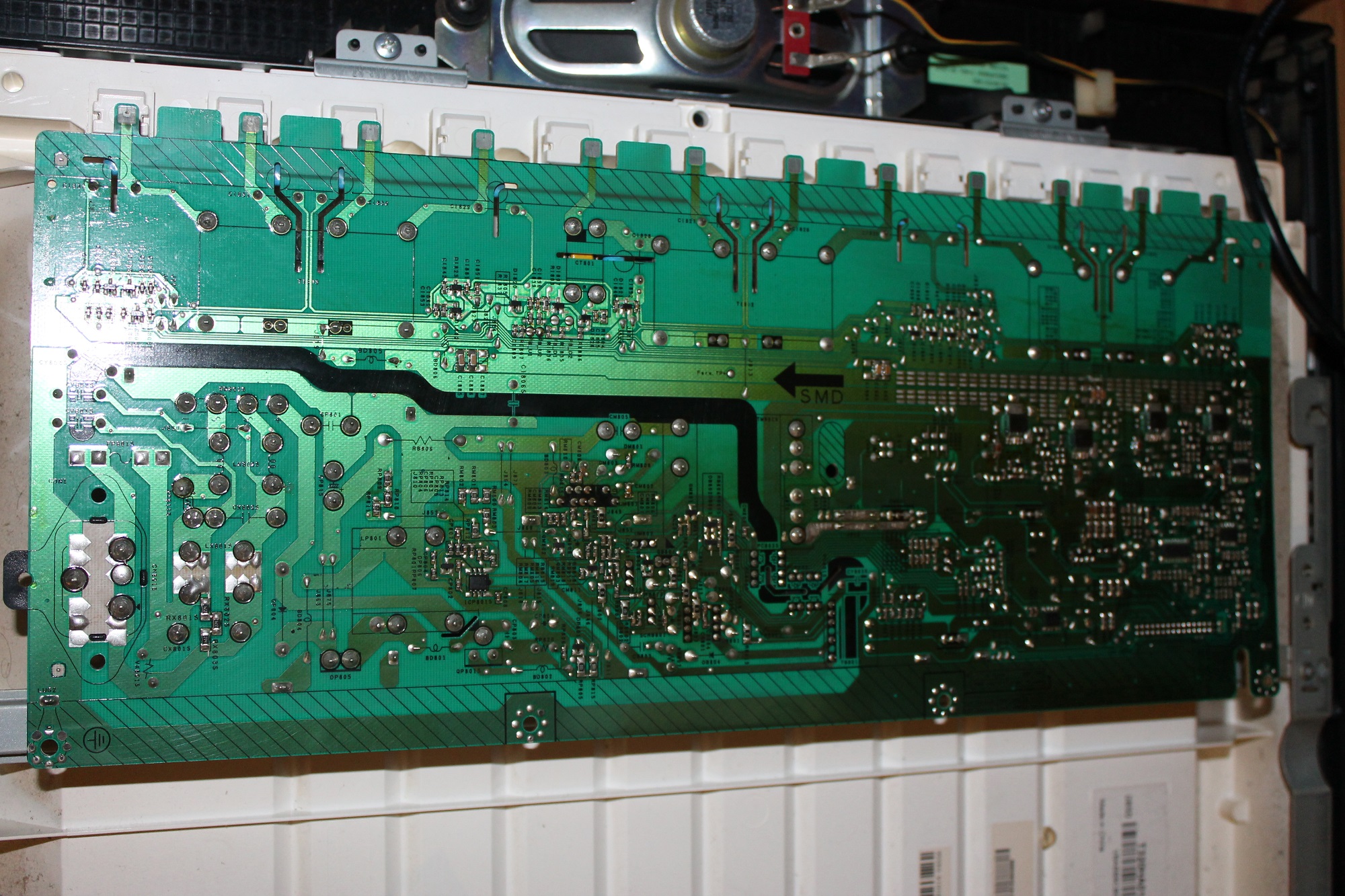

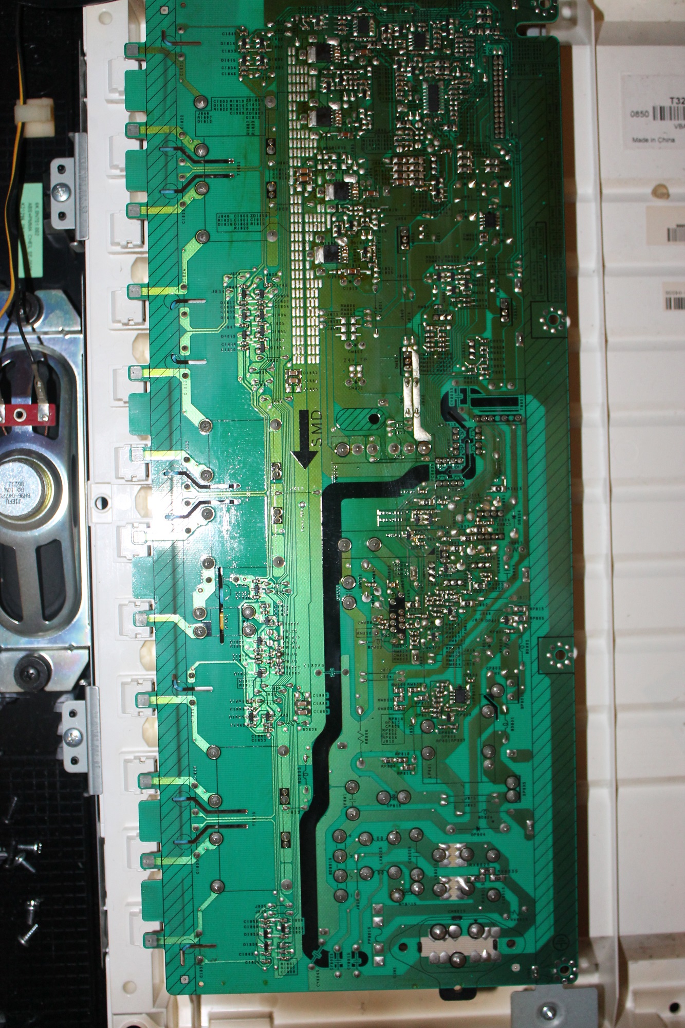

      Take a photo of the underside of this board.
      Check for cold joints.

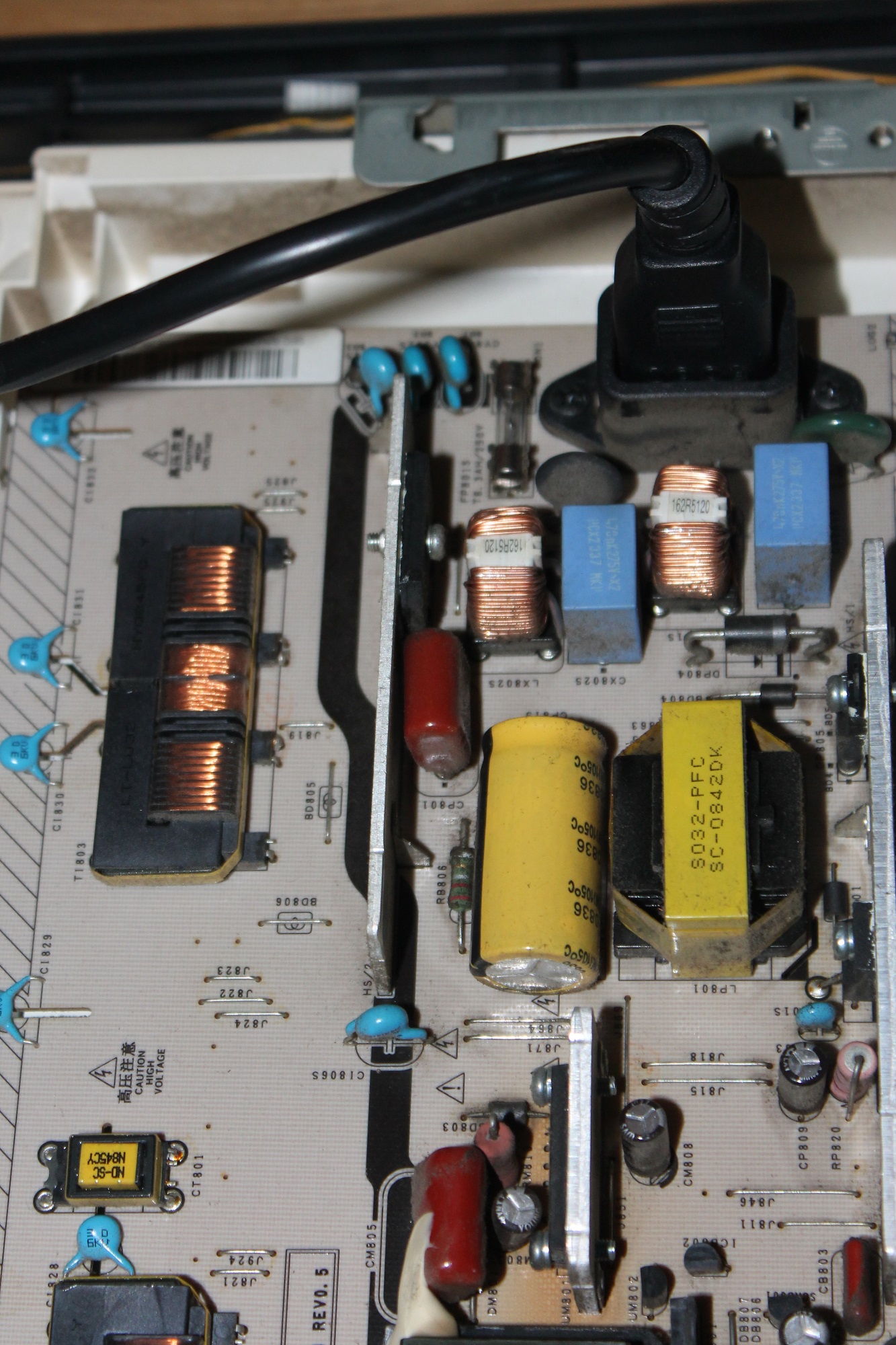

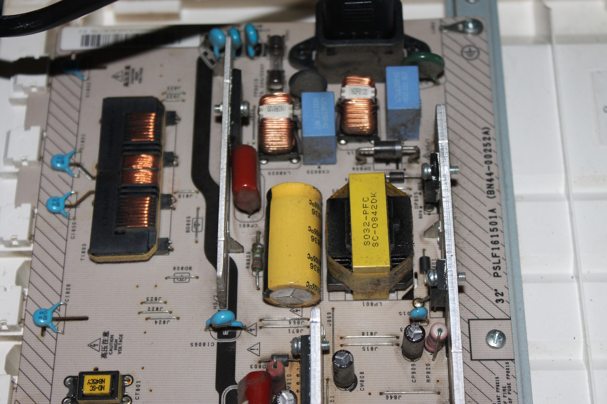

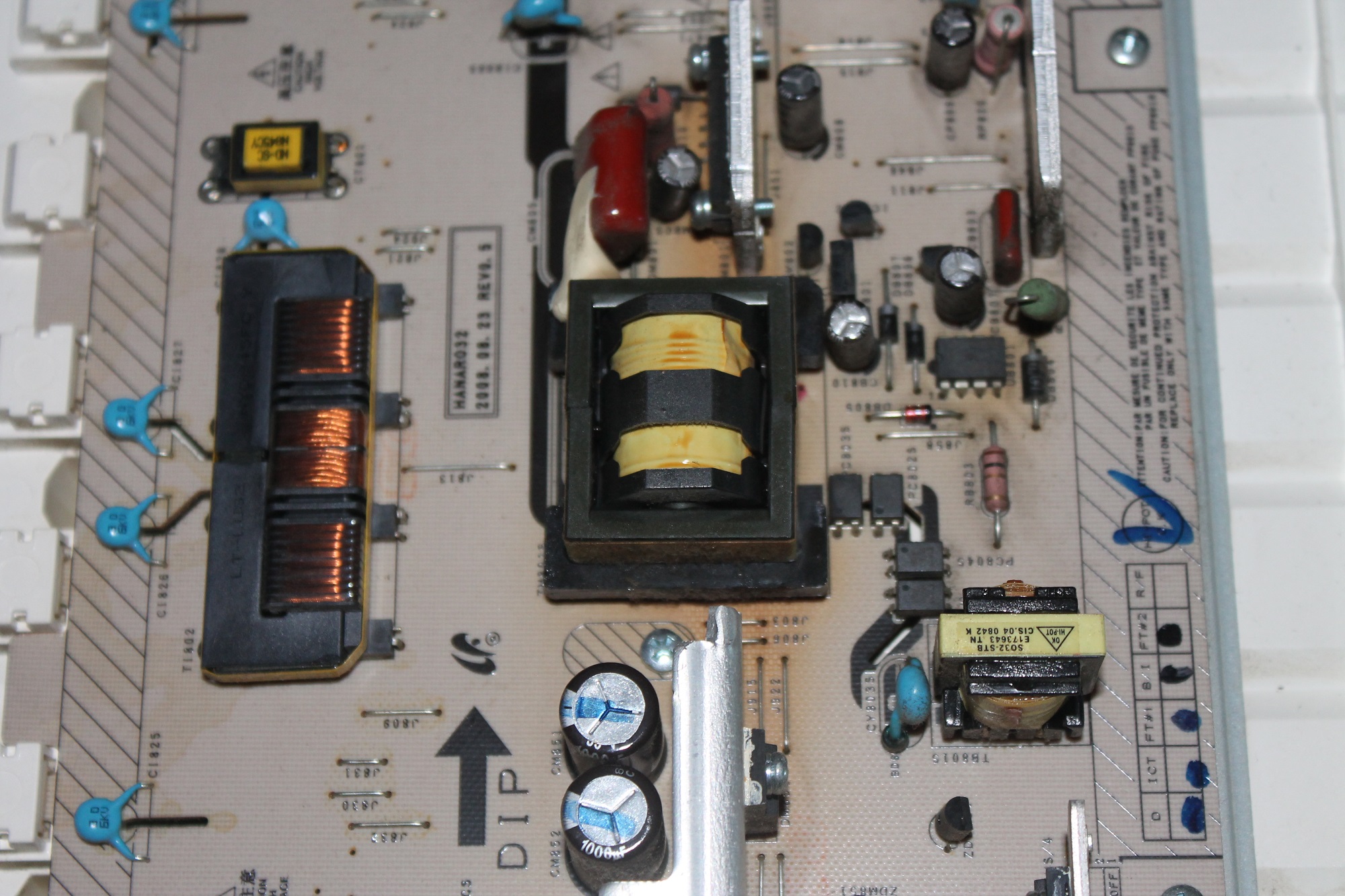

        Re: Samsung LE32A336J1N - Standby and nothing else
        Of course, martino.
        That picture was taken with my cellphone, I've taken better pictures with a real camera, please see the attached pictures.
        I really appreciate your help, and thank you.
        If you need any more information or pictures, just ask.

          On connector cm802,can you find the standby voltage? I believe its 5.3 volts? Is it stable?
          Same plug,ps-on,whats the voltage there and is it stable? (might have to try and turn tv on to get a reading... )
          put multimeter on 20volt DC,black probe on tv metal frame,red probe on connector wires...

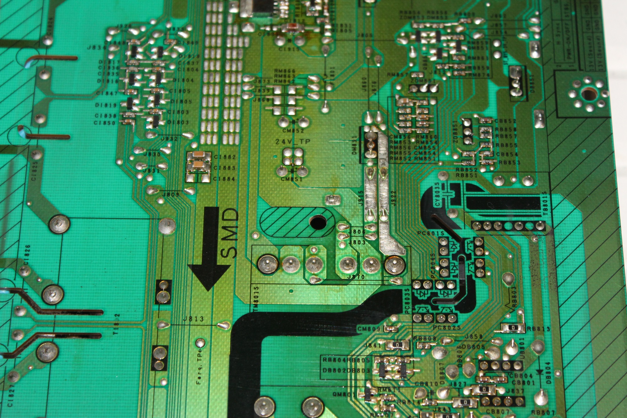

              I'm sorry martino, i've had a hard time understanding what you are asking me.
              Where is the connector cm802? Can you place a circle on one of these photos, please?

              Hamie, please see the attached pictures, for underside of the board.
                "Where is the connector cm802?" It is on the that board, it is a black double-row socket where the flat grey ribbon cable with white connector is connected to, you can also see the label for each pin function. See your picture #3 post #4.

                  Thank you budm, I eventually found out the connector, when looking closely to the board.
                  But i still can't get the reading, i tried without the ribbon cable and with a multimeter on pin 7 counting from top left, where it says it gives 5.3V and i get nothing, but I'm not sure I'm placing the red and black probes on the right spot.

                              Can you see a part # written on the board marked "BN44" and some digits? That might get us a schematic.
                              Edit: Nevermind - Saw it - BN44-00252A. Can't find a schematic at the moment, though.

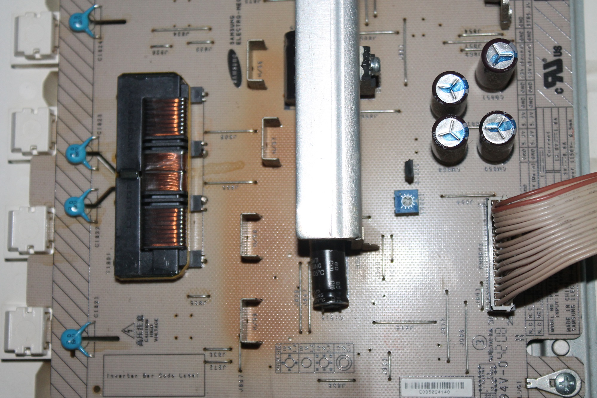

                                    I've tested what tom66 suggested, i couldn't found a pin PS ON or PSON but i found "Power ON/OFF" i guess that was it.
                                    I noticed something, each time i ear a click the voltage rises to ~4V then drops to 0V.
                                    Each click are 2 seconds apart, more or less.
                                    Can you explain what pins you want me to test it, selldoor?
                                    Please check the attached picture so you can see the pins.
