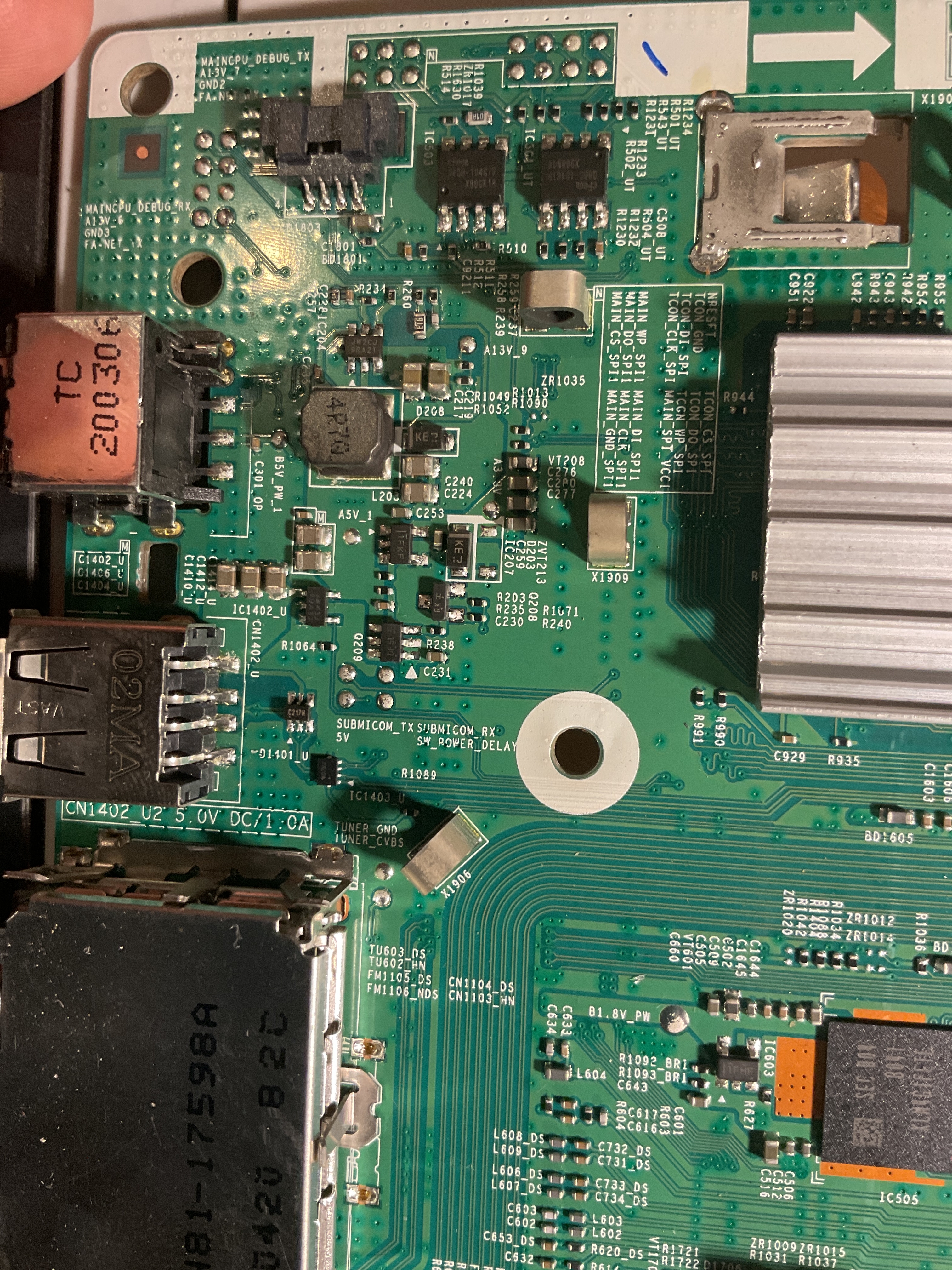

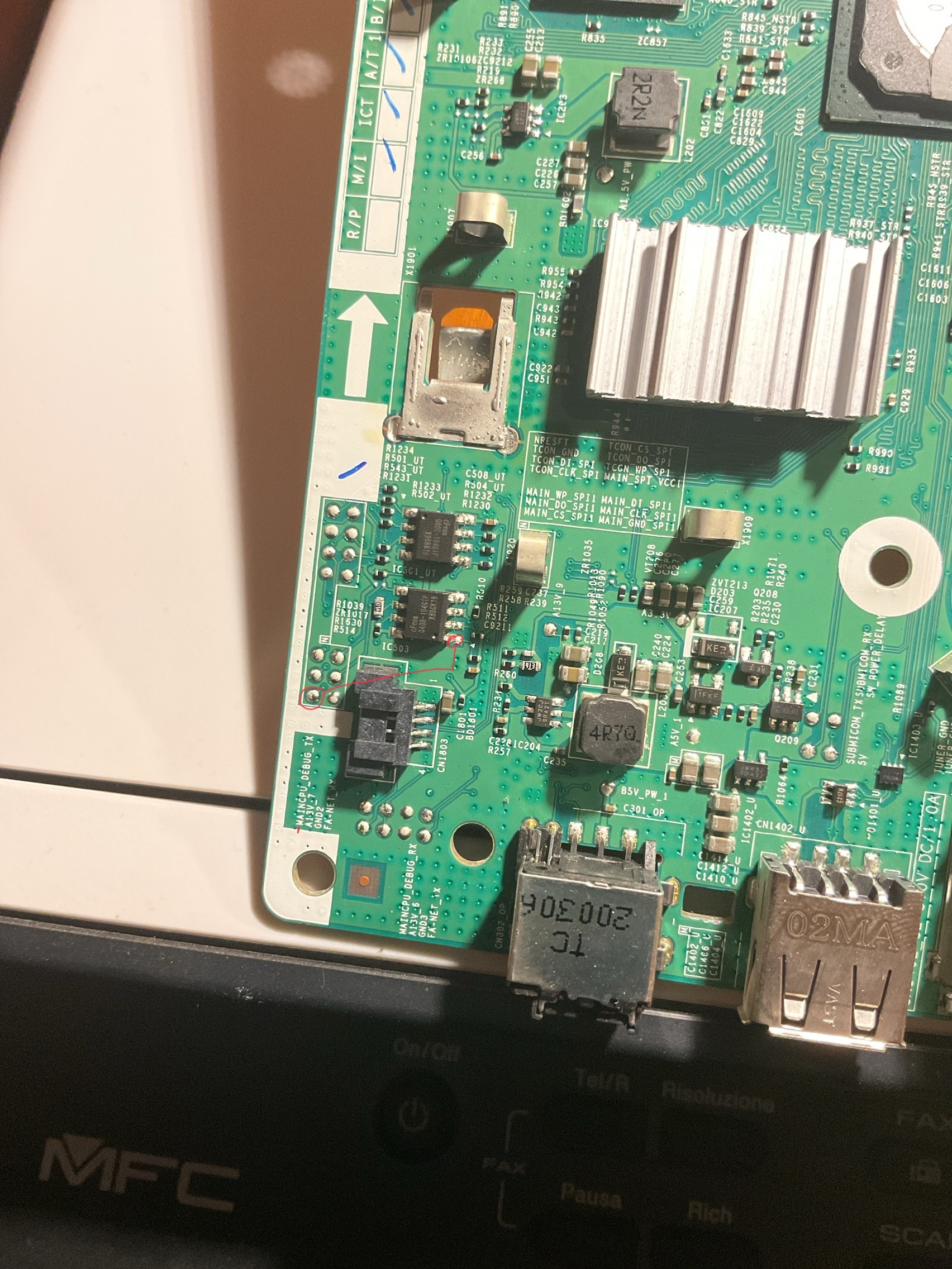

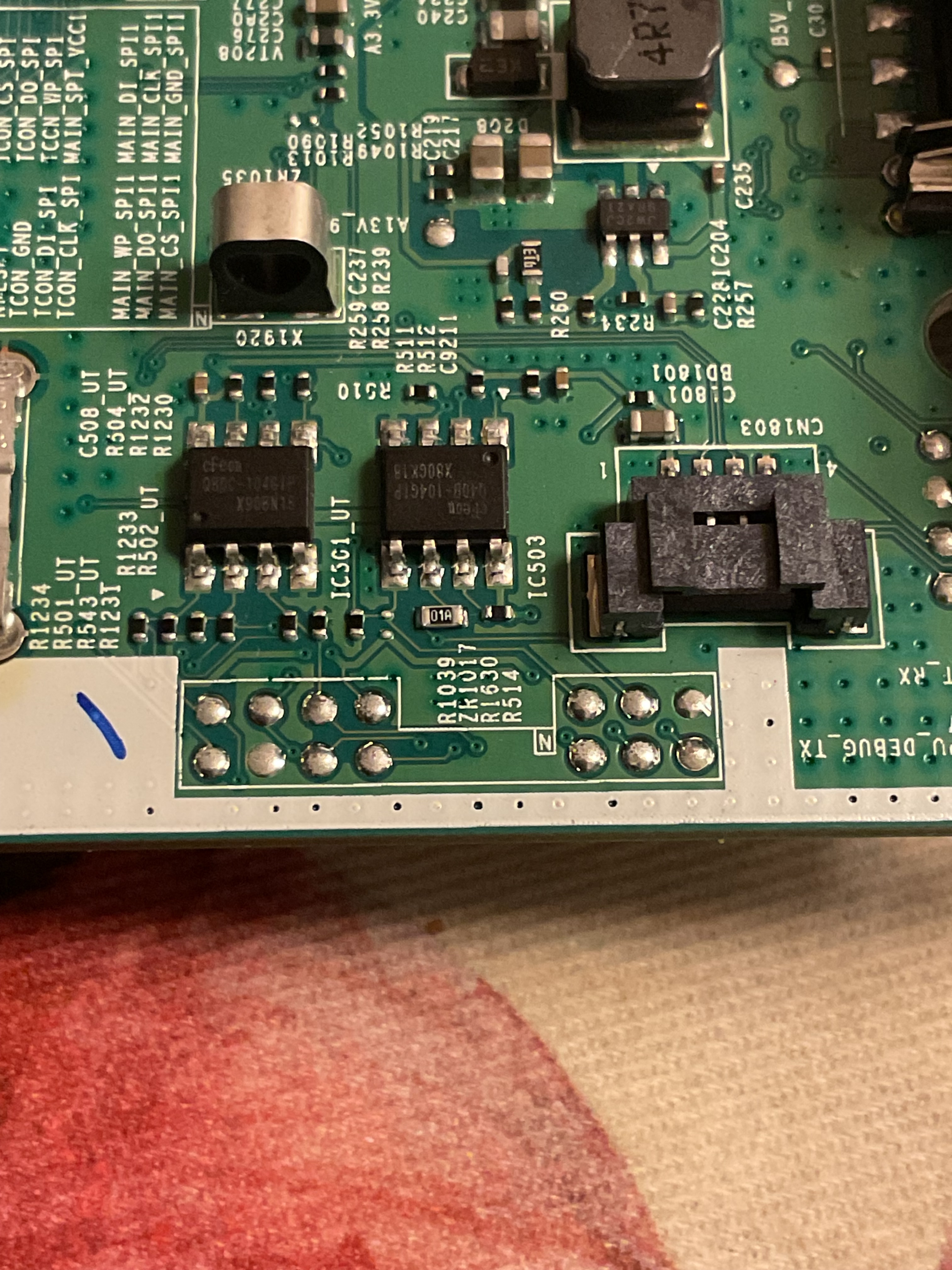

For your question I checked the board and I find two ic memory, ic501_ut that is q80c-104gip that should be a en25q80c-104gip but i didn't find a lot on internet. And in position ic503 that is a 25qb-104 gip that I find easy on internet. Are they what are you looking for? I give you the photoComment
The correct one is the Q40B (not 25q as you said, but is 25Q40 entirely) most probably, if you can enlarge the view on photo (please cellular in landcape not portrait), i can see testpoints definition, or better, if you can confirm the TP that belongs to that chip is named "MPU_debug_TX" you're 100% sure it is the standby mem. and you can flash it, you can use even from different size of screen but same series..Comment
I take a better photo of the chip, and a landscape, there are a lot of point of control, and I have main cpu debug tx. There are a lot of this point control and description, so I don’t know if I’m doing good. But the point near the name main cpu debug tx go to the first pin of the q40b I don’t know if it s correct or I’m checking wrongs point. Do you have the dump of it because I really don’t have hahaThe correct one is the Q40B (not 25q as you said, but is 25Q40 entirely) most probably, if you can enlarge the view on photo (please cellular in landcape not portrait), i can see testpoints definition, or better, if you can confirm the TP that belongs to that chip is named "MPU_debug_TX" you're 100% sure it is the standby mem. and you can flash it, you can use even from different size of screen but same series..Comment

so i desolder the ic, the program with detect find the 25q40, i read and i have something, so or it s not working, but we cant know if we dont have an other dump or the problem is somewhere else...maybe in the psu...because i have 13 volt and not 11,8 that it s written on the board on the strtandby point....i really dont know ahah. hope someone can find the dump or say me if i have something broken in the main. now i give you the dump of the standby ic that i read, i dont know if there is someone who can understand if it s ok or no.....the first part it looks like there is something, then all blank and almost on the end there is a string with the alphabet like abcdef ecc...Attached FilesComment
really if it s the problem we found the problem...then we just need to find a dump i hope Iotas can help me, he is like a god of dumps ahahah. honestly i never read an ic in my life....it s the second so i dont know for that i put the dump file here if someone can help me...and didnt work so we can try also other dump maybe we are lucky....hope someone can help me...Comment
