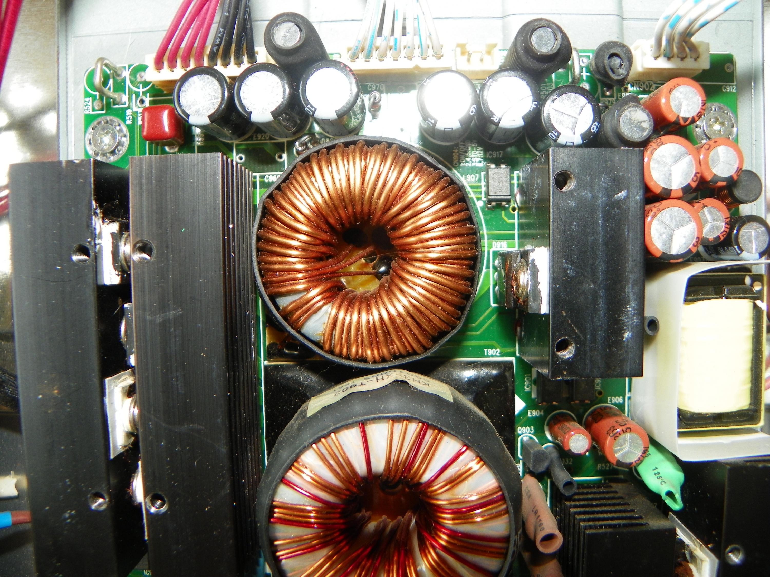

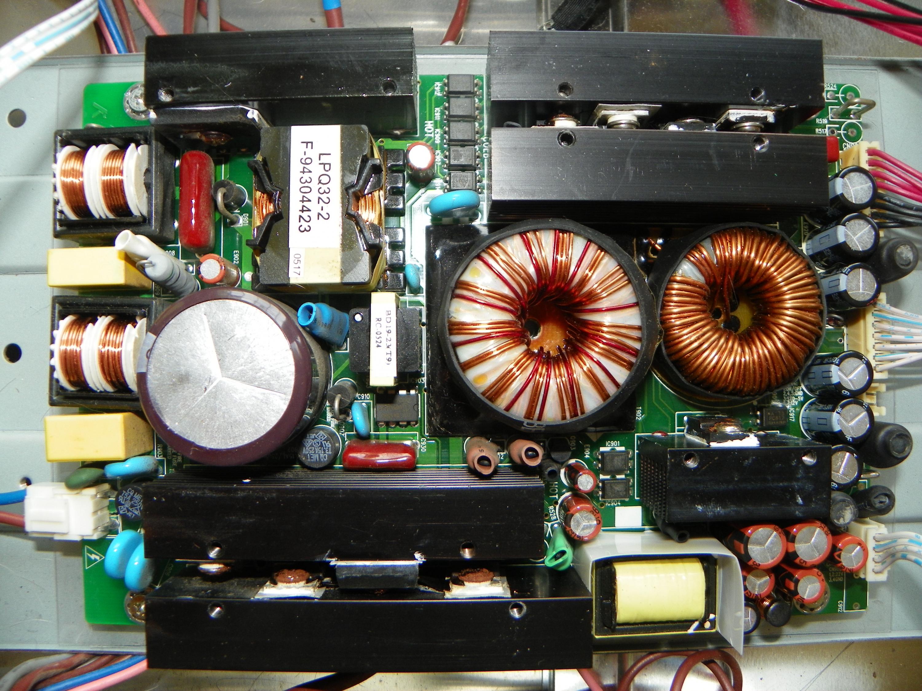

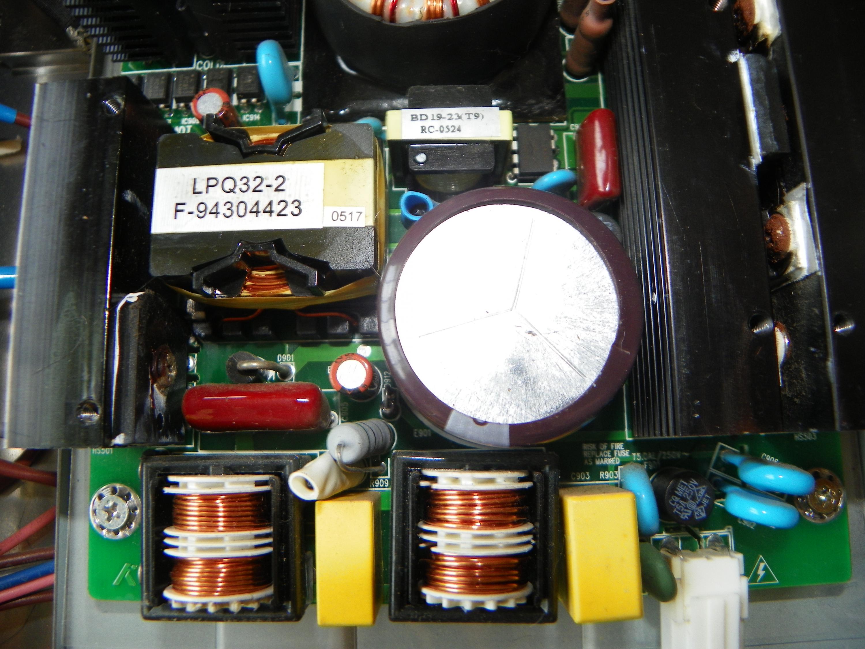

    Was wondering If anyone had some experience or schematics for this TV?
    Power supply has no voltage at all comming out. Found some bad solder joints on some heat sinks but that was it . Fuses are good...

    if you can post good clear pictures of your boards, that will help.

      So I need to update, After resoldering the heatx the standby voltage is now (.468 VDC). The caps all look good(I know that doesnt mean much). I am definately an amature, but I am pretty good at soldering and following directions .

          I see rust on the mounting screws for some parts, so you might want to check for corroded connections\leads as well.
          It may also be possible (at a guess) that rust has broken through the insulating washers on some of the parts, you might want to check that there is no connection.
          I found a service manual but it doesn't have a PSU schematic
          Does the PSU have a model number? You might find it is used in other sets and you can get a schematic off their manuals.
