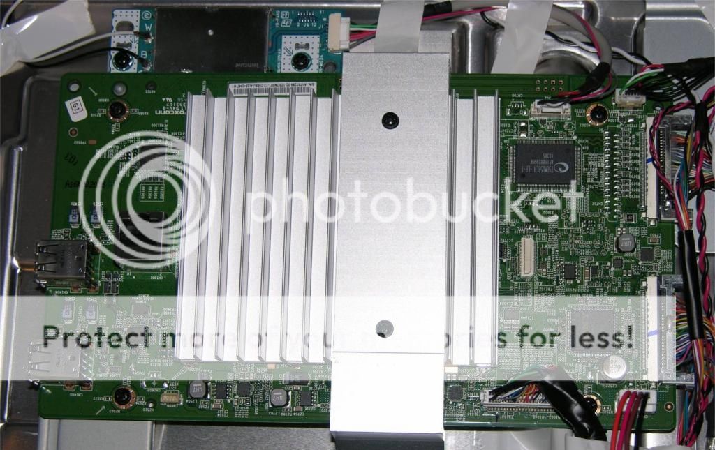

    Re: Sony NSX-32GT1, Power Surge, No video/audio/lights, just a clicking sound
    Overall Layout
    Power Supply
    BA Board
    M Board
    Power Supply Underside
    BA Board Underside
        Can you make a close up picture from the connector on the power board that has the most wires come out of it? It shows printing beside it what tells you what it is,ps-on,stby etc..
          Below is a link that shows a closeup of that connector. I don't have a multi meter (or know how to use it) but a friend might be able to help me this weekend
          http://i944.photobucket.com/albums/a...ardCloseup.jpg

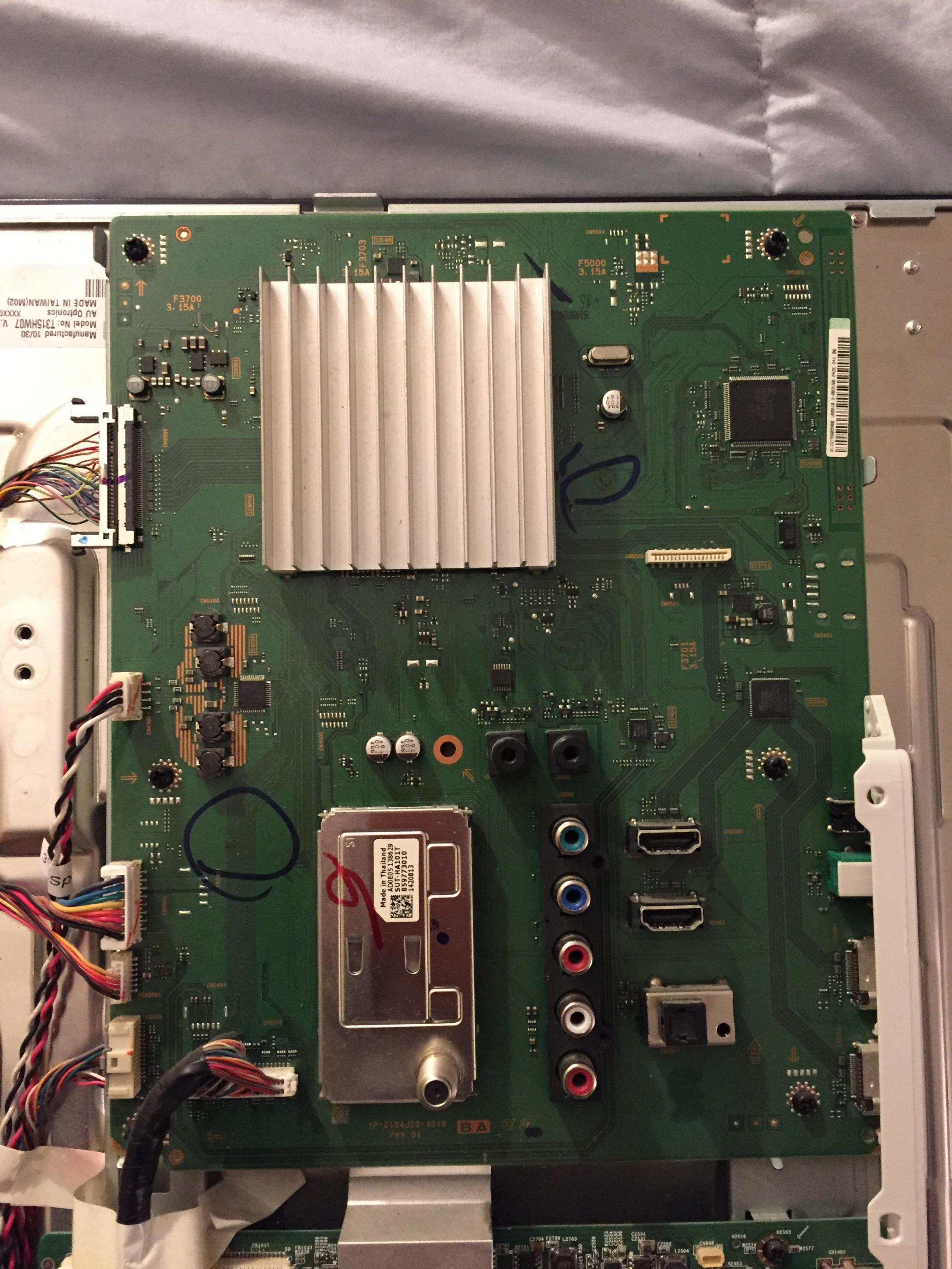

                                Hello.
                                I have the same TV, and am having a similar problem with the TV staying on (NSX-32GT1). I plug in power, and the LED turns red as normal (one loud click). When I try to turn it on, however, it tries to stay on for a few seconds, then turns off and the red LED blinks 5 times, pauses for a few seconds, and repeats blinking 5 times.
                                I just brought a multimeter home from work today and started taking some volt readings, but before I got too far, I just tried turning it on again and it's working now.
                                A few days ago, I was able to get it working after a few powercycles, but then it stopped working. Obviously, there is some part that is dying, but I'm not sure what. I measured 120VAC out of the power supply. One weird thing I noticed was R6501 and R6513 were running inconsistent voltages. With the power cable plugged in but the TV not on, they would fluctuate a few dozen volts relatively quickly. I'm not sure what the purpose of these resistors are but it seemed strange to me. I was measuring DC, as AC just showed up as 0V.
                                Any ideas on what might be happening?
                                  ^^ To clarify, the resistors are on the power supply board and look like this:
                                    Need voltages from connector that goes from power supply board to main board. Will need pin#- PIN DESCRIPTION -Pin voltage in standby-Pin voltage when pushing power button and picture of connector on power supply board.
                                    Format:
                                    Pin# - Pin Description - Pin Voltage standby - Pin voltage power on
                                    1 - XXXXXXX - XXv - XXXv
                                    2 - XXXXXXX - XXXv - XXXv
                                    3 - XXXXXXX - XXXv - XXXv
                                    4 - etc.

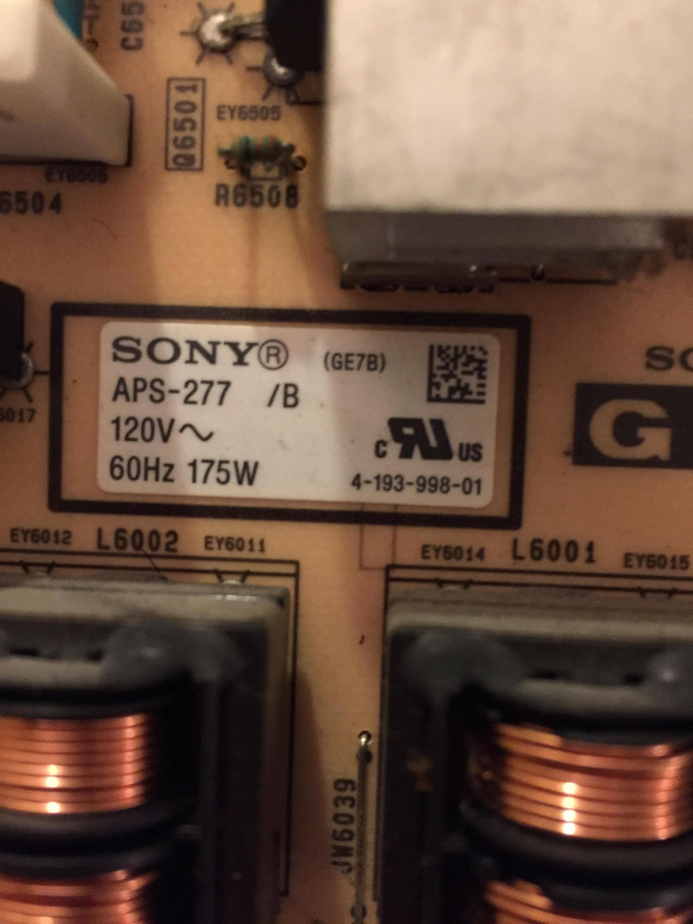

                                      We need good clear straight shot pictures of the bottom side of the board so we can trace out the circuit in that section where the two resistors are.
                                      BTW what is the full p/n as printed on the white sticker?
                                      4-193-998-????
                                      • silva000001
                                        • May 2017
                                        • 7
                                        • US
                                        p/n is 4-193-998-01
                                        I left my multi meter at work today but I'll bring it home tomorrow and get some more readings then.
                                        leaving some pics for now
