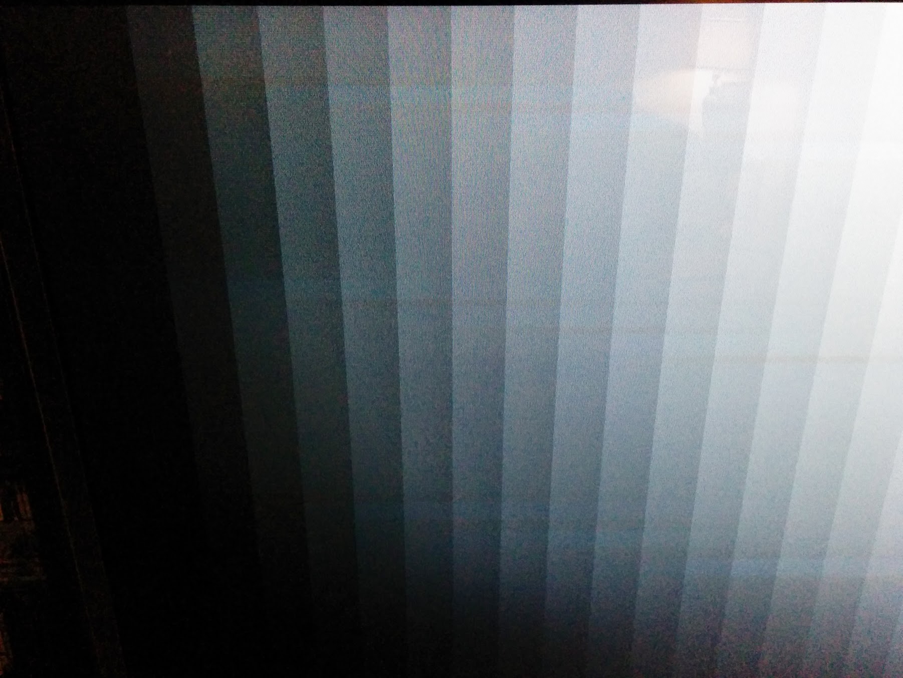

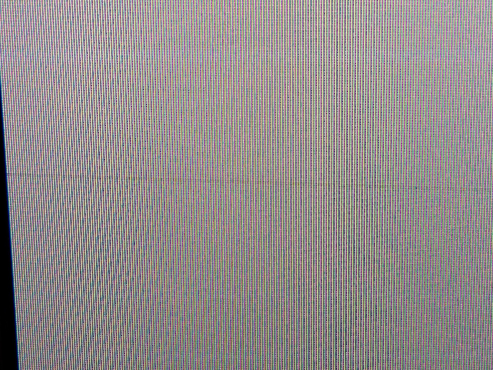

            Edit: I've also attached a close-up pic. It's hard to capture. The line only shows on consistently solid bright or white screens. If the image were to be darker, the line would light up properly with the rest of the pixels. If a portion of the screen around the line were to become darker, the line would disappear. 2nd pic shows a gradient displayed on screen, which causes the line to disappear (other lines are artifacts from the camera).

            If I set the screen to all bright green, the area of the black line becomes slightly brighter in opposite fashion.

                Not a problem with voltages. It looks like a panel issue. Since it's intermittent, maybe you can locate the cause by pushing the ribbons very gently with the handle of an insulated screwdriver. The ribbons are glued to the panel but can be removed with some effort (though I have not yet heard of someone reattaching them.)
