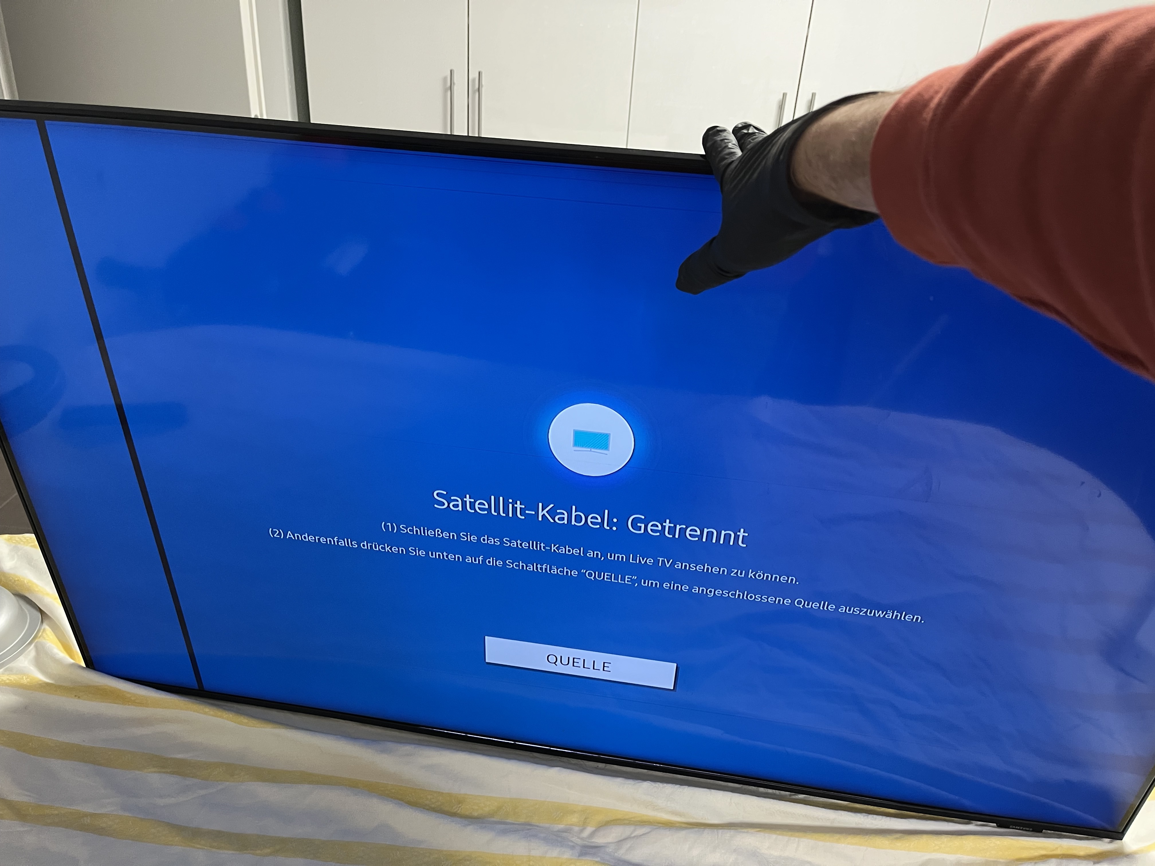

    Samsung GQ50Q60AA and VGH shortage
    Hi, have a Samsung GQ50Q60AA, that went into protection. I measured CKx lines, found no problem, but noticed on the left side from the back of the TV, that the VGH had a ~5 KOhm resistance against ground. I cut the VGH trace on the left panel PCB to the Panel and now the TV is no longer going into protection, but shows a picture with a vertical black line and some small horizontal bad lines. Please see the image.
    I am a bit surprised, since 5 KOhms do not really seem to be a short.
    Obviously now the left (always seen from the back of the TV) part of the panel now has no connection to VGH. I ordered one of those little DC DC convert kits from China to feed in a programmable VGH, but that has not arrived yet. Will that fix that issue ?

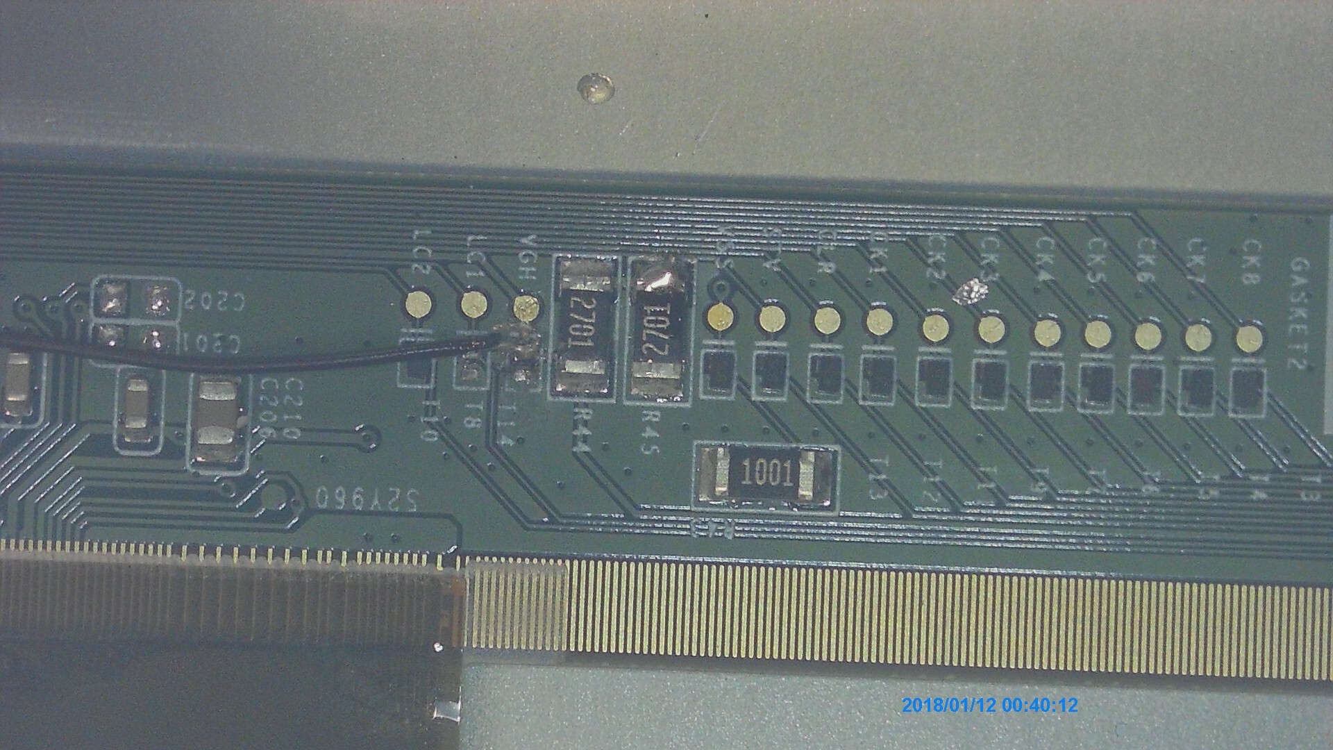

      In the meantime the DC / DC converter boards from China arrived and I tried to install it today. Attached you see the cut of VGH and the new wire, that inserts the VGH voltage from this little China board. On the other side of the TV panel VGH is 24.6 V, so I adjusted that converter to 24.6 V as well. However the image on the screen is absolutely identical.
      I performed some more measurements and found something really strange: When measuring the original feed of VGH above the cut I saw a negative voltage, something I would expect from VGL. On the other side of the panel as stated above VGH is 24.6 V. Unfortunately performing multiple measurements I slipped with my probe and a small spark was created. Now the negative voltage is gone, the 24.6 V is still there and the picture still looks like above.
      Has anyone ever seen something like this ?

          BTW from yours Photo look you have short to chassis between CK2 CK3 test points
          • kevin_allein
            • Dec 2023
            • 45
            There was a little solder spot on that picture, but it did not really generate a short.
            I removed the DC/DC converter, but I am confused about your suggestion to "tracking your shorted rail". You mean the one, that was negative voltage before and is now dead ?

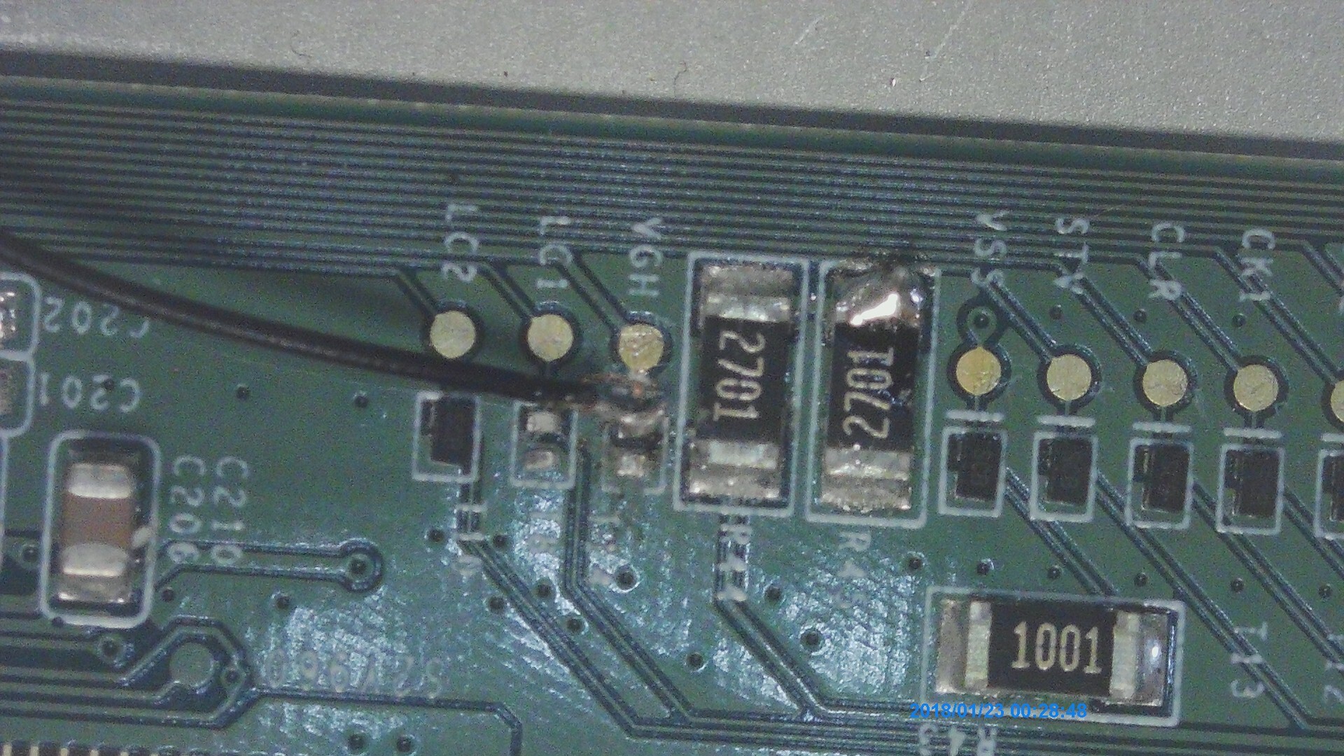

                Don't listen to certain stories, VGH VGL are normal supply lines and the output of a normal dc dc converter..
                can you show where did you do this "cut"? I see only a missing diode..

                    on the unmodified TV there is a ESD protection diode and above a golden circle test point. The test point and the pad for the ESD protection Diode are connected by a thin trace. I did cut this trace.

                                      I am pretty puzzled by what I found now: From the 96 pin connector VGH goes directly to R44 and here I still measure 24.6 V. The VGH test point however seems to be connected through a trace to the very left of the scalar board and than directly to the Panel. So it seems like there is a short in the panel between VGH and VSS/VGL ?
