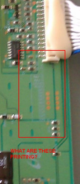

    There are printing by the connector telling you what the pins are. Look at the picture in post 2, it is out of focus so we cannot tell what the labels are.

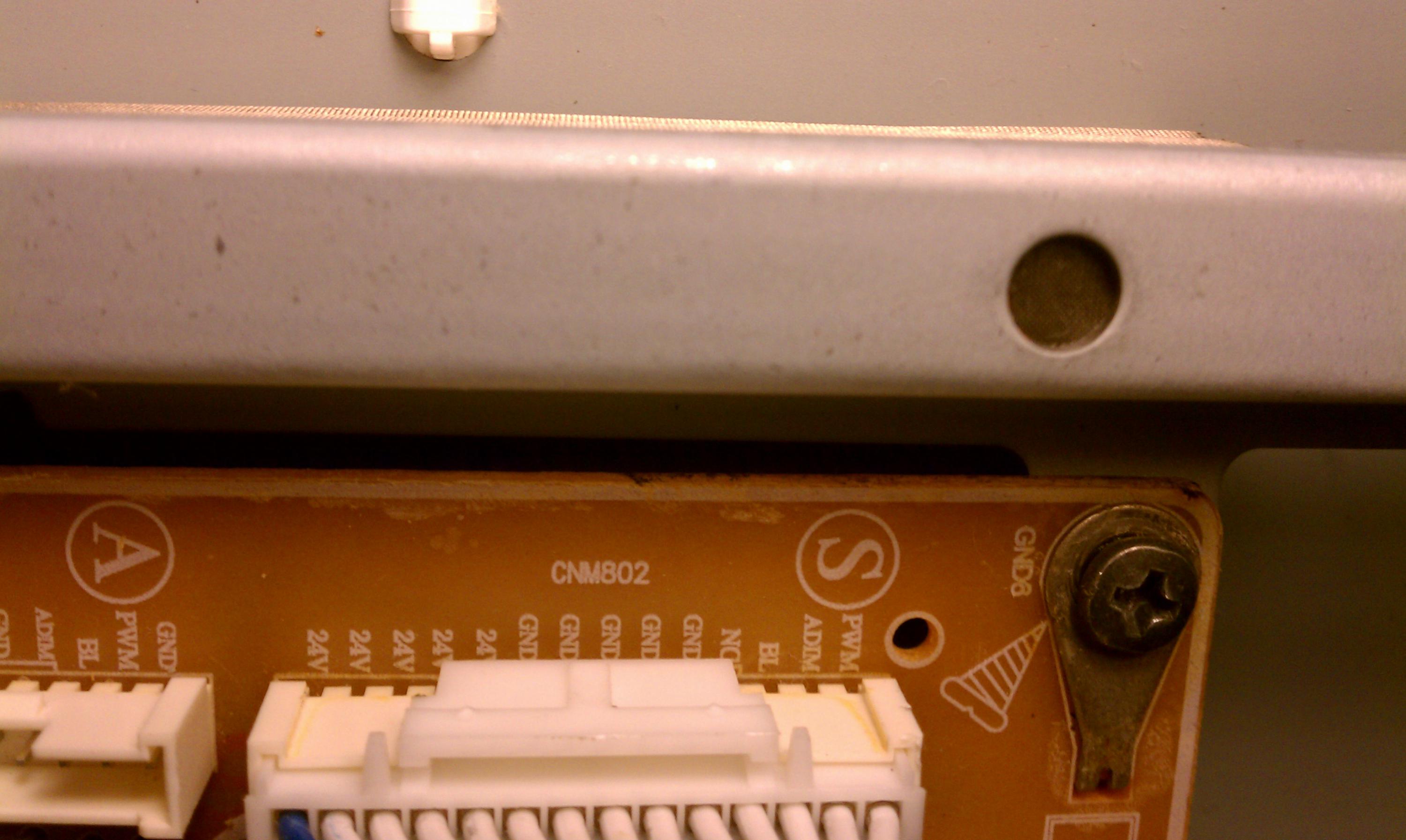

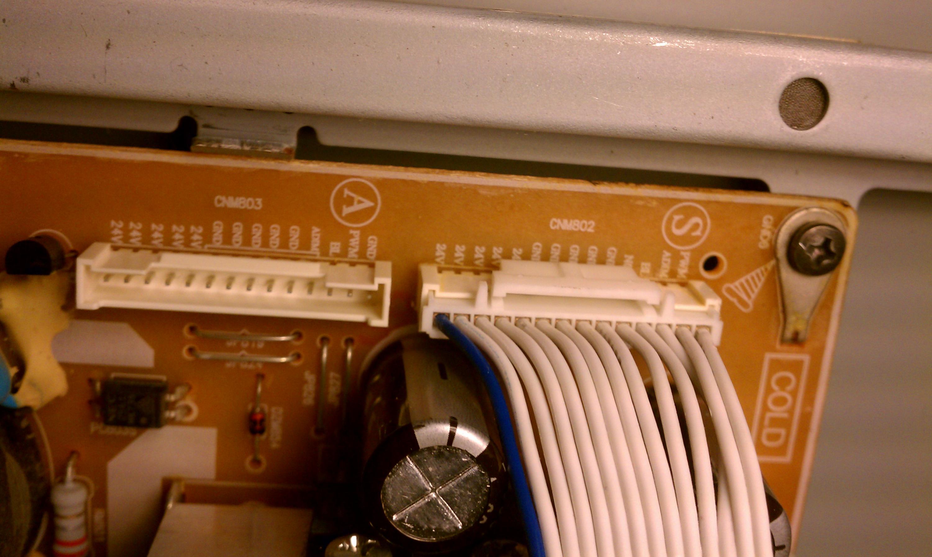

      spokm yea thats what i did. those little wires are going into the LCD i think. budm heres the label on the psu connector. there is no label on the connector on the inverter board.

        Re: Samsung LN-T3242H works fine for a day, then wont turn on. intermittent.
        why is there that second connector that is empty??
          Man, you are not helping.
          What are those printing then? I gave up.

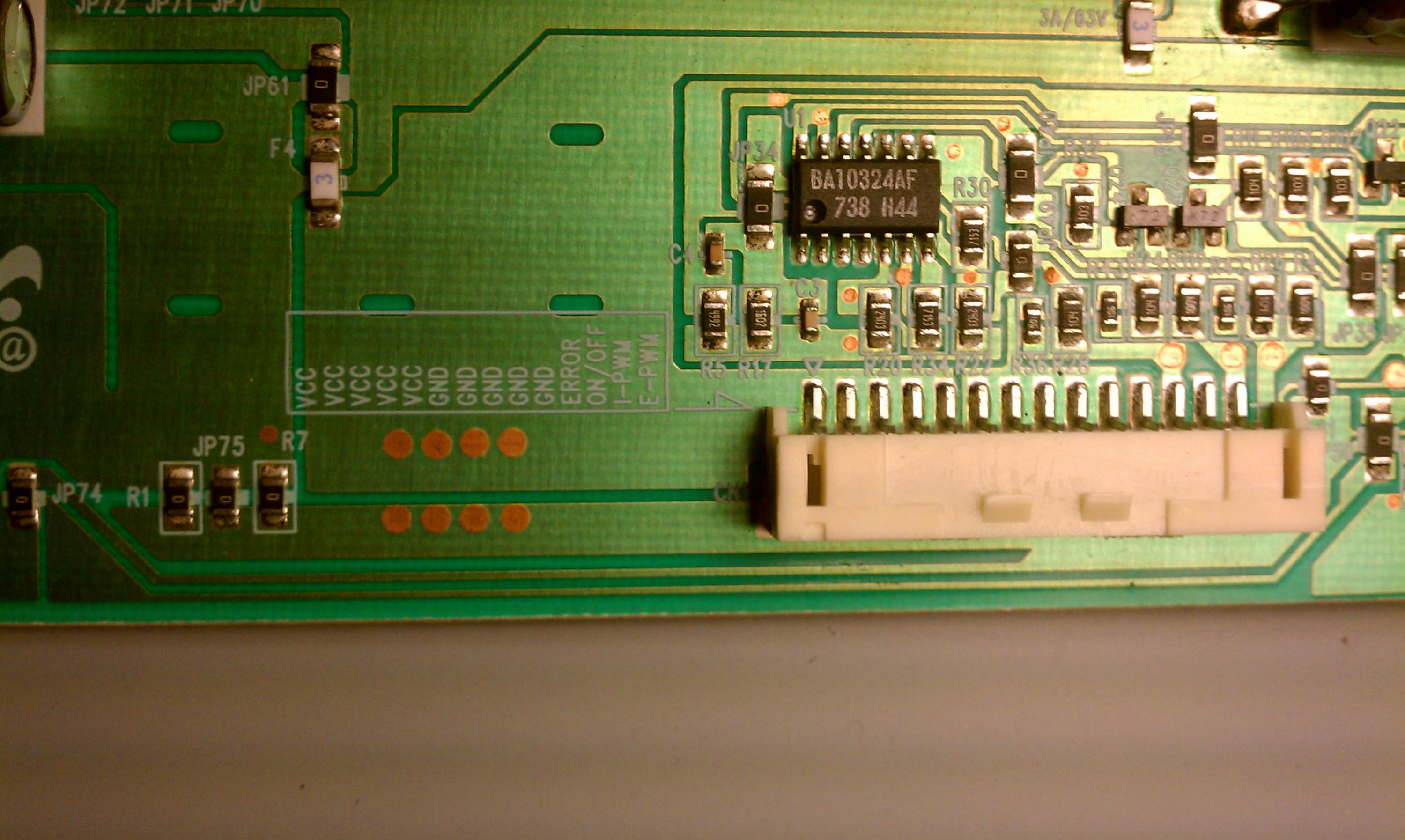

            sorry i didnt see those earlier and didnt understand which labels you wanted.
            please dont give up on me!
            this is a good picture of that label.
            Don't fear the repair...
              Take the DC voltage reading on pin 12 (ON/OFF), 13 (I-PWM), 14 (E-PWM).
                12: 5.3
                13: 3.4
                14: 0.5
                11 which says error is 0
                  OK, the inverter is getting the correct signal and voltages. Inverter transformer resistance testing will be required next. Need the numbers as printed on the top of the transformers.
                    BTW, the power supply board has two connectors so it be used with more than one model of the inverter board, since same model TV can have difference make and model of LCD panel assembly. You can see that all the pinouts of the two connectors are not the same.
                      that makes sense. i noticed the pinouts were different too thats why i didnt want to try plugging it in there
