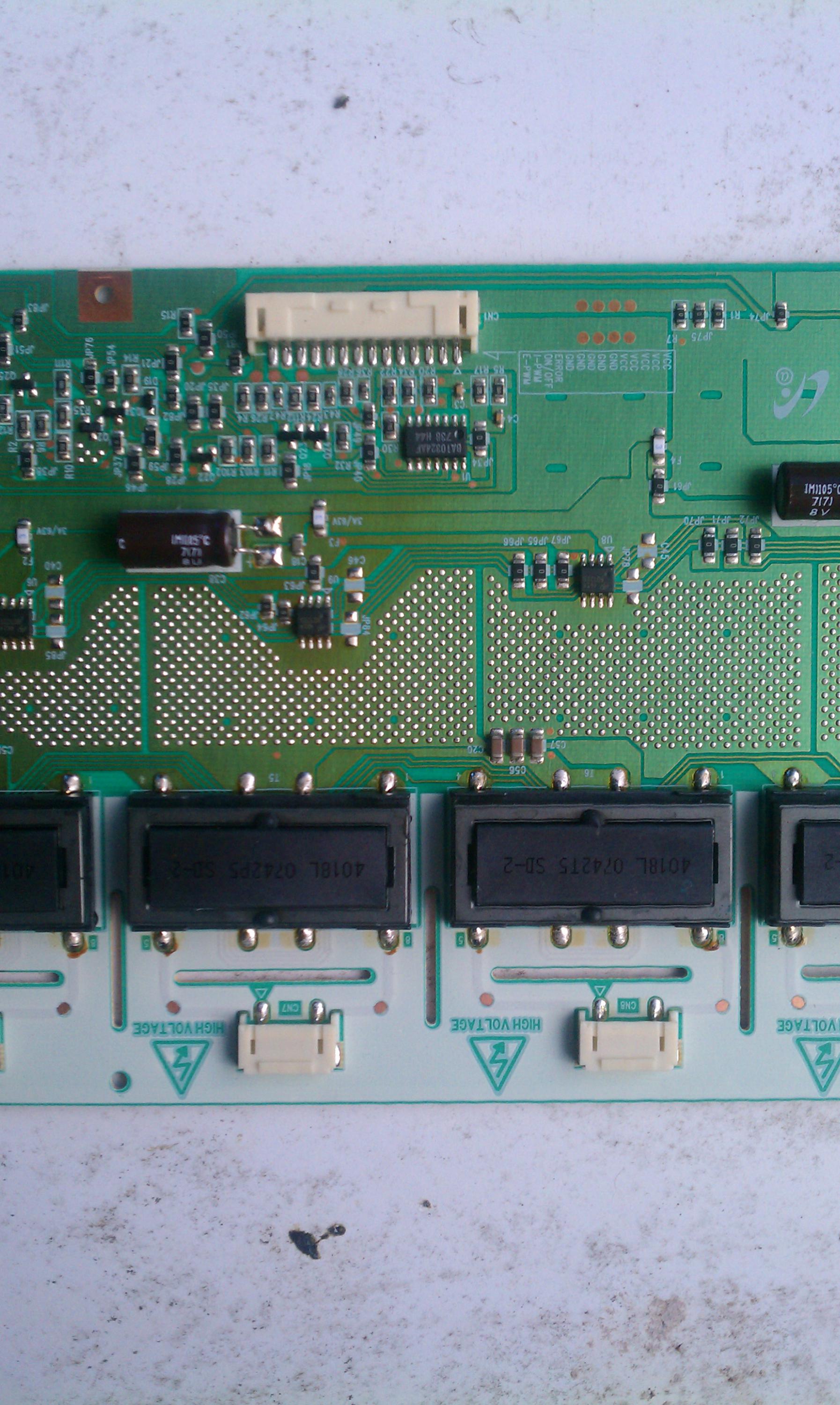

                  "when i was making the voltage measurements on the fuses, the backlight did try to turn on..it flickered on and off a few times" You mean one of those white fuses on the inverter board, it sounds like you have bad connection, try using plastic rod of some sort and press around the board to see if you can make the lamps to come on.
                  Can I see good FOCUSED STRAIGHT SHOT pictures of the INVERTER board, then pictures of section of the board (may be in 4 sections) so I can clearly see the traces and the components?

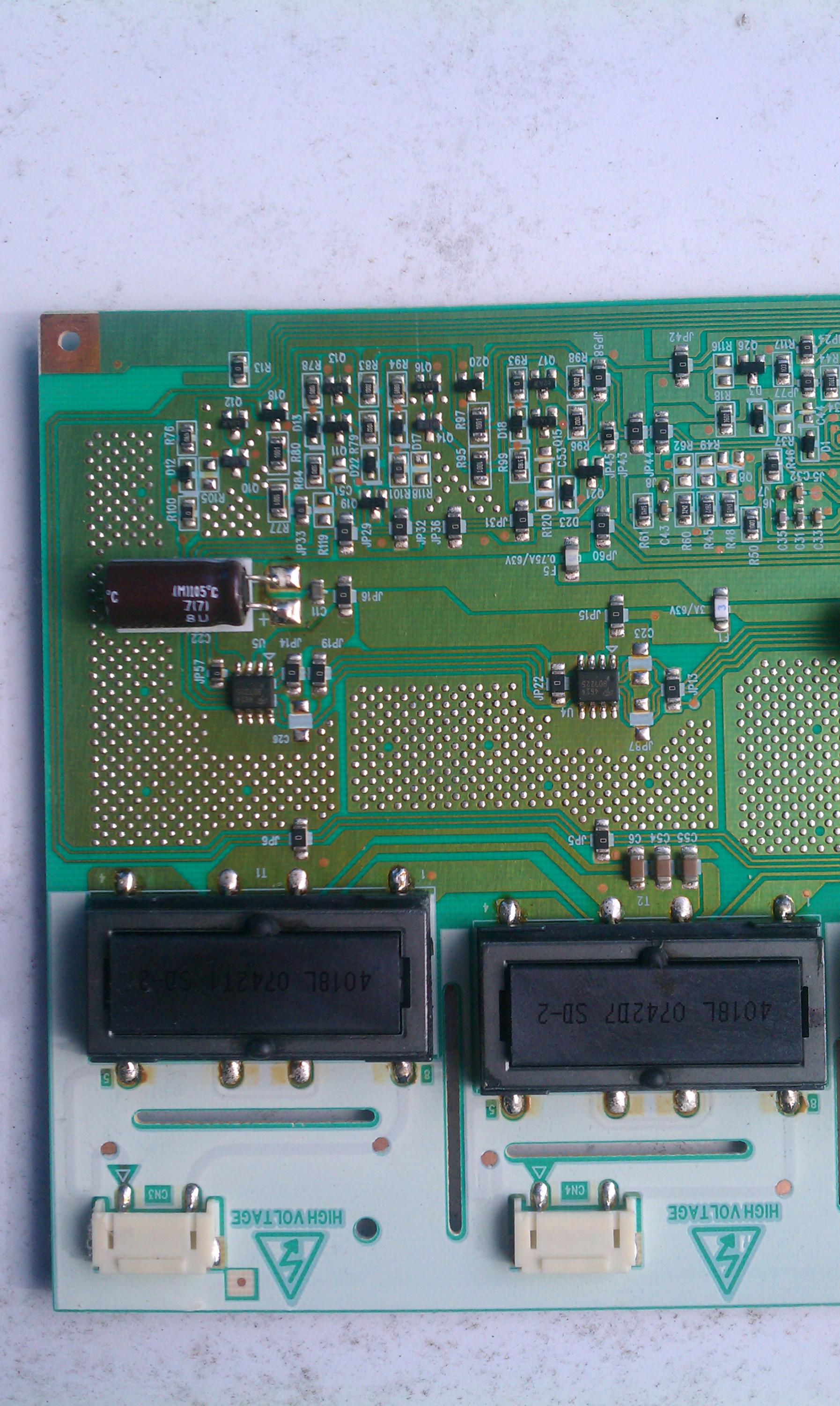

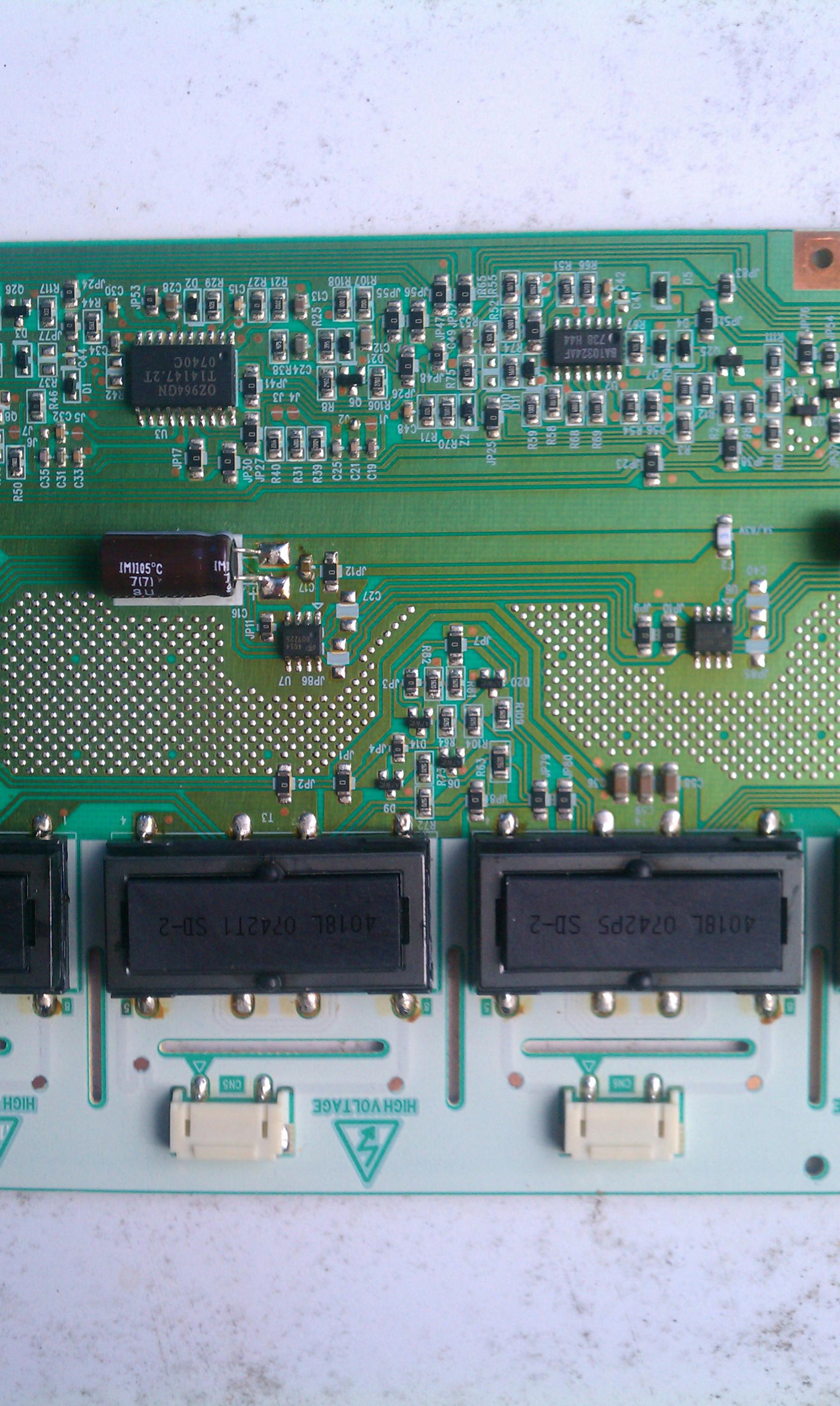

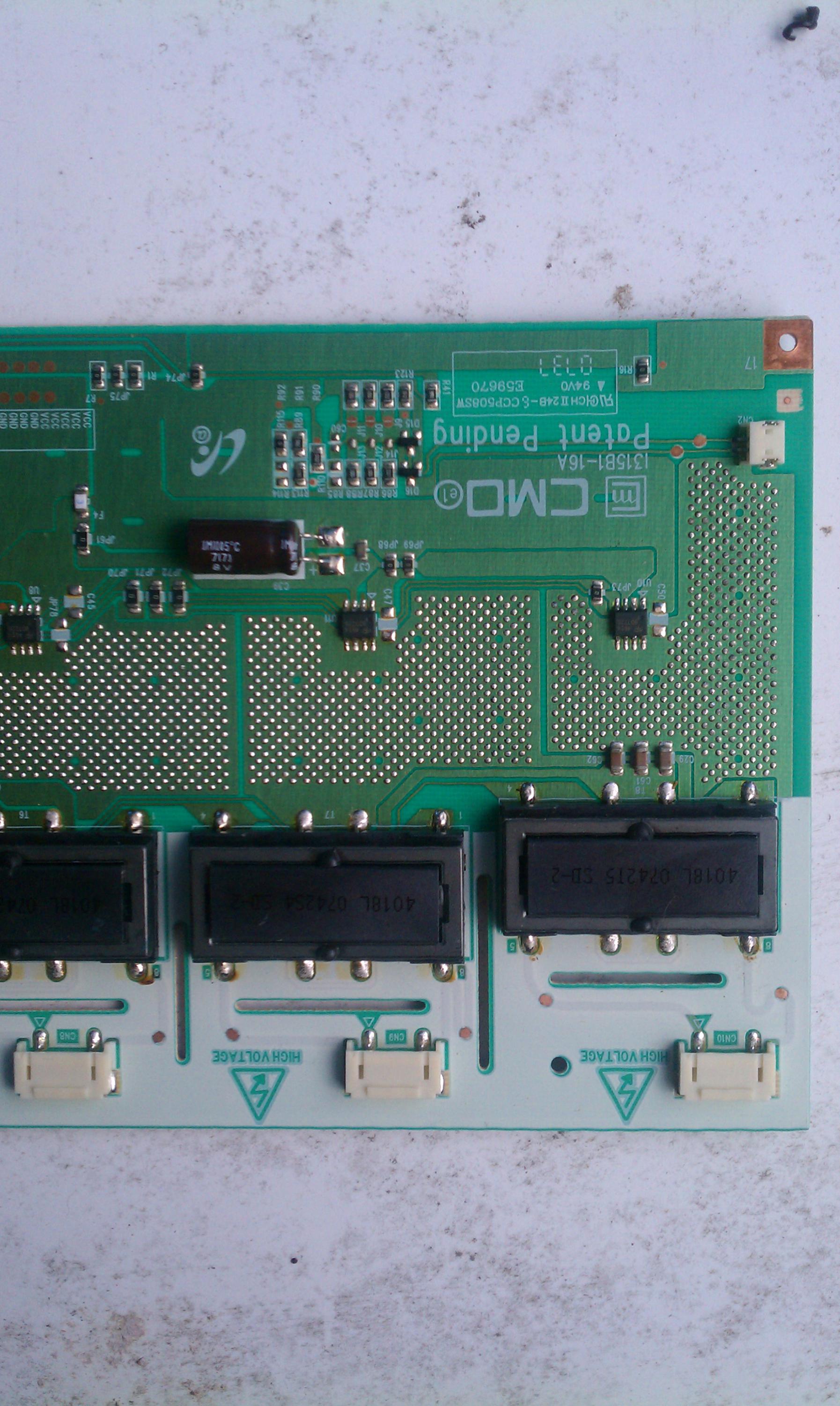

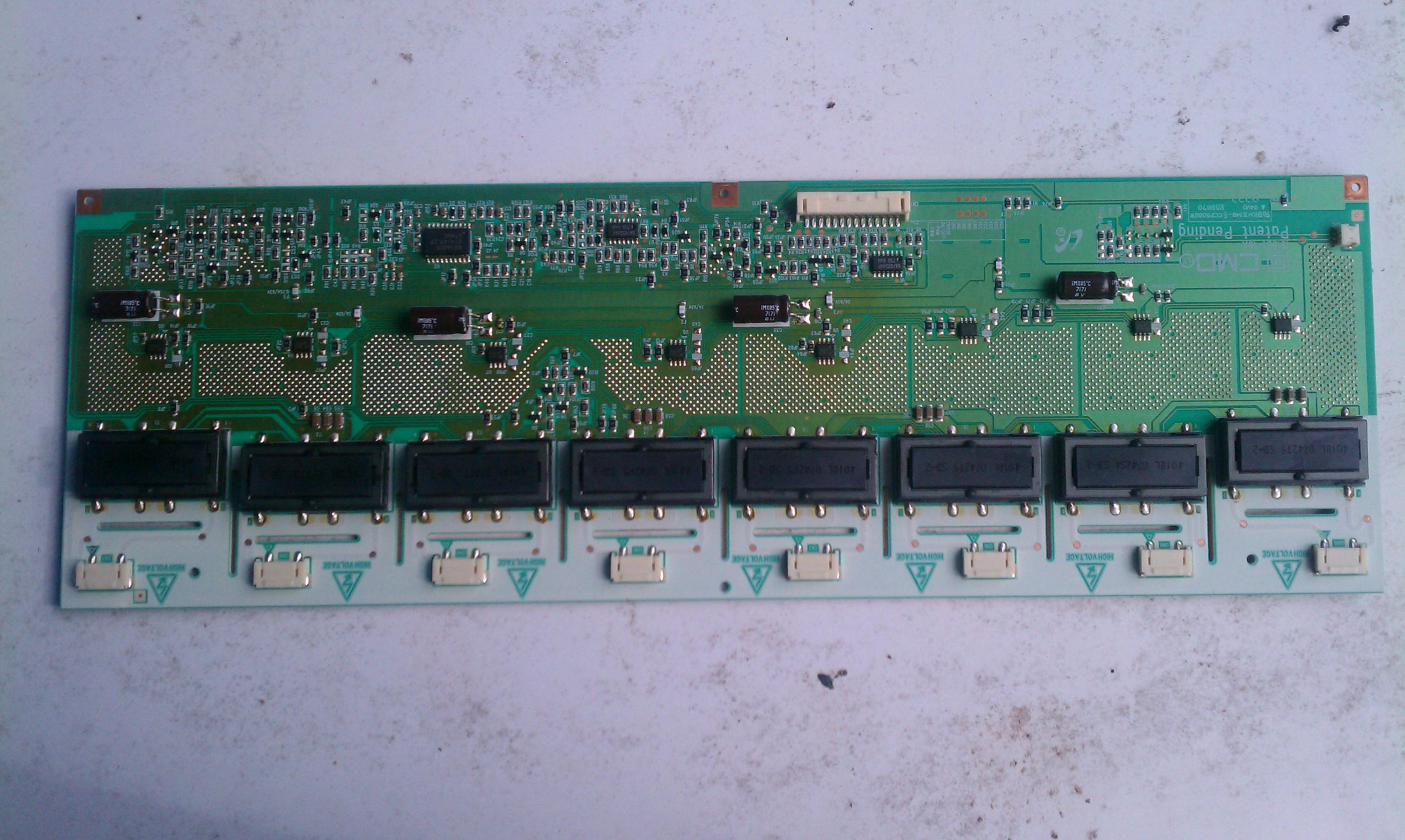

                      wish i had a better camera... but i guess its pretty good for a phone.
                      to get the best pics i take the board outside and put it in sunlight on the hood of my car (that needs a wash)
                      anyway heres the inverter pics

                          The way it works is this, if there is at least one bad lamp that is broken or not connected to the inverter board, the inverter will have to start up and try to light the tubes, if in the first 3 seconds, if the protection circuit detects no current draw (lamp not connected) or no constant current draw after firing phase (bad lamp), or too much current draw (bad lamp) for any one of the tube, the circuit will go into shut down. That is why you should see the lamps at least flash on first since not likely that all the lamps can go bad at once then shutdown.
