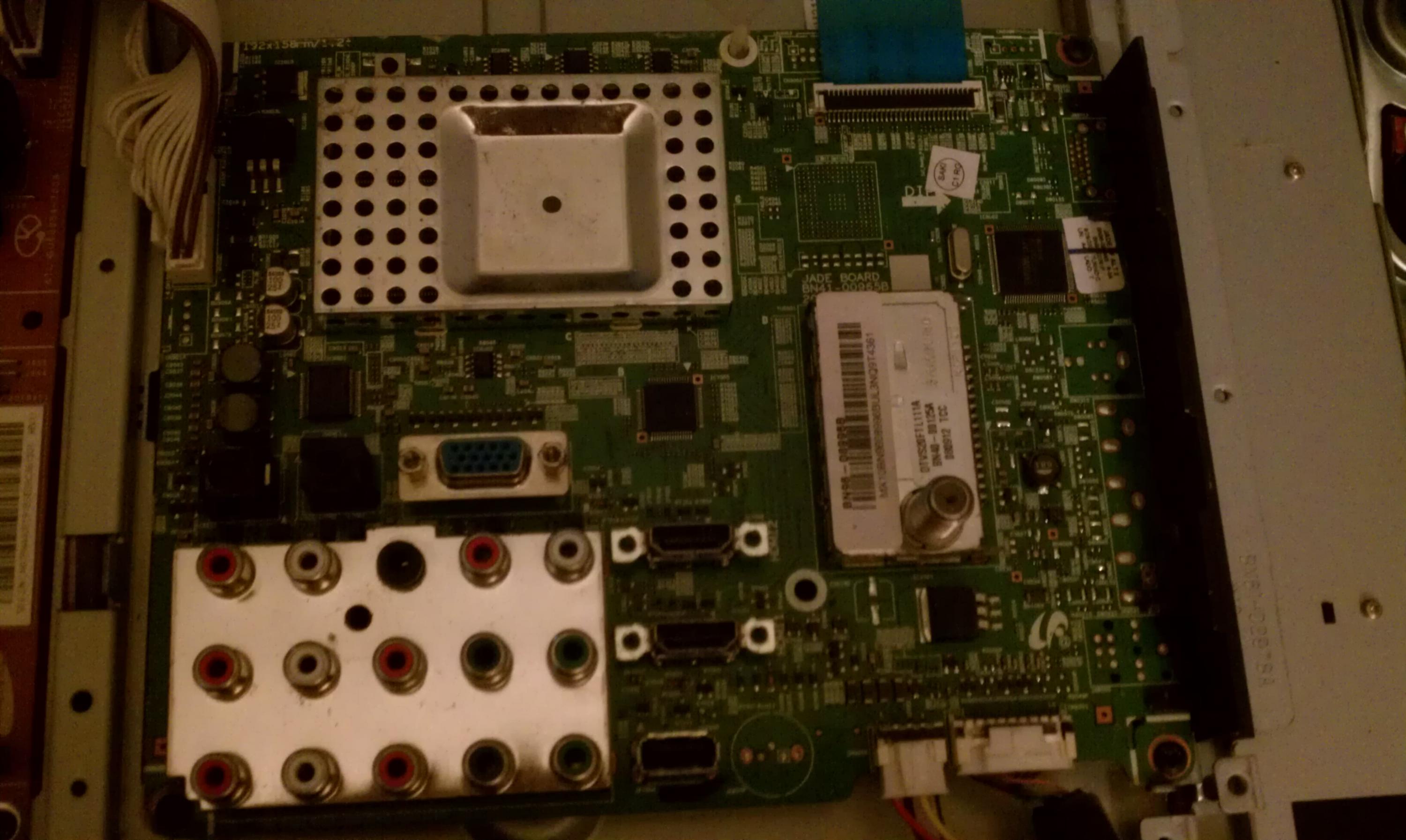

                                      ive been looking all over the service manual and i cant find eeprom anywhere...is this the same as "flash memory" ?
                                      there are at least 10 IC's with 8 legs on the front and the back of the board...

                                        I think the ic is a 24C32, 24C64 or 24C128, something like that. Not sure about the jumpering, we just used to replace them with blanks which the set then programmed at first power on.

                                          ok i found in the service manual where it says eeprom.
                                          in the parts list it says its in location IC112
                                          and in the block diagram it says EEPROM 24C256 and says its connected directly to the main ATI chip.
                                          i took off the metal shield to get to the main ATI chip and hopefully find this eeprom.
                                          but i cannot find a chip that says 24C256
                                          and i also cannot find a location IC112
                                          i have looked at the board for at least 30 minutes now and i am just not seeing it.
                                          this is the correct service manual, and the pictures of the boards look identical...
