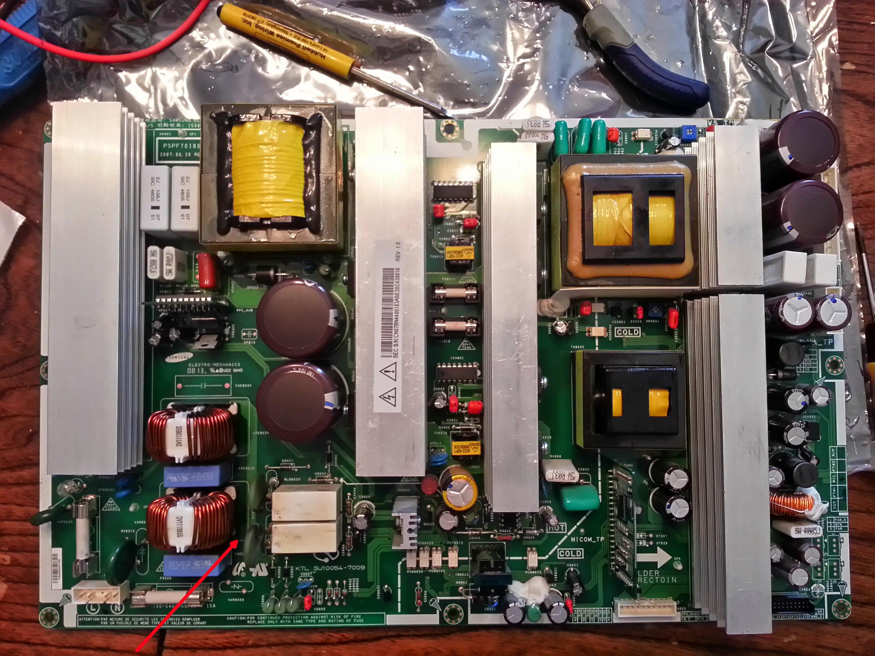

    Samsung PN58A55081FXZA pops main fuses
    I was given this unit since original owner couldn't get it to work. I removed the back, determined that one of the two main fuses was bad. I replaced it with same spec fuse and it immediately popped when powered on.
    I have pulled the PS and visually checked the caps and checked them with an ESR meter. All appear OK with caps.
    So I notice there are fuses on the other boards in the unit. Can I assume that if the short were on a board other than the PS that the fuse on that respective board would have blown?
    In checking components on the PS, is there an order I should go about to troubleshoot?
    Thanks much for any assistance.

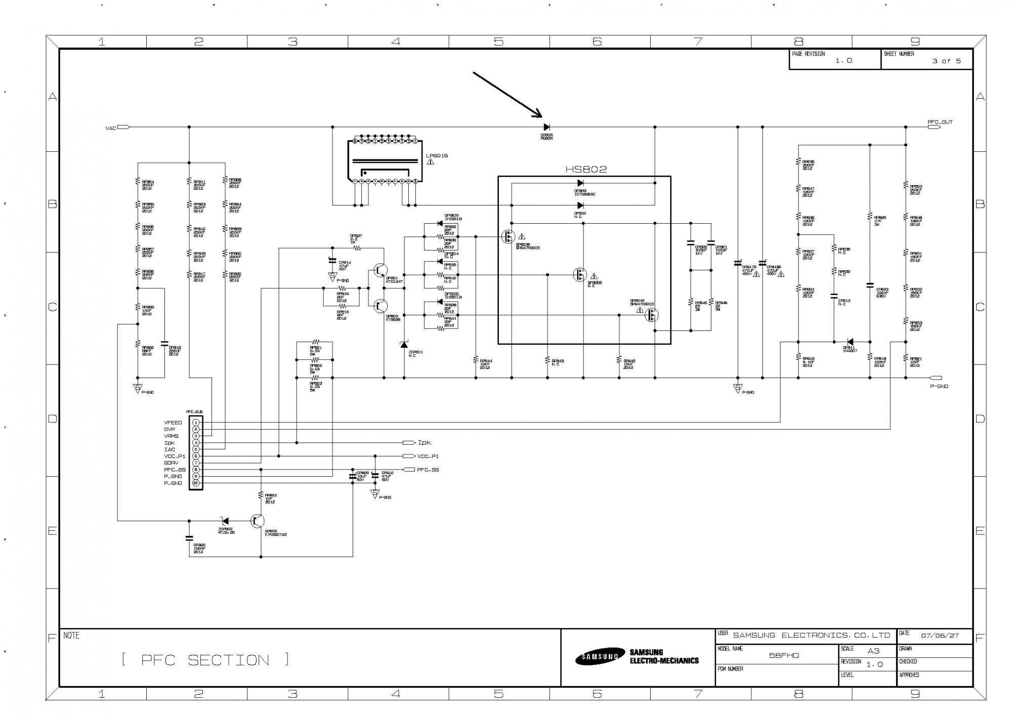

      Well it appears the rectifier DP808 is bad. I pulled it from the board to test again and it still failed.
      Anything else I should look at? The rectifier I pulled is located in A5 on attached schematic.
      Thanks for your help.
        Re: Samsung PN58A55081FXZA pops main fuses
        If DP808 is bad then it's possible that one of the FETs on the heatsink is also bad. Check those too. DP808 alone couldn't pop the fuse.

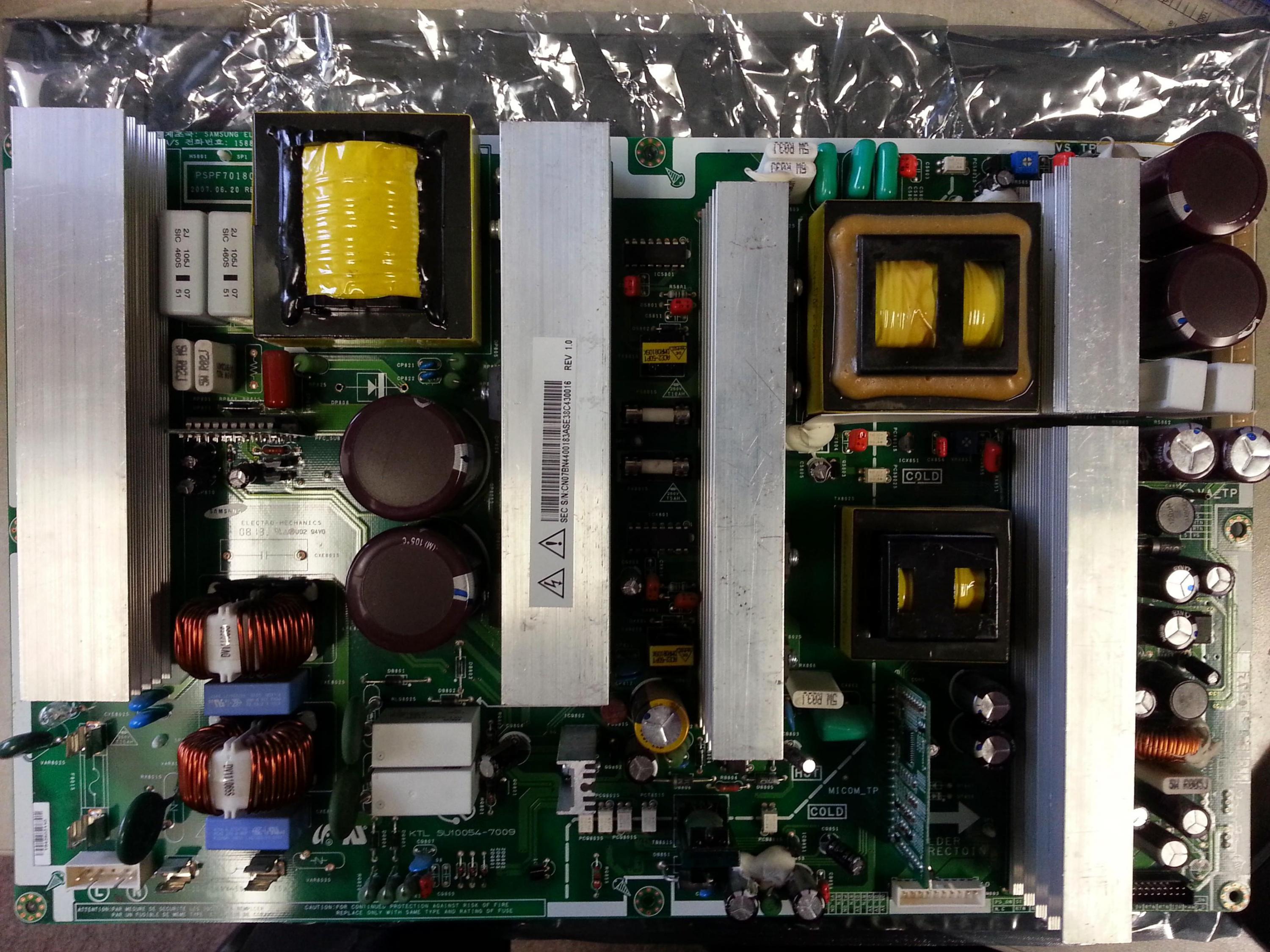

                  UPDATE:
                  So I replaced the MOSFET, driver transistors and driver IC and put it all back together and....
                  Got a nice little display of sparks. Both of the thermistors shorted out and burned before the fuse could pop. I'm thinking I messed this up somehow.
                  Any pointers on where to look?

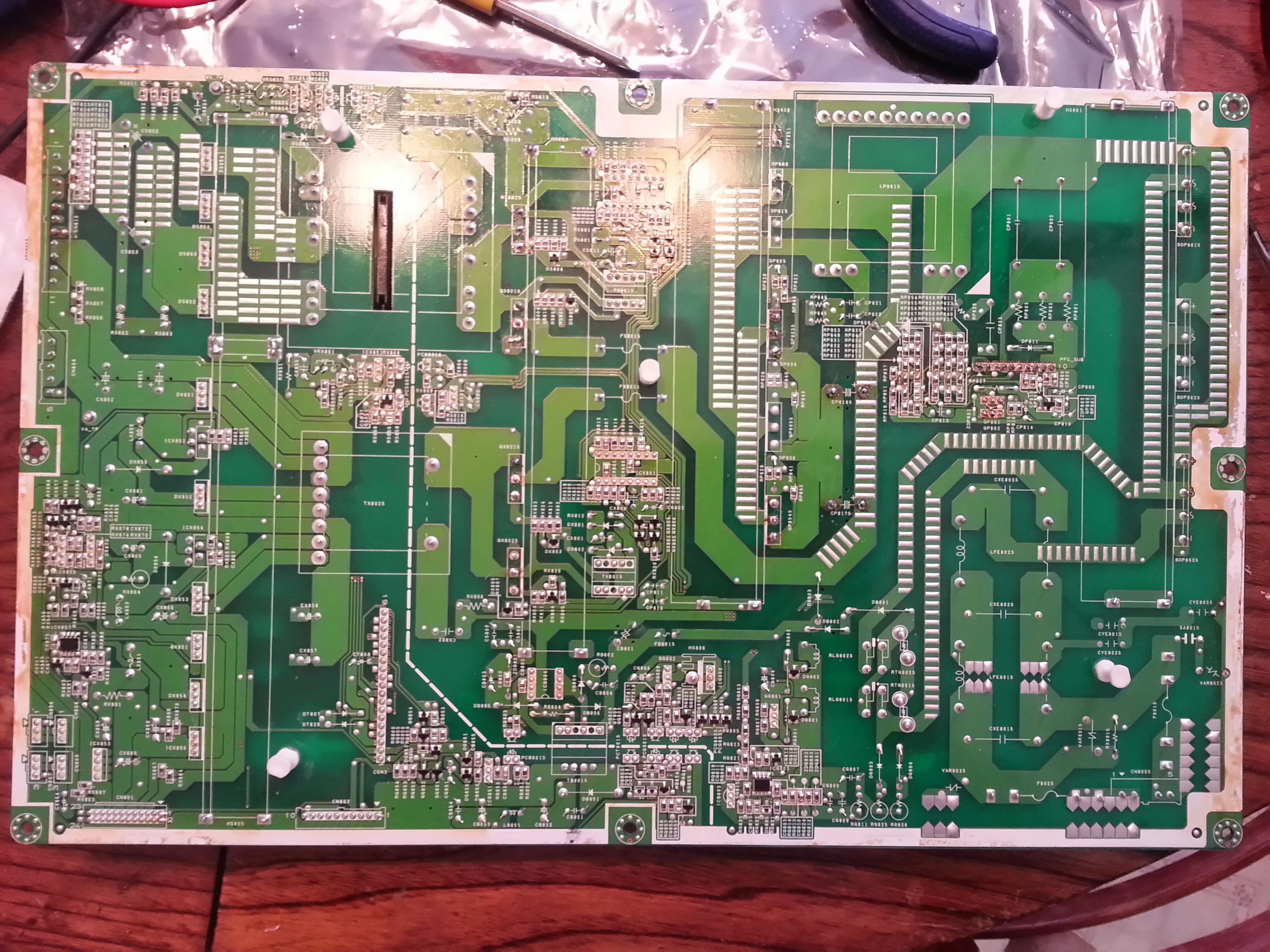

                    foto of the other side of the board please.
                    • LameCooter
                      • Jun 2012
                      • 35
                      • US
                      Here you go.
