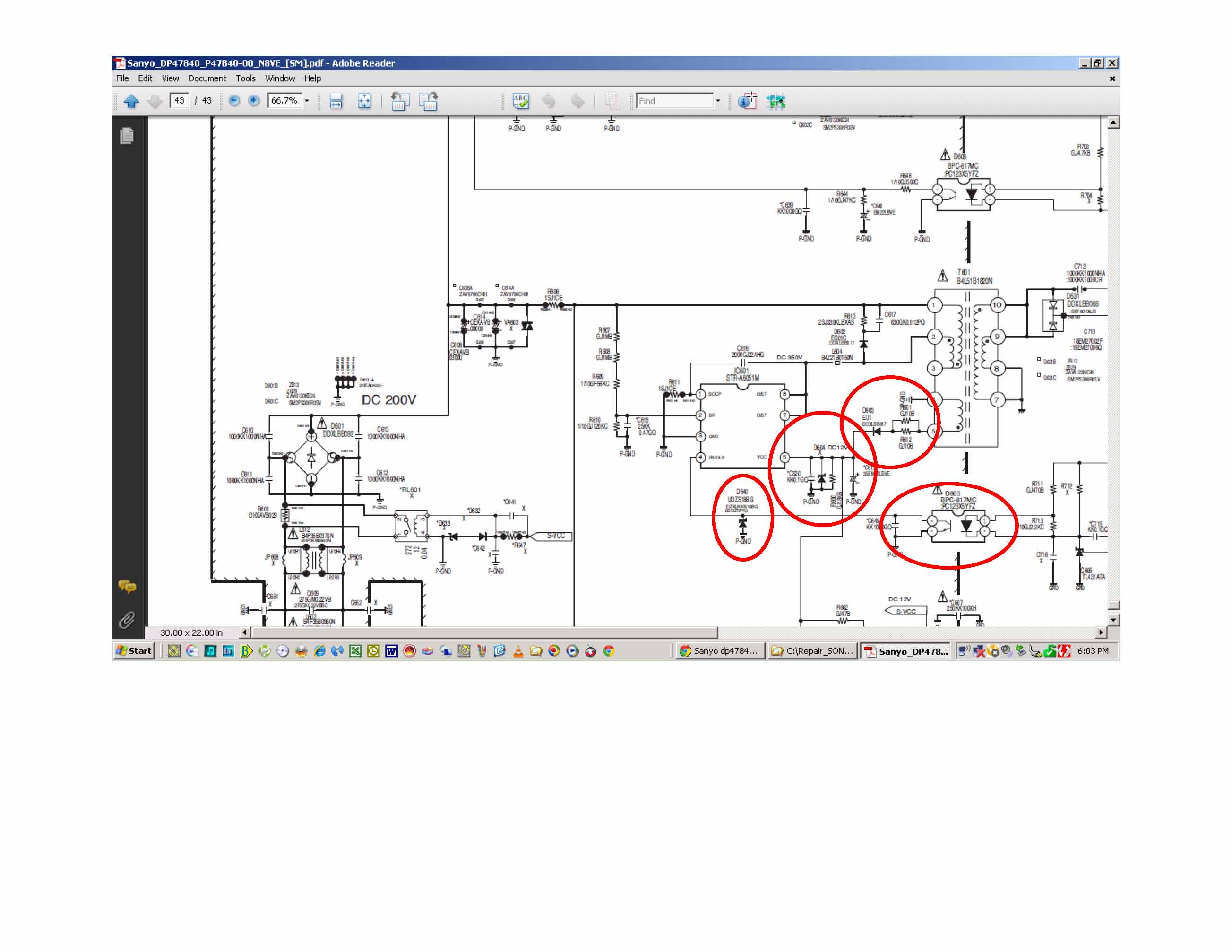

    Sanyo dp47840 No Standby Voltage
    I checked all the fuses. i have no voltage on the secondary side at all. i replaced ic601 which is for the 5 volt standby section but still didn't fix it. i have 170v across the main caps and 19v on the vcc pin of ic601. i thought then it might be r613 was bad but with it out of circuit it read 333k ohm which it is suppose to be a 330k ohm resistor so thats not it atleast i don't think so. i have 170v on 1 side of that resistor and about 256 on the other side where the drain comes off ic601. i checked all the diodes and caps and they seem fine on both the primary and secondary sides. i also checked the opto's and d631 which also seems fine.i did see that shopjimmy did have a repair kit but they are out of stock. maybe ic602 is bad but i don't know how to check it. i'm stumped any help would be appreciated. here is the schematic compliments of tom66. if pics are needed i will take some but hopefully we can figure it out with the schematic cause my camera sucks. page 43 has the schematic diagram.
    [SM].pdf&mfg=Sanyo

                                  Re: Sanyo dp47840 No Standby Voltage
                                  Since > 165VDC was dumped into the VCC pin and any thing that are connected to that pin, the ZENER is already damaged, I would say the Opto D605 is more likely to be damaged. You should also check all those components in red circles. You have spare IC too, right? If in doubt, replace the parts, that much of the high voltage can damage lots of parts.
                                    yeah i put in the spare ic but i don't have any of those zener diodes around. i tried to check all my spare boards but they don't seem to have what i need. i also put in another opto in d605 but i don't wanna try it until i get 1 of those zener cause i don't wanna ruin the new ic. i did check all those components and everything else seems ok i also replaced r612. d603 still reads resistance both ways and i'm positive it didn't prior to my mess up in circuit but if i take it out then it read the way it should so i might just change that also to be safe.
                                      i changed everything you had circled and still don't have any standby voltage
                                      • philliesfan30m
                                        • Aug 2013
                                        • 542
                                        ok now i have the 5vstb and i have approx. .3v on the ps_on pin and i have 2.3v on the line off pin. i think it is some kind of fault putting it in shutdown mode. none of the led lights on the front come on even though i have the 5vstb. the power switch works when i hit the button the voltage goes from about 0 up to about .7 volts. but the mainboard doesn't seem to be sending the signal. so i tried to jumper the 5v and the ps on and still nothing. i haven't checked the ir board but i think something on the mainboard is causing the problem. what is the line off pin for?
