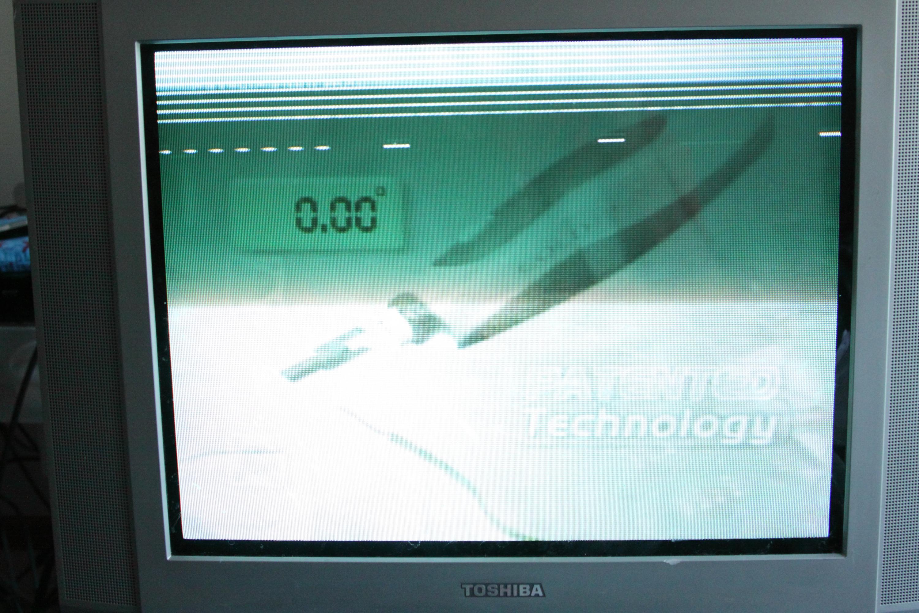

    Lines in toshiba crt tv
    MODEL 20AF41
    MFG DATE 2001 CRT TV
    I need opinions, info here.
    What to suspect, old CRT or worn caps? Ive heard electrolytics in the vertical circuit could do this.
    Thoughts all?

    Re: Lines in toshiba crt tv
    By the way, I have no schematic for this TV.
    But I am equipped with a full line-up of test equipment, except a capacitor tester, as I have never seen one that can reliably test caps in or out of circuit, even expensive ones.
    I test for ripple under load with an O-scope, provided the unit functions as this one does.
    Thanks in advance!
    -Lemur

      So only seeing just one vertical line?
        • 31287
        foto's of the problem please.
        and it's not the crt - they last and last.
        unilike modern crap, a crt that does not use a narrow neck can last 30years+
          I took a photo and forgot to attach it. Here it is.
            To me, looks like it is not blanking the signal properly on the vertical retrace. I know bad capacitors are common with many older Toshiba CRTs due to the use of Capxon capacitors.
            • ENERGYSAVINGS
              Lemurjumping
              • Jun 2014
              • 56
              The picture looks bad because the shutter speed was too fast, the actual picture on the TV is good except for the lines at the top of the screen, at its worst, there is actually some "wrap around", or "foldover" your choice, at the top.
                • 31287
                probably small caps in the vertical timing area.
                does the picture look shifted down if you use teletext?
                because it could be your seeing the "hidden" lines used for teletext/closed-caption data.
                  Replace C436, C407, C406. As seen on the schematic, page titled "Deflection schematic diagram". Should work fine then. Of course, also check for other bulged caps while you're in there. Those mentioned are too small to bulge, they would have simply dried out.
                    and check for broken solder joints on all transformers and parts bolted to heatsinks.
                    broken soldering was common on crt tv's
                      By small caps, do you mean not electrolytics?
                      I don't have the time to reverse engineer the TV, so it looks like I'm going to be shotgunning alot of caps. I haven't had to deal with this problem before, and could use a little direction of what area to shotgun, if some else has the experience/ knowledge.
                      By the way, I tried the text mode, it seems to make no difference.
