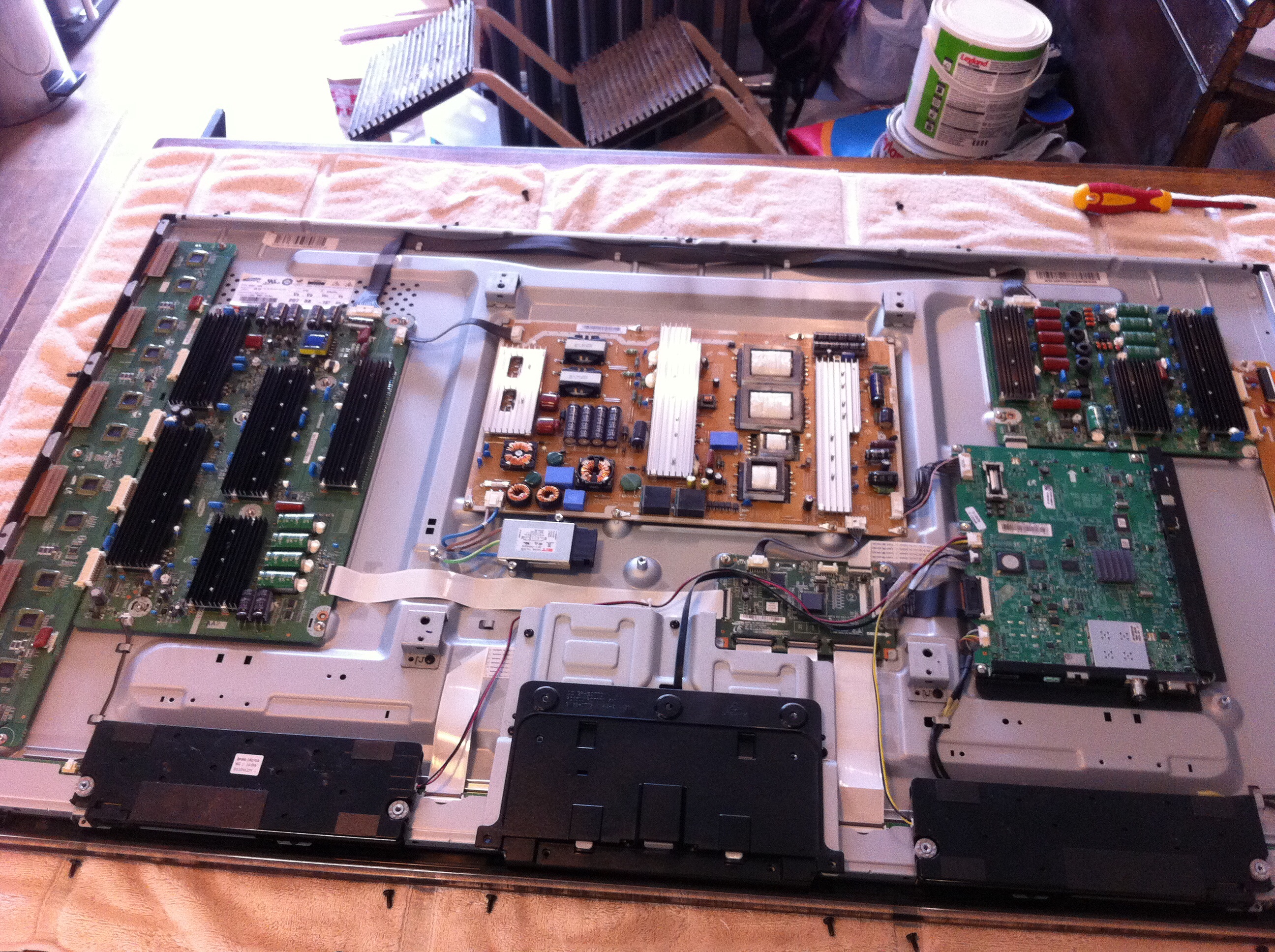

    Re: Samsung ps51d6900 dk will not switch on
    A picture of the back of the TV
      blink every 5-7 seconds indicates X-main or Y-main drive fault, do you have a digital multimeter available?

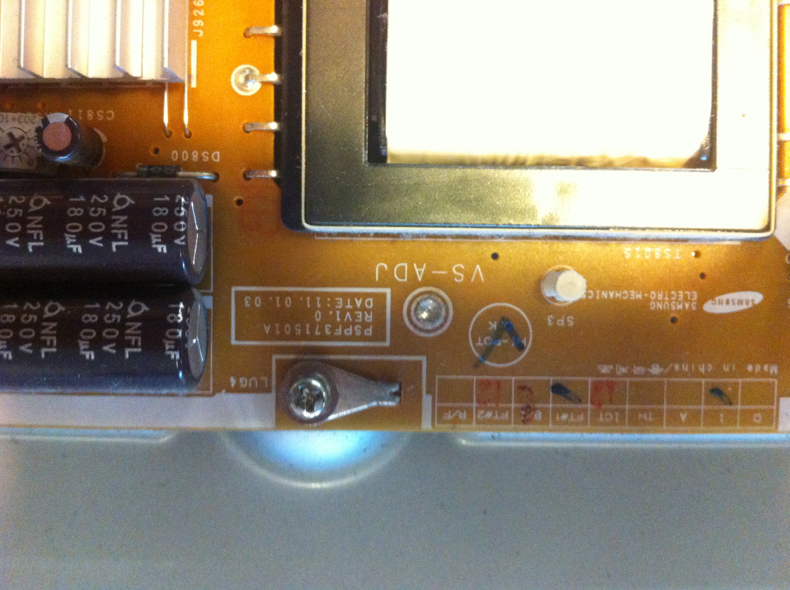

            Originally posted by tom66
            OK try to locate the Vs test point on the power supply and take a measurement there. Red probe on the test point and black probe on a part of the metal chassis, reading should be in the range of 205~215V, DC.
            Will it be called "vs-adj"
            See pic
              That's the one.

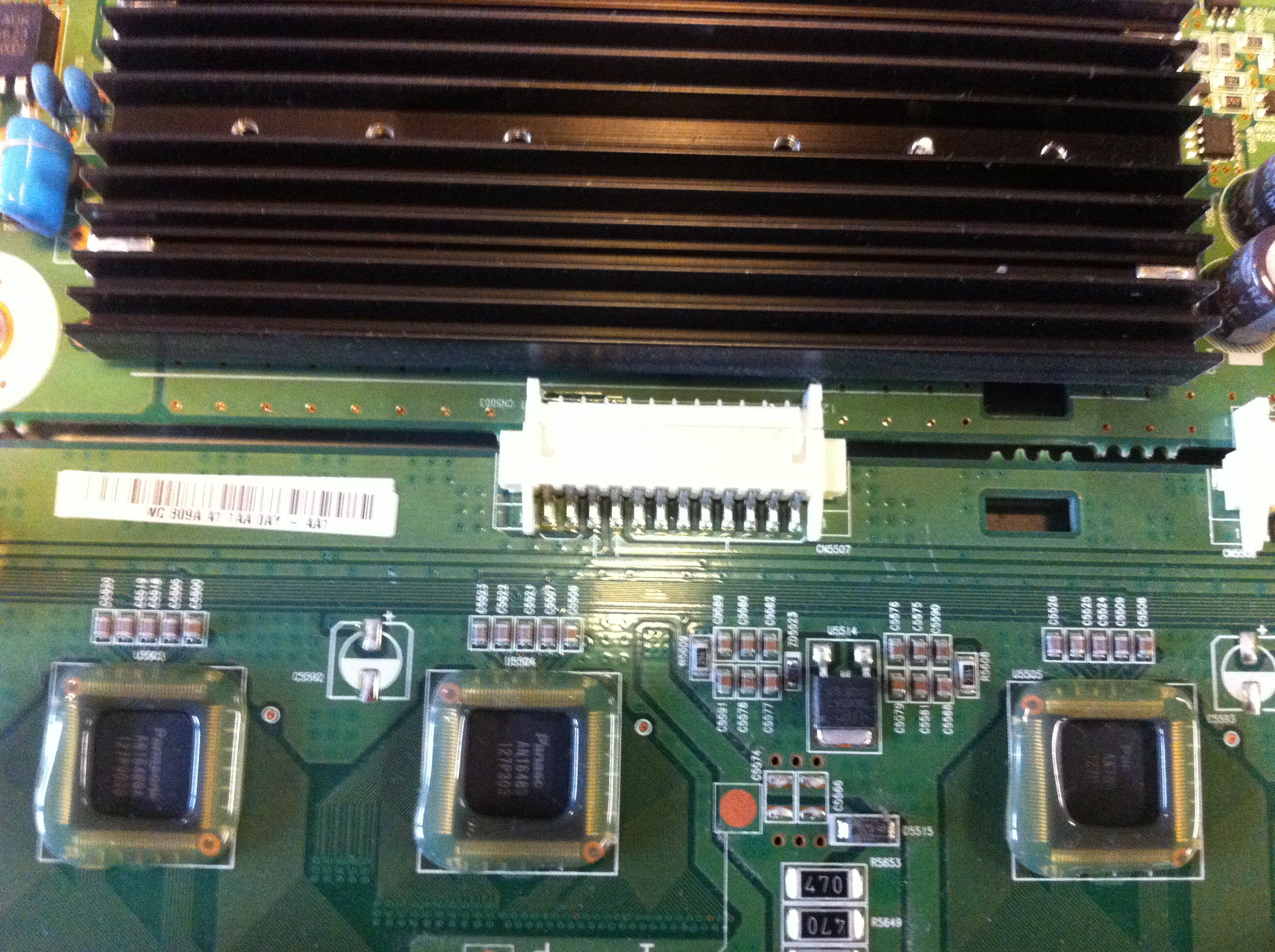

                      OK, this indicates there is no short, so the next step, I will need a picture of the Y-main and Y-buffer. In your photo above, these are the large boards on the left hand side of the TV.

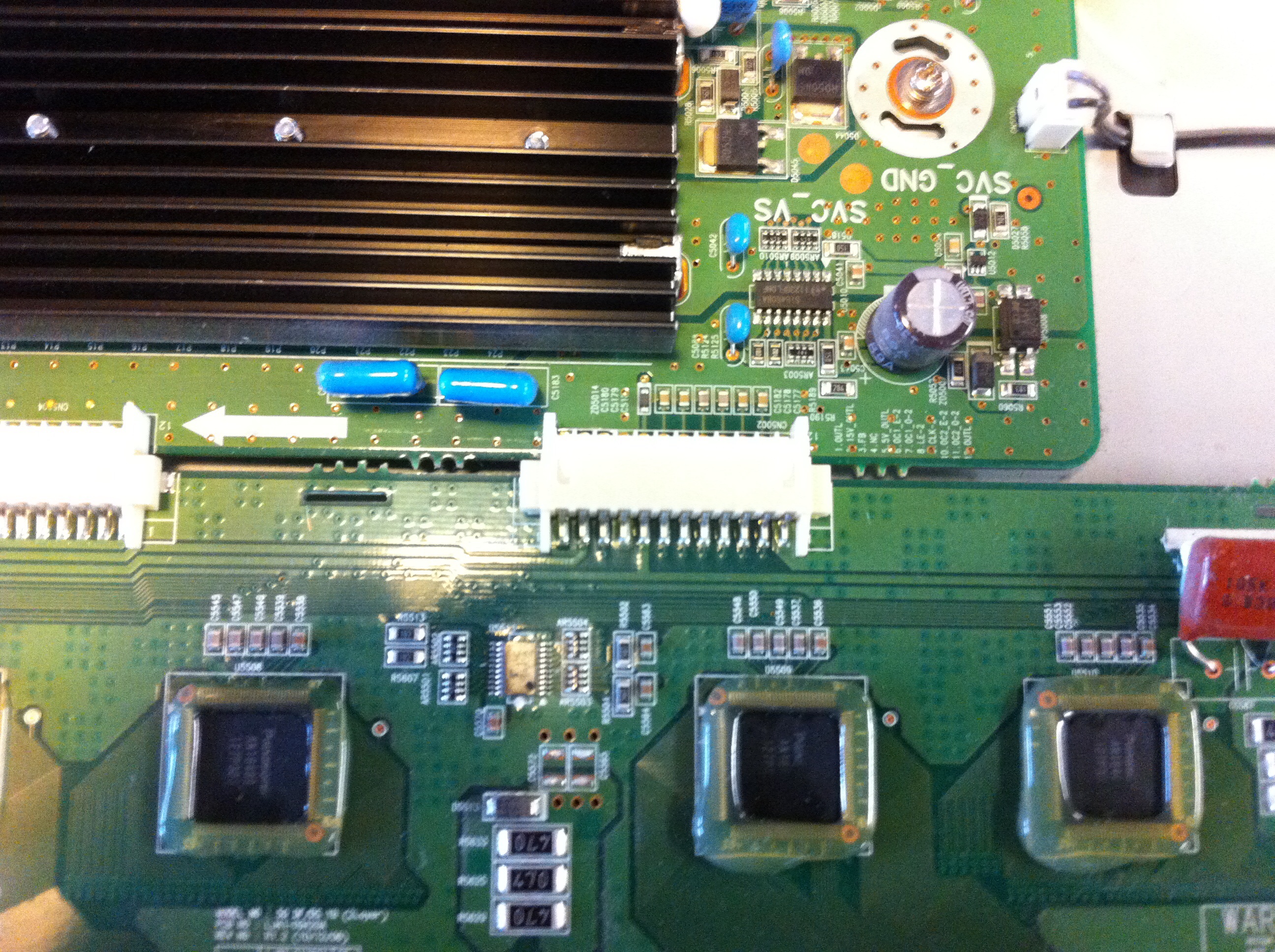

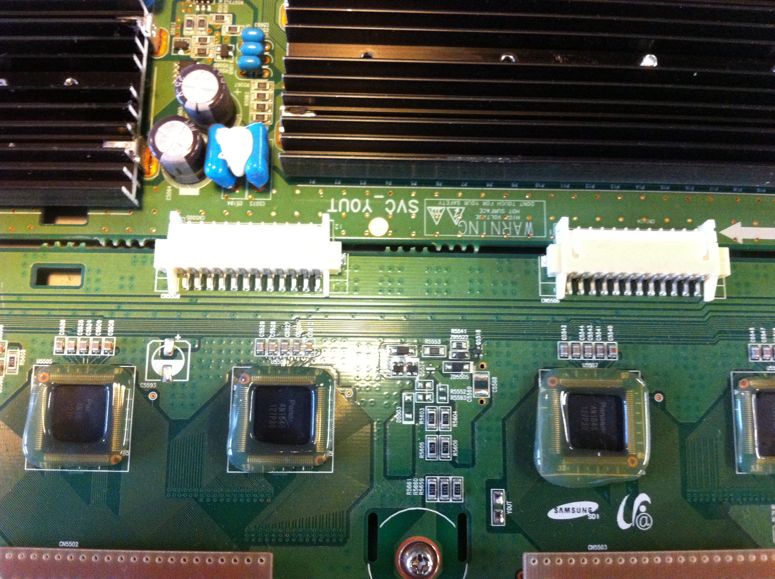

                        Are these ok?
                          There is a point marked VSCAN on the Y-main board, please test this. Should be about -187V according to panel sticker. The reading will be negative.
                          Could you get a clearer shot around the connectors where the buffer boards, bottom half, meet the Y-main board? I need to see the small traces.
                              • Miller r5
                                • Jun 2014
                                • 30
                                • Scotland
                                • Miller r5
                                  • Jun 2014
                                  • 30
                                  • Scotland
                                  And finally
                                    OK, you see the points marked SVC_OUTL and SVC_OUTH on the buffer board? Measure the voltage between these points i.e. black on OUTL and red on OUTH.
