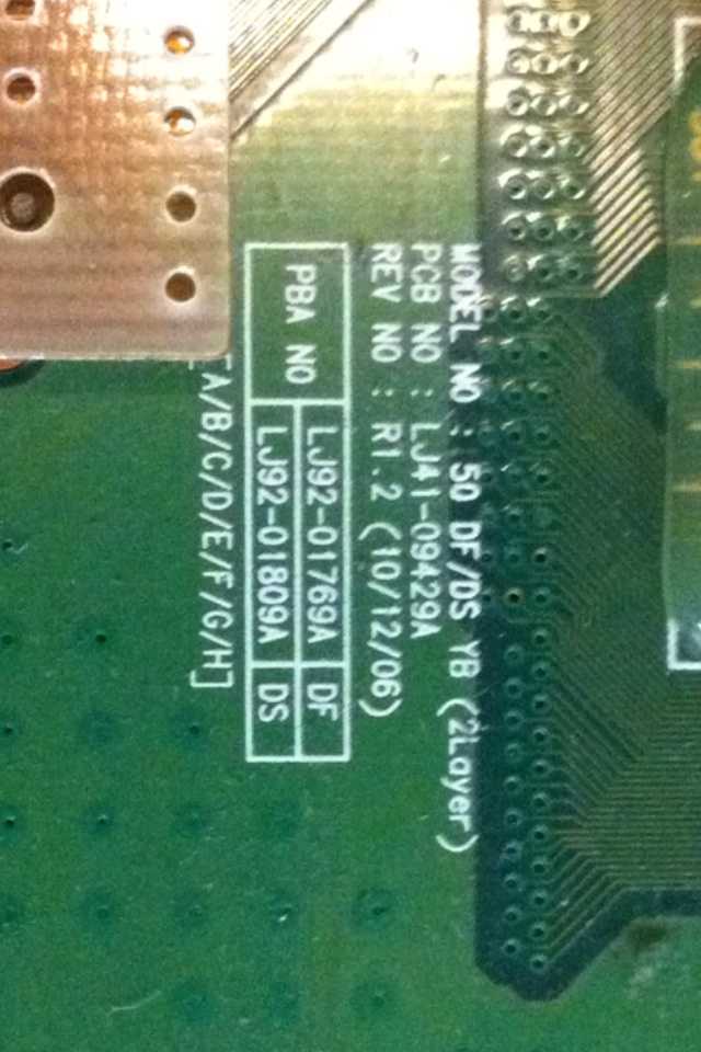

                      Re: Samsung ps51d6900 dk will not switch on
                      I have found a NEW board and as something this delicate I would prefer new. The only thing I can see differently is the rev and date would this be a problem?
                      http://shop.sjstv.co.uk/lj92-01809a-...new-2525-p.asp
                      Cheers
                        Originally posted by Miller r5
                        Hi tom
                        I have removed and tested the panel per the link and found the second top set of wires to be faulty. Only the first three from the probe in the attacheched picture. Does it just take one to be at fault to loose the whole screen?
                        Would I be right to assume the position of these wires run the full lenth of the screen? then this is roughly where the crack is!
                        Cheers
                        Chris
                        The drive lines do run the length of the screen.
                        If the short is there, then it is an awful bad coincidence that the panel is also cracked there.
                        Installing a new board might fix the TV, but it could fail in a few months, or it might fail immediately. It is hard to be sure.
                        That SJSTV board will be fine if all connectors are the same - rev number not important for those boards.
