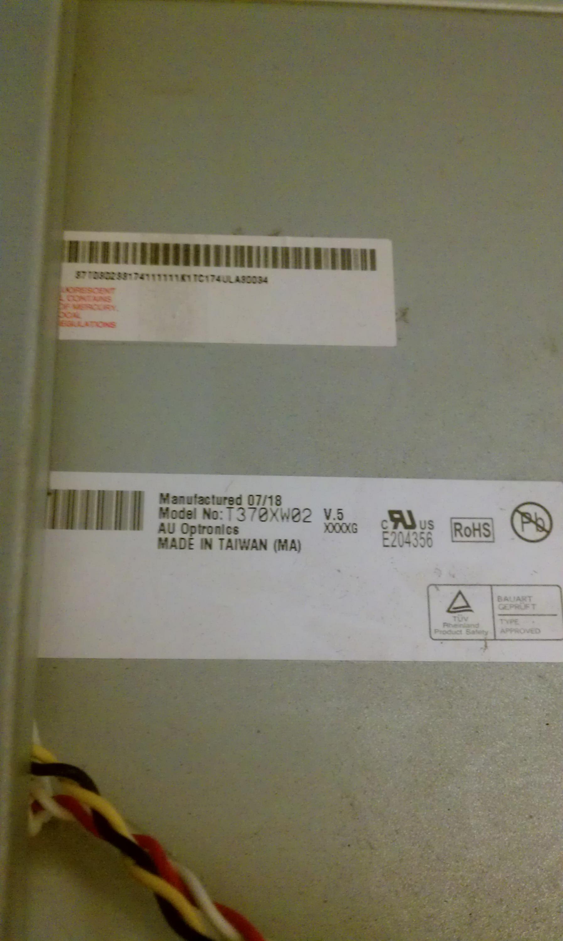

                    Re: VIZIO VX37L HDTV10A has messed up color
                    im having trouble saving up the funds to buy a decent hot air station, but if i could get this tv fixed by just replacing the TCON board, then i could sell it and be a lot closer.... trouble is when i type in the numbers on the TCON board the cheapest one is like 40$
                    but when i just type in
                    VX37L HDTV10A
                    i can find one selling for only 15$
                    it says its out of the same TV, but the TCON board itself is obviously different.
                    are TCON boards in any way interchangeable?
                    whats going on here? cause id really like to just buy this 15$ board if it is compatible.
                    http://www.ebay.com/itm/VIZIO-VX37L-...item2ed0f7114b
                    Don't fear the repair...
                      #30
                      You can have more than one version of the same model TV, one model may use screen from one manufacturer, then 6 months later they may have found cheaper panel from another manufacturer and use the new one. The T-CON has to match the LCD panel model.
                                    ok i finally got around to looking at what model of LCD is in this thing...
