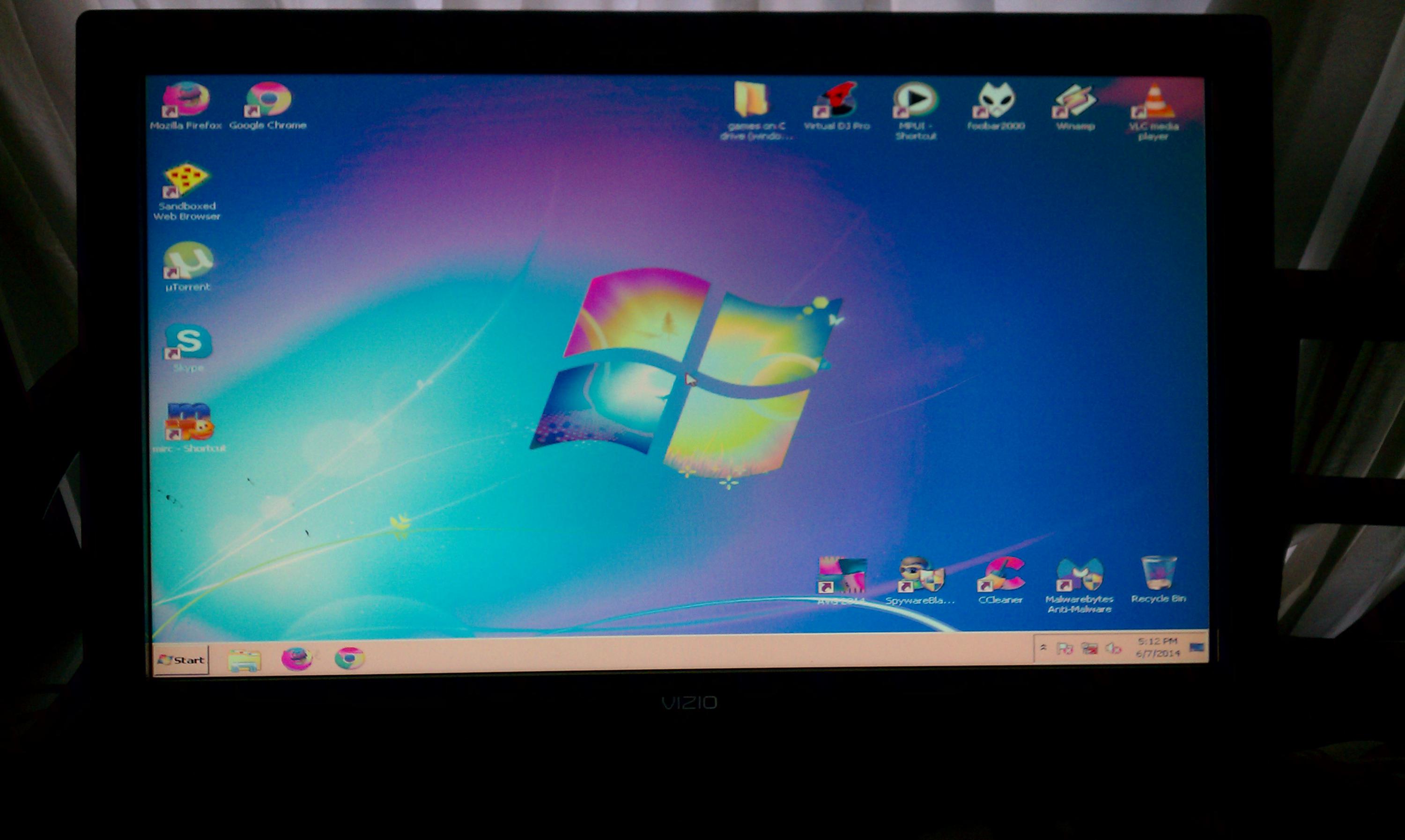

    VIZIO VX37L HDTV10A has messed up color
    i picked this TV up from the recycling place for 20bux because it mostly works but just has a color problem. the guy said it was most likely the TCON board. does that seem right? i guess first thing ill do is take it apart and check for loose connections and blown caps. but how do i accurately test the TCON board if its not something obvious?

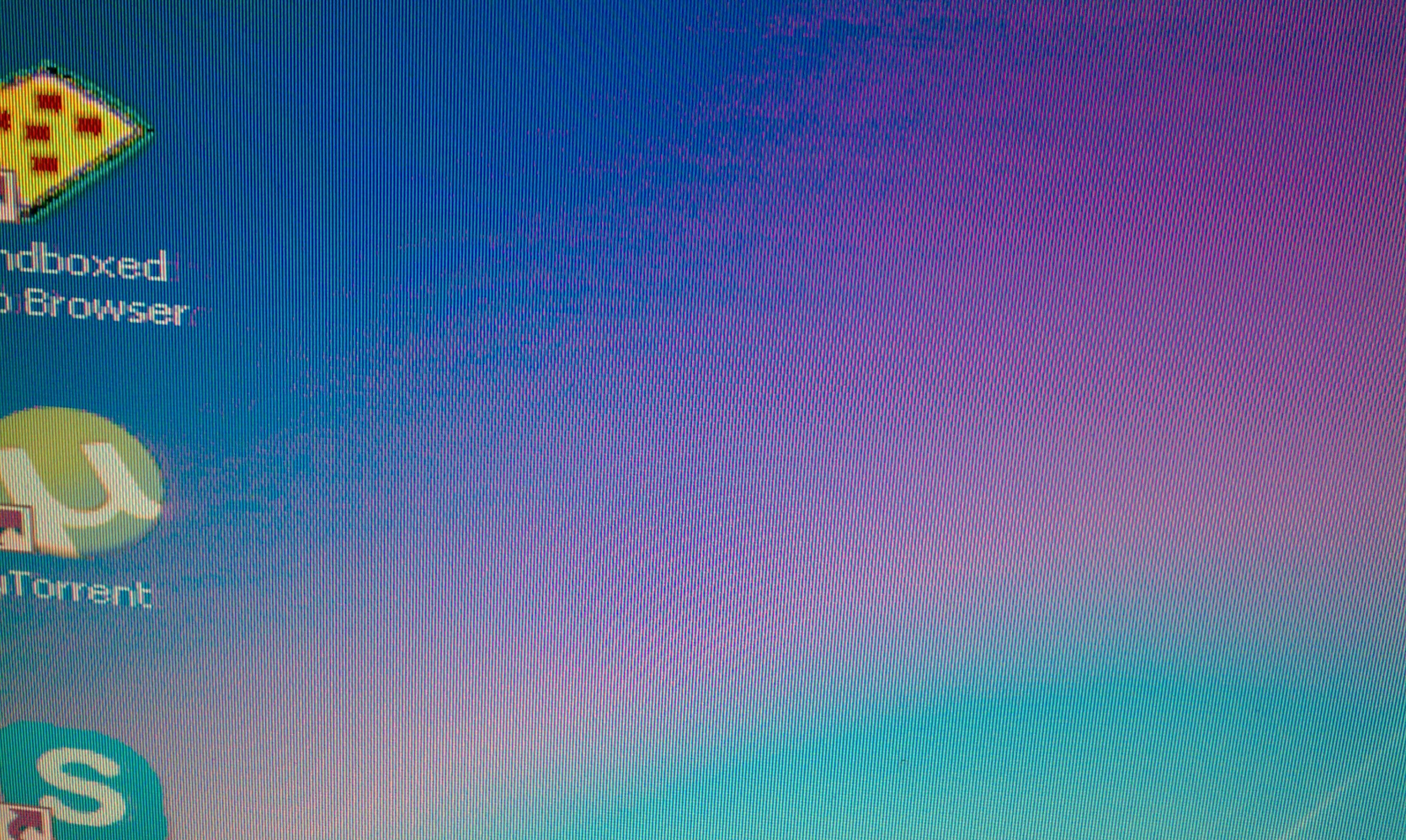

    Re: VIZIO VX37L HDTV10A has messed up color
    as you can probably guess, the pink is not supposed to be there
      Probable Gamma fault--Check the Vgama voltages....

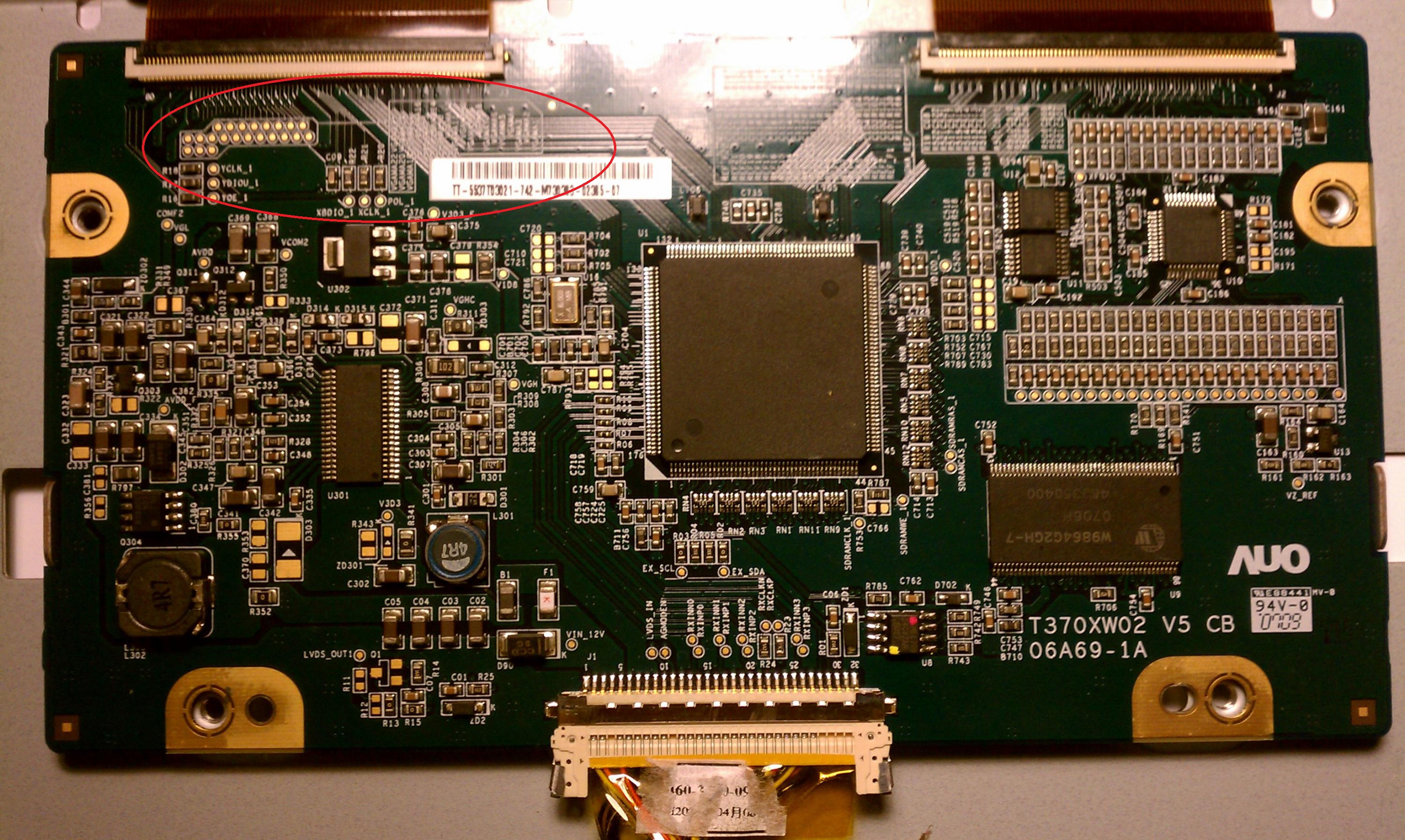

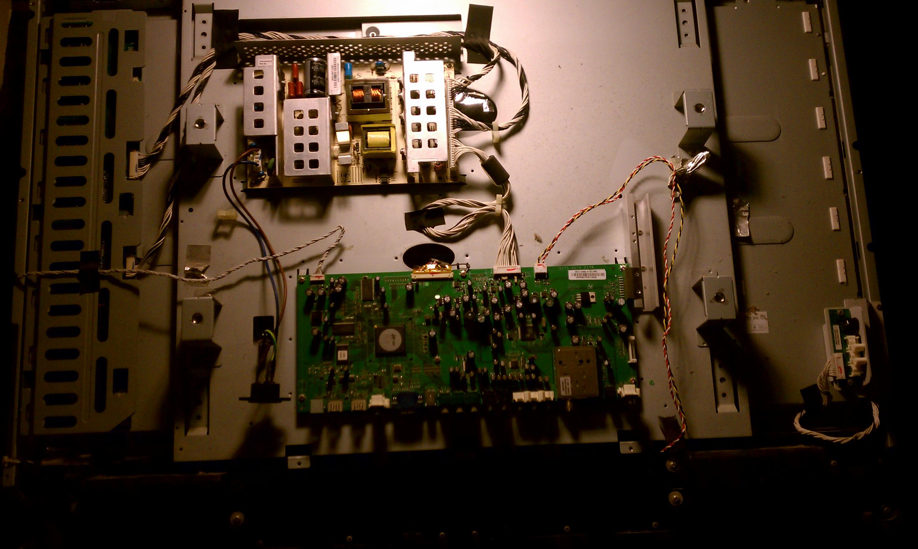

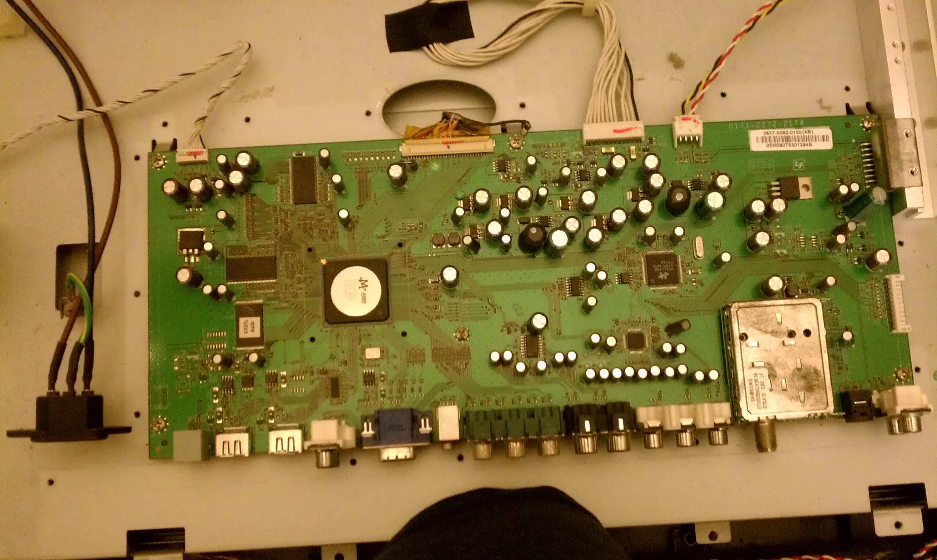

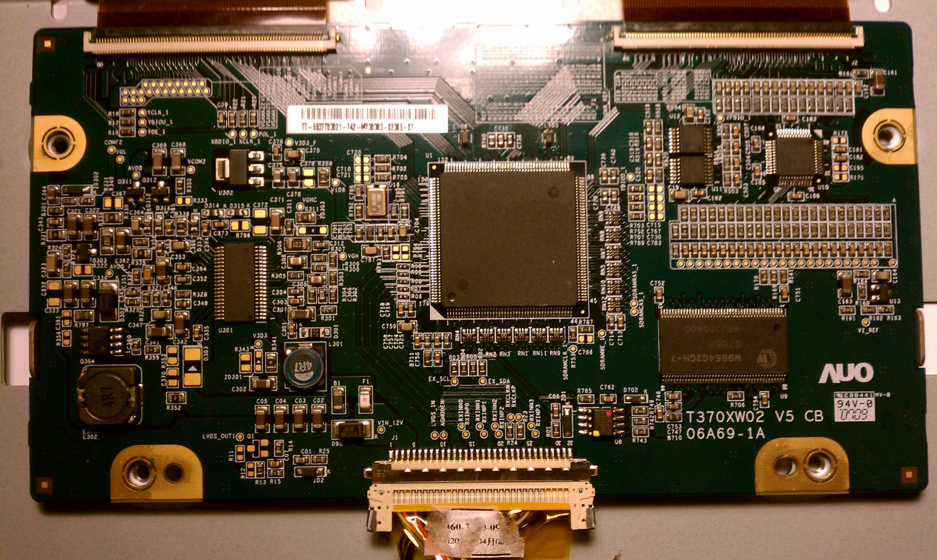

              ok so i took it apart.....too many screws!!
              i took pictures of all boards
              the tcon board is underneath the mainboard and powerboard.

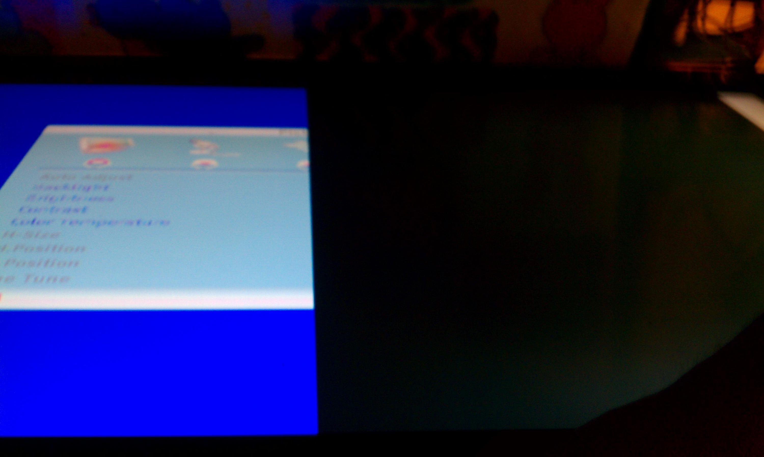

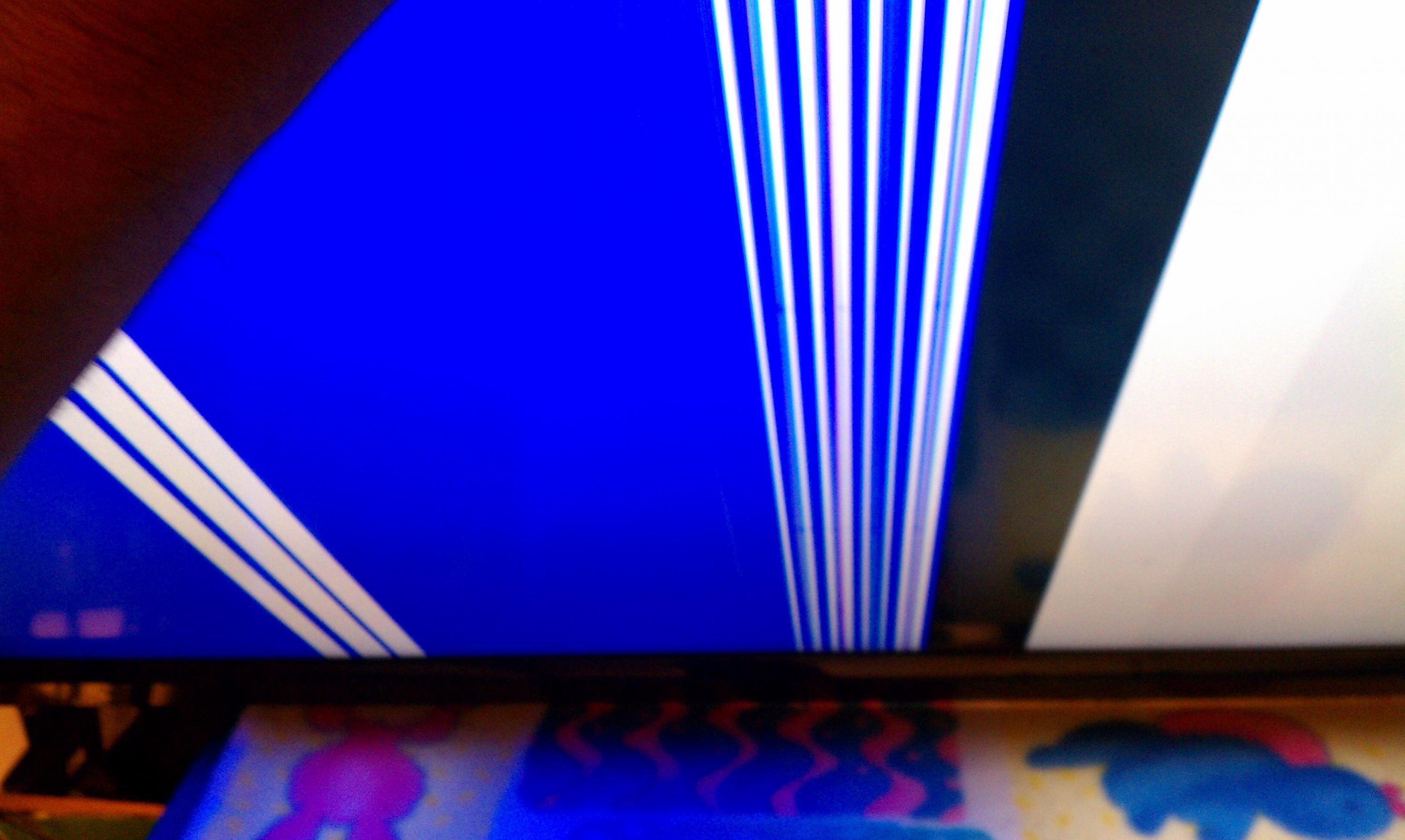

              i disconnected the left cable of the tcon board and powered it up
              and i got one half of the screen black and the other half still showing messed up colors.
              i disconnected the right cable and reconnected the left cable and i got crazy vertical lines all over the whole screen, and i could just barely make out the menu screen faded in the background.
              im not really sure how this testing of the TCON board works i only know i read other people doing it so i figured id try it too and post the pictures.
              so check it out and let me know what you think is happening.
              thanks again!

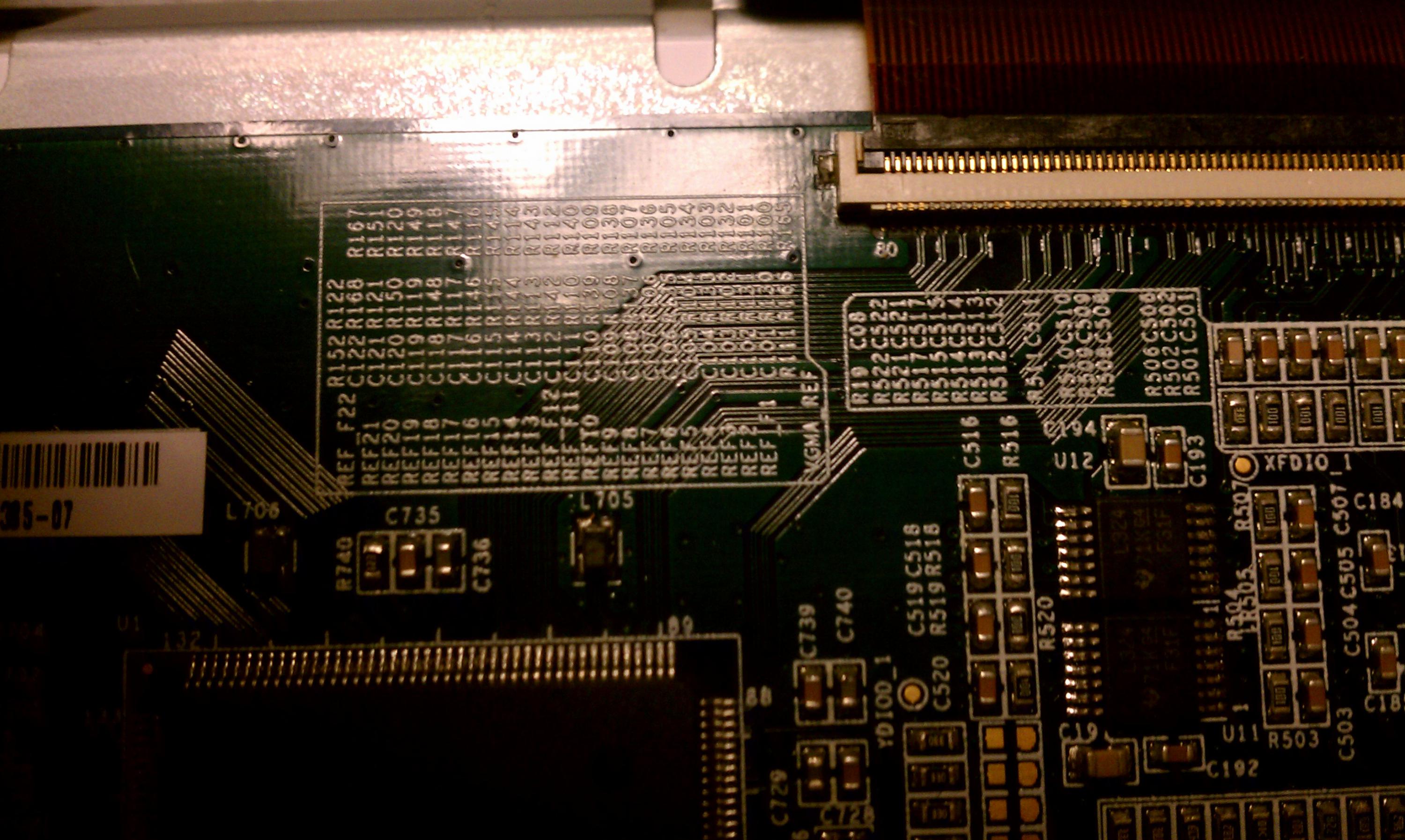

                See where it is labeled Vgamma1..2..3 etc
                Report all your measurements for each here.
                Hmm, I dunno about the vertical lines, usually that indicates a bad panel when one end of the tcon is disconnected. But first lets check your gamma voltages.
                  whew that was a lot of measurements.
                  ok if we look at the picture and say we have 2 rows of pins
                  a top row and a bottom row
                  the top row goes like this:
                  7.29
                  3.10
                  4.01
                  4.34
                  4.86
                  6.82
                  7.56
                  10.47
                  10.8
                  12.27
                  15.22
                  and the bottom row goes like this:
                  0.31
                  2.55
                  3.54
                  4.63
                  6.68
                  7.32
                  12.96
                  10.49
                  11.41
                  13.45
                  15.36
                  what do we know from this?
                      I can't tell from your labels how the numbers are going but you'll have to put it in the correct order
                      Vgamma1
                      Vgamma2
                      Vgamma3
                      Vgamma22
                          i had it on for 30 minutes at least maybe an hour and i didnt notice it getting worse..
                          ok heres the revised table of voltages:
                          the rightmost pins of each row are vgamma1 and 2
                          vgamma --- voltage
                          1 - 15.36
                          2 - 15.22
                          3 - 13.45
                          4 - 12.27
                          5 - 11.41
                          6 - 10.8
                          7 - 10.49
                          8 - 10.47
                          9 - 12.96
                          10 - 7.56
                          11 - 7.32
                          12 - 6.82
                          13 - 6.68
                          14 - 4.86
                          15 - 4.63
                          16 - 4.34
                          17 - 4.01
                          18 - 3.54
                          19 - 3.10
                          20 - 2.55
                          21 - 7.29
                          22 - 0.3
                          Don't fear the repair...
                              if i recall all the voltages should go down in a pattern to like 1.5 volts looks like 21 and 22 has an issue...
                                AS15 Gamma ref. chip--almost certainly faulty.
                                Be sure to get the one with the same suffix, as in 'G' 'F' or 'U' They are pretty cheap, I paid about a fiver for two not so long back....
                                    Yup, its a SM chip, but with care, can be replaced with normal iron and methods, Look on youtube, there's some vids of it being done.
                                    Only one thing--Make sure when you're fitting the new one, be careful of the alignment, check with strong eyeglass that all four sides of pins are exactly on the pads--Makes soldering easier and less likely to short between pins....
                                    Also--Make sure pin 1 is in the right place--Yup, Ive done it!
                                      i cant seem to see a chip on here that says AS15 on i...
                                      • triplefour
                                        • May 2014
                                        • 1747
                                        oh wait i see it... but theres so many tiny legs!! how can i solder that with just regular (super crappy) soldering irons?
