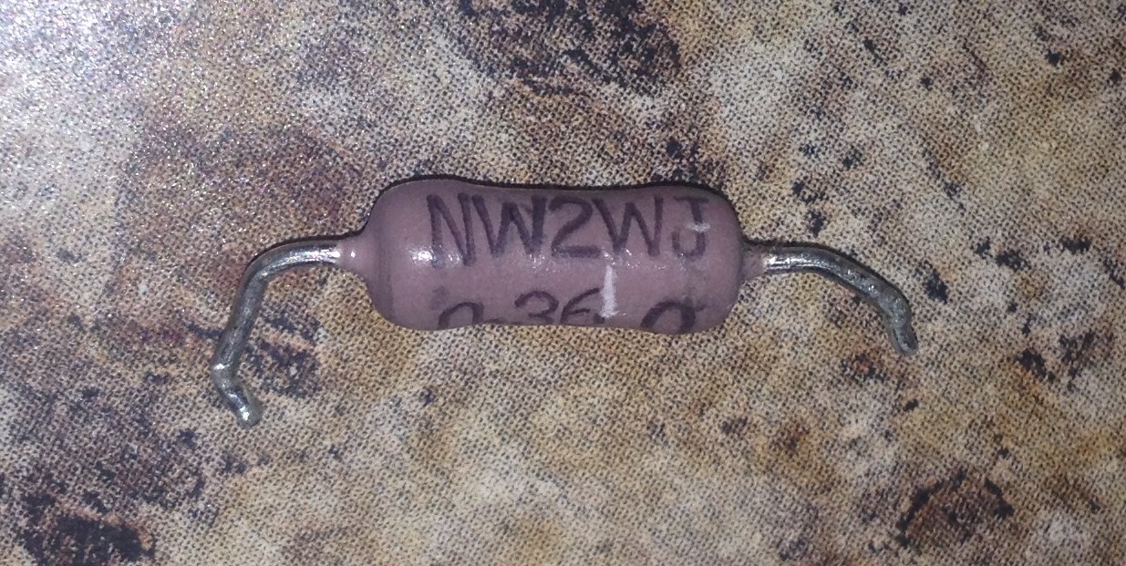

    Hey guys, got another issue here. Picked up this LG 50pj350 yesterday. When tv was powered up power supply would click, flash WHITE screen briefly, then shut down. Continously. So I replaced the 22ohm resistors today, powered tv on everything worked great! Or so I thought, let tv run for about 20 minutes, and it shut down. Now I only have standy light, no response from controls on tv or remote. I have seen the posts about the voltage regulator on similiar models, but there issue was a little different.

    I found this shorted power resistor next to the voltage regulator. But cannot find a replacement anywhere or even a data sheet. # NW2WJ . 0.36 ohm.
    Anyone?

      Its a .36 ohm 2watt resistor, it will check (shorted) .36 ohms to be exact

        Very good sir, you are right. Now that its dark out i was able to see that the tv screen was lit. All my voltages are good on the ps.
