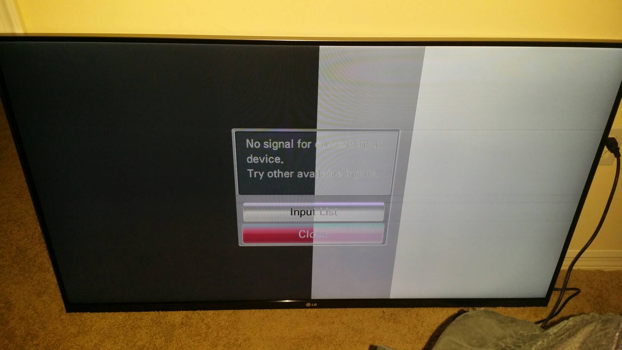

    I have a prospective tv someone has offered to sell me. Here is a picture of the issue. Any idea what this might be?

    99% bad LCD panel

      Fixable Tab bond issue with the panel or should I pass this one up completely?

        Pass it up, it will not be fixable in most cases.
          Re: 2012 LG 55" 3d 55LM7600 - Half screen is grey
          If its super cheap like in the 20-40 dollar range, hell take a chance if anything you can recoup your funds and then some by parting it out.
          But anymore then that I would walk away!

            Yea I just got one of these it is a 55lm6700 though with the same problem. I was supposed to buy it for 30 but after finding it had a short in the right side of screen I wouldn't pay anything for it and he gave it to me. It's just sitting now.
