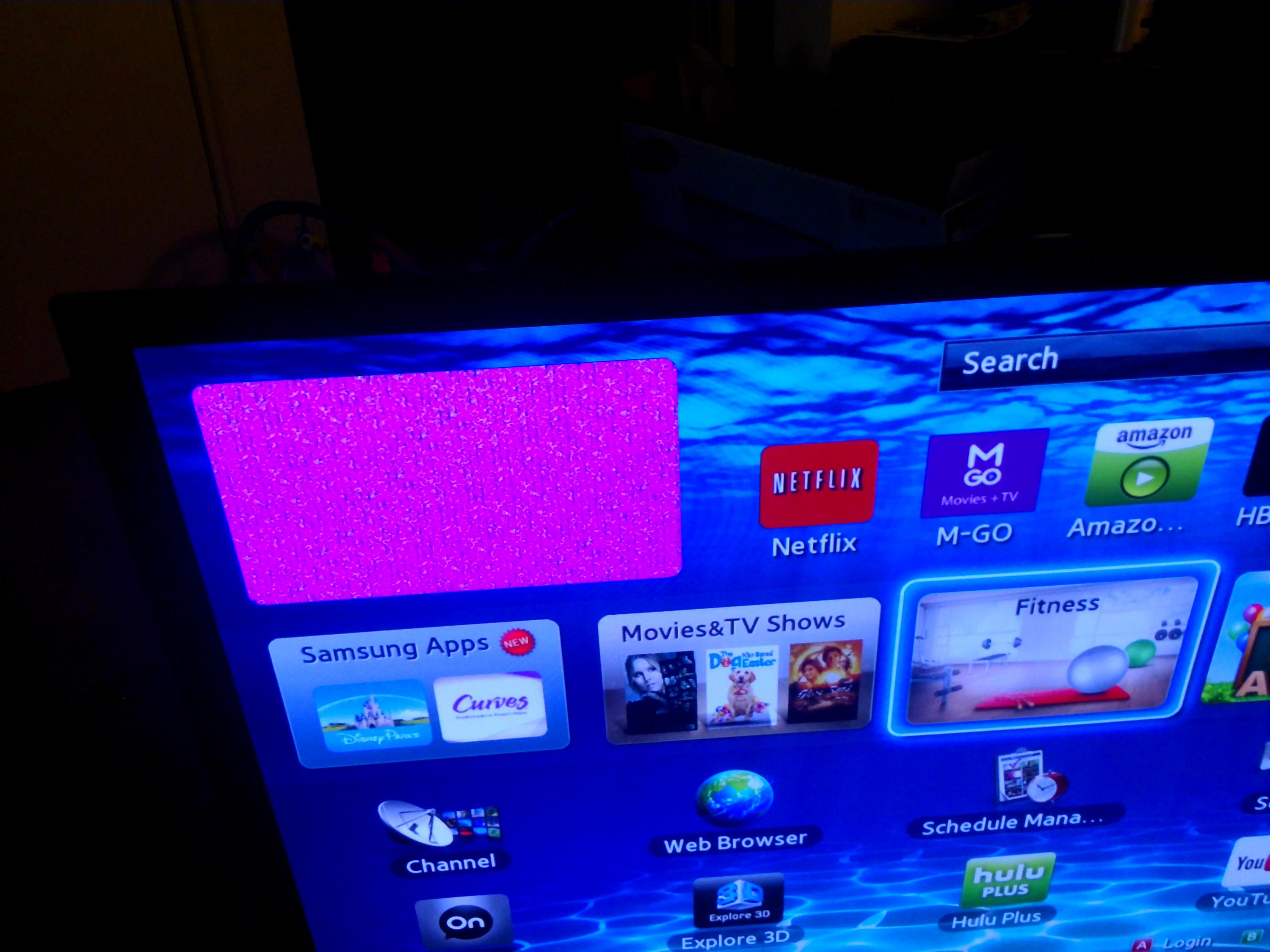

    I have a Samsung plasma TV PN51E550D1FX that flickered off during a thunderstorm and then would start turning off and on(no clicking could be heard). We unplugged it for a while and turned it on and we would have a good picture with sound for five minutes and then it would start turning on and off again. After trying all of the recommendations from Samsung with no luck I popped the back of to take a look. No bulging capacitors to be seen. I'd like to give it a go to fix it since it would cost more to take it to a reputable repair store at this point than buy a new one. I'm not sure where to start, any suggestions?

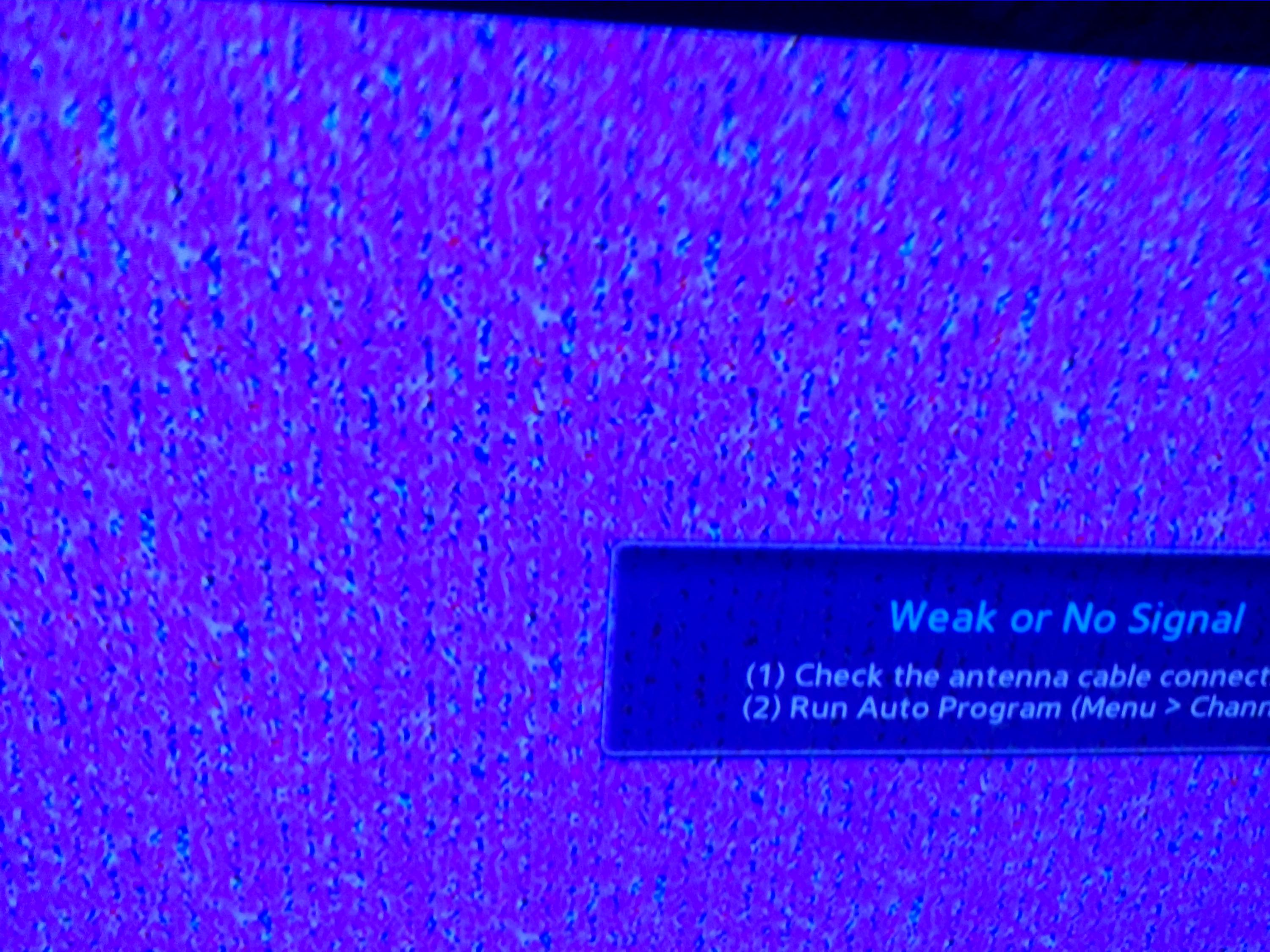

          Okay I checked all the edges and saw no damage. I turned it back on to grab a picture and it looks like the pink stuff is only when it is on the TV source but is fine on the smart Hub and launching the YouTube app. Here are the relevant pictures.
            Re: Samsung plasma TV PN51E550D1FX power cylcling
            Wait, I missed that you had a picture? My fault. Cracked panel can't cause that.

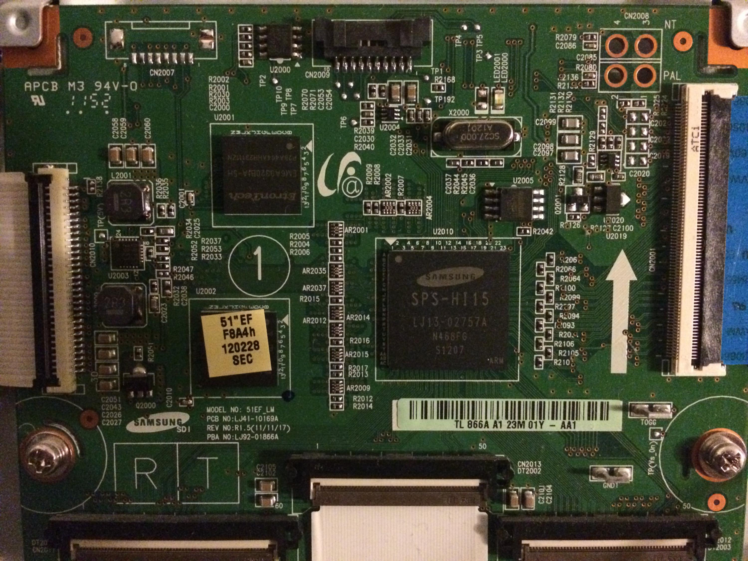

            Can you post a picture of the control board? It's the board that connects to the AV input board and the sustain boards, it's usually in the center of the panel.

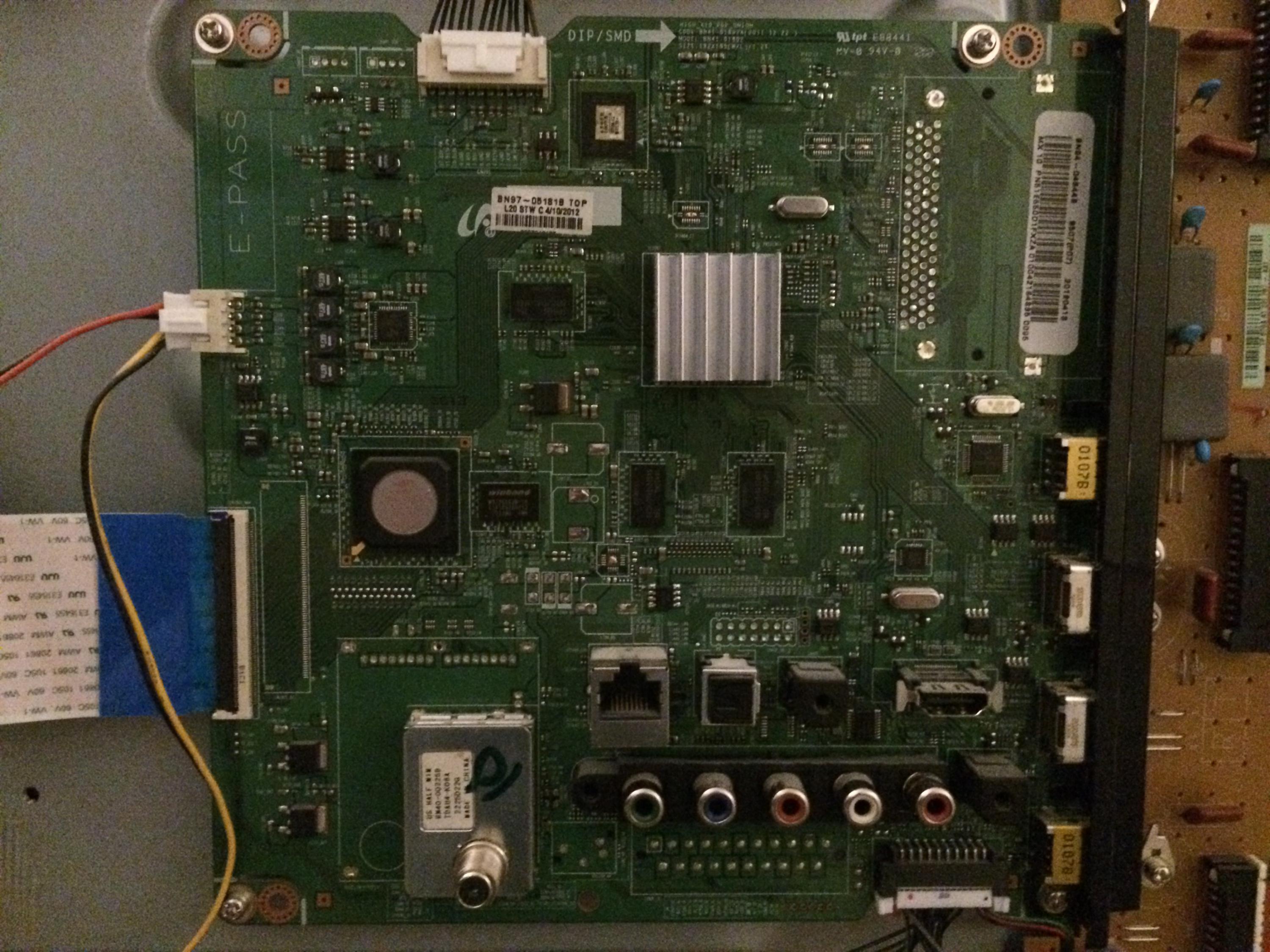

              Not at all Tom I just uploaded it, sorry for the confusion. Here is the requested picture, at least I'm pretty sure its the right one.
                That's the AV input board ("main board"), but if you follow that wide ribbon cable coming off it, it will go into the control board. I need a photo of that control board.

                    OK, see those four big copper plated holes, top right, with CN2008 printed next to them? With the TV unplugged, place a wire jumper between the holes marked 3 and 4. You want to collect these together.
                    Then, disconnect the wide ribbon cable on the right hand side of the board, the one which goes to the main board.
                    Power on the TV. You should get cycling test patterns on the screen. Is any distortion visible on these patterns?

                          No distortion visible at all.
                            Main AV board is the cause of the fault then.
                            If the TV stays on, attempt a firmware update. (Do NOT attempt one if you suspect it will shutdown, you will "brick" the main board and control board, making an expensive repair necessary.)

                              Actually it has the absolute newest firmware, I got it to fully update while initially working with samsung. The TV has stayed on for six minutes.
                              EDIT: at the ten minute mark it turned off and turned back on and started repeating this every 30sec or so just like before.
                                My guess would be lead-free soldering failure under main CPU. Lead-free solder is brittle and can crack under high thermal load.
                                Same failure cause as Xbox 360 red ring of death and PS3 yellow light of death.

                                  Okay so if this is the case would a reflow of the solder work? Or a more permanent solution?
                                    Reflow could work as a temporary solution, but it's very rarely permanent.
                                    • Sryii
                                      • May 2014
                                      • 22
                                      So a new board would be the way to go then?
                                        Yes.
