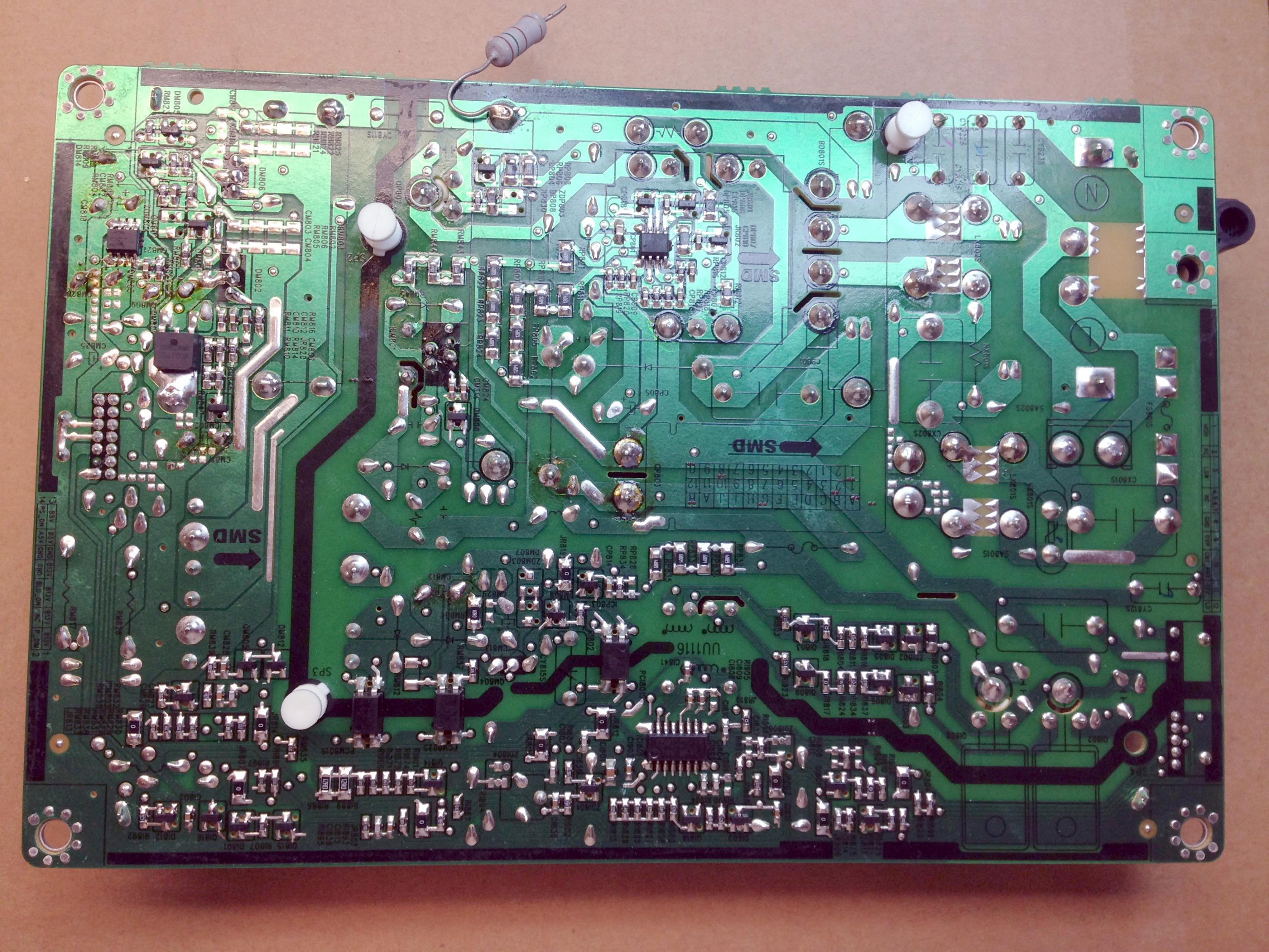

    Been troubleshooting a Samsung 32" LCD TV.
    Initially i noticed that the red LED was flashing twice and would not turn on.
    Now there is no LED at all.
    Observations so far:
    -5V standby is 4V, 13V output is 10.5V (both off equally - 20%)
    -If i disconnect the 5V standby from the PS(actually 4V), and inject my own 5V the led in the front now gives me the 2 blinks again and the PS_ON pulses momentarily enabling the PS including the power factor controller and it comes up at 400V.
    -If i put a scope probe on the 5V/5V standby it is bouncing around, and so is the feedback from the optocoupler. But the converter regulates at 4V.
    -I replaced the pwm/integrated FET IC thinking that in internal ref was bad, no joy, standby is still 4V.
    Does anybody have experience on how opto's fail? Would their current gain change as a failure mode, or do they normally just go open?
    Thanks!
    Re: Samsung LCD TV Power Supply BN44-00438B
    It may have bad startup cap. Post good clear pictures of the board, both sides?

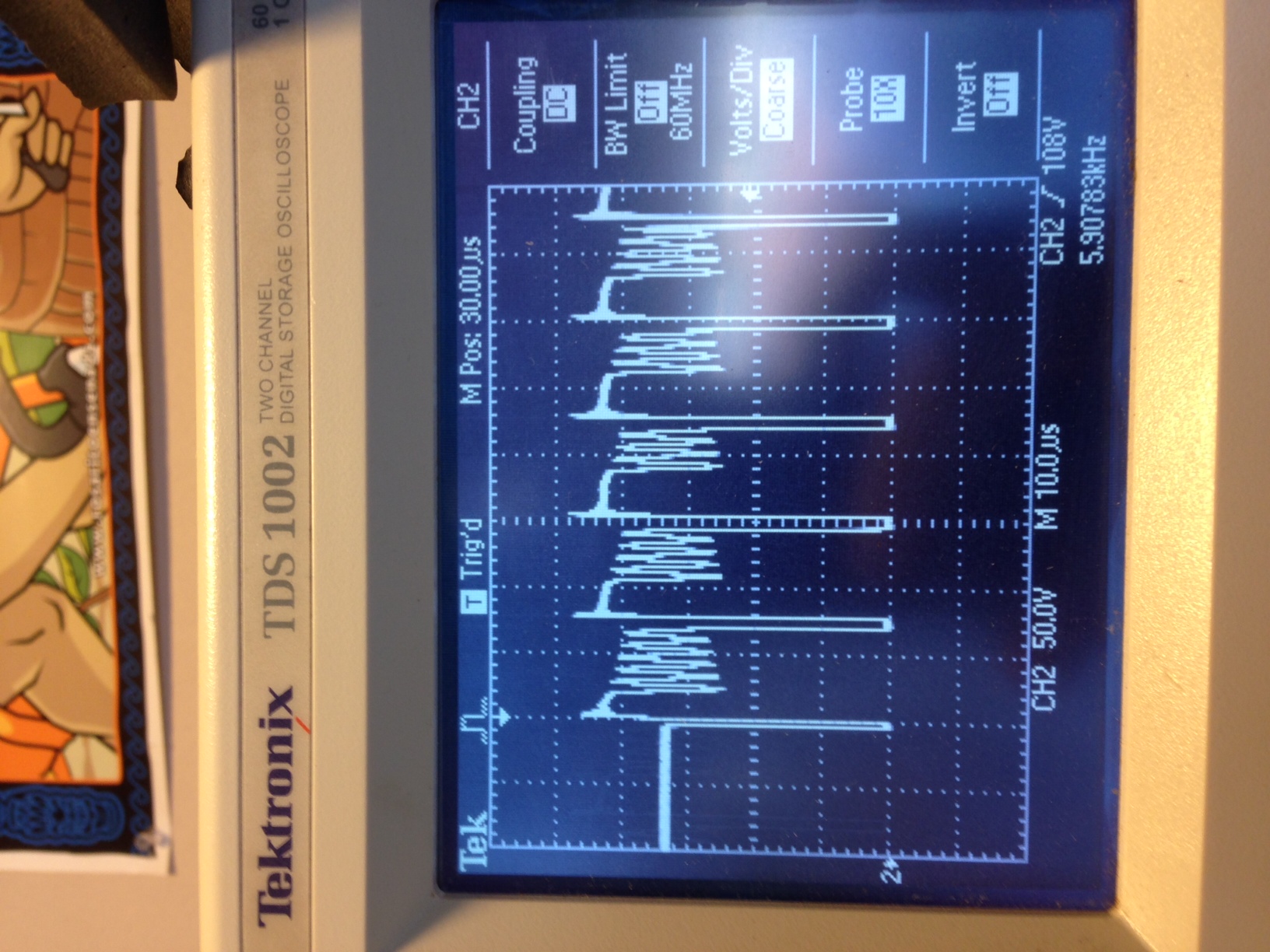

        OK so I replaced the opto and no dice. The standby output is still 4V and the 13V is approx. 10V.
        So I have replaced the PWM/FET IC, opto and the electrolytic on the output.
        Could it be that the xformer has a shorted winding or 2?
        Attached is a pic of the Output converters drain waveform.
        (looks like a flyback converter min duty cycle? Am i right about that?)
          The voltage are steady at 4V and 10V and not fluctuating? If that is the case, it can be the Vref Diode such as TL431 which is commonly used in the SMPS, it is connected to the LED side of the Opto that i used for regulation.

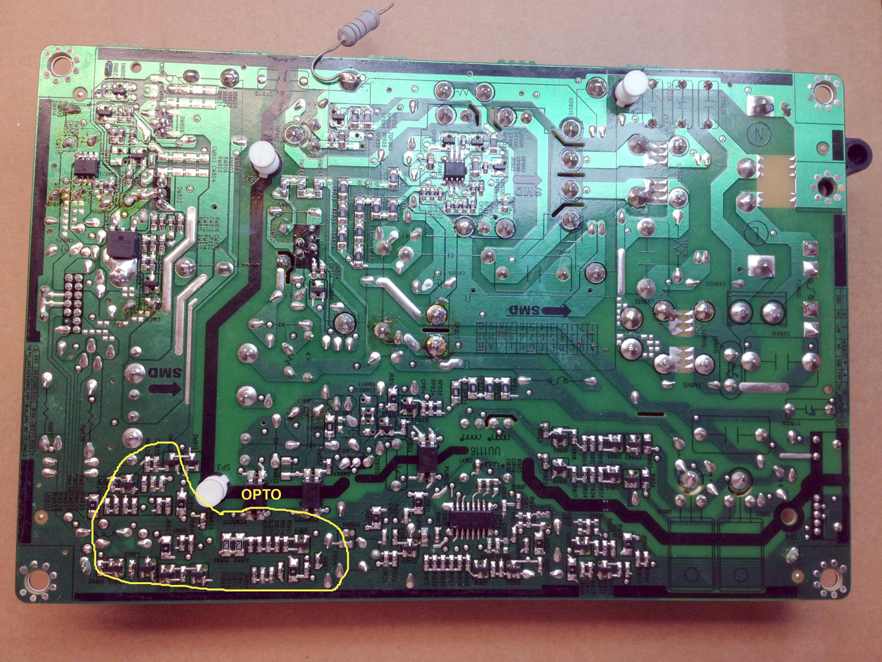

            On the DMM the 4V and the 11V are stable. On the scope it is bouncing around a little. Not sure how obvious it is from the scope pic above, but the converter is in burst mode, it is not constantly switching.
            So is the zener diode a small plastic package, 3 pin divice?
            The opto that i changes is circled in the pic below, am i right in assuming that the zener in question is in the circle?
            Thanks!
              Yes, it will be 3-pin device.
              This typical usage of the TL431 and the Opto used in SMPS.
              You should get the P/N of that multi-pin of the SMPS IC mounted on the heatsink, it will have application notes on how it is used, most manufacturers will just copy the design.
              https://cdn.badcaps-static.com/pdfs/...9ac3a965b0.pdf

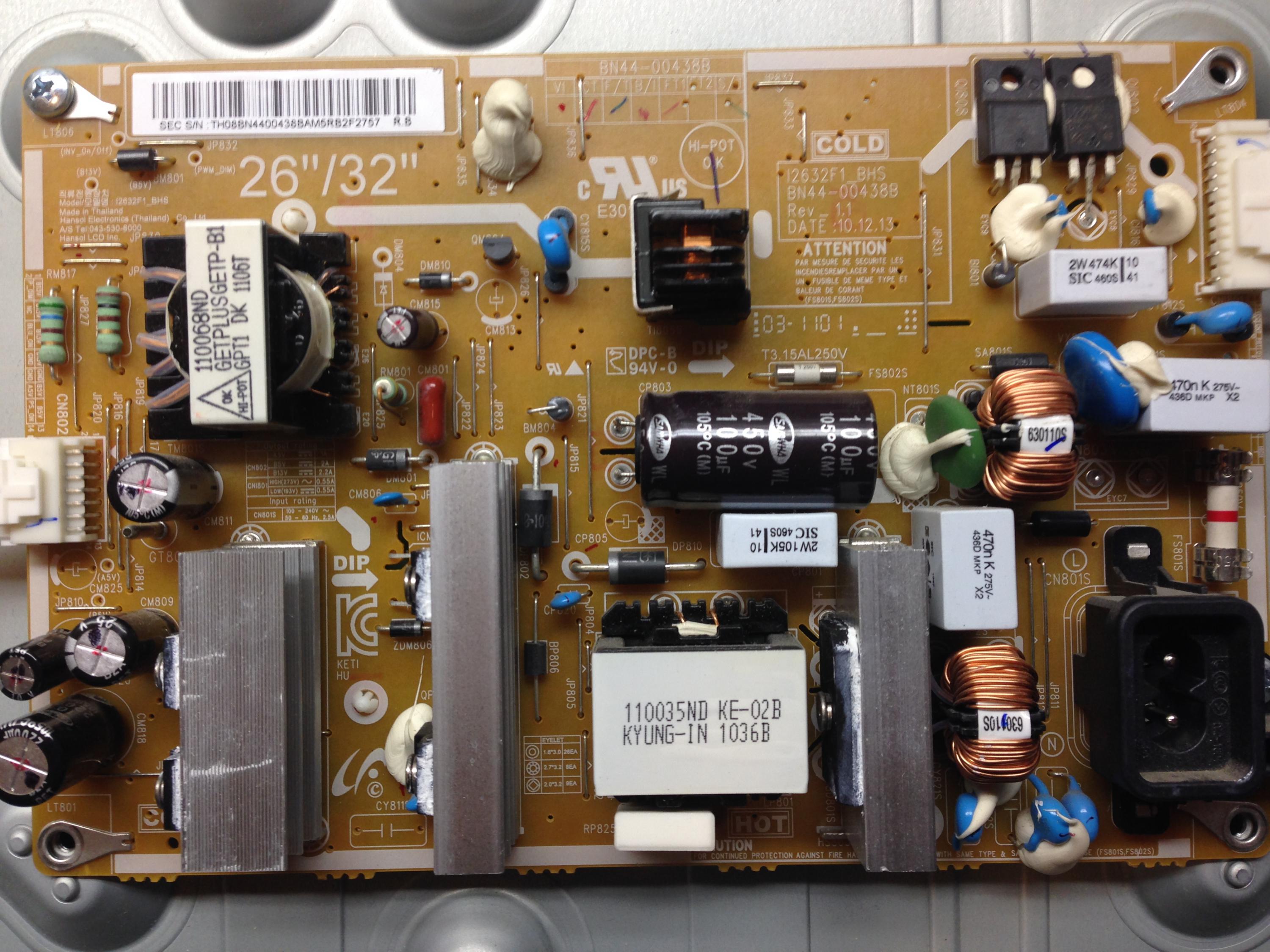

                        i want to order a new power supply but first must ensure that it is indeed the power supply has failed
                        Symptons no back light tv working fine (via flash light)
                        cn801 voltages
                        HIGH FET 0
                        LOW FET 0
                        OVP 0
                        CNT_PRT 13V
                        LD 11.6V
                        VOLTAGE AT BIG CAP 160DC?V
                        I have voltages at both CN802 and CN801
                        available with CN801 or CN802 connected or not
                        if necessary
                        What can I do to make sure it is Powe supply
                            The Voltage on the big cap should jump up to >360VDC when the PS_ON signal is applied, without that boosted Voltage the main supply will not work.
                            Please list ALL the Voltage reading with its name of each pin of CN802 when the TV is not turned on then with the TV power switch is activated.
                                  "no801 ALLOut" what does it mean ALL OUT?
                                  'Will check voltages with tv on and tb off
                                  Is that what is needed" Yes, and all the cables are connected.
                                  So far it PS_ON is present but you still do not have PFC boosted Voltage on the main cap, so the PFC circuit will have to be looked at next.
                                  I will need really good clear pictures of the whole bottom side of the board, and then in four sections because I will have to trace out the connections on the bottom side of the board.
                                  ICP801 looks to be the PFC Controller IC, can you read the numbers on the top of the IC? We will need to get the spec sheet to get the pin out of the IC.
                                  NOTES: I assuming this is ACTIVE HIGH signal.
                                  Check resistor RP825, it should be <1 Ohm.
