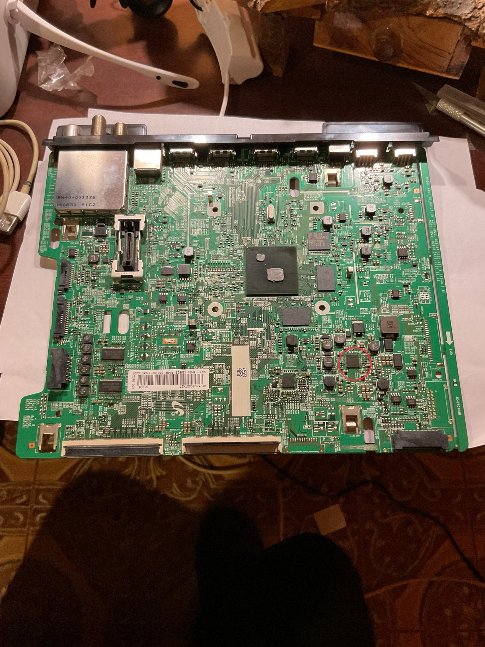

Samsung eu75nu8000 no picture after tape method
diah, just come back from the test, and I think the main board is gone. How u suggest I disconnected the 2 flat cable of lvds, turn on and the cpu is become really hot in like 10 sec u can’t hold the finger on the cpu, I show u the zone that become hot. Is it normal be so hot ? It s because I removed the heat sink? Or the hot without the lvds connect means the cpu is in short?Comment

MAN..... with out heat sink the Soc will be very warm to hot... and no panel LVDS will be more hot because the GPU section in Soc will turn load 100% searching for it panel source..... we are talking on DC to DC IC.... put the heat sink back and tell about this shit other wise i will not follow any more... go make ICE cream with the advised experiment..Comment

Ok you told after that in the test you made you heard sound, this is a good sign, this means the cpu is working and needs the metal plate to work, the hot part you marked it is surely the CPU core, the other sparate "core" (it is called DIE) is the tcon processorLast edited by Davi.p; 11-11-2024, 05:02 PM.Comment
