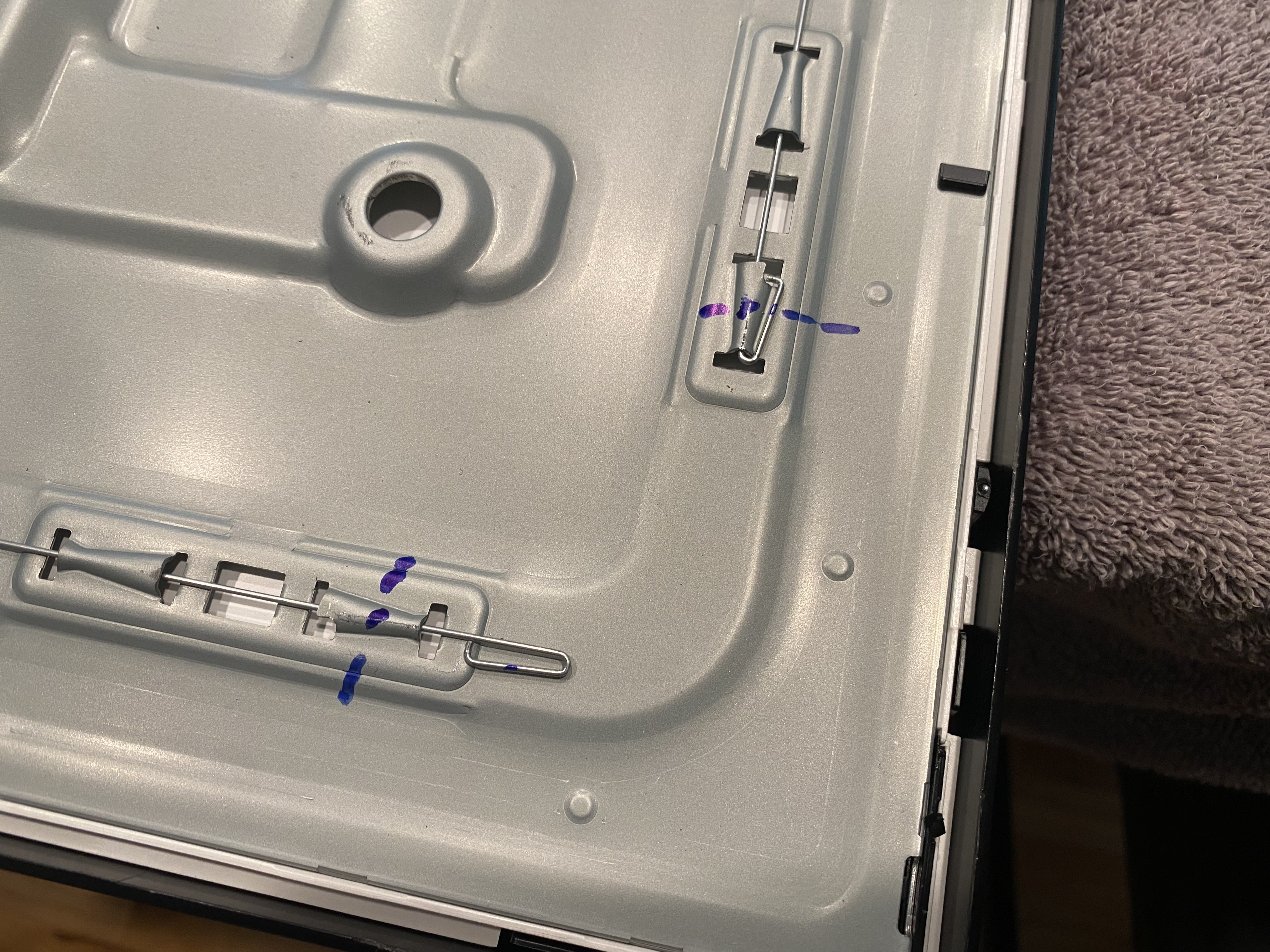

    I've done a few of these. Using Samsung Service Manul method always result in some broken bits and the snap lock metal wire always gets bent and not reinstall as nice as original. After reinstall often have some pops and clicks. This is the best method I found so far. Pull the wire out instead
    https://youtu.be/paYZAc1rcWs?si=GHdTOv5ySIJgjZOC&t=82
    Here is a pic of how the hook on the wire locks
    Click image for larger version  Name:	IMG_0143.jpg Views:	0 Size:	3.35 MB ID:	3743830
    Stil ended up with a couple of small broken bits on the bottom haha. But the wire stayed perfectly straight and seems easier/less forceful. Fishing the wire hook out does require a little force using a small flat blade screw driver.
