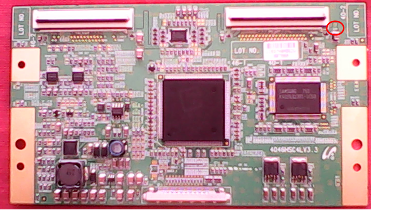

                I remember, when it smoked, the pad near an SMD cap burnt (the pad is still ok when I cleaned it, so I think the smoke came from this pad).
                Please see encircled pad near the cap on the attached photo.
                I will check if this cap causes the short circuit.
                And as you suggest, I will check also the board inside the panel.
                If tcon part causes the short ckt, it gives me hope and I will order new tcon.
                Thanks.

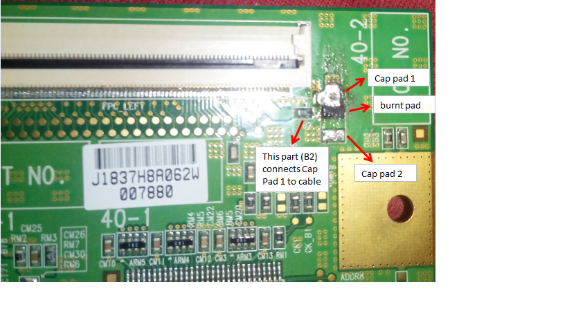

                  Re: Sony KDL-40V3000. 5 blinks error code
                  So does that MLCC SMD cap burnt out badly? MLCC will fail as shorted circuit when it goes bad. You can also see another cap close to the second connector that goes to the panel. I believe those are filter cap for the voltage feeding the boards inside the panel, so to me you have the failed MLCC that caused the fuse to blow, not due to shorted circuit in the panel.
                  • dboy
                    • May 2014
                    • 20
                    • philippines
                    Hi Budm,
                    The cap is still ok physically.
                    When I desoldered this cap, I found burnt pad (underneath this cap). Please see picture.
                    You are correct, multiple pins cable for this line with a component (B2) in series with Cap pad 1. Cap pad 2 is gnd.
                    1. I checked this Cap (unmounted) it is not shorted (maybe shorted before it smoked).
                    2. I checked also resistance across the Caps (for left and right ribbon cables), they both in 20~30 ohms (I am using analog meter) with and without ribbon cable.
                    3. I am not sure what component is B2, coil? both components are 0 ohm across and no burnt pads.
                    I could not access the board in the panel but according in number 2, when ribbon cables connected, the resistances are about 20-30ohms not 0 across the caps in both cables.
                    New tcon will arrive tues or wed.
                    I will update later.
                    Thanks.
                      That 'B' is the Ferrite bead (small inductor, <1 Ohm). The 20~30 Ohms does not sound right at all to me. At this point I believe the problem is in the T-CON, not in the panel.
