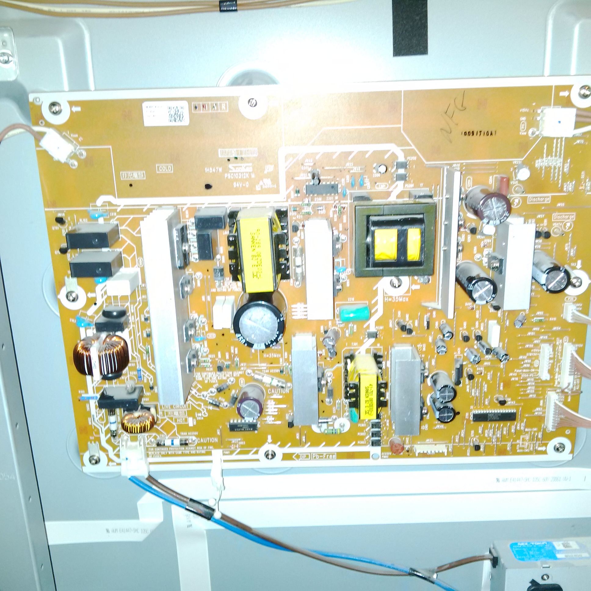

        I meant I had all the ribbon cables disconnected. I'm actually starting to think it's the P board. With all my cables disconnected except for P7, I get some voltage at various points on the P board but never any voltage at P2 or P11. Is there a way to test the P board without it connected to anything besides AC? Like jumpering some pins to make the P board think it's on. I have done it on a Samsung.
        EDIT: Just metered SN2 and SS11. No shorts. I'm back to thinking I have a bad P board. I have the same tv I can pull the A and P board from but it's at the cottage. I'll have to drive out there, pull the boards and bring them home.

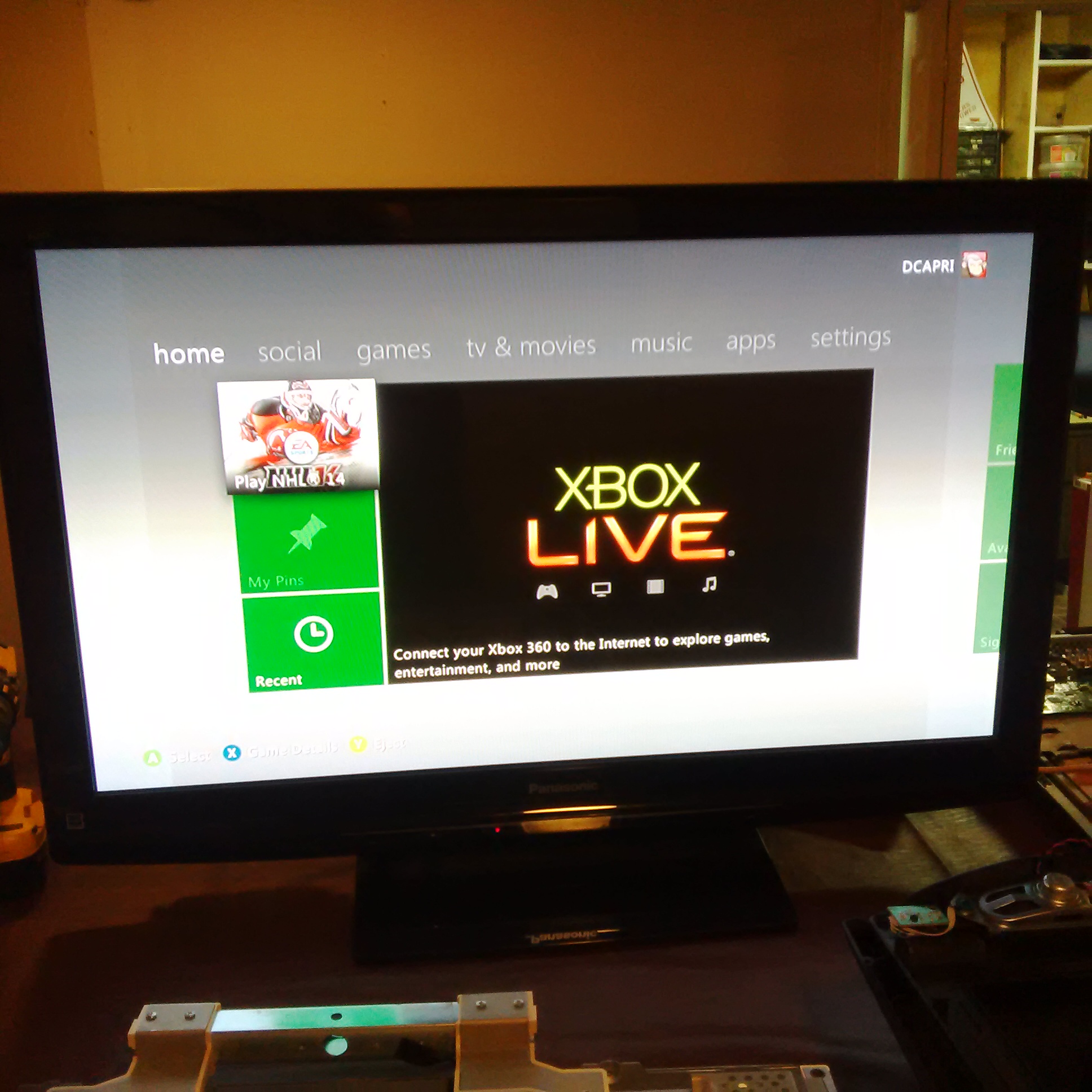

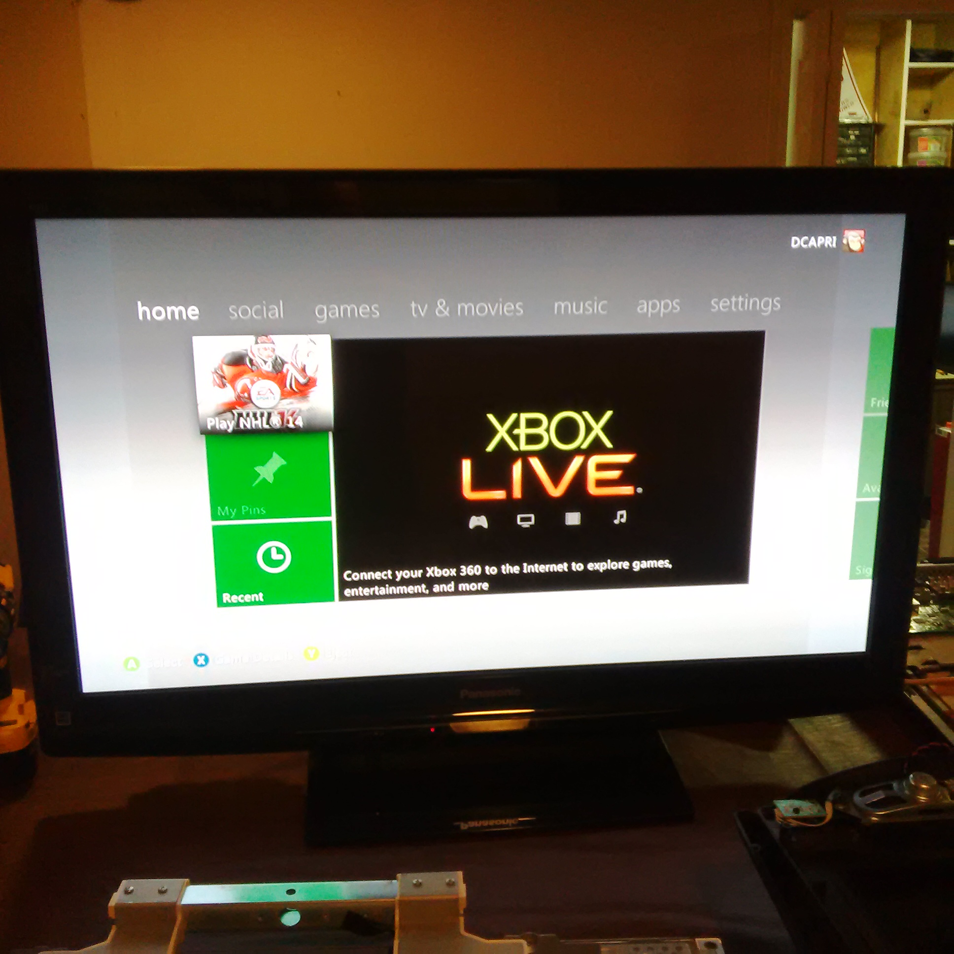

          Brought home the P board and A board from the lake. The P board was faulty in the tv. Fired it up right away. But The screen is lighter on the outside. Like a burn in from watching 4:3 shows. Any way to get that to go away? I attached pics.
            Re: Panasonic TC-42PX24 Why do I?
            Nice, to be honest I put the P board at a low failure chance so I was expecting A, but you should be able to fault find it and repair cheap I expect since you have one to model off.
            So which voltage is dead or yet to determine?

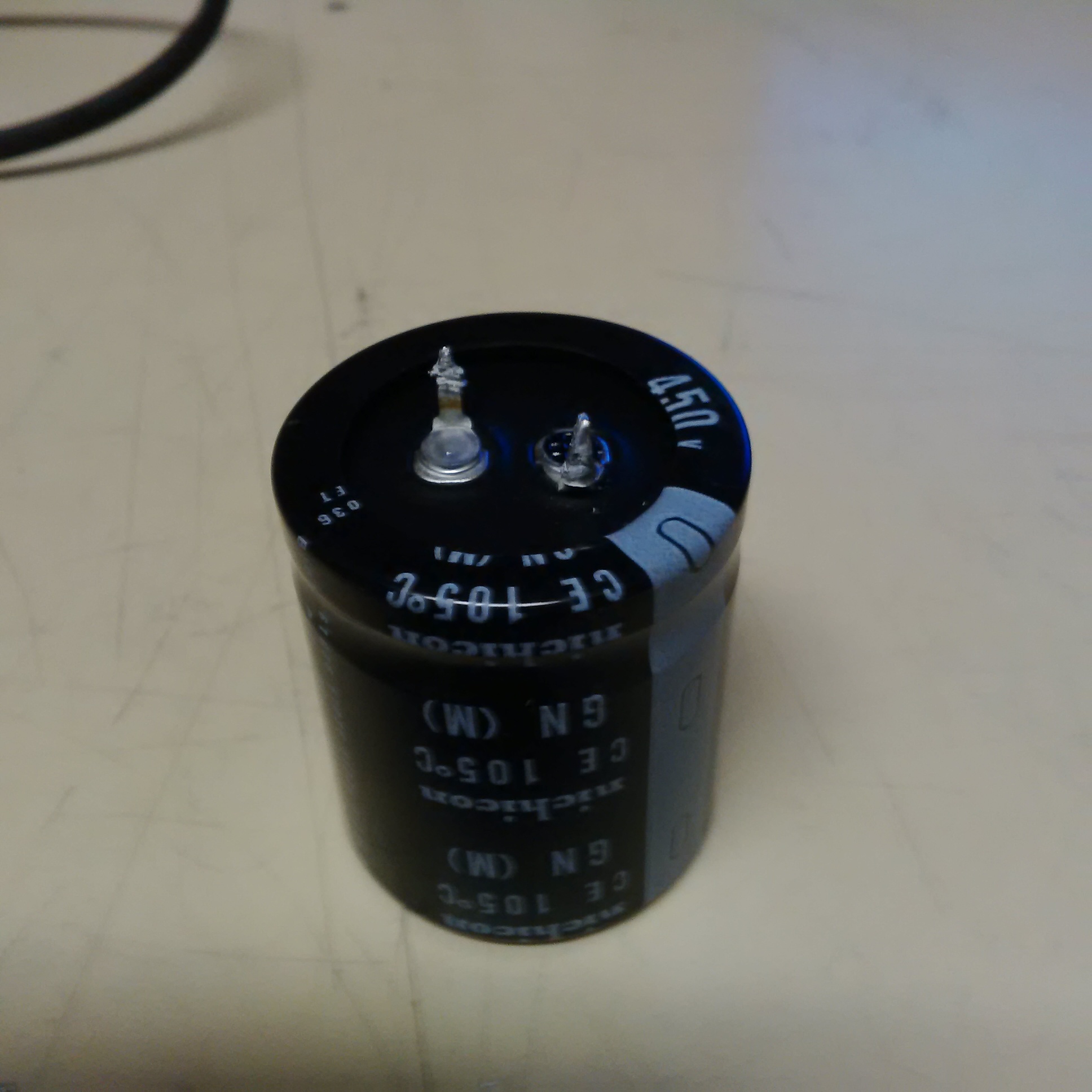

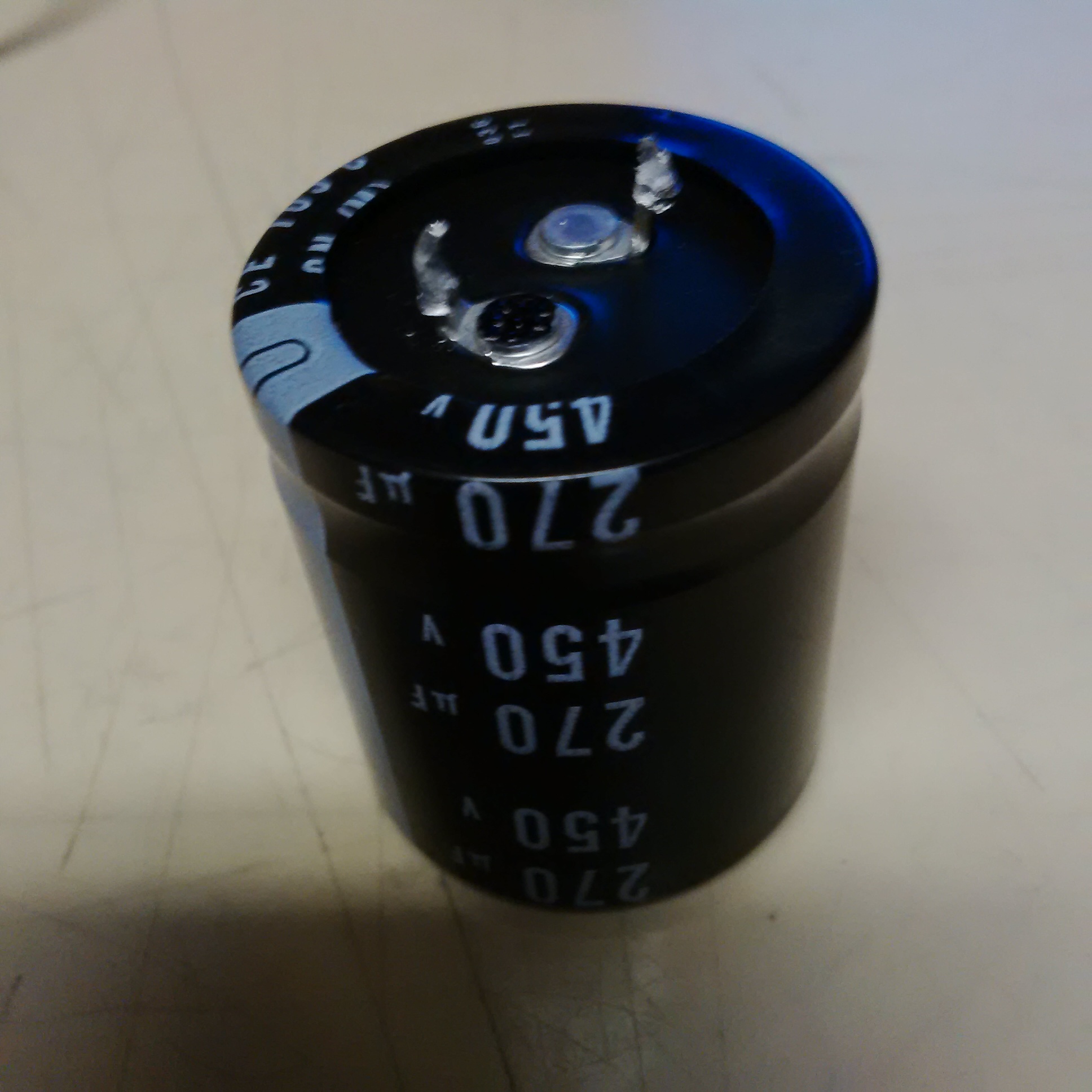

              Thanks for the quick reply. I have no voltage coming out of P2 or P11. I metered various parts of the board. All the caps, diodes, gates, and transistors. I have another dead P board with the same problem. I'm sure I can make one board out of two. My concern is the burn in on the outside of the screen (I posted pics above). Will that go away if I keep running the "scrolling bar"?
                Well I found the problem. Believe it or not, it was a main cap on the P board. I felt a small bulge in it and it even was a Nichicon. I metered it after I pulled it out and it was reading 150nf. Usually don't bother reading those caps but I sure am from now on. I've attached pics.
                  Good work. Maybe bad batch? usually those big buggers look to have a bulge but are ok.
                  This will help a few down the track. Panas PSUs are usually pretty good.

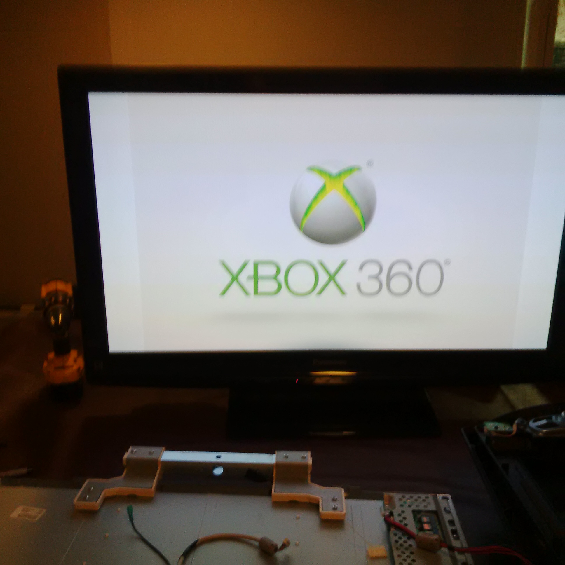

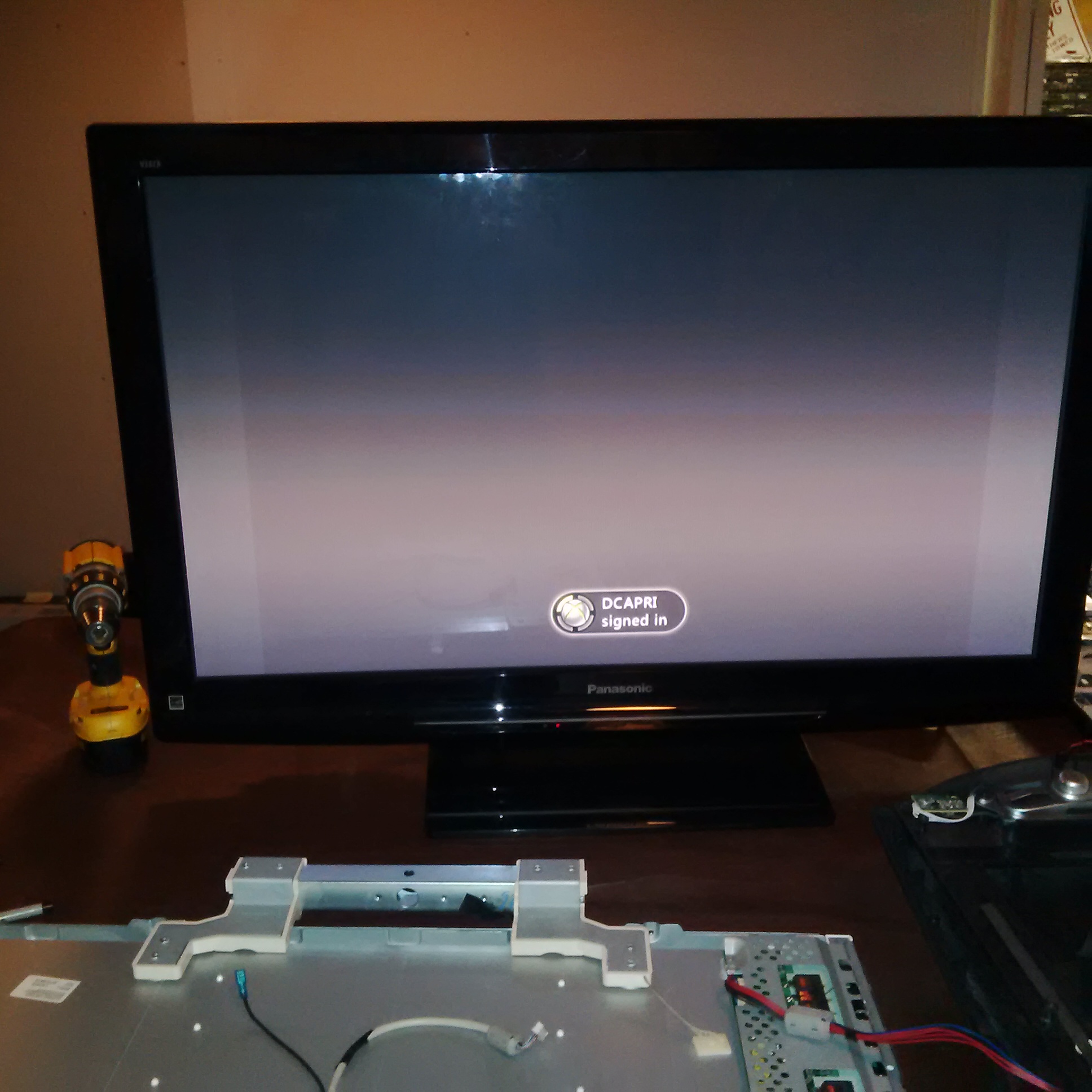

                    I'm trying to get rid of the 4:3 burn in running the "scrolling bar". I have pixel protector I am going to run after that. Also there is a setting greyed out called 4:3 side bars. It's set to bright and I can't change it for some reason. Like to change that if possible.

                      Try this. Do not have exact guide.
                      While pressing [VOLUME ( - )] button of the main unit, press [INFO] button of the remote control three times within 2 seconds.
                      press 1 to cycle through to SRV-TOOL
                      press OK
                      use arrows to highlight bottom right block directly across from the SOS history
                      press mute for 3secs or more and should show hours and power cycles.
                      Also if you go into aging, you can cycle through the test patterns and get a full white to see if it helps. P42C2 manual should be good enough for exact instructions.
                      Not sure about the bars, maybe need a user guide, check if it's something preset in Hotel mode?

                                  I downloaded pixel protector to see if it can fix it but I need a pal dvd player to use it. Trying to convert it to NTSC. I'll post back if it can repair the 4:3 side bars.

                                    Good luck. Did you find the AGING, and the white pattern?
                                    Might take another 19000hrs to equalize Sorry that's my sick sense of humour.
