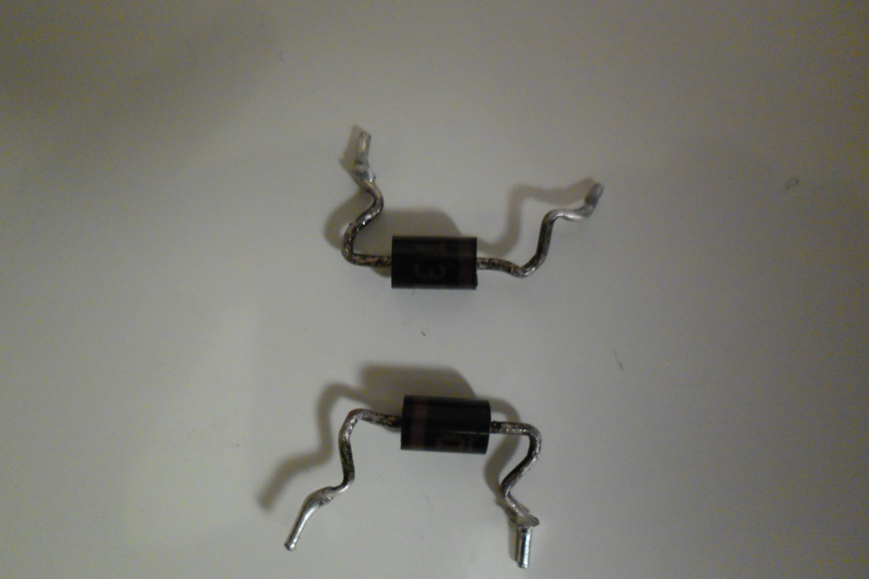

                      These are open circuit part number is T3D 0D if correct, the last D is underlined.
                      Location D204-D216

                        Re: panasonic tx-p42gt30b
                        http://www.donberg.ie/catalogue/semi...t-tc/t_3d.html
                        33 euro$

                          #52
                          these may not be faulty please see
                          https://www.badcaps.net/forum/showthread.php?t=23214
                            Cheers vinceroger69, I put them back in then, will start looking at components under the heatshields.

                              #54
                              Location D204-D216
                              yeah, they are not normal diodes, and most people think they are faulty when they test them.

                                #55
                                cheers lads, thank the lord I don't have to replace them 33 euros each?
                                  #56
                                  Panasonic originals bound to be overpriced. They would cost 50 cents from a good electronic part distributor. But, you need specifications to be sure which part to get.
