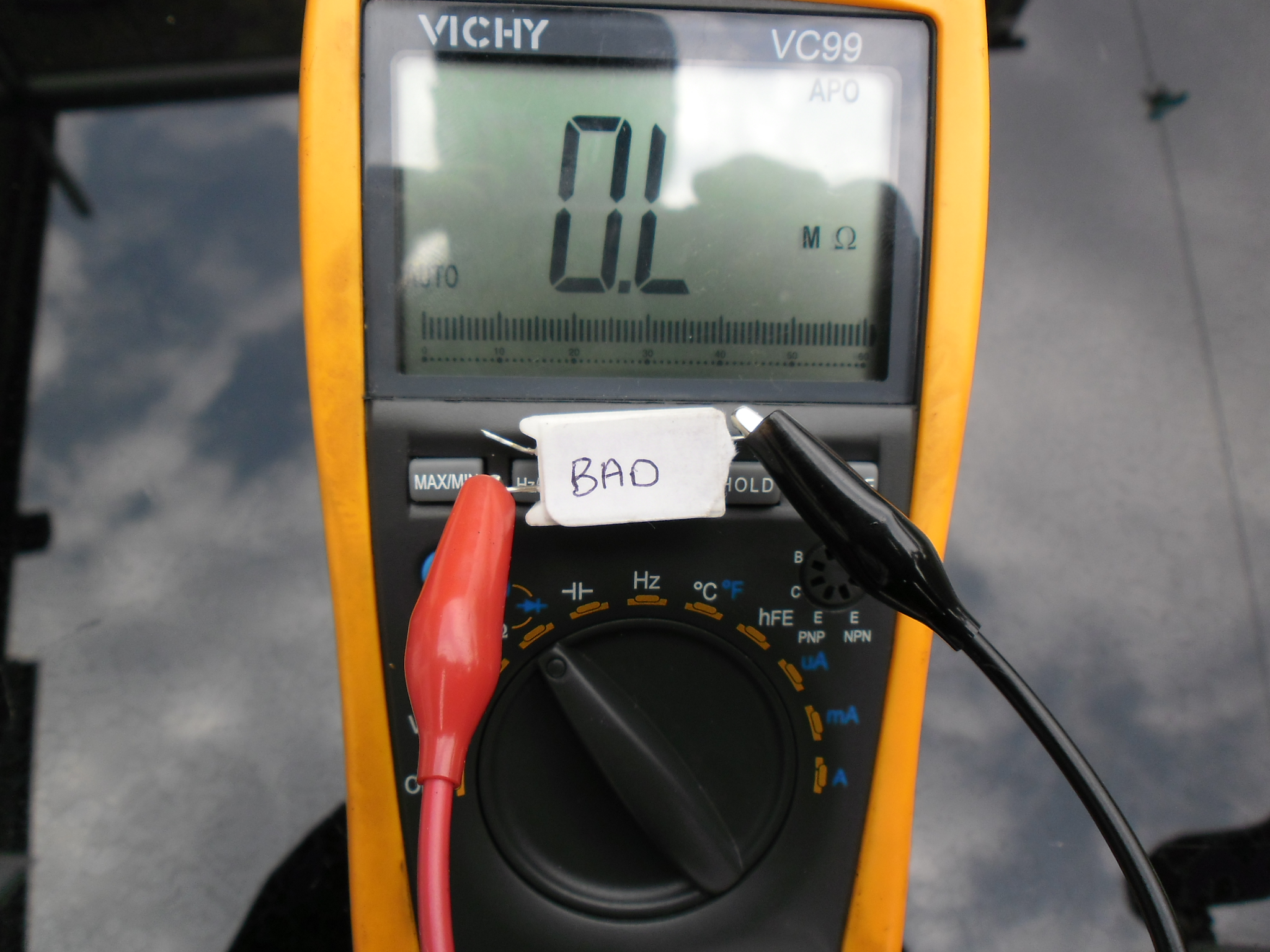

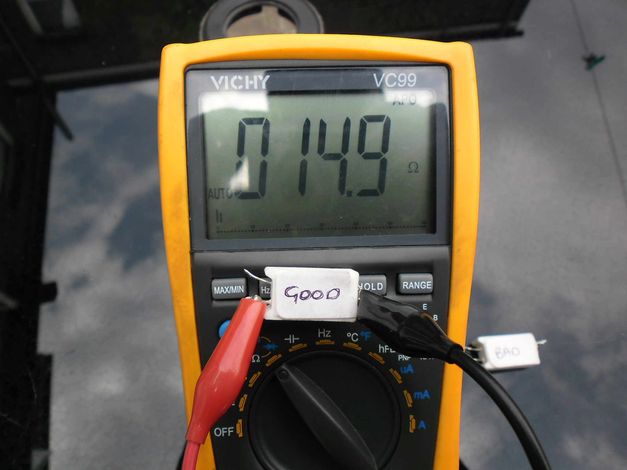

    sorry tw2005 if what I was saying isn't clear, could I piggy back the resistor over the connection with original still in place, Connection 1 & 2 just add the 5w or 7w 15ohm resistor on top.
    • tw2005
      • Oct 2011
      • 6458
      Re: panasonic tx-p42gt30b
      Yeah , I guess, don't know why though. I'd stick to 5W otherwise more energy is going to pass through the 7W before it blows. It may be ok but you're dealing with the mains side of the PSU, exceeding the original design may be risky.
        I may of confused you sorry, its not the fuse sided that's blown, its not reading the resistance 15ohms
            No I think I confused everything early on, I don't think there is a fuse as such but the whole resistor is the fuse. And it has done it's job because it is now open cct and no longer reading 15ohms.
            We'll just think of pins 1 & 3 as the same. (on the resistor)
              Ive removed them from the board, to test.
              hope this helps.
                hope this helps.
                makes it clear,I understood your point, I've explained it best I can.

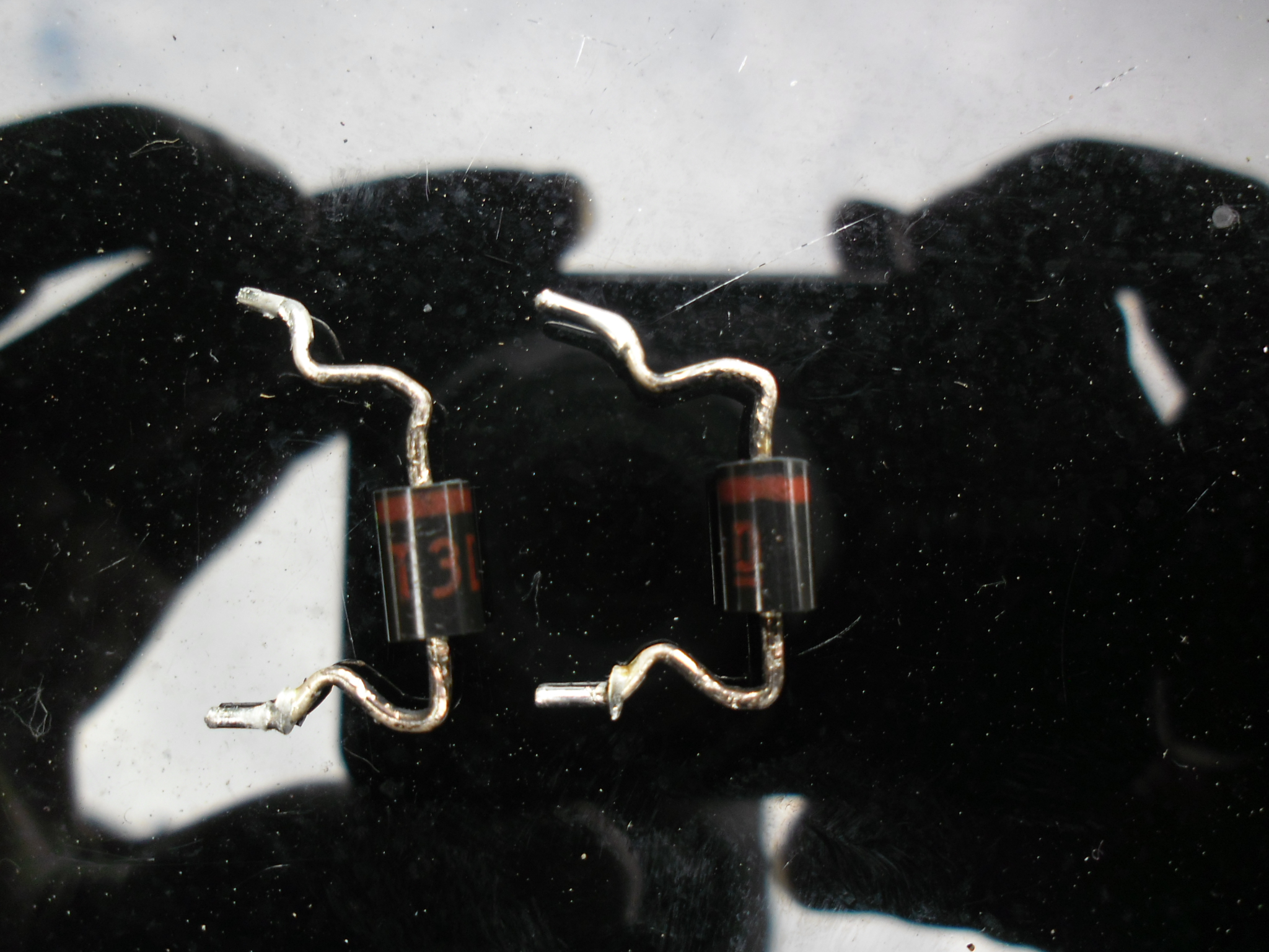

                              Re: PANASONIC TX-P42GT30B
                              Hiya after few more checks, does these readings sound right.
                              D100 <near to where that 5w 15 ohm resistor that was blown under the heatshield
                              1-2=1.441
                              1-3=1.441
                              1-4=1.102
                              2-3=1.765
                              3-4=1.440
                              1-2=0.494
                              1-3=0.492
                              1-4=0.473
                              2-3=1.763
                              3-4=0.493
                              D700 <near to the 2 transformers under the heatshield
                              1-2=0.450
                              1-3=0.451
                              1-4=0.888
                              2-3=0.000
                              3-4=0.451
                              1-2=OL
                              1-3=OL
                              1-4=OL
                              2-3=0.000
                              3-4=OL
                              Also notice C603 should be 820uf but its reading 726.3uf (ESR Meter Used)
                              These 2 diodes? D204 & D216 both reading OL, near the single transformer.
                              They read T3D 0D

                                How did you get pins 1 to 4 on one two pin diode?
                                • Jahson
                                  • May 2012
                                  • 245
                                  #36
                                  thats not related to those diodes
