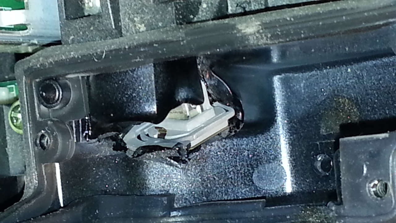

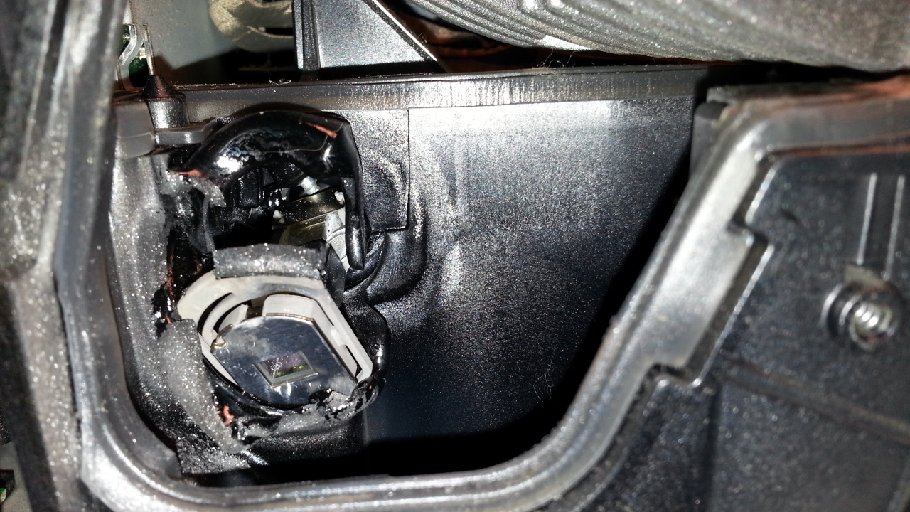

                      I killed it. I ran it with the color wheel facing up waiting for it to fail so I could maybe rule out the color wheel but smoke began to rise from the light tube and by the time it was all over there were some melted pieces in there. Didn't realize the wheel itself provided some cooling effect from the lamp.
                      I will have a look later to check on the extent of the damage but this just lightens my load actually. Almost can't wait to haul it to the curb hehe.

                              The color wheel does not provide any cooling, I'm not sure what smoked, I've seen them run with broken color wheels and not had any problems other than no color of course.
                              After the lamp there is a uv filter, then the color wheel, then the light tunnel (4 small mirrors aranged in a square (tunnel), then some lenses, mirrors etc.
                              Did you have a picture with the color wheel out?

                                Re: Samsung HLT-4675 DLP Shutting Down..
                                Well the whole assembly was out and facing backward with everything plugged in but I could see a pic as it reflected off the various surfaces behind the tv, yes.
                                It looked like whatever is just past the color wheel assembly was smoked. Will attempt a picture when I get home.

                                    And evidence of the carnage... first one is top-down second one is straight on with lamp assembly removed.

                                      Looks like the light tunnel heated up. I've never seen that happen, how long did you have it running before that happened. The only thing I can think of is that the color wheel glass itself must filter the intensity enough so the light tunnel does'nt get that hot?
