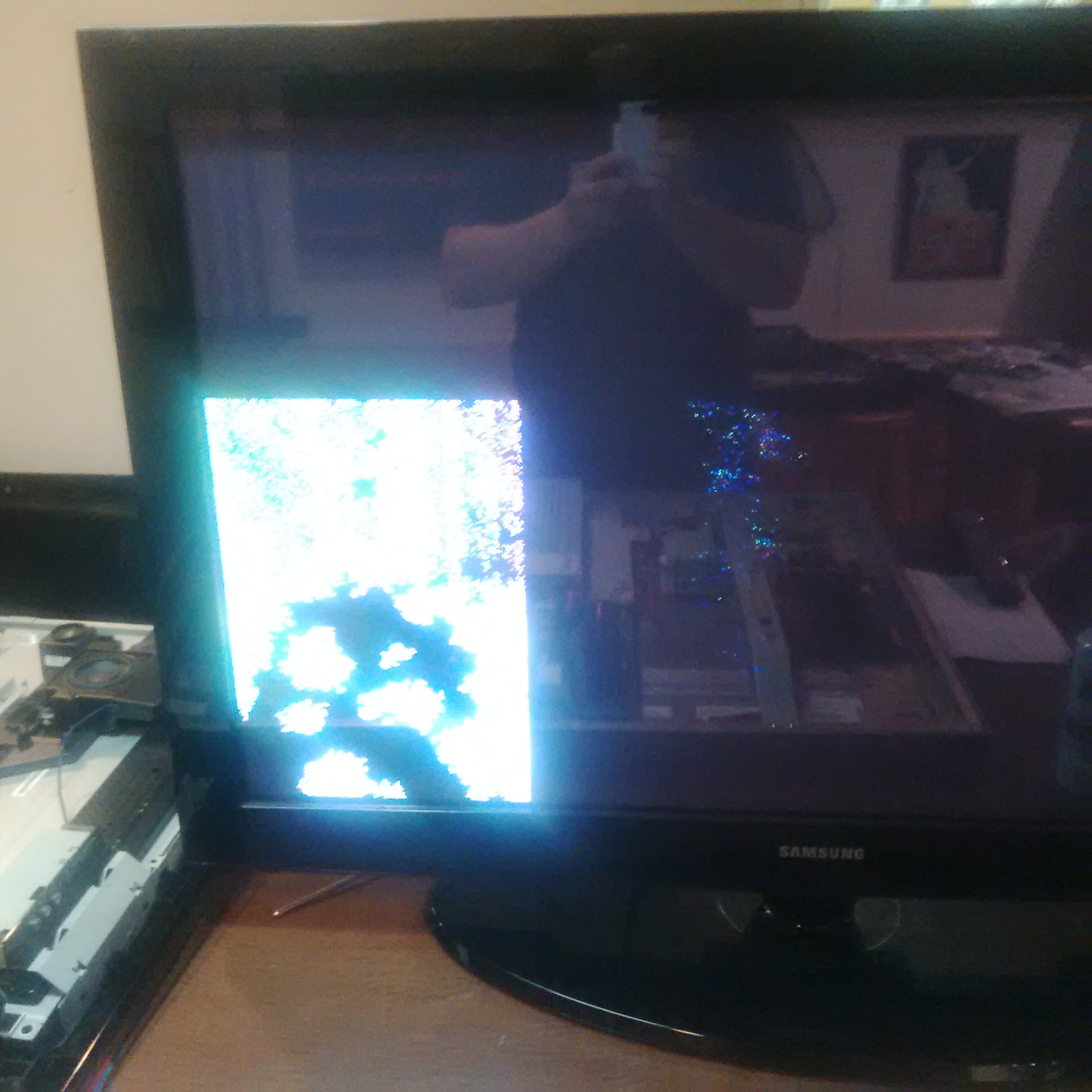

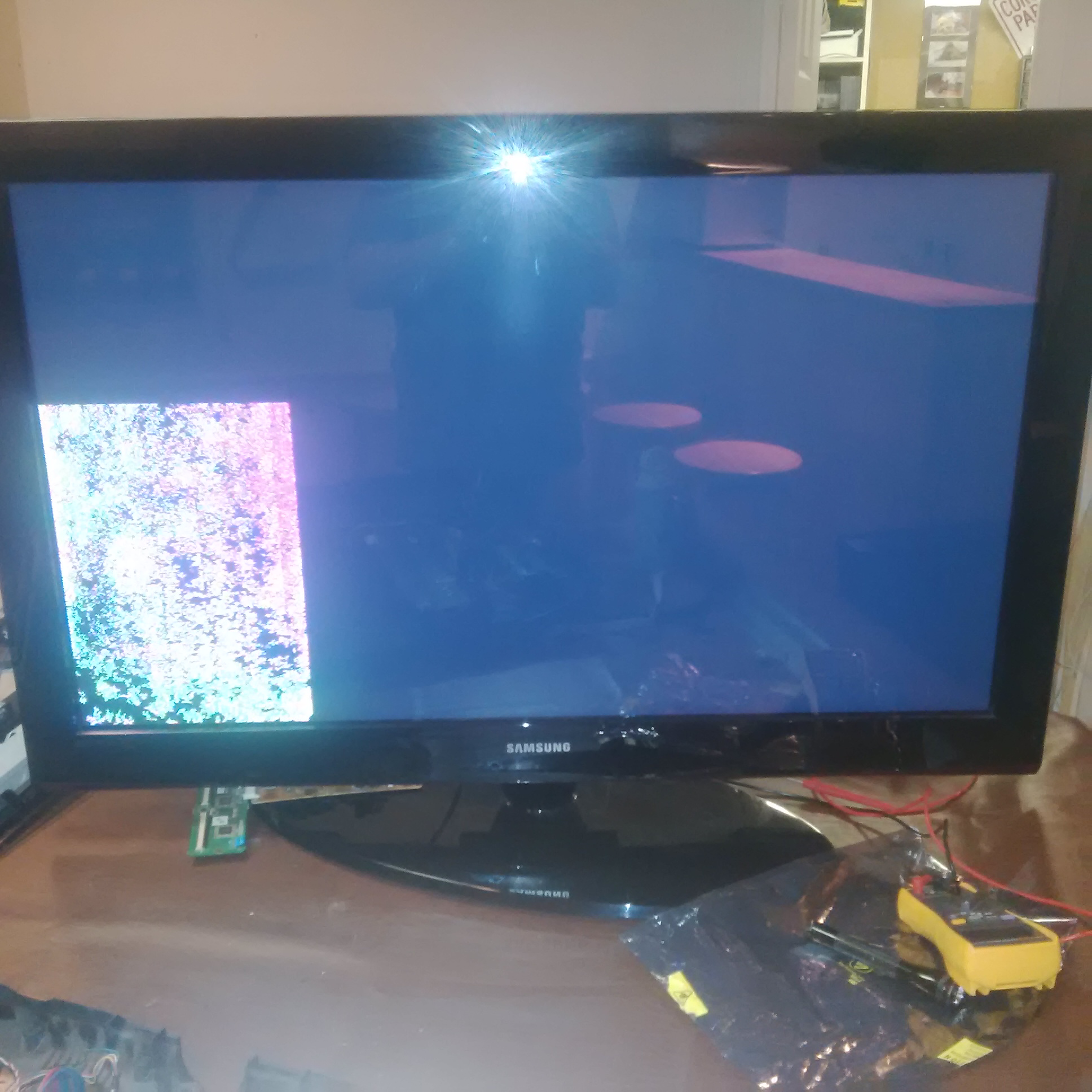

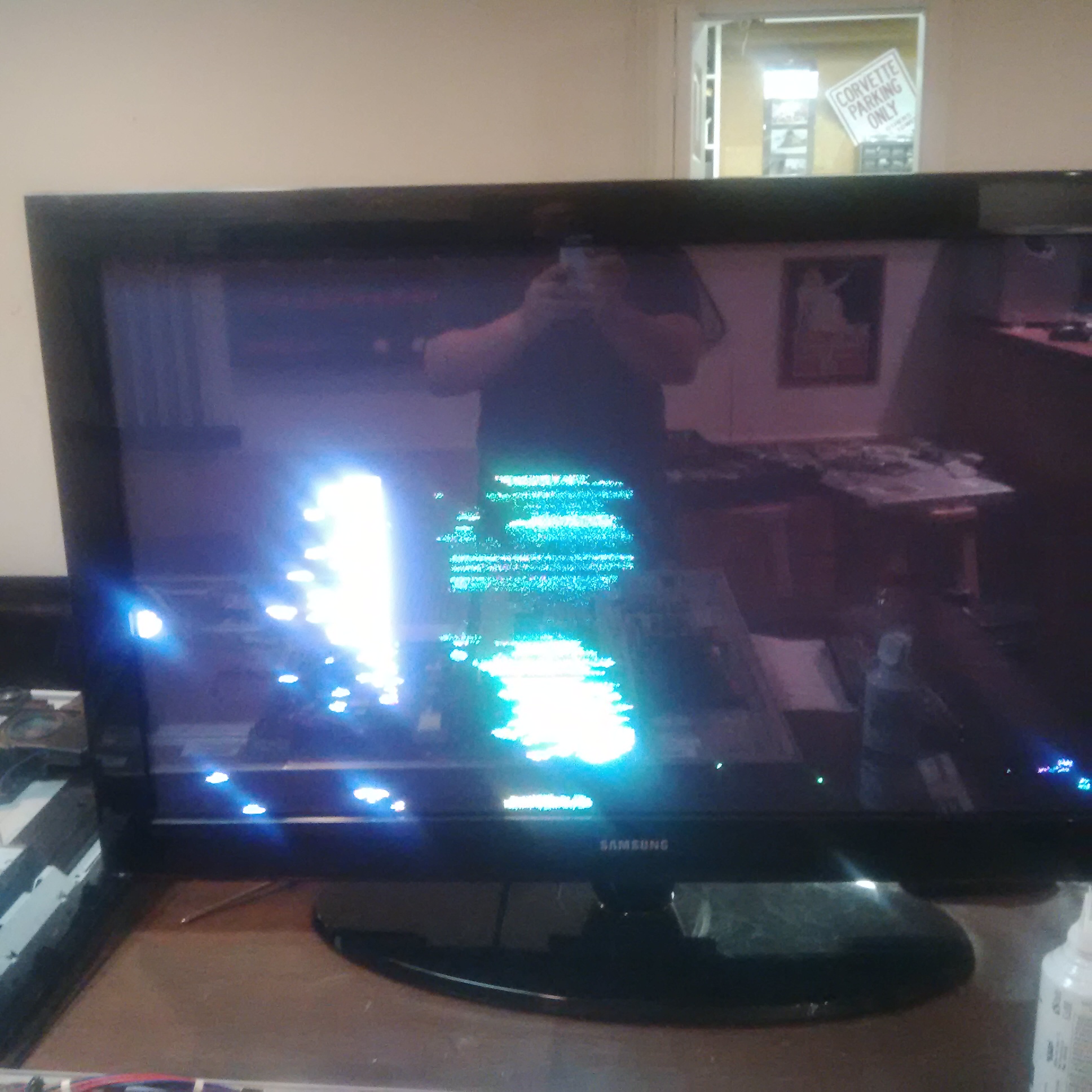

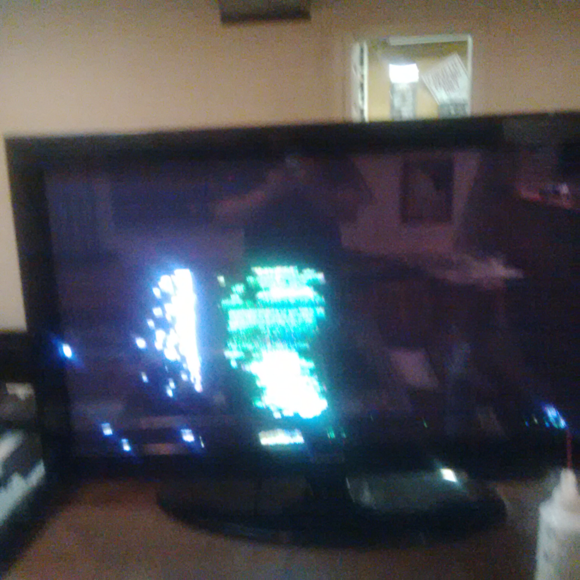

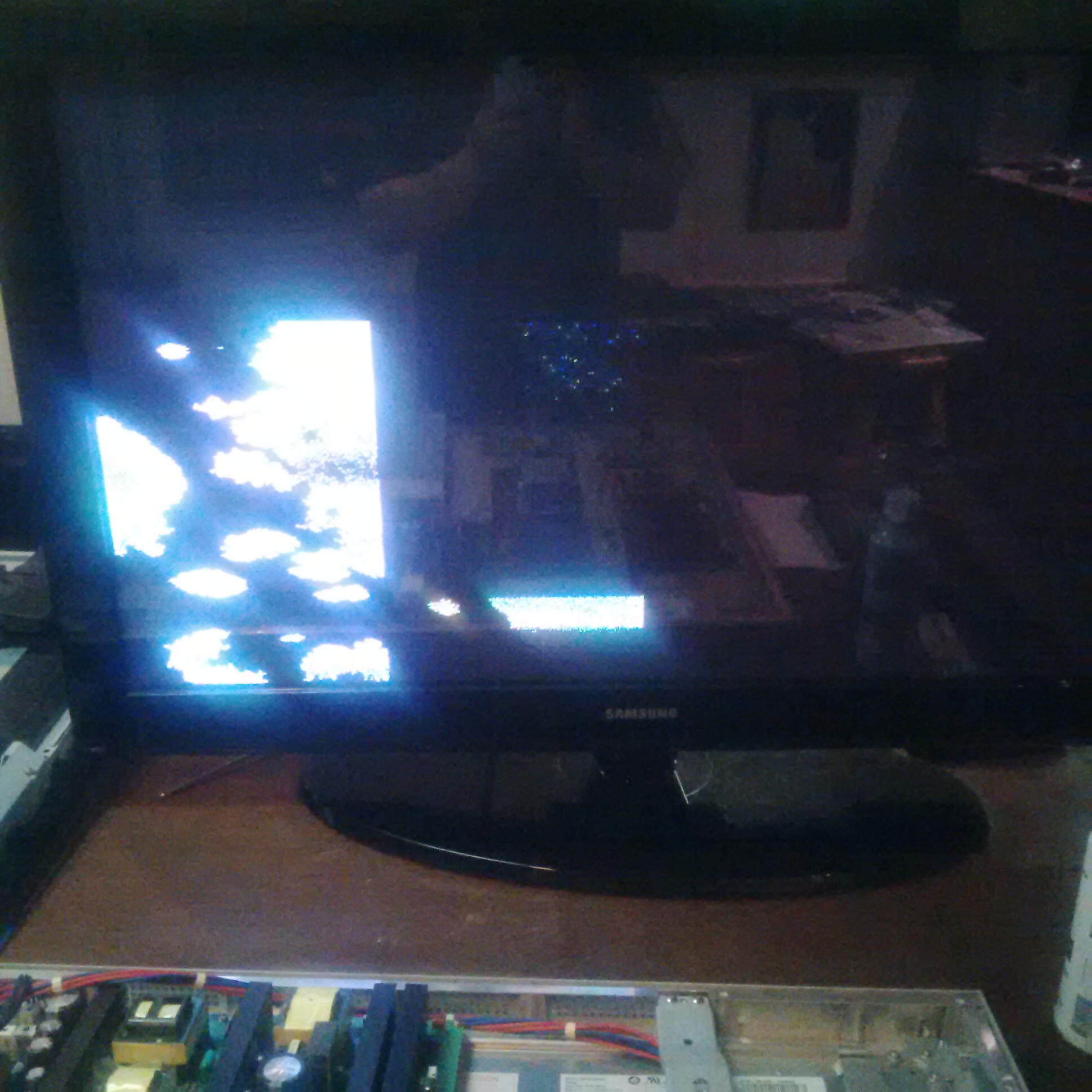

    I have beating my head against the wall on this one. I took some new pics. Pic 1 is when you first turn it on and pic 4 is after you leave it on for a few mins. Thinking I missed something, I re-metered everything and cannot find a short or blown part anywhere. Anyone have any ideas?

      Adding to my problem. I tried the control board test as per Tom66's thread, no test pattern, same problem. My voltages never fluctuate. I tested the y buffer chips and there was no shorts. The green light on the control board blinks once per second, which is what the service manual says it should. There is a test point on the Ysus that says VSCH and it fluctuates around 15v. The Vscan is 190v like the panel says it should be. When I turn it on and get that funky display, the power light on the front blinks red for a bit then turns off and no other lights come on. I also took a flashlight to the whole panel and there is no cracks. Can someone tell me if there is something I missed?
        Re: PN42B430P2DXZC Audio No Pic Voltage good
        resistor marked 470 is actually 47 ohms (47 x 10^0). Typically 6 to 8 are in parallel so that gives you your 6 ohms right there.
        Vsch should be 120 to 150V. Is this not the case? Isolate the buffer and measure without it. What does Ve measure?

                        I decided to beat this tv up again. I didn't order a logic board yet. It's blinking green normally. I did unplug the ribbon cable from the Xsus to the panel and the picture didn't change. I noticed that my voltage on the Y buffers are all 149v except for the first 2 pins on the top connector. Dunno if that's normal. Anyone have anything I should try? Or should I be taking the loss and tossing it.
                        EDIT: I noticed there is no red light behind the cover of the digital audio connector. I'm wondering if it's the main board or the logic board.
