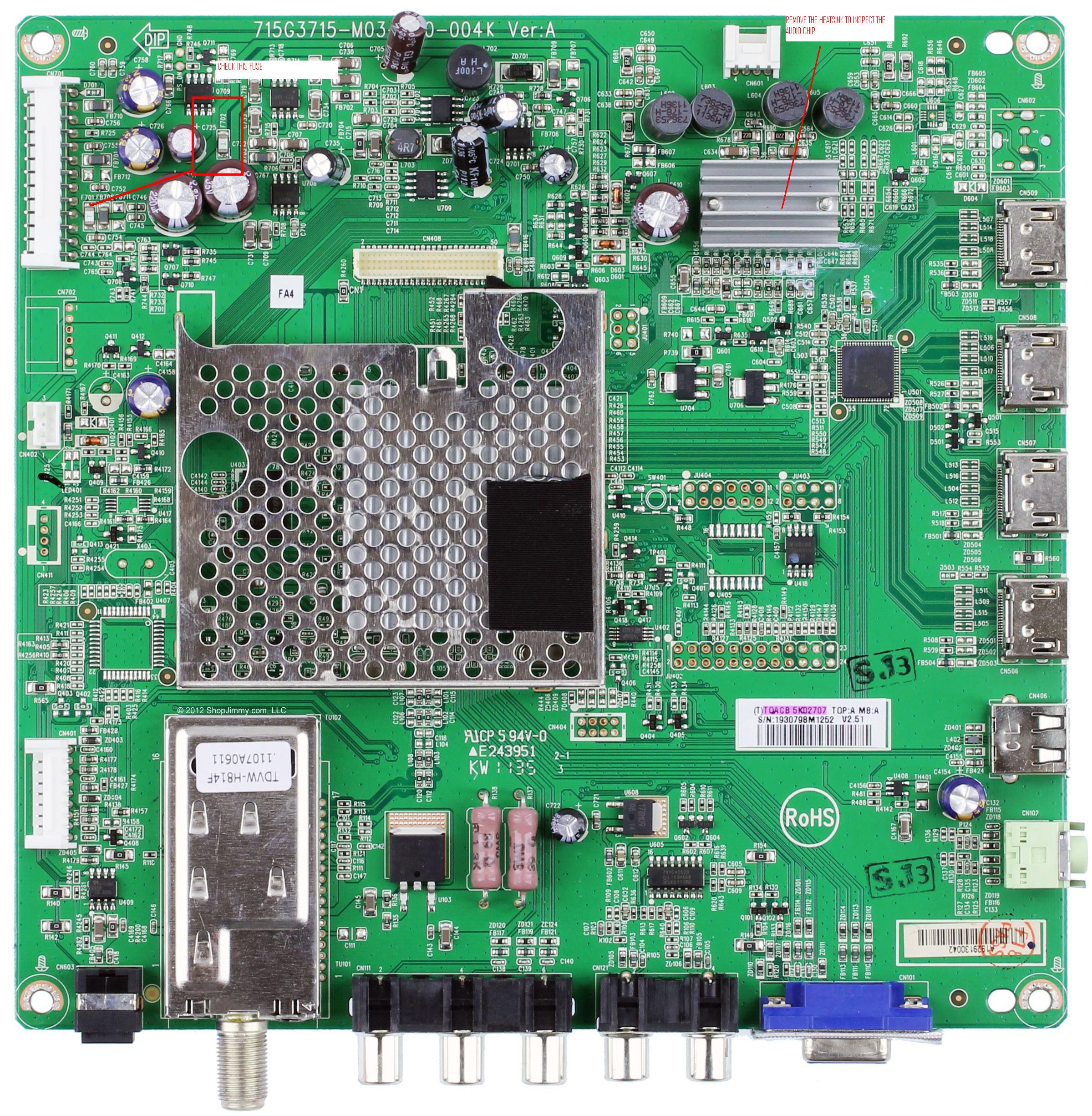

                Re: Visio E320VA No sound
                post pictures of your main board and power supply
                I was using the datasheet from the audio chip as a reference

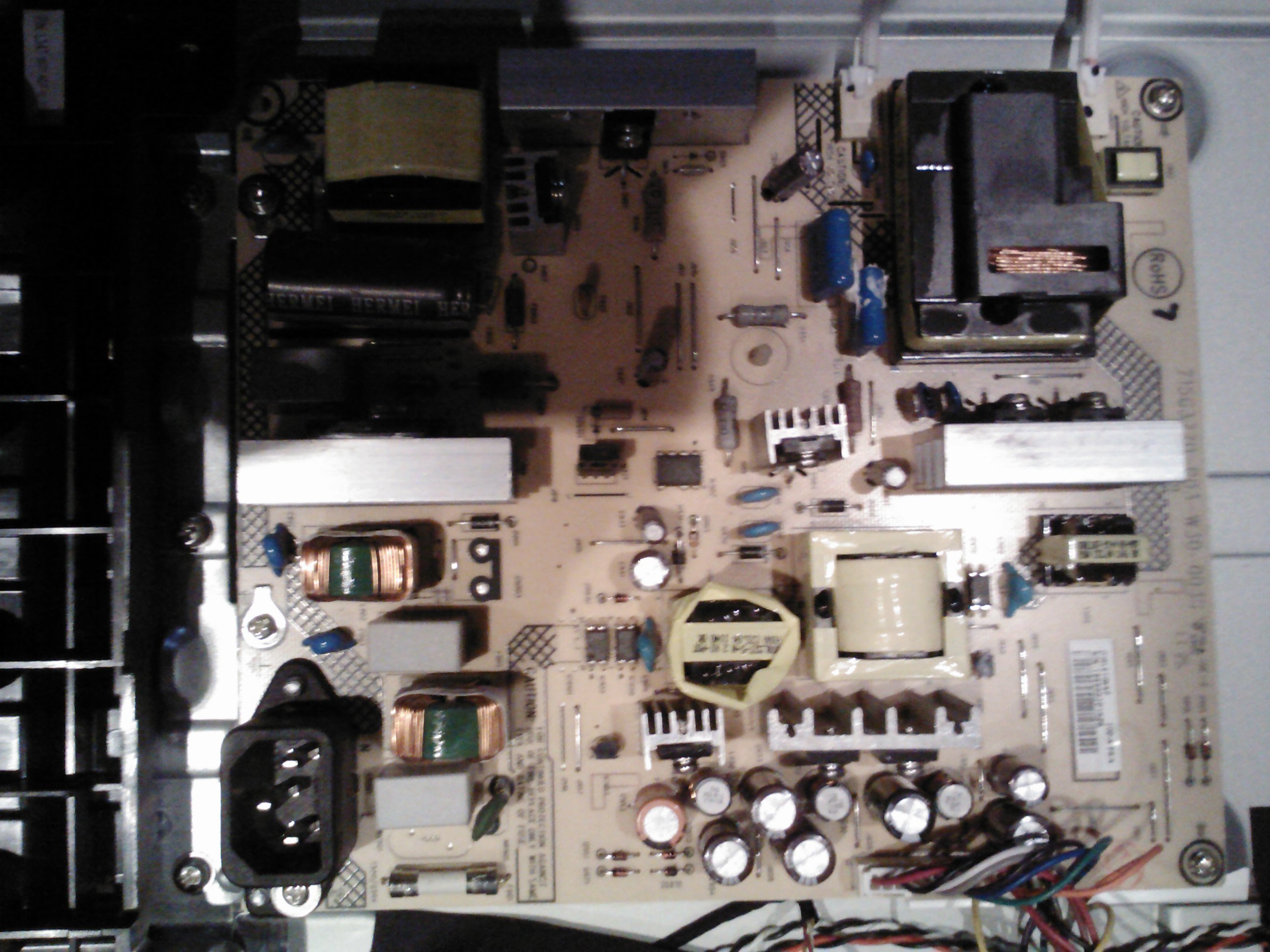

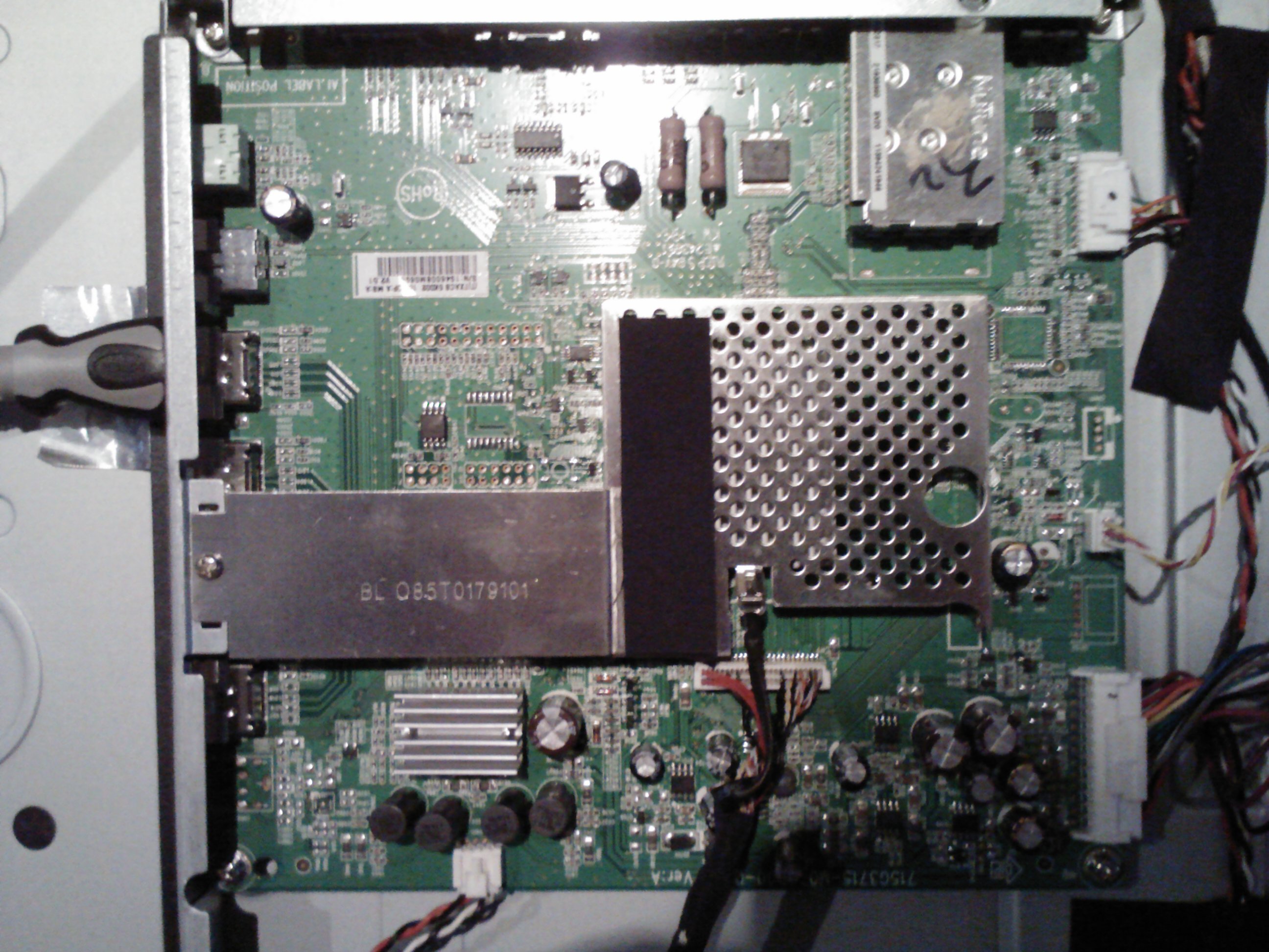

                    Pic's attached
                    • ecking767
                      • Oct 2009
                      • 492
                      You can start by checking the fuse for the +12v going to the audio section. You will have to remove the heat sink to examine the audio chip if the fuse is blown
