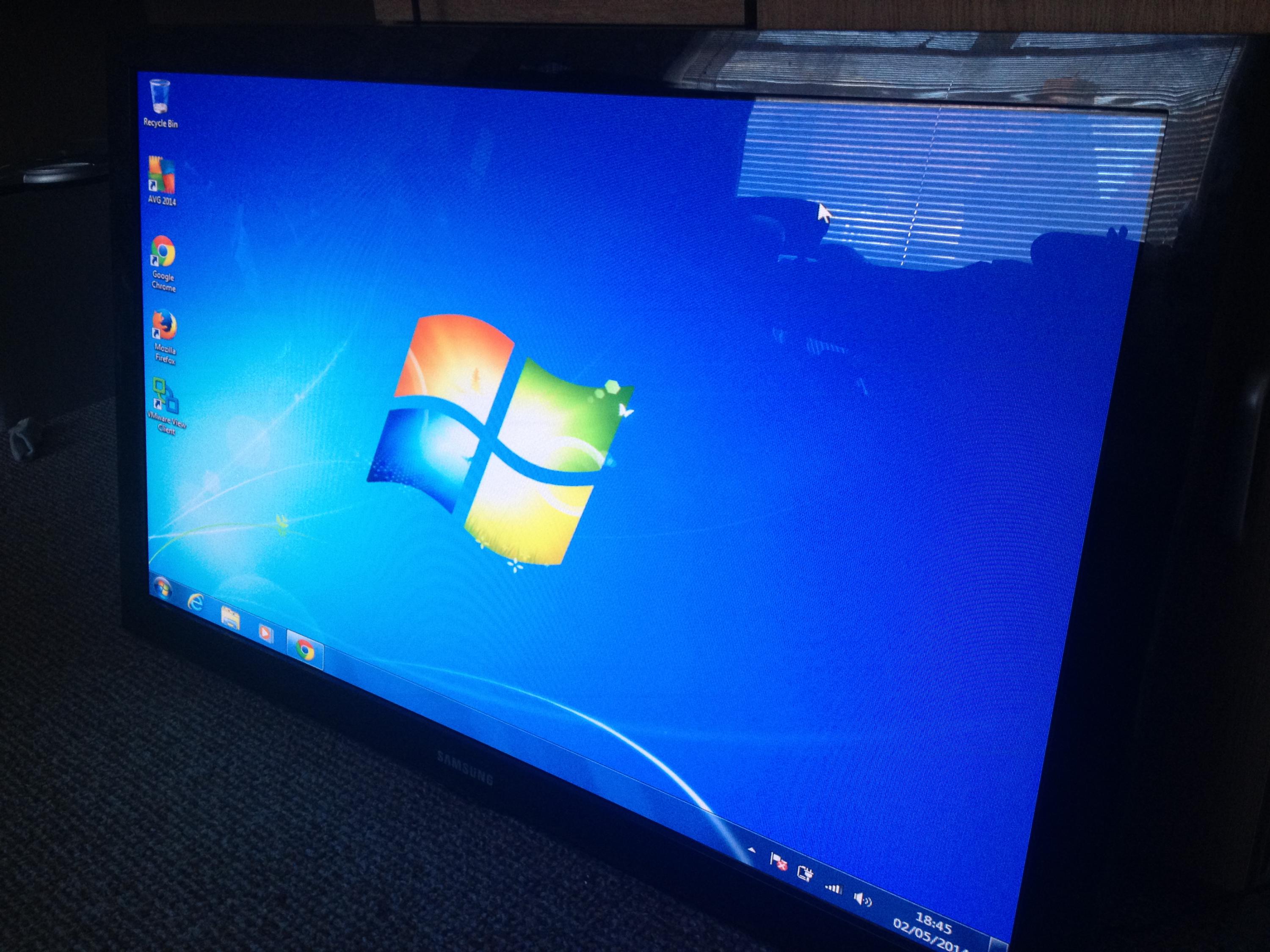

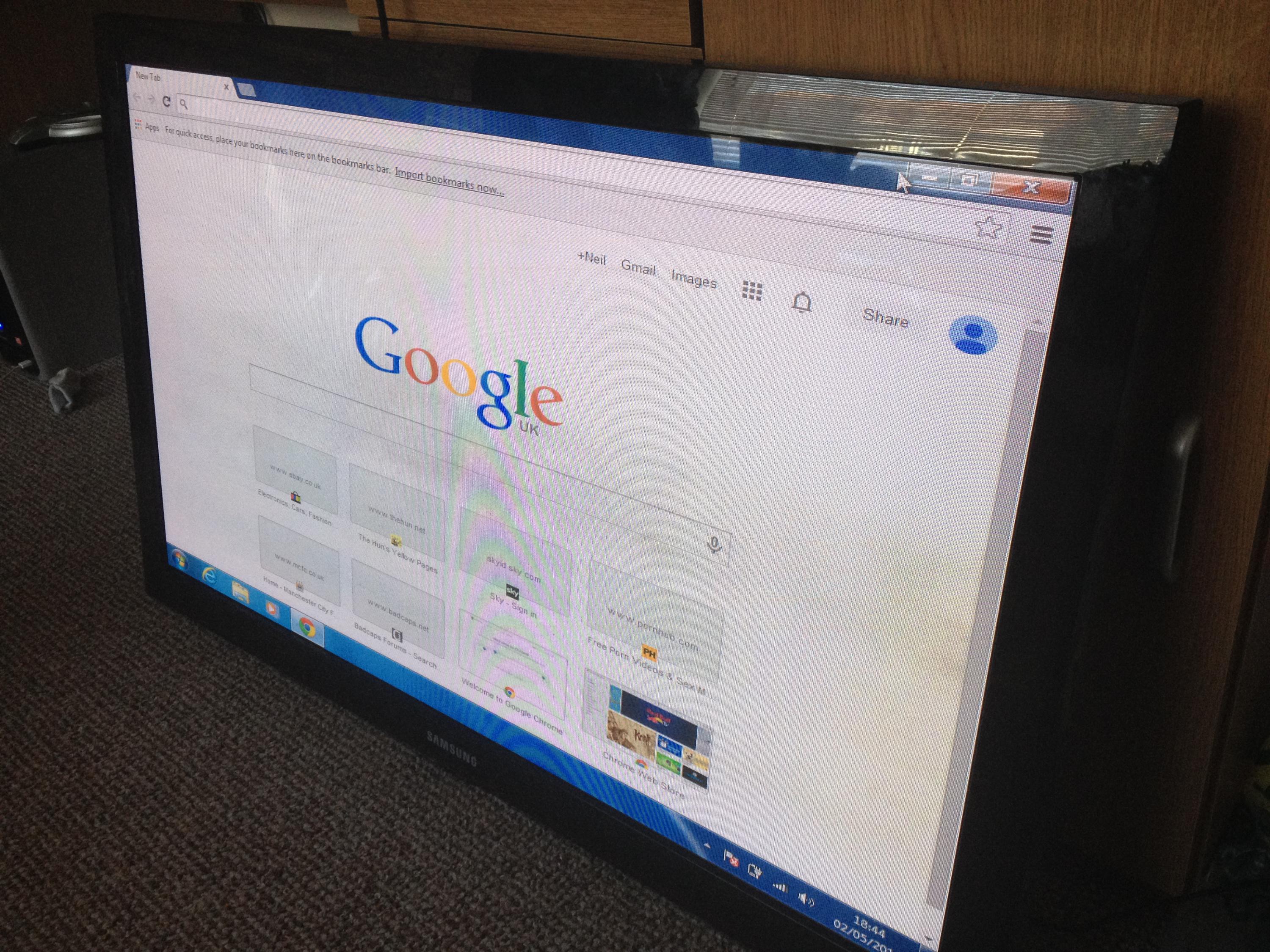

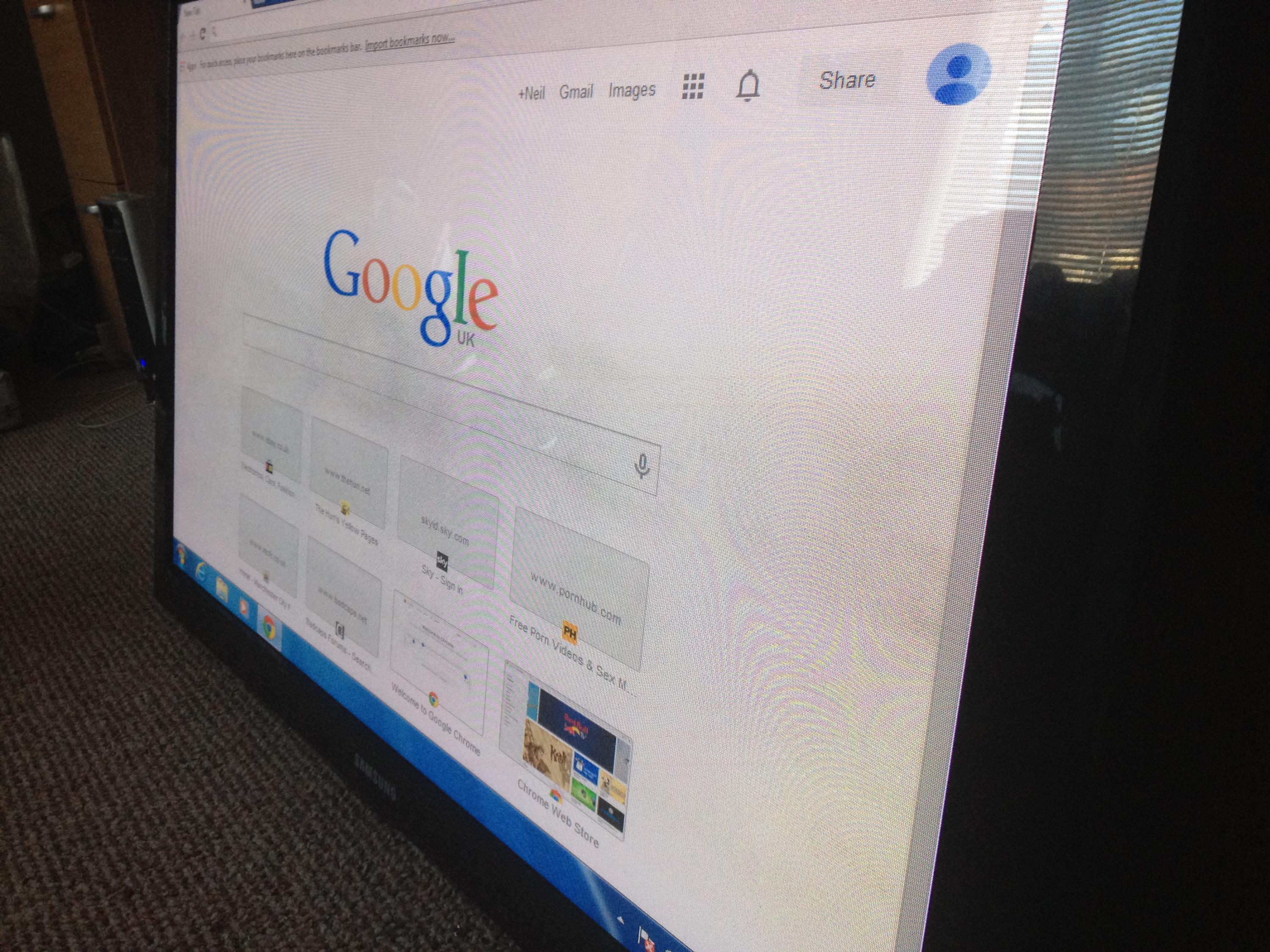

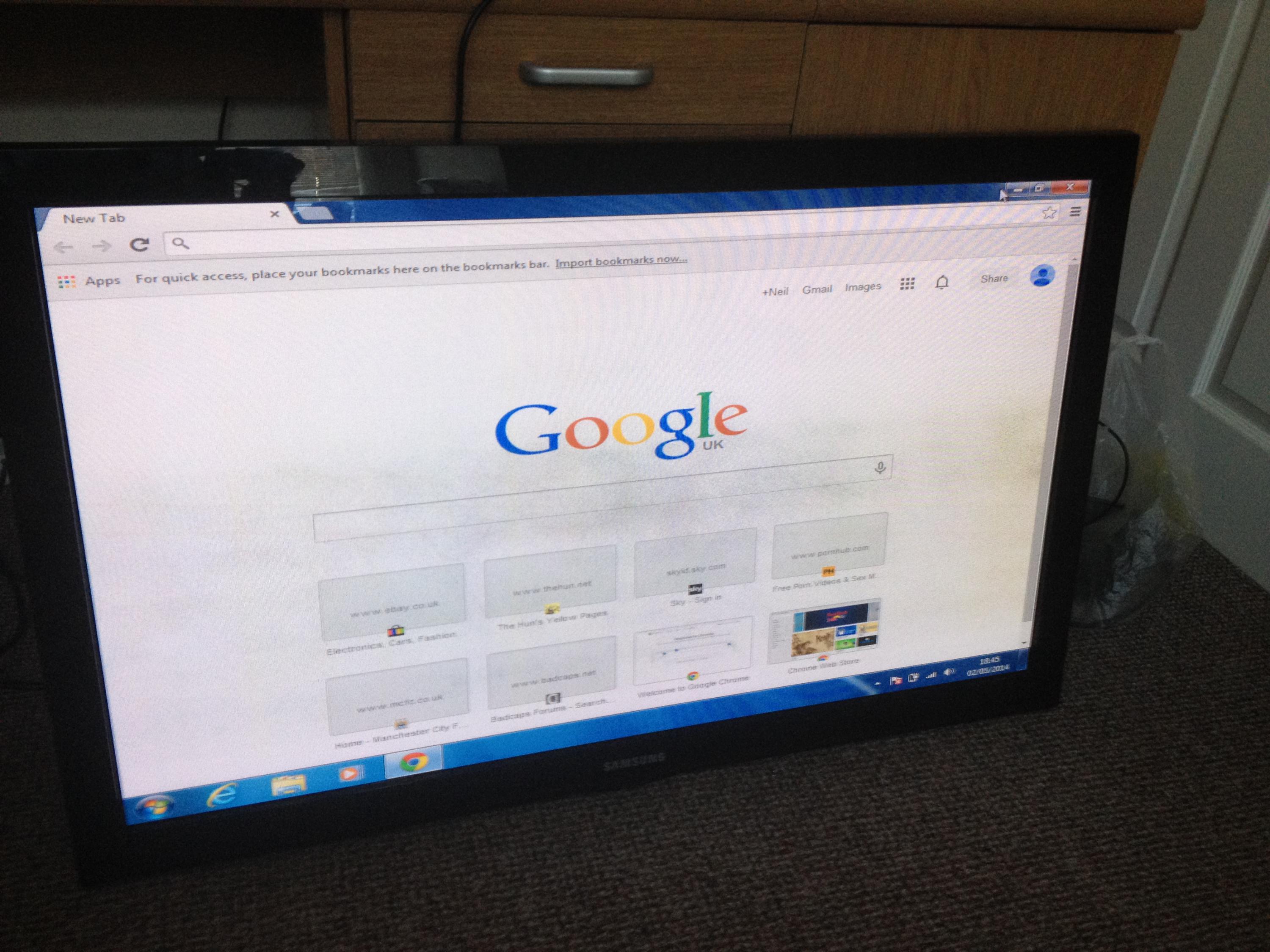

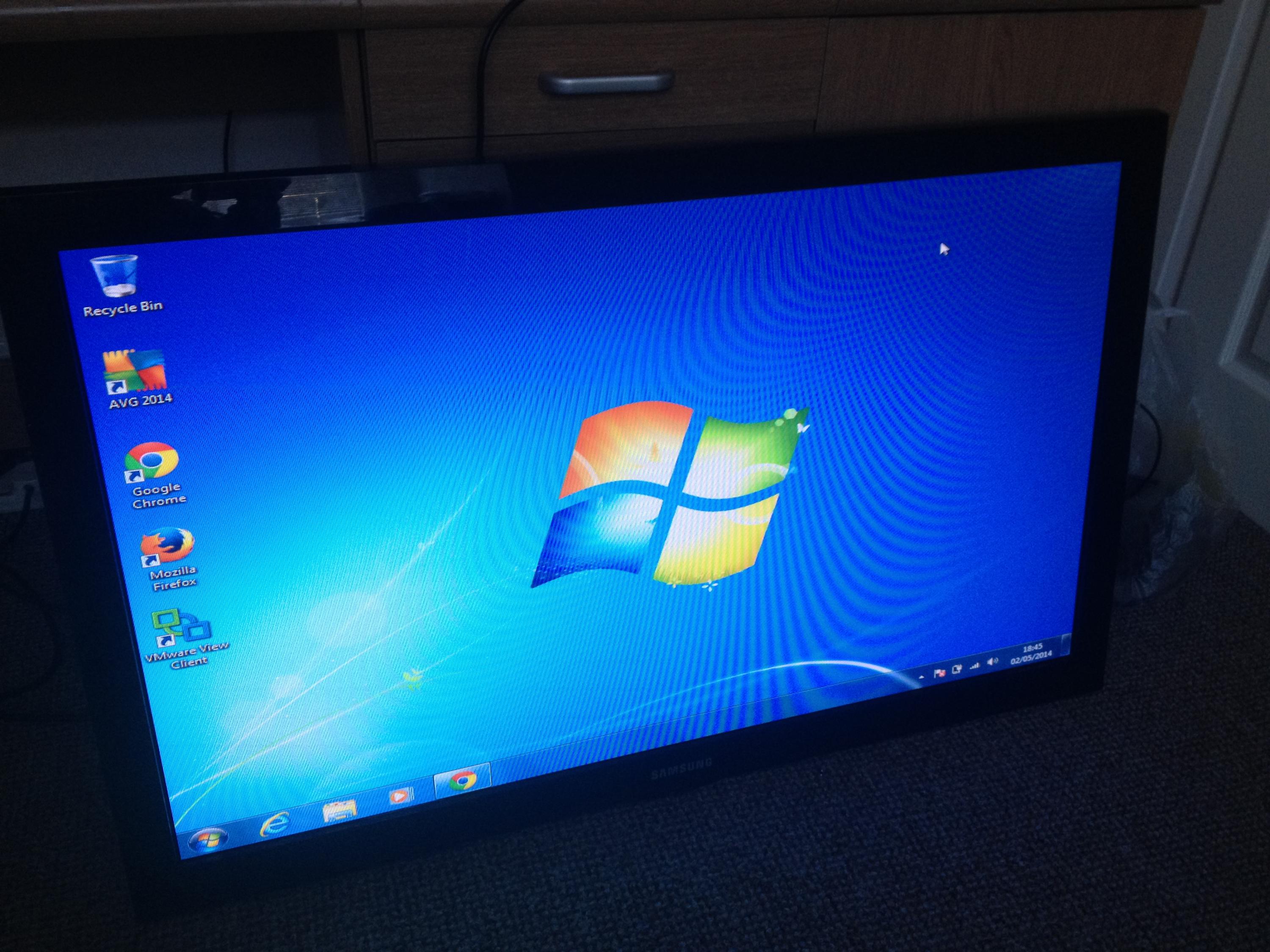

    Hi All
    Got this one with a fault of "turns off after a few minutes"
    Tested tv for well over 16+ hours stayed on the whole time
    It is working fine however you noticed it struggled to show white pixels
    so if you got a large white picture you had gray / blackish darker patches in it
    other than that ie any coulour and its fine as you can see in the pics
    Been inside nothing obvious very clean all in order
    Iv upgraded the firmware problem still there
    any suggestions ?
    Re: Samsung PS42C450B1W - image quality on white screen
    Check Vs voltage on PSU. Match panel sticker. If it is still showing fault increase by about 5V.
    • noledud
      • Dec 2013
      • 413
      • united kingdom
      spot on tom as always, increased +5 as it was correct and that sorted it
      thanks mate
