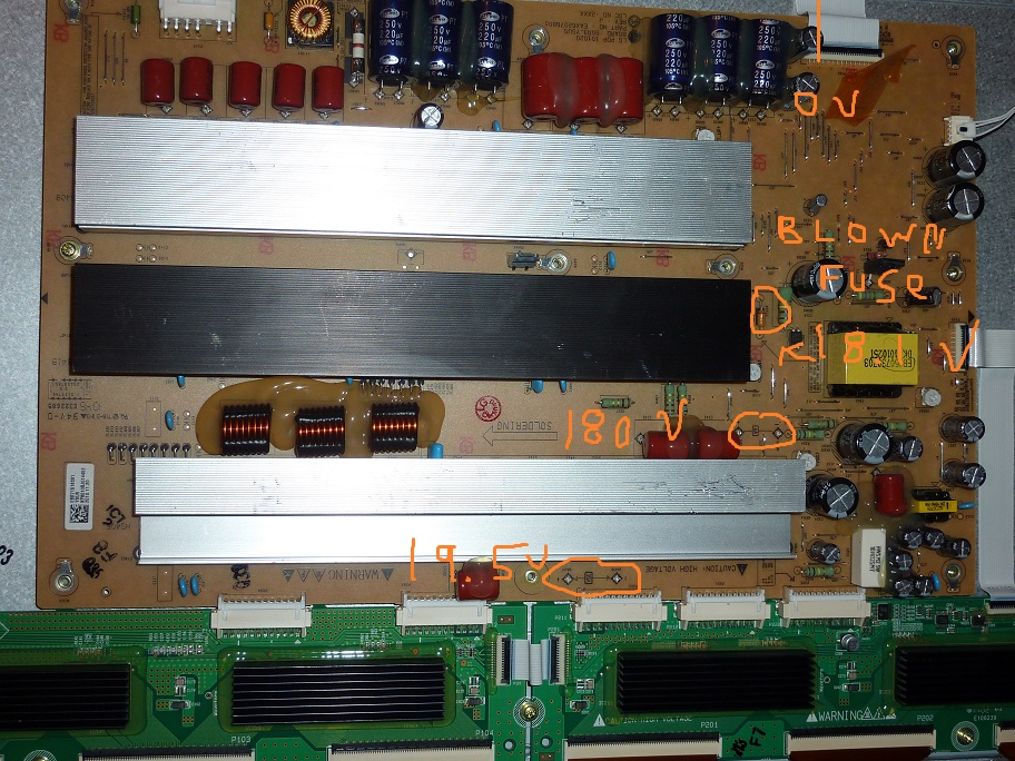

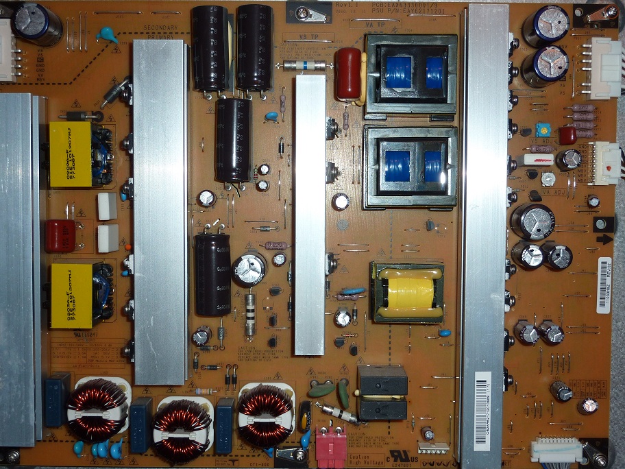

Hi allβ¦..new member here and I need help with sound only on my LG 60PV450. First thing I did was check all the voltages on the power supply and they all checked out good. Then I checked out all the fuses and the FS104 2A 125v fuse was blown on the Y-sus. I have good soldering skills but decided to order a new one on Ebay. Before installing it I checked all the fuses and they were all ok.
After installing the new Y-sus board, I turned on the TV and nothing but sound and the FS104 fuse burned out again. Back to square one.
Learned quite a bit from Tom66 and others, I have attached some pictures with voltage values.
Va 55v
Vs 202v
Vy 180v on Y-sus
Vsc 19.5v on Y-sus

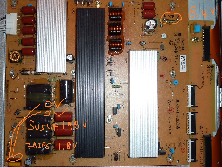

Vzb 8.4v on Z-sus
Zbias 1.8v on Z-sus ribbon cable
Sus-up 198v on Z-sus ribbon cable
Pin 1,2 of Z-sus ribbon cable should be 18V and it's 0
Pin 1,2 of Y-sus ribbon cable should 15v and it's 0.
I tried jumping the logic board cable and pulling the ribbon cable without anything displayed.
Any help would be much appreciated!
