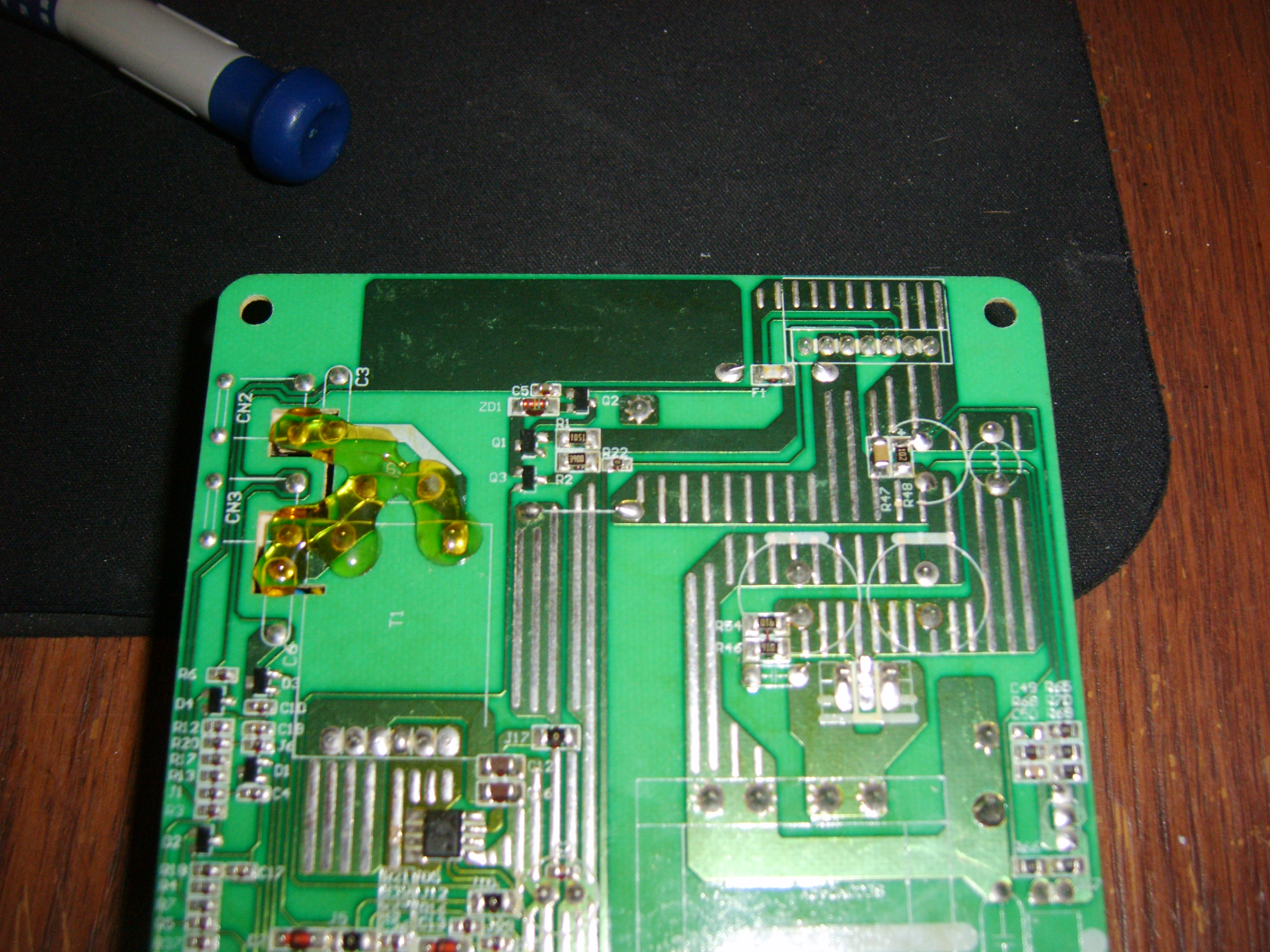

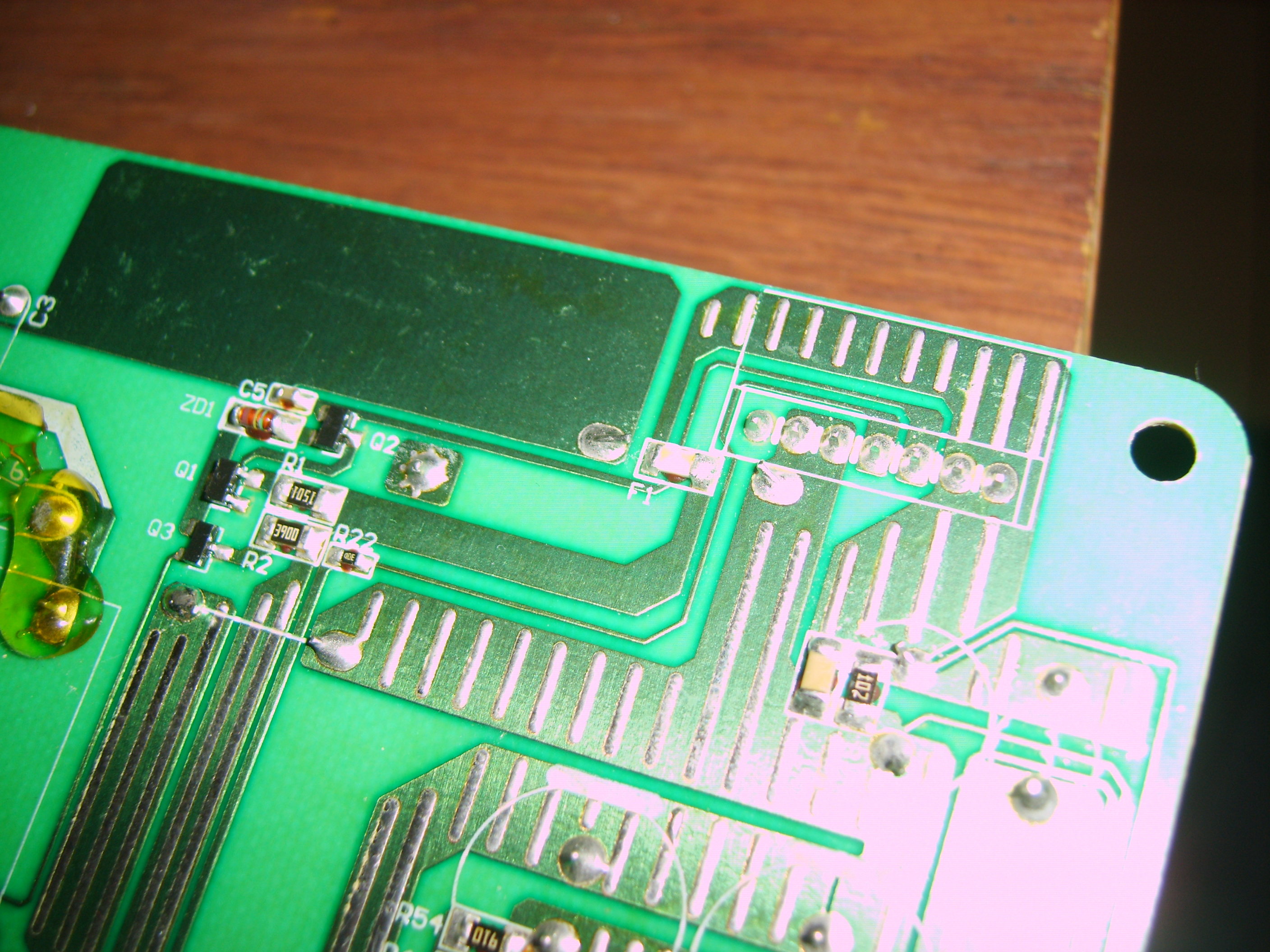

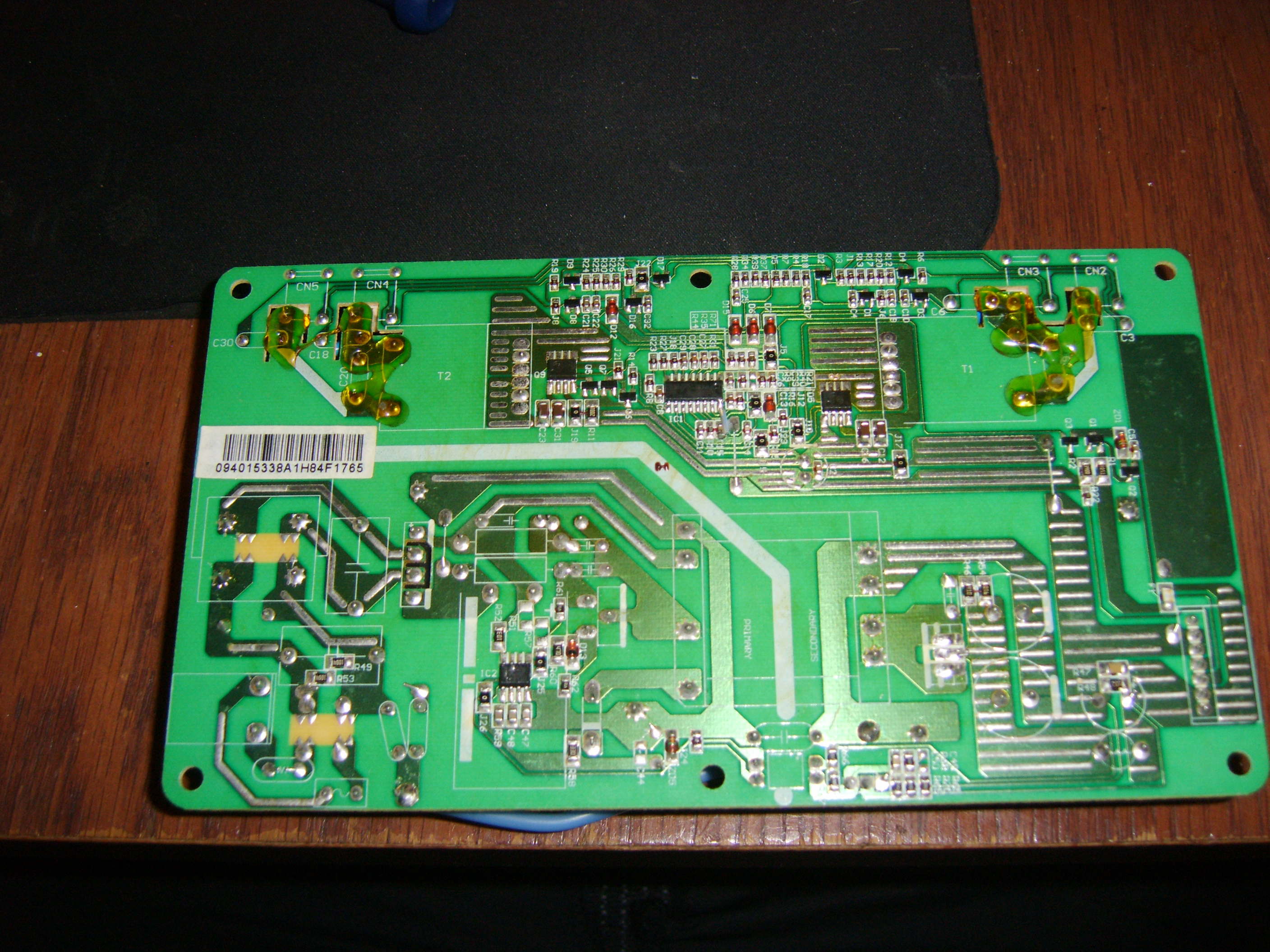

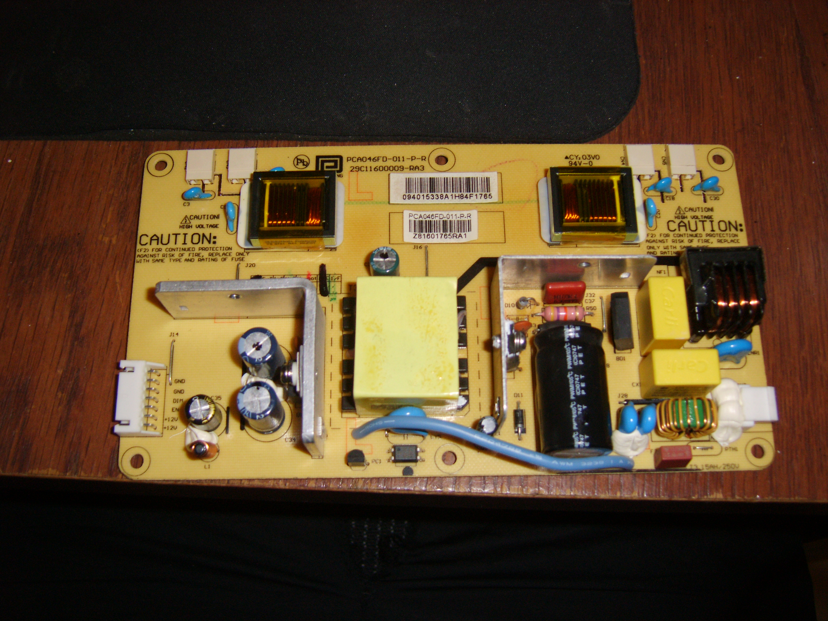

    Picked this up free a few weeks ago and as it kept blowing mains fuses I didn't go any further
    but have some time now so thought i'd take another look
    nothing obvious from what i can tell maybe 1 part on the back on the secondary side (f1 near the main board power connector, looks whitr but with tinges of brown round the sides) but assuming this is irrelevant as if it's blowing main fuses it has to be a problem primary side?
