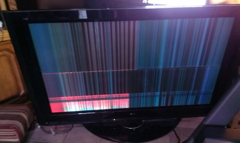

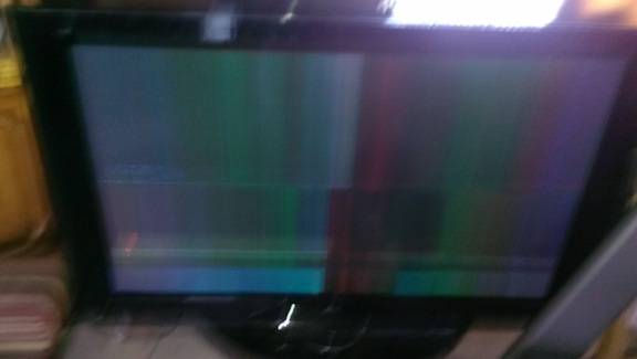

    I have a LG 60PY3DF that I got from my recycling center. It had sound but no picture and researching that I ended up replacing the large board on the left side with 6 heat sinks. That brought back some sort of picture but not images from the input dvd player. Now it is showing multi colored lines around the screen with dividing lines.
    These appear without any input source but the color is more bland.
    I have sound and the power seems to be ok over time.
    I have posted 2 photos.
    Any help here is appreciated.

      Re: LG 60PY3DF - problem colored lines in both directions and blinking red spots
      Likely bad buffers. Could be a Y-sustain fault. I doubt it is a Z-sustain fault.
      Most likely Vscan voltage to the buffers is bad. If the panel is steady and not flickering the IPMs are probably OK. Check Vsc should be about 140 to 150V.
        I checked the resistor R60-Vsc one side of the resistor is 116v and the other side is 6v... =| LoL
        I tested voltage to/on the y-buffer boards on the 15v legs of the P1 and P2 connectors on the y buffers I get 22v.
        Vs and Va match panel specs at 194.# to panel 193 and 60v to 60v on ymain.
        update:
        After noticing the split voltages on R60 i started to test other resistors and several are open... =| hmmmmm hows this thing even working a little bit still is beyond me lol
