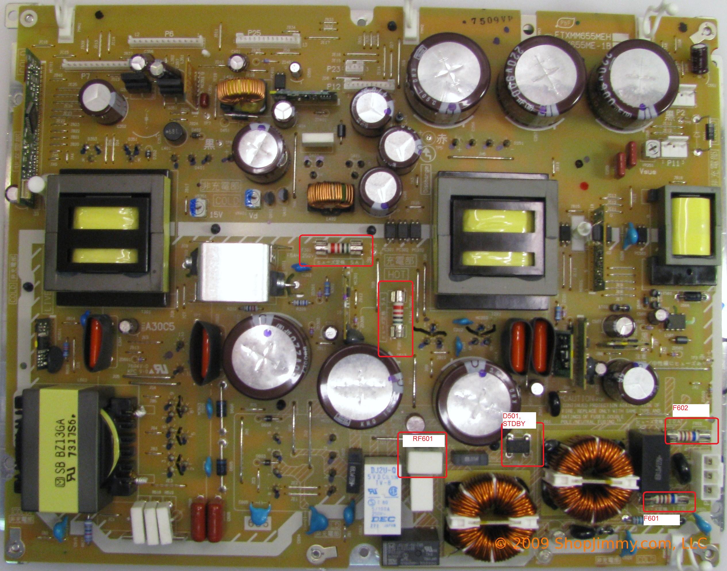

    Have a panasonic th50PX77u thats completely dead (apply power - no clicks or lights) - PSU etxmm655meh.
    checked all fuses (4)
    no 5V at pin 5 of connector A7 when the
    TV is plugged into the AC line
    TV unplugged - 1 ohm continuity between pins 8 and 10 of connector P12 of the P board
    disconnected A7 conn - set does nothing,
    assuming the PSU is bad. looking for diagnostics on PSU - or what to look for ?
    does anyone have any diagnostic or repair tips for this PSU ?? I've seen a blog that says replace MC201, MC301 and maybe IC tea1610. Thanks

    You have no STDBY 5v so I'd start with the fuses F601,602,501, thermal fuse RF601.
    manual and troubleshooting guide should be in Tom's reference library in the sticky.
    TRAINING MANUAL
    SERVICE MANUAL
    you should be able to start a new post from the front page.

      done the basics - took off heat sink on psu. checked all fuses. RF601 - all good.
      no 3.3V at pin 6 of connector P7 when the TV is plugged into the AC line
      I'll have to print out psu schematics and start over.

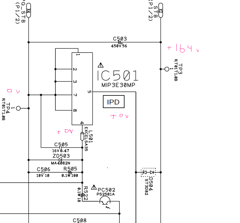

        can't seem to find any info on these ICs - attached PSU schematic and voltage readings. is there panasonic test point voltages out there ???
          Re: Pana TH-50PX77U dead
          That's the standby supply...
          What voltage do you have across C503?

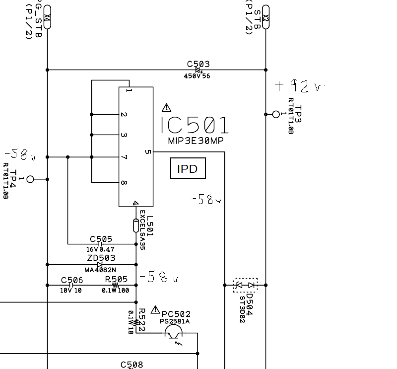

            think I wasn't using correct ground - going to re test. across c503 = +164 volts
                turns out T501 was open - removed it, had corrosion on windings for this circuit. re-soldered and set works great. Not sure how just 2 windings of this xformer are corroded - maybe some contamination ?? something must have dropped on power board right at this location. Not a fan of this set thou - doesn't have menu button on set - hard to navigate without remote (complaining on a free set !)
