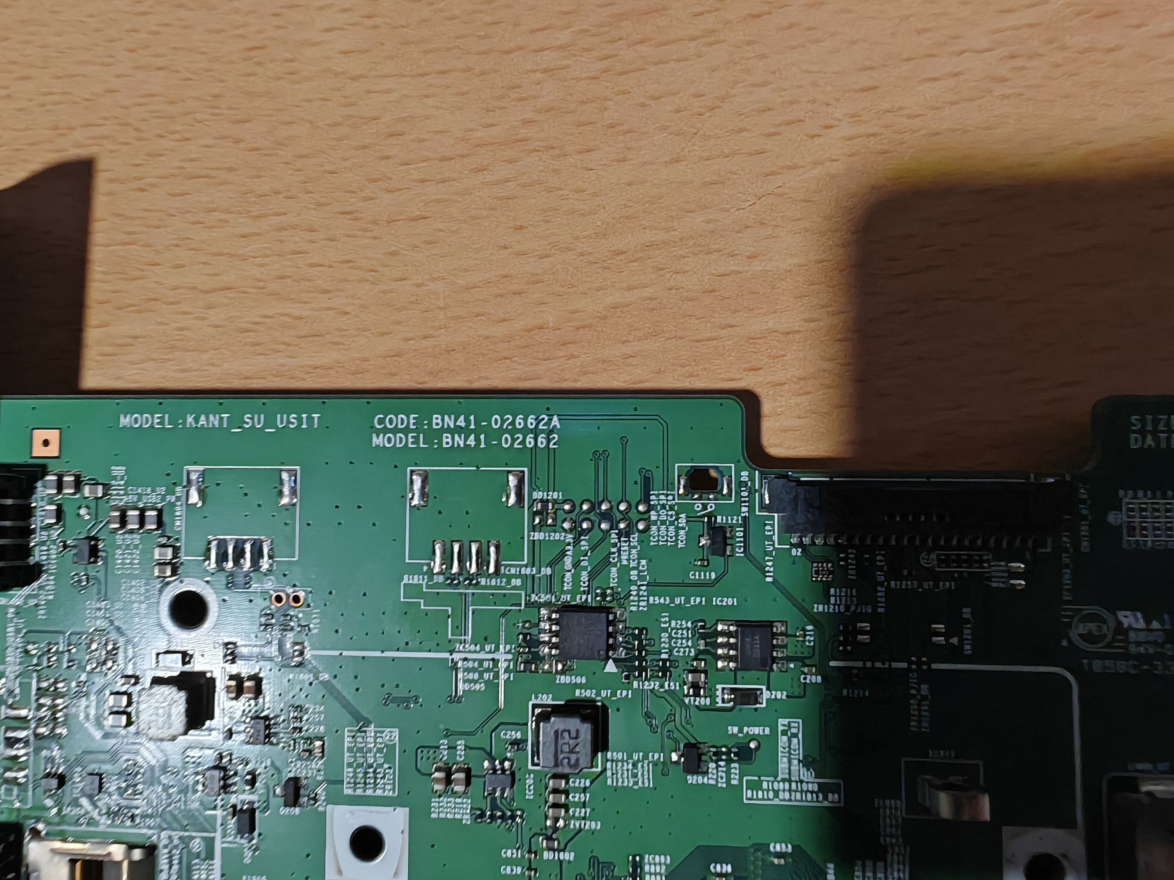

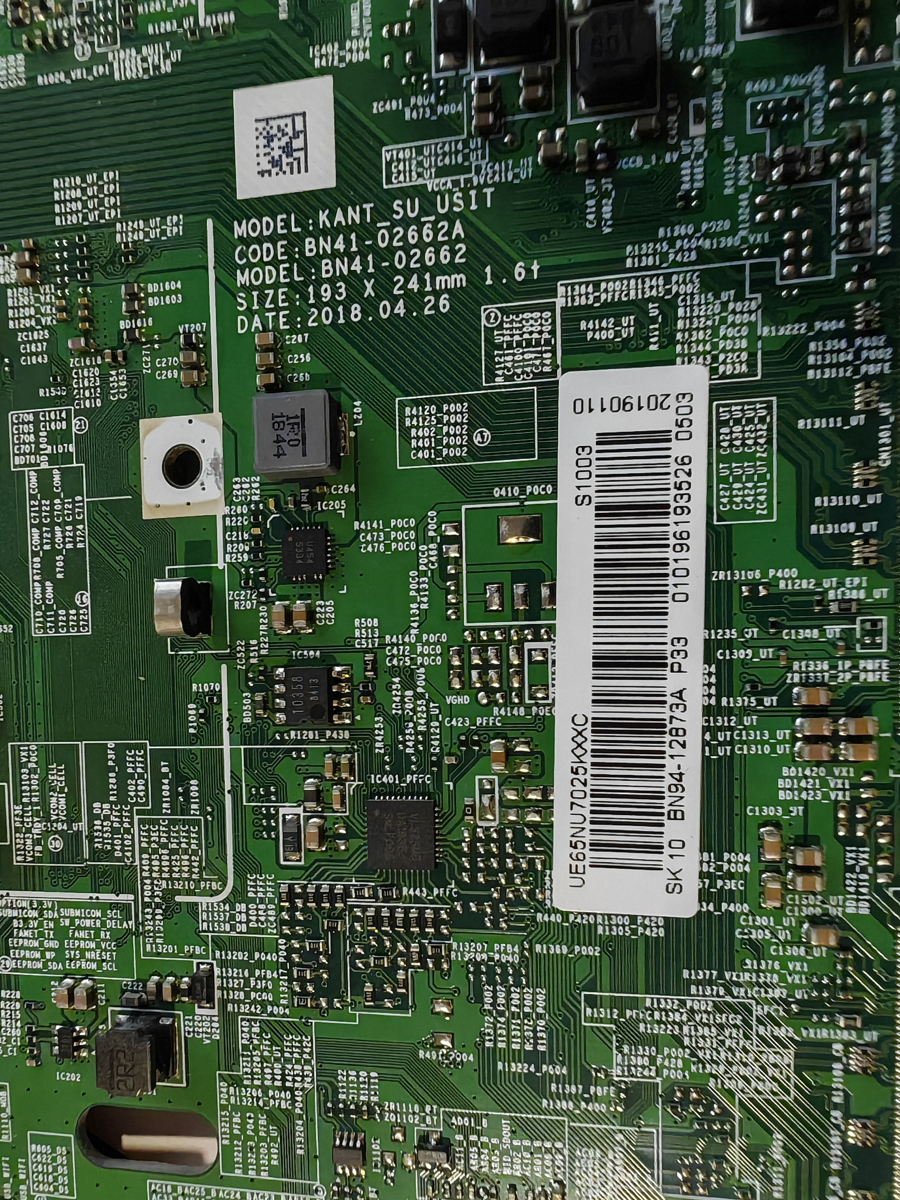

No Standby Light on Samsung SAMSUNG UE65NU7022
  • SJX1290
    • Sep 2024
    • 28
    • Slovenia
    👍🏻..thanks again
    • lotas
      • Jan 2016
      • 4803
      • Russia
      This is not the same, this textolite number, it can be used under a different model number, with a different matrix, with a different region...
      This is the number you need to search for. (BN94-xxxxx)
      • SJX1290
        • Sep 2024
        • 28
        • Slovenia
        ok
        • lotas
          • Jan 2016
          • 4803
          • Russia
          Yes.
          • SJX1290
            • Sep 2024
            • 28
            • Slovenia
            can I get MB with same textolite number ( smaller size tv 55") and change dump?
            • lotas
              • Jan 2016
              • 4803
              • Russia
              It may not help, besides dump, you also need to reinstall the position resistors.
              • nomoresonys
                • Jan 2013
                • 12306
                • U.S.
                Any update?
                • SJX1290
                  • Sep 2024
                  • 28
                  • Slovenia
                  Tryed some more to find problem, no success.... I just got MB from same series but 55". I will try with transition to 65",...pls advice with position resistors
                  • SJX1290
                    • Sep 2024
                    • 28
                    • Slovenia
                    #29
                    I have now 55" MB from same series... how to deal with position resistors, where are located and what to do with them
                    • lotas
                      • Jan 2016
                      • 4803
                      • Russia
                      #30
                      You need to compare for yourself, mostly they are located in the t-con area (mostly they are rearranged for different panel manufacturers AUO, BOE, Samsung...).
                      • SJX1290
                        • Sep 2024
                        • 28
                        • Slovenia
                        #31
                        Problem solved, new motherboard from 55", t-con flash 25Q8VD reprogramed with content of same 65". So far TV working with no issues withouth any change of position resistors.
                        • lotas
                          • Jan 2016
                          • 4803
                          • Russia
                          #32
                          You're lucky, they don't always change, if the 25Q80 (t-con) firmware didn't help completely, then you need to rearrange the resistors, just like on the original motherboard.
                          • SJX1290
                            • Sep 2024
                            • 28
                            • Slovenia
                            #33
                            👍Thank you for your help, ...till next challenge🙂
