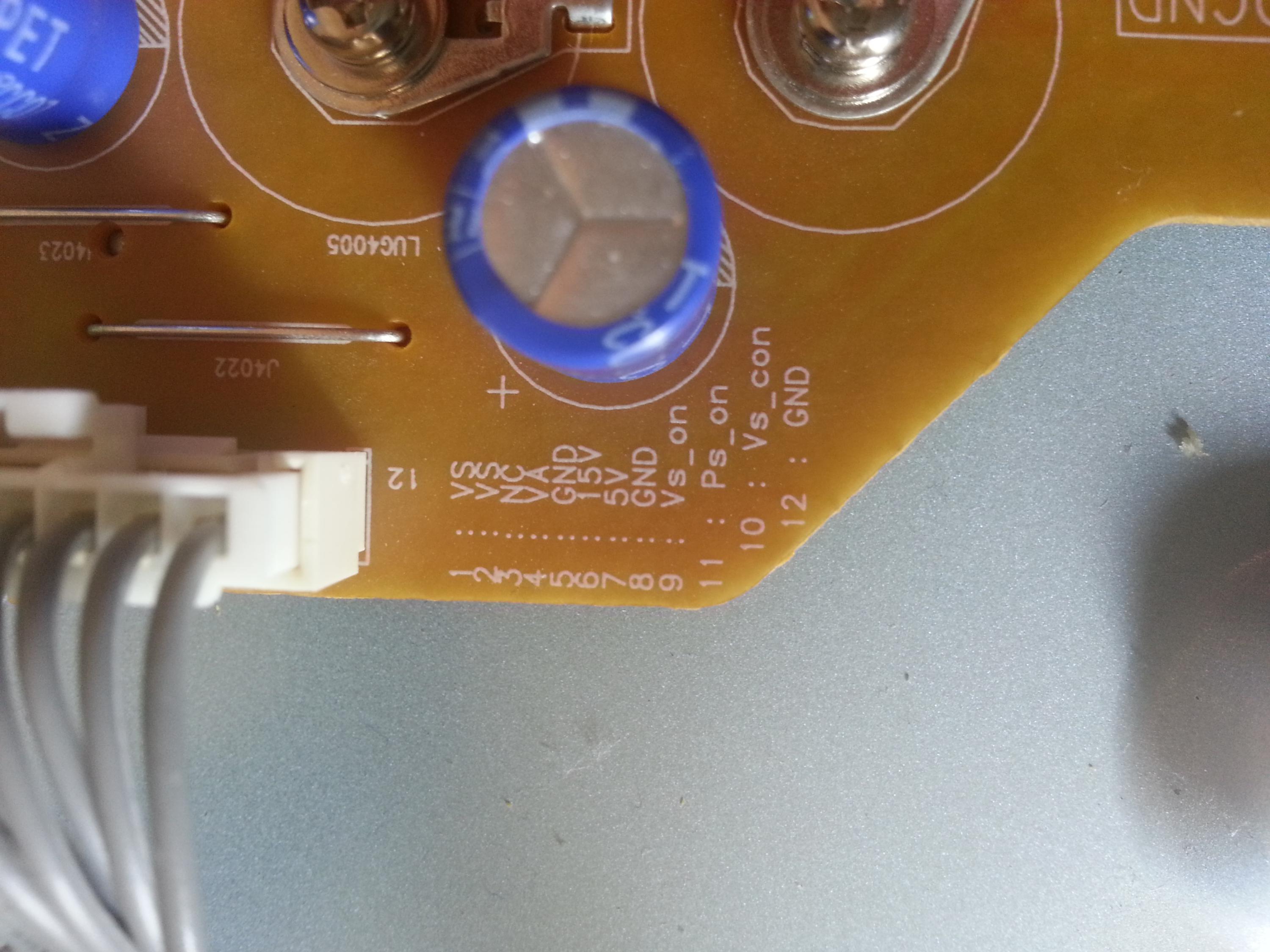

    hi guys trying to repair this. problem is when you plug in and it goes to switch on screen flashes then powers back off again then tries to boot back up. gives a few flashes of the power red led then led goes off and when tv should be on it displays nothing, no light or anything etc coming from screen.

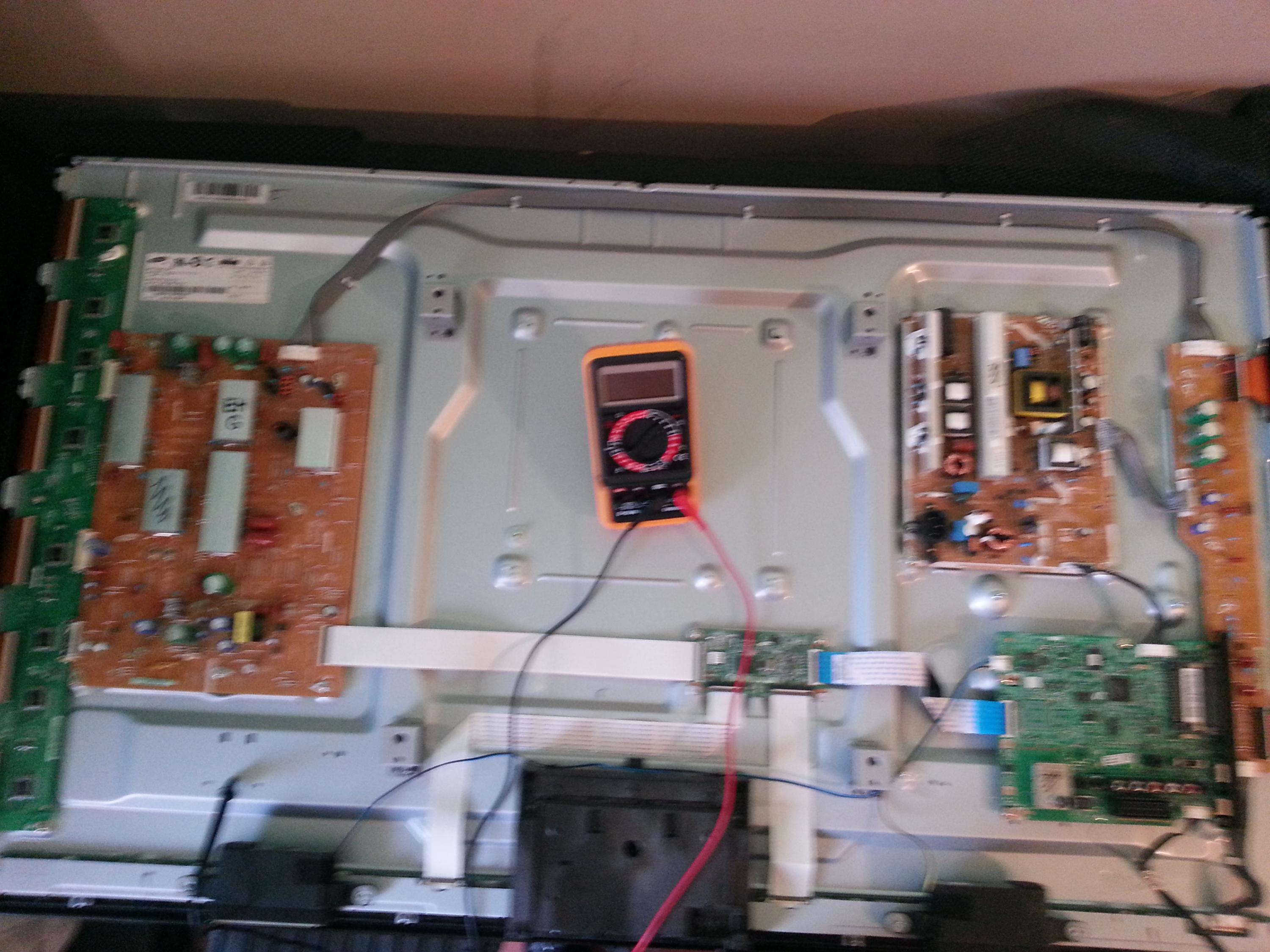

              Re: Samsung PS51E450 Plasma Problem.
              ok tom had to switch the tv on and off a few times to get voltages, its as if there is a surge going through it every few seconds so tried to catch volatges but they where all jumping between 0v to what is listed below.
                Ok, now unhook Y- and X-main board power connectors and repeat the test, check voltage on power board end. Does Vs rise higher?
                  disconnected those boards Tom, the 2 VS at 0.07v very slowly rises back up to that rather than jumping about

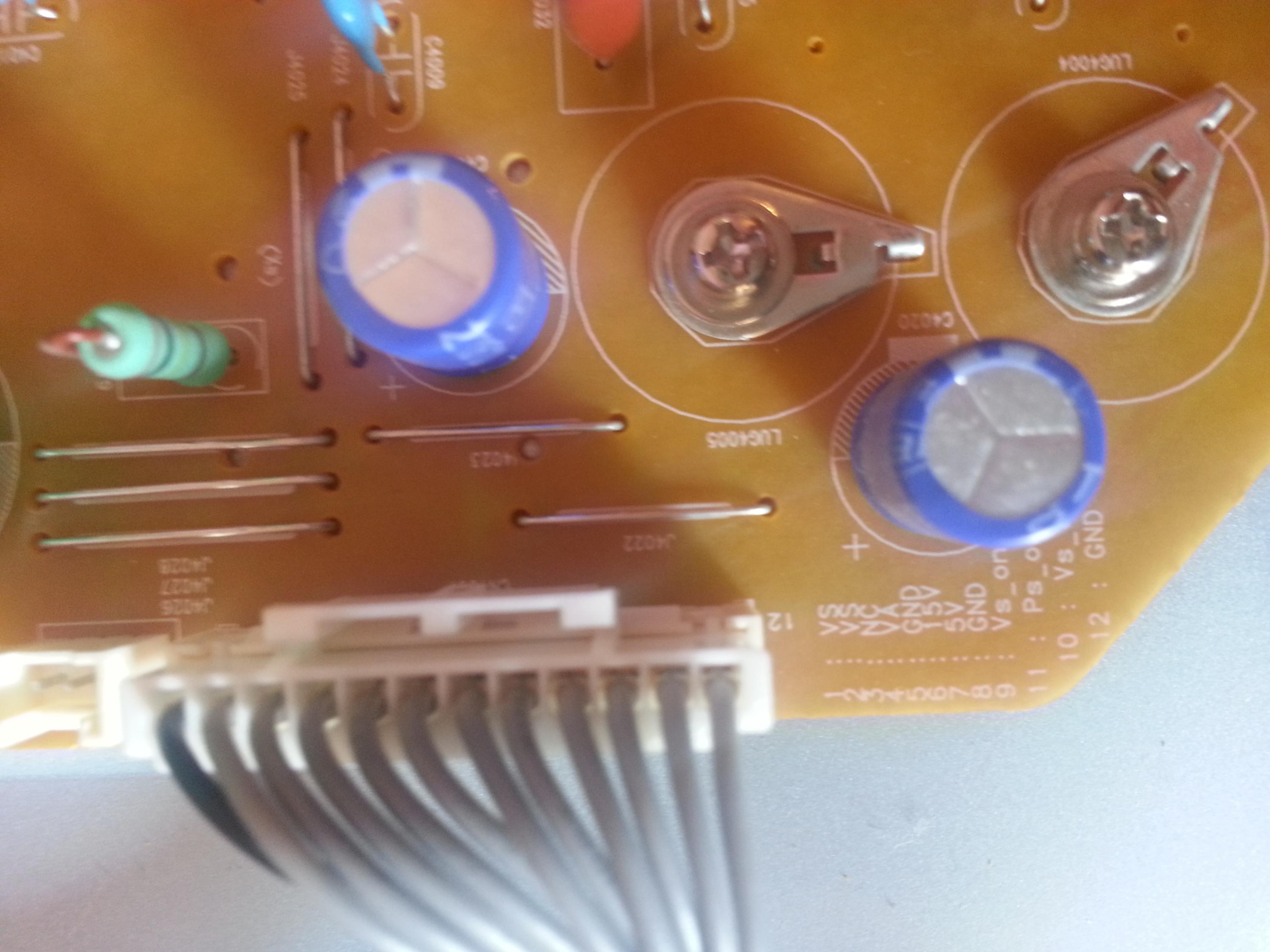

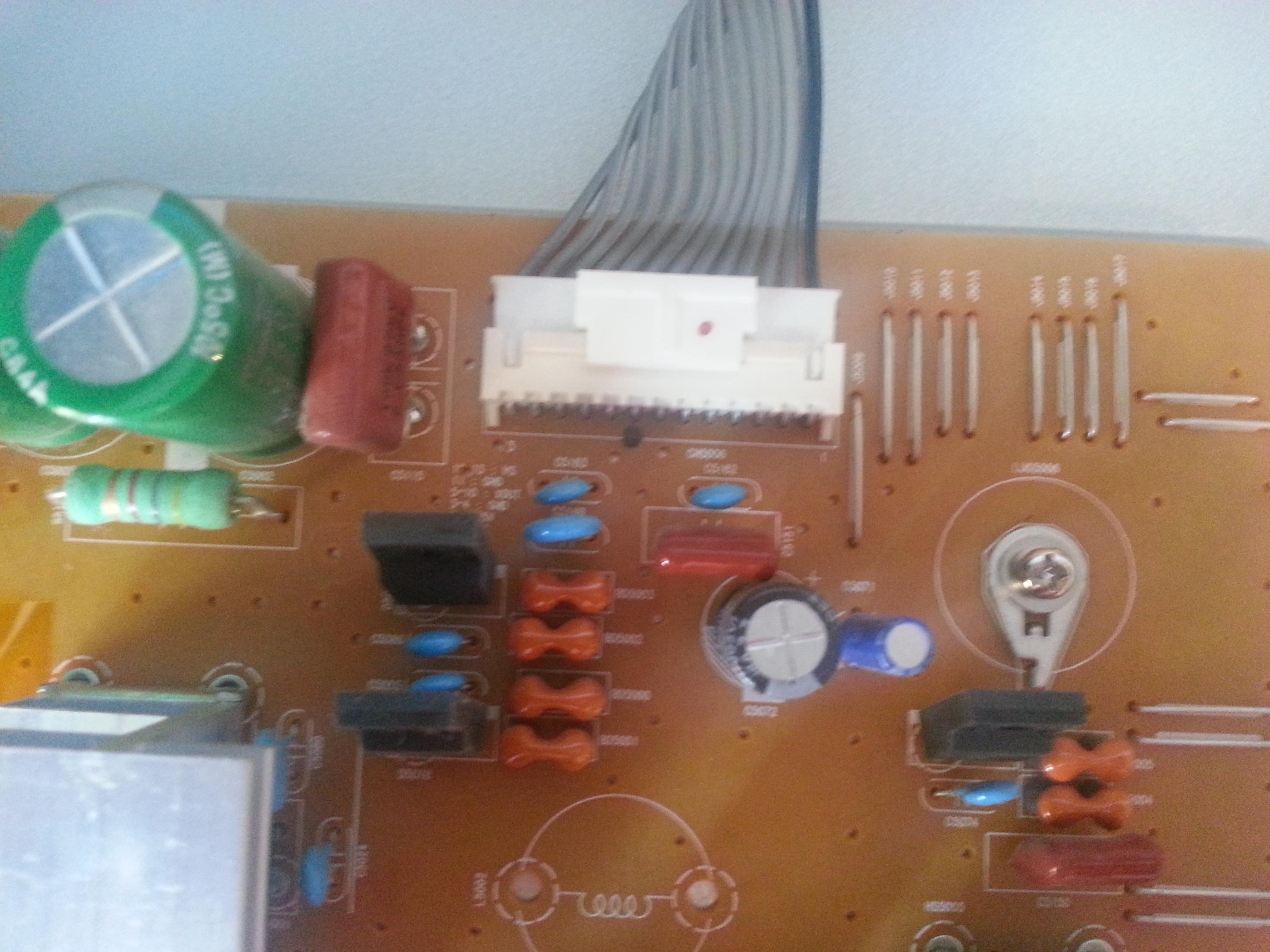

                    OK so far from what you've told me I'm thinking power board problem.
                    Can you provide a close up picture of the power board & I will highlight any necessary tests.
                    I would probably suggest a new power board - for a new TV like this they are likely to be cheap.

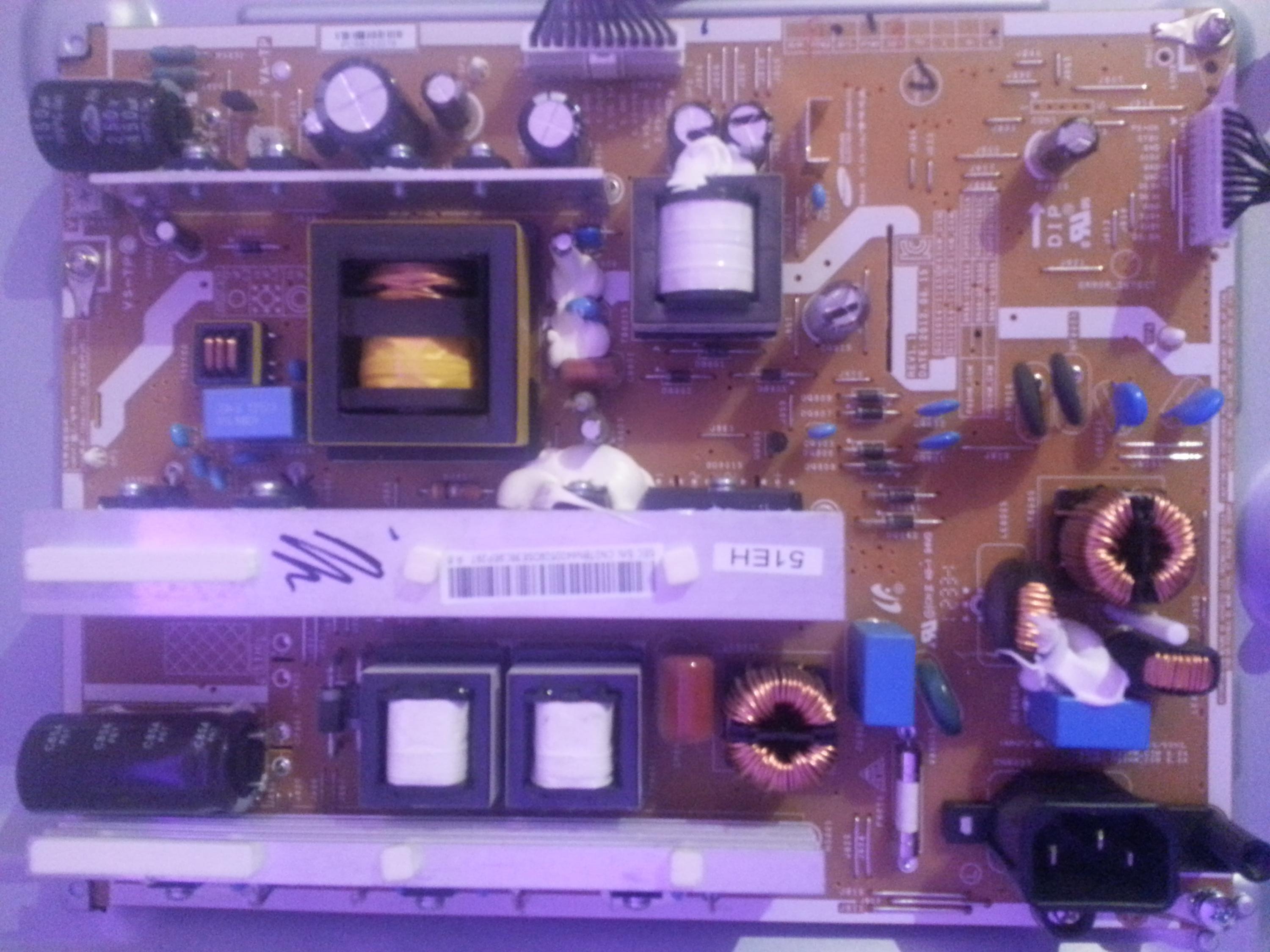

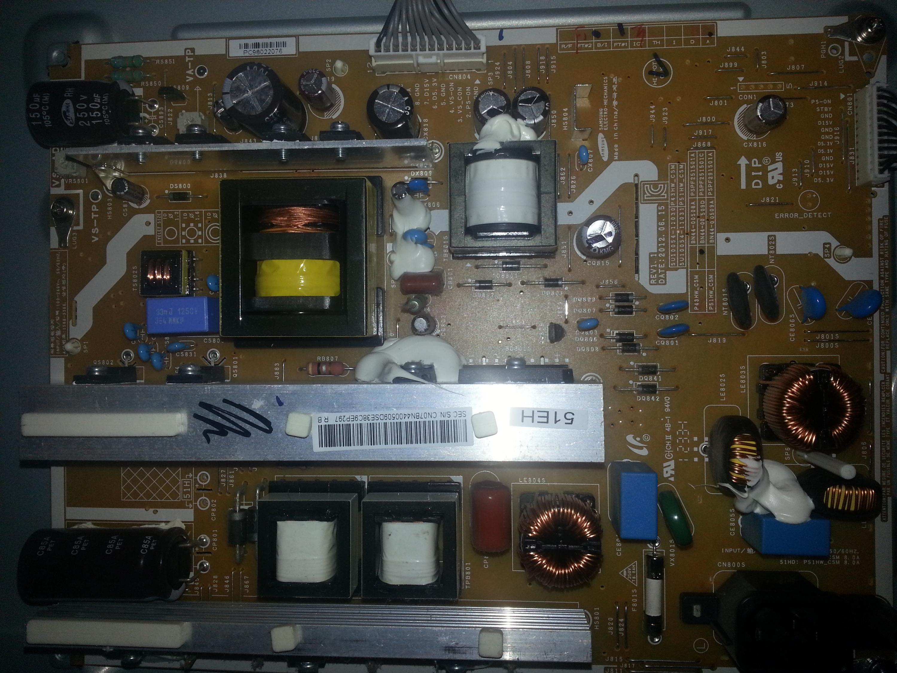

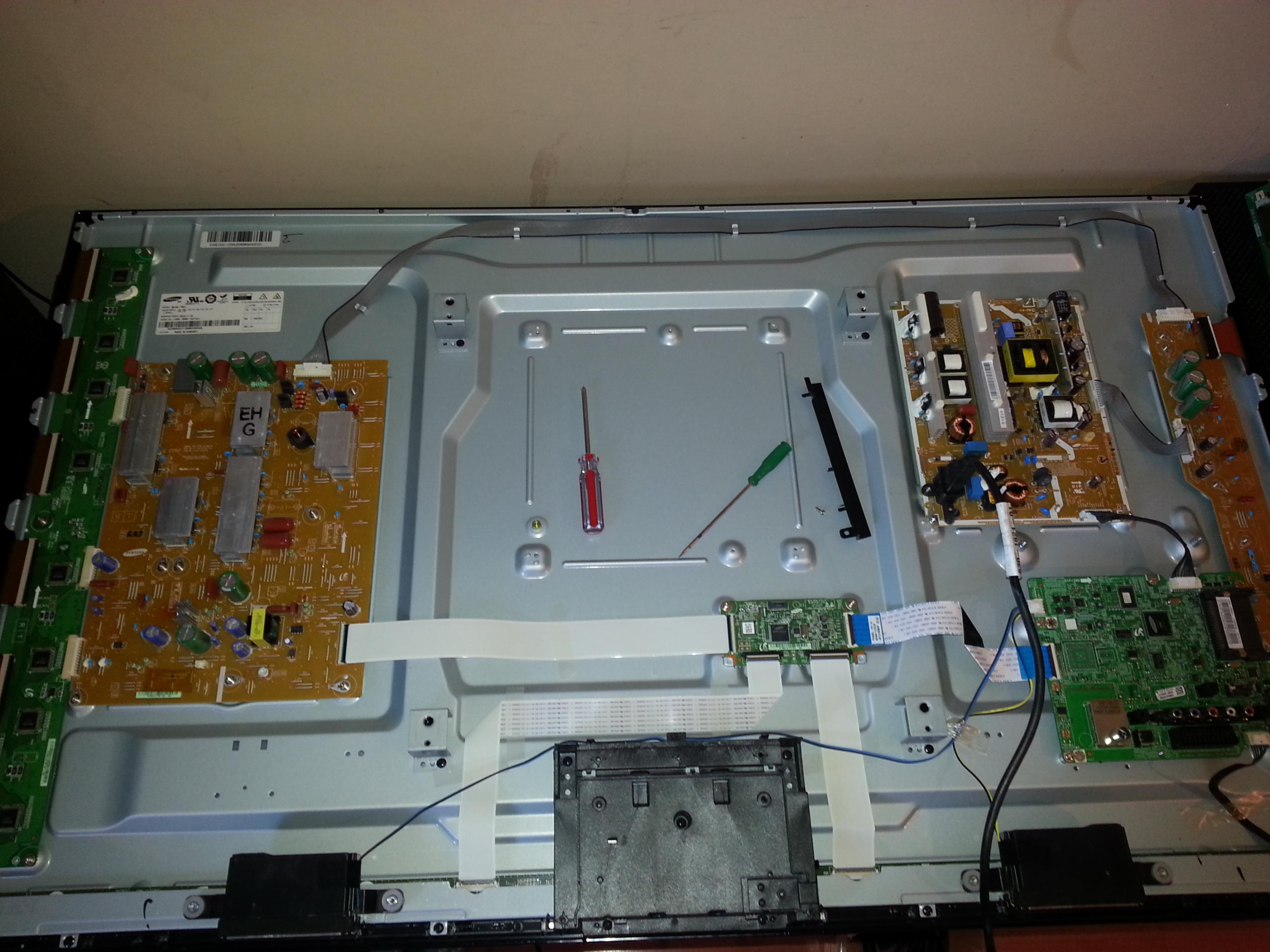

                      OK Tom here are 2 PSU pics, one with flash on and one with flash off..
                        I have another board exact same as this pulled from a 43 inch model but all voltages seem to match. Could I try that ?
                        • Alastair E
                          Chief Womble
                          • Mar 2013
                          • 1963
                          • U.K.
                          Board from 43" wouldn't be strong enough for a 51" It just wouldnt supply the current needed--although very similar, I'll bet the Vs transformer is smaller on the 43" PSU

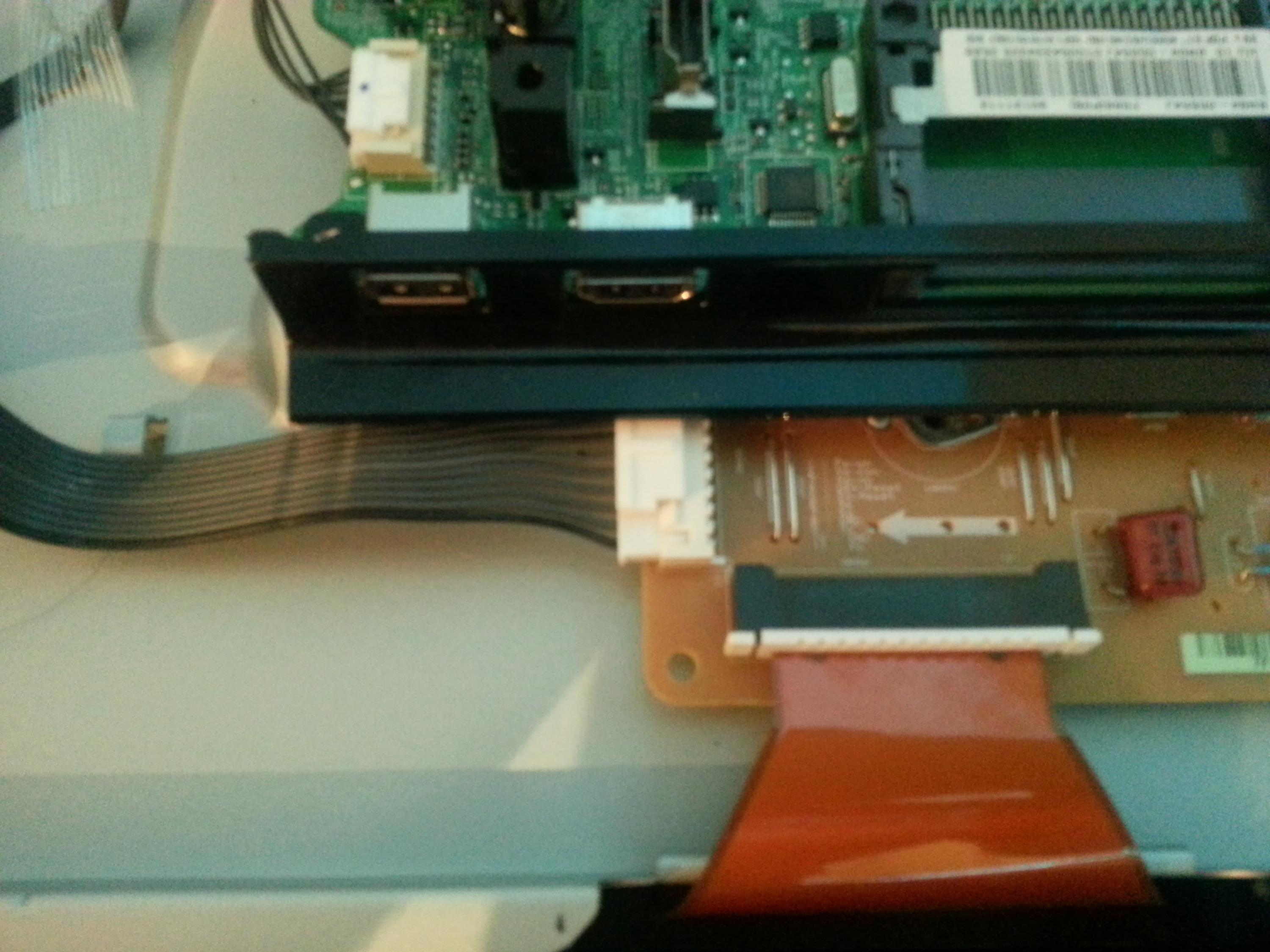

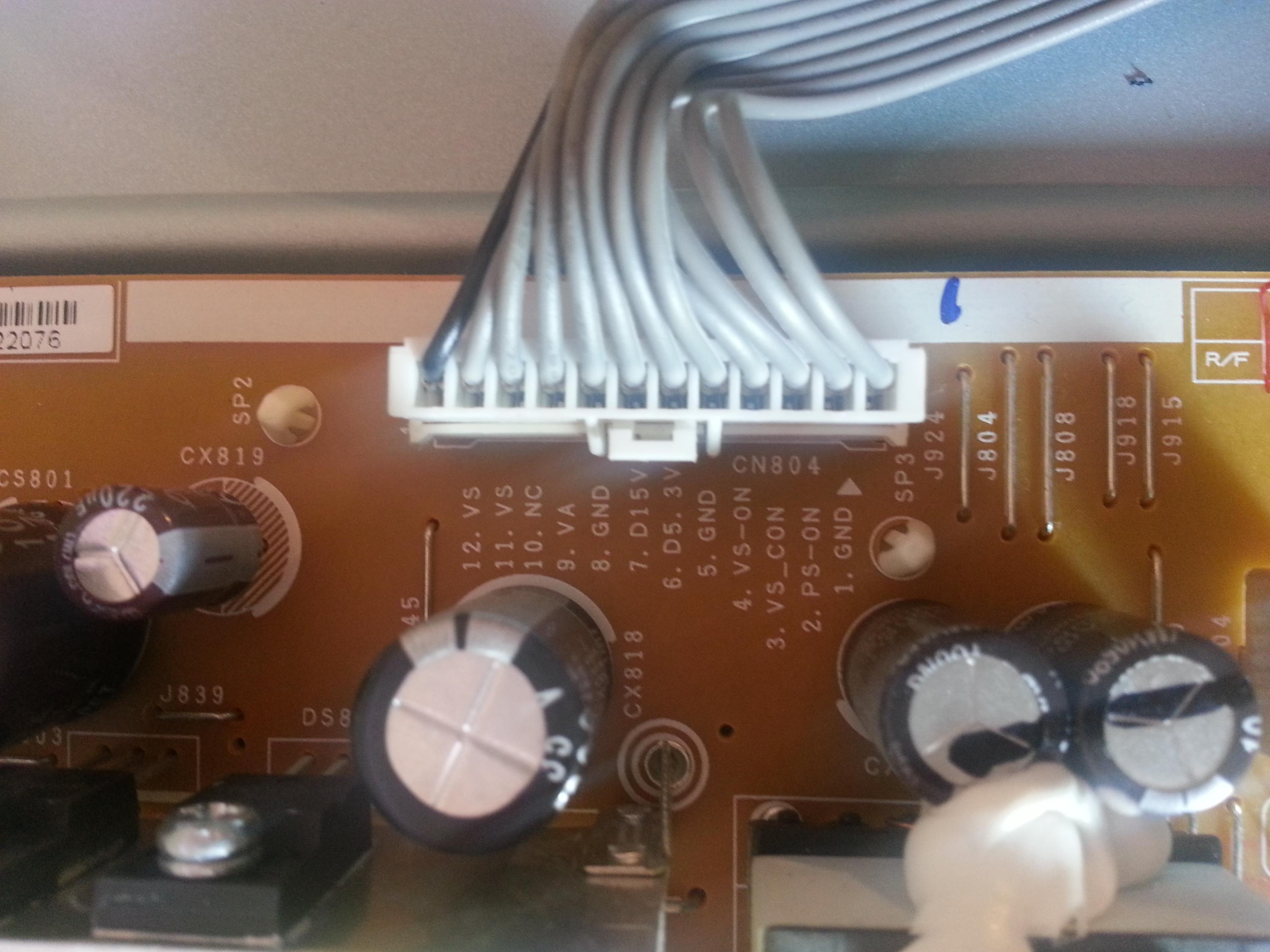

                            It seems this PSU gets its on/off signal through the "X-main" (although calling it that is a bit of stretch, there's hardly anything on it...) That then might come from the Y-main or control board.
                            Can you get a picture of the labels around the X-main and Y-main connectors?
                              is this what your after Tom.
                                Yes - is there another connector running from X-main to the bottom panel boards or to the control board?
                                  this is the layout of the tv Tom, what cable is it you mean ?
                                    X-main right hand side board in that photo, I think there is one connector hiding behind the main board. Please locate it.

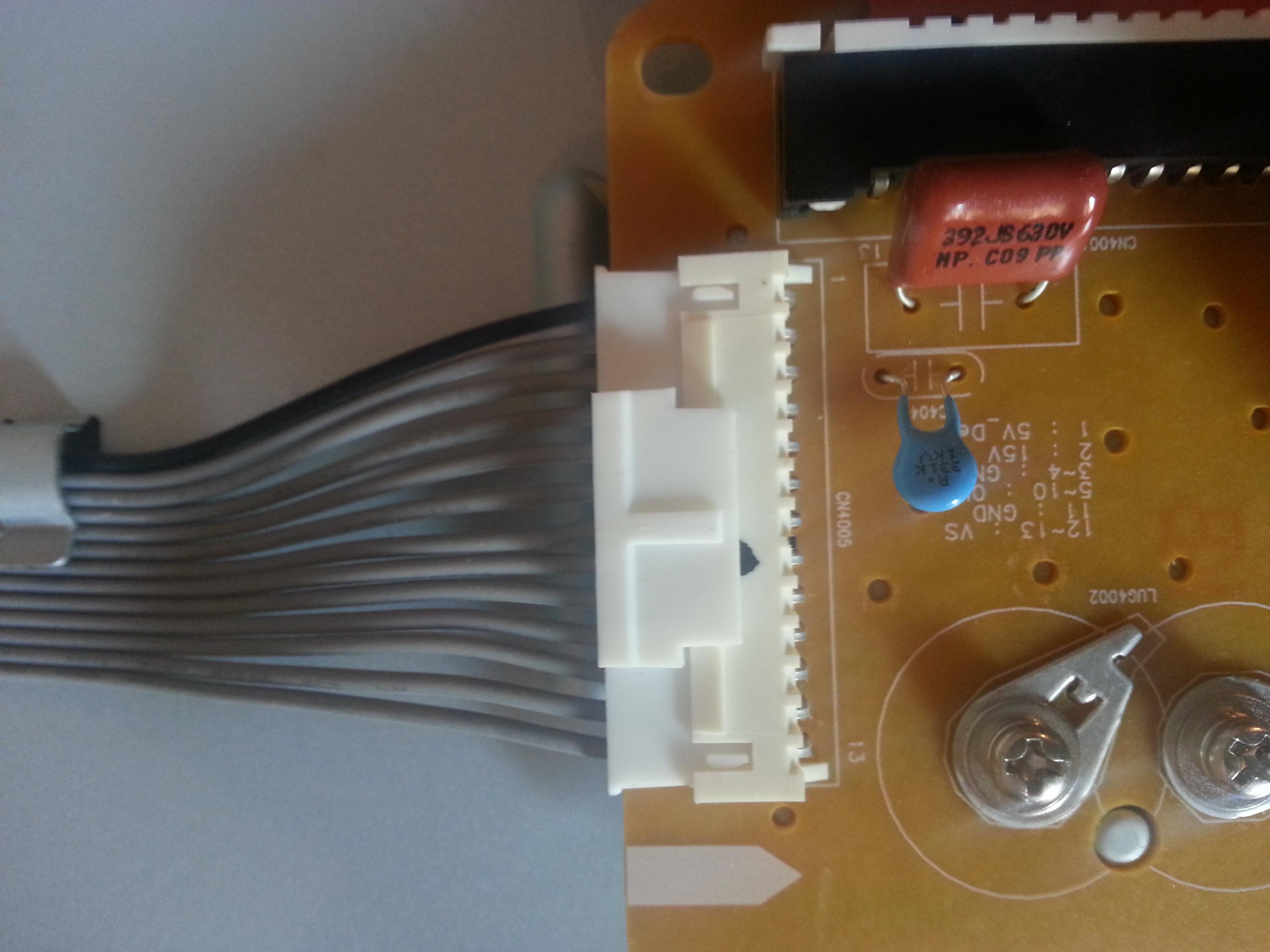

                                      this cable Tom, leads to the two boards running behing the metal shield at the bottom of the screen.
                                        OK, can you get a listing of the labels near that connector; or a picture of them?
